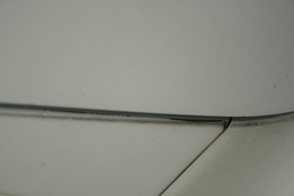

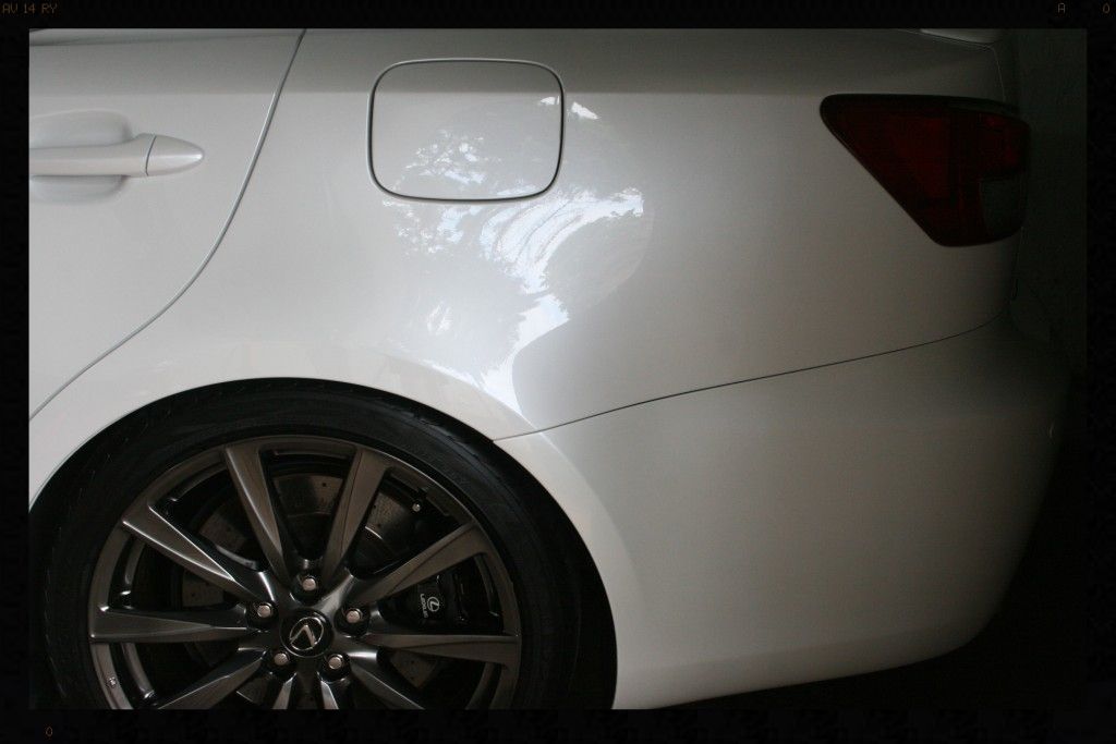

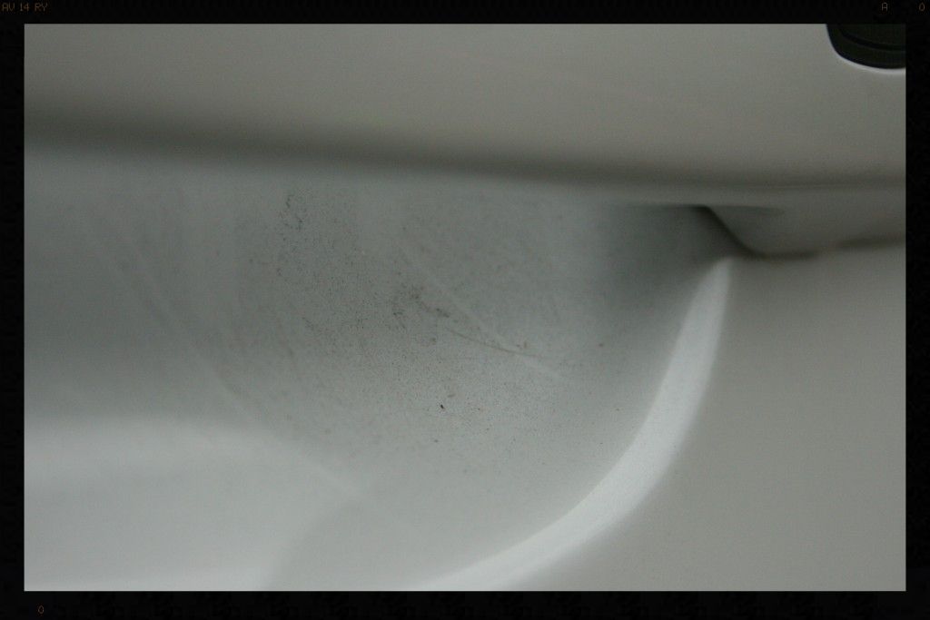

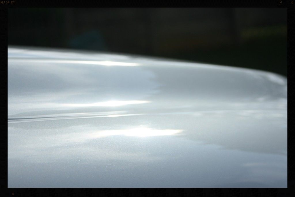

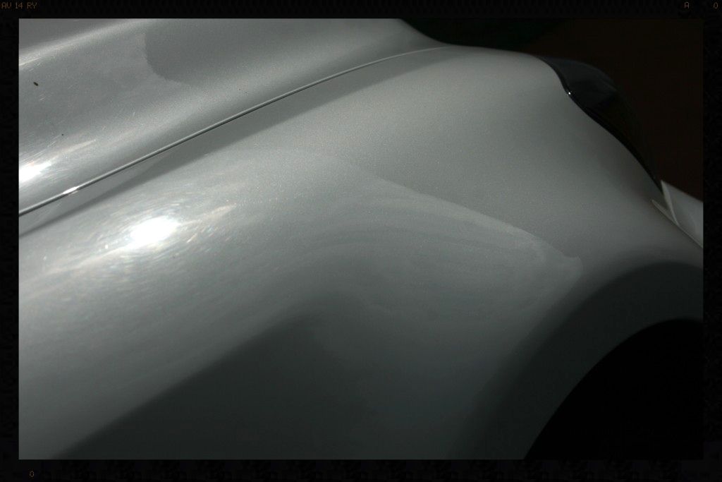

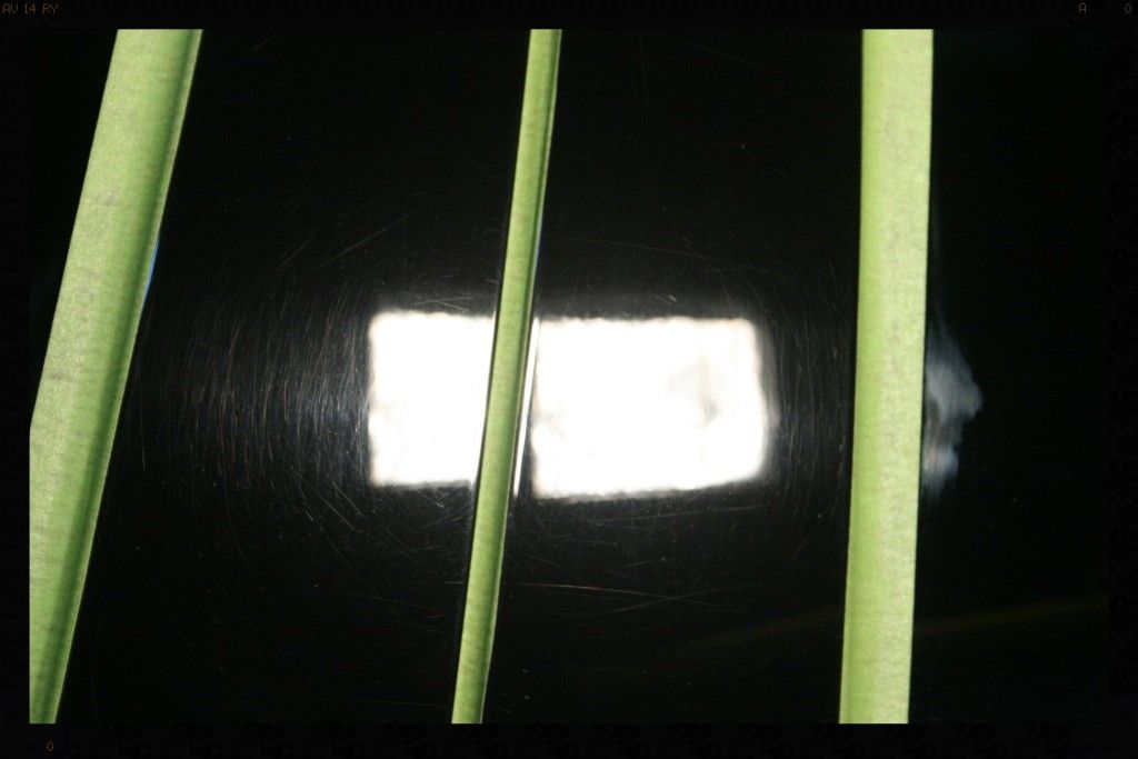

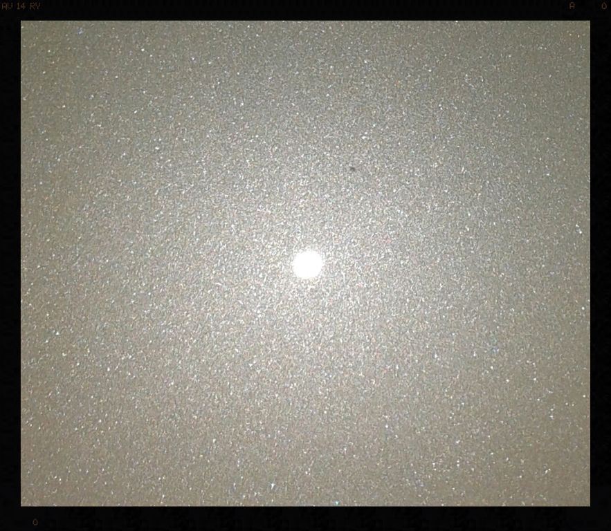

As we all know you really never can be sure of how the paint on each car will react to correction, and to make assumptions about brand 'x' being soft and brand 'y' being hard, is rather dangerous. I assumed that the paint would be on the softer side and thus was anticipating only having to do a 1-step correction. However this paint was actually rather hard (like Audi hard) and had quite deep damage. In the end a 2-step correction was needed to restore the paint but was well worth the additional work. This however meant that I was a bit pressed for time and did not get many 'during' pics. (the car is also deceptively big, especially the bonnet housing the 5l V8)

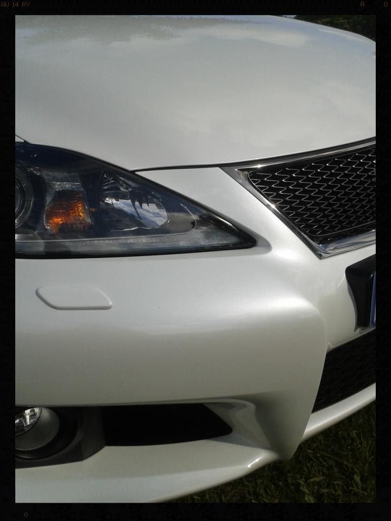

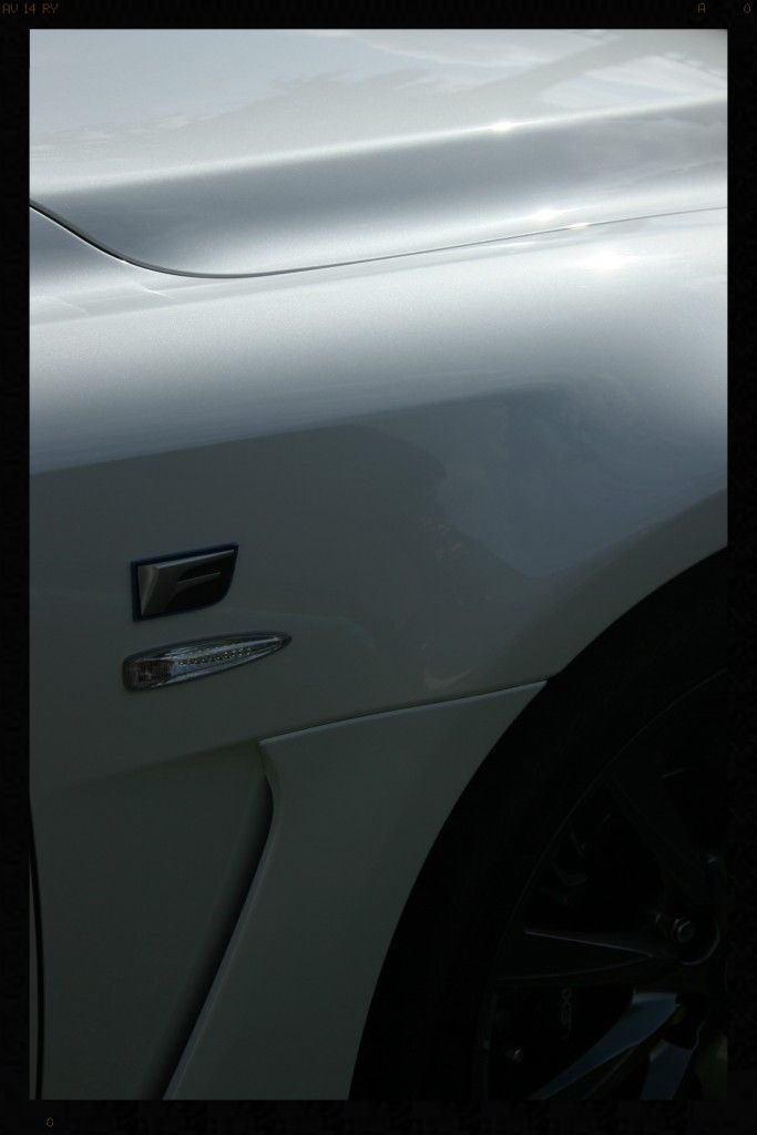

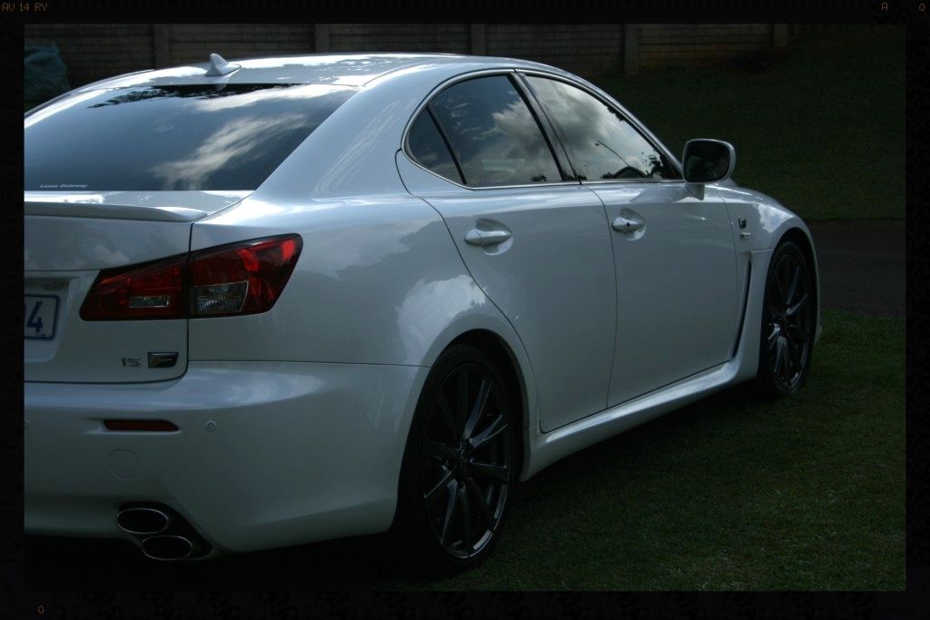

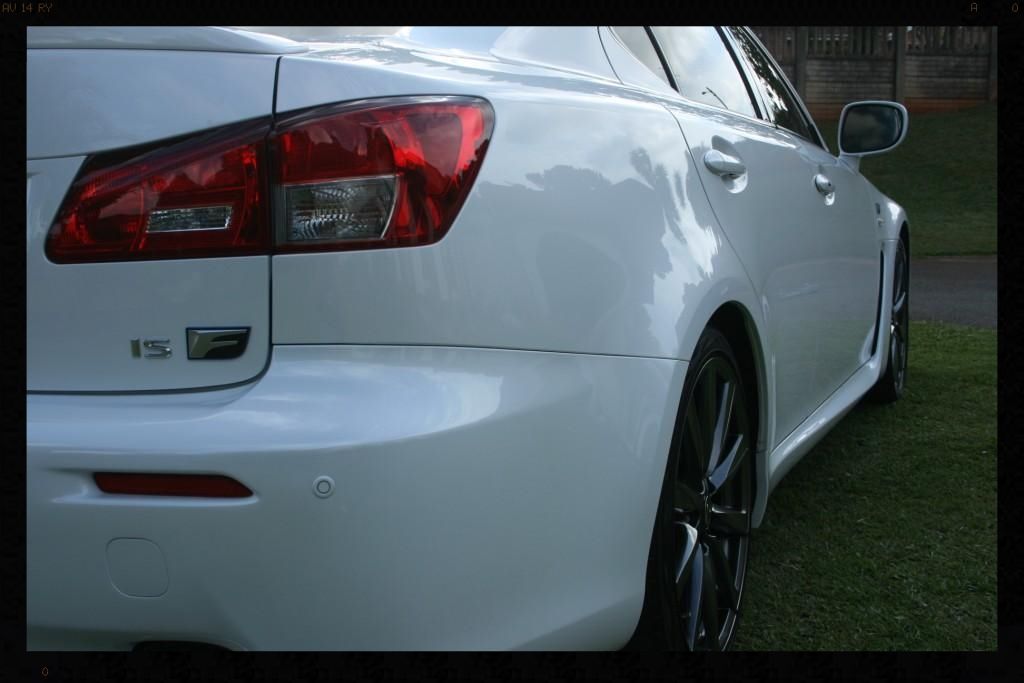

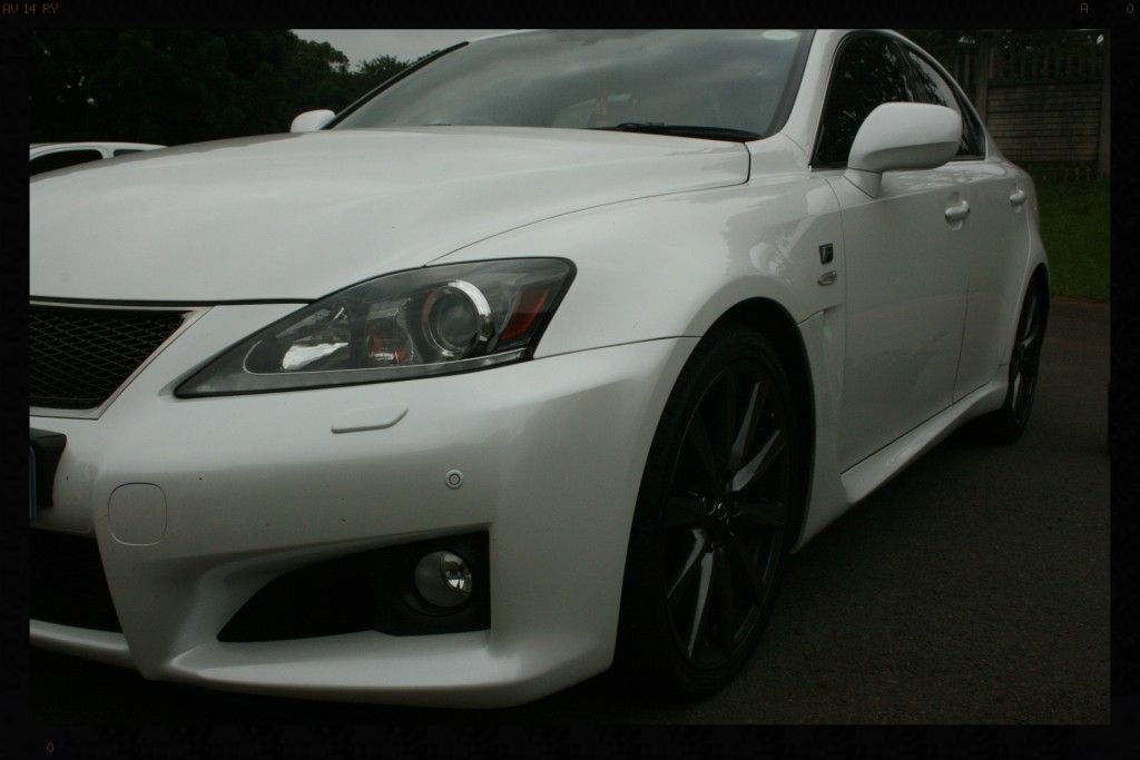

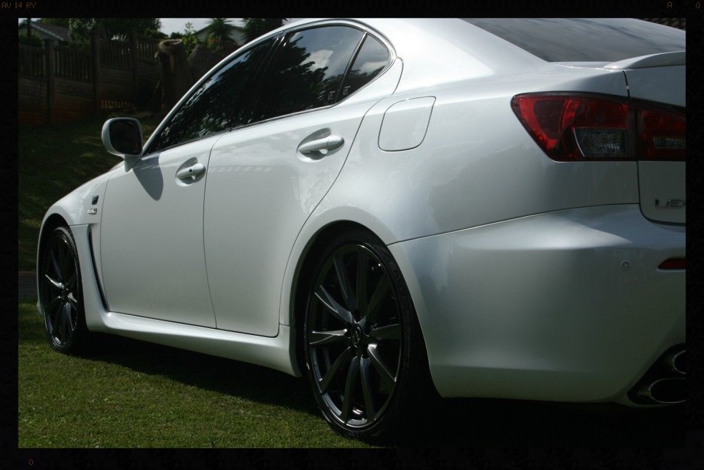

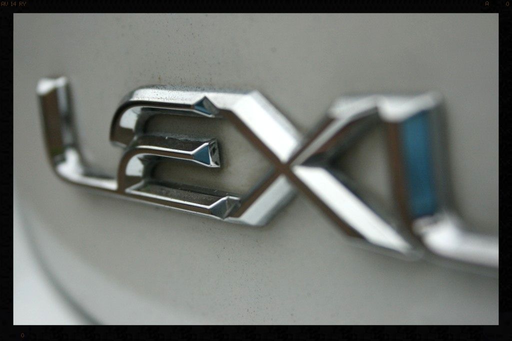

So Saturday morning was rather dark and gloomy and rain was predicted for pretty much the entire weekend. I managed to snap a few quick pics before getting stuck in - With no sun around, there was not much to see in the way of below surface defects

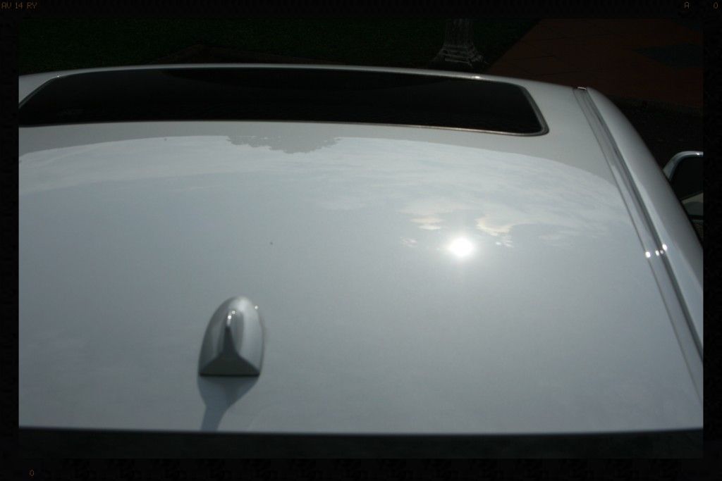

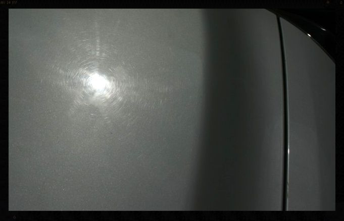

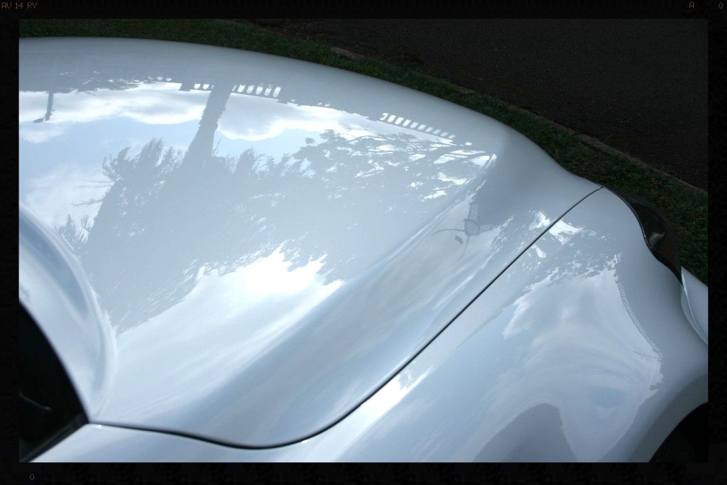

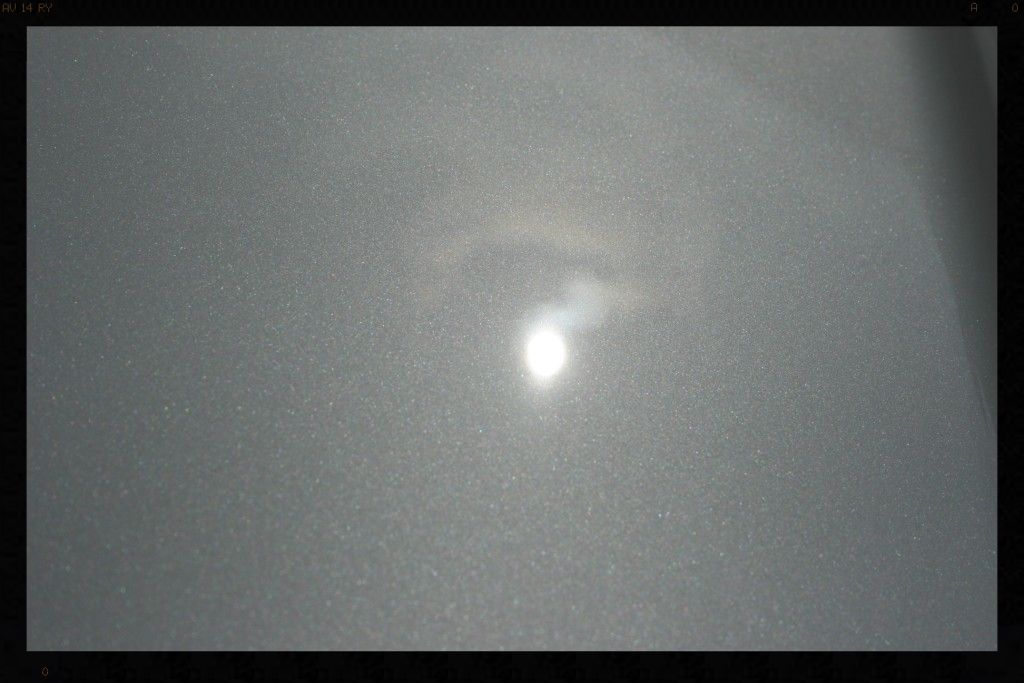

But then a little while later the sun managed to peek out from behind the clouds long enough for me to take these

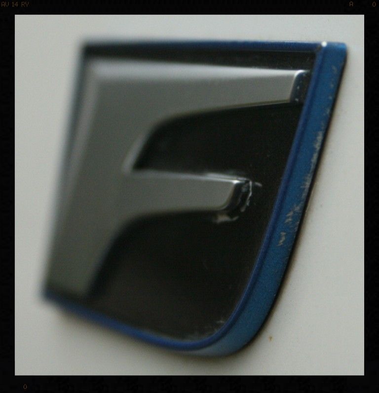

Door shuts, window rubbers, fuel flap, badges: Cyclo APC / Various Brushes / HP Rinse / Chemical Guys V7

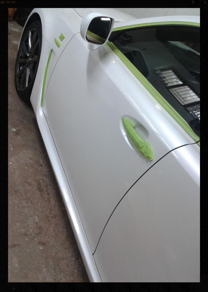

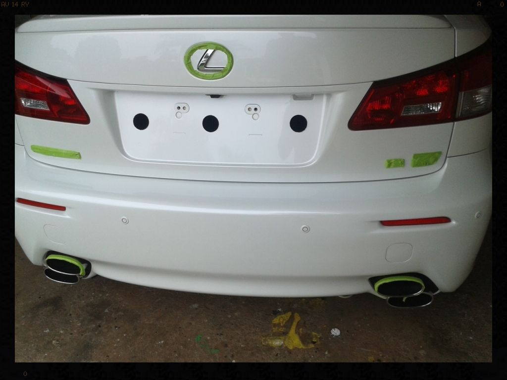

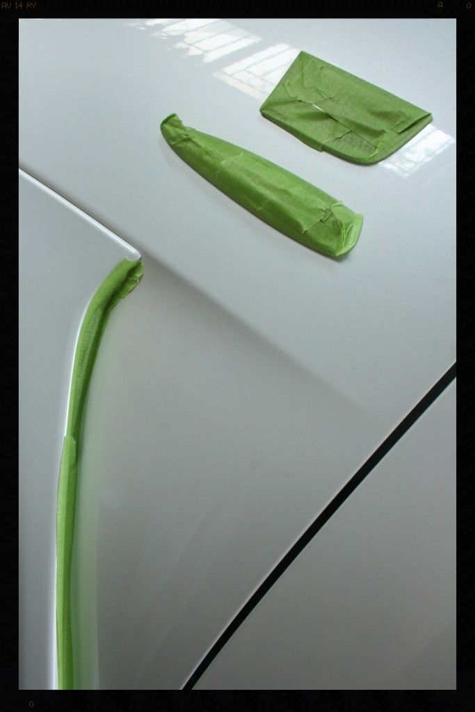

During tape up

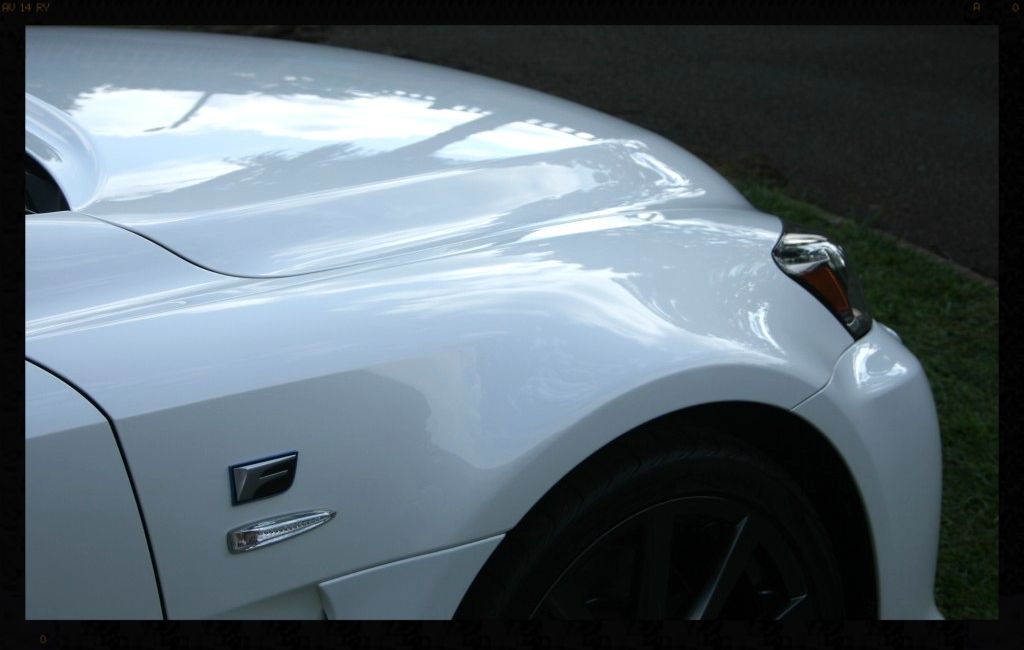

Correcting the B-pillars

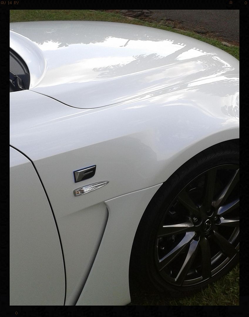

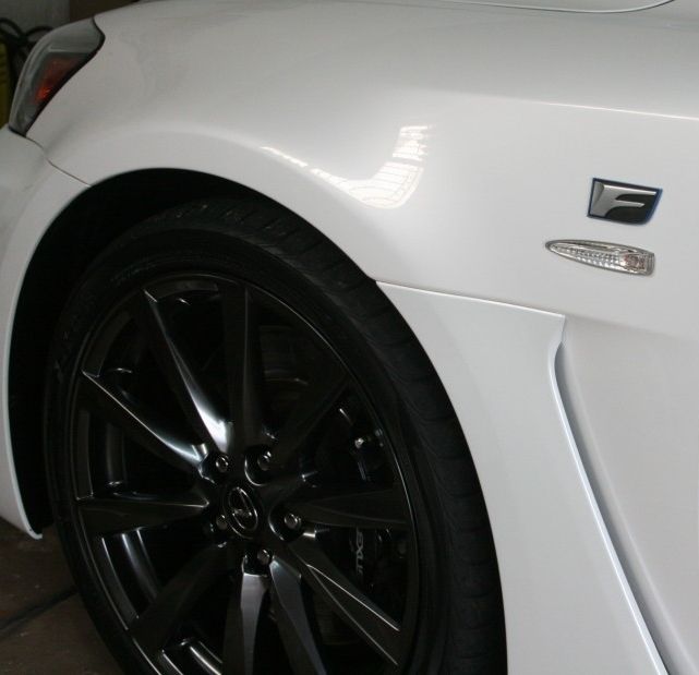

And then the paint after correction
2 Quick shots with the car still in the garage

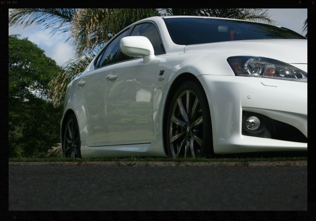

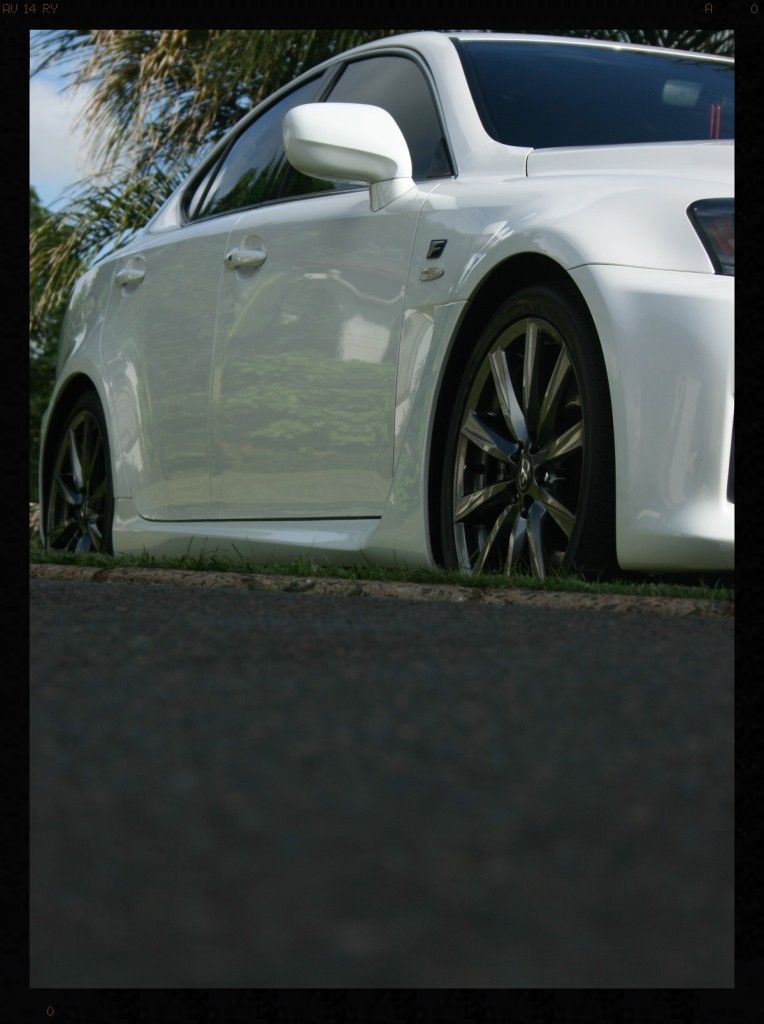

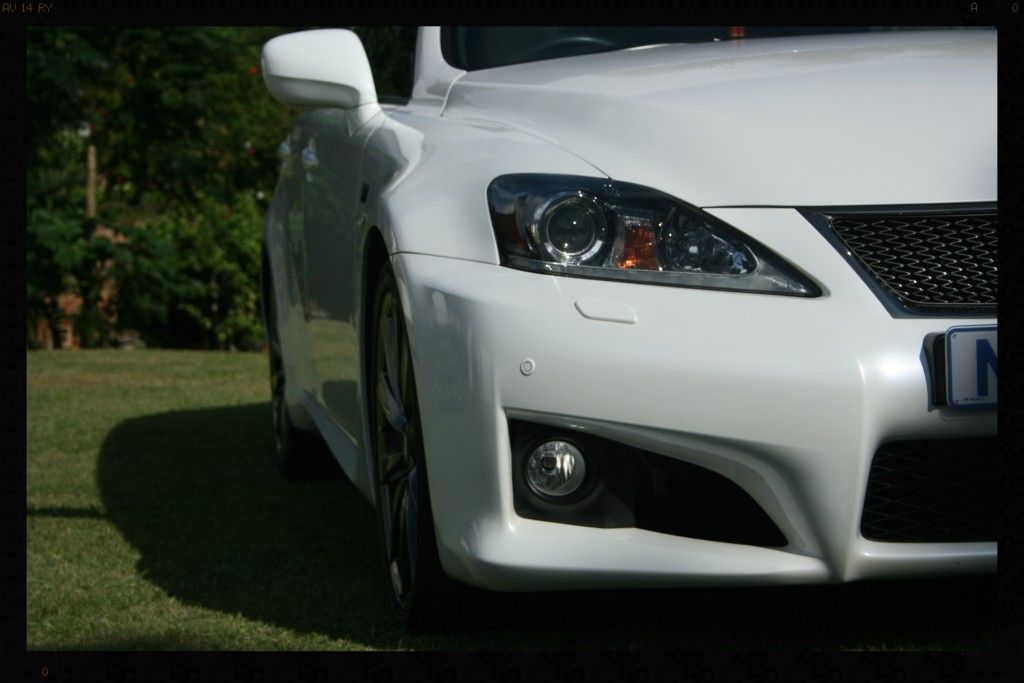

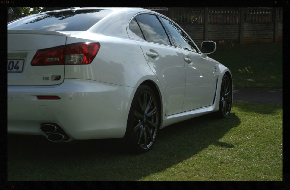

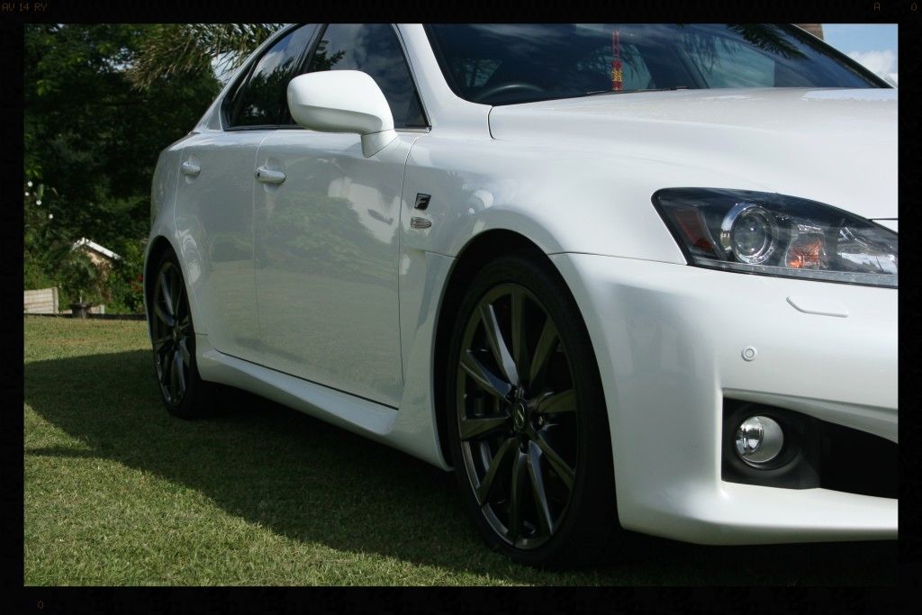

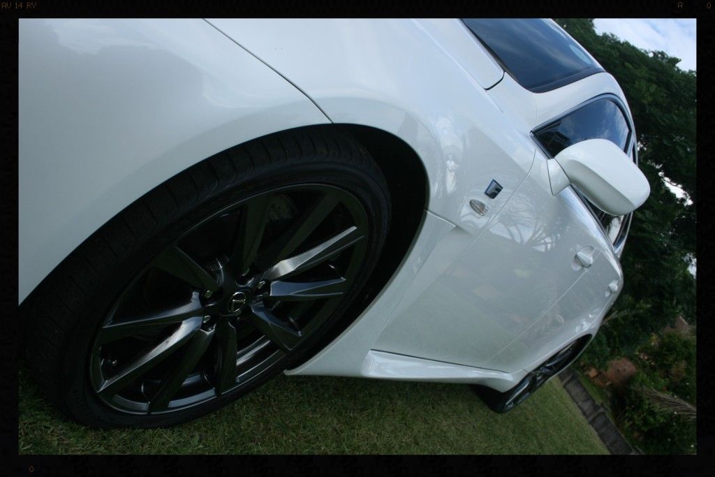

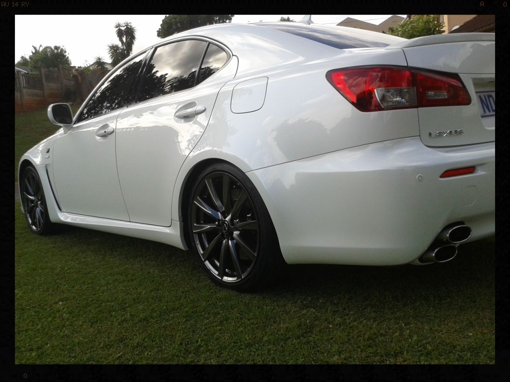

And then some taken out in the fading sun a few minutes before the owner collected on Sunday afternoon and with light constantly changing between cloud/sunny and then going into evening, the white balance is a little all over the place on some of the pics (was fiddling with it and don't have any post processing software, so sorry about that).
Total time spent = 31 hours
