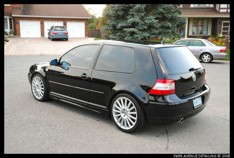

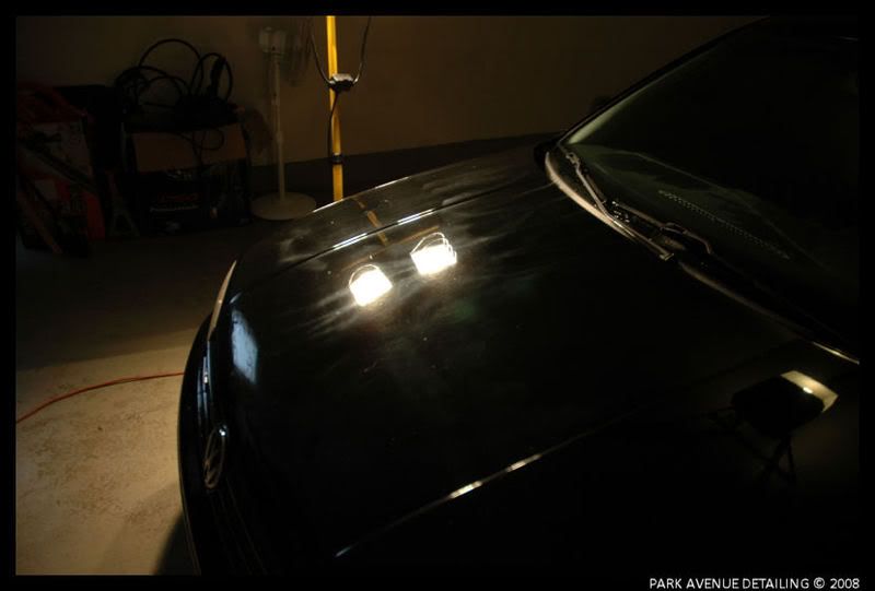

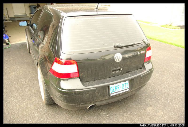

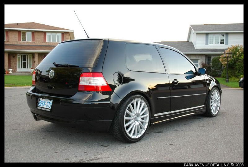

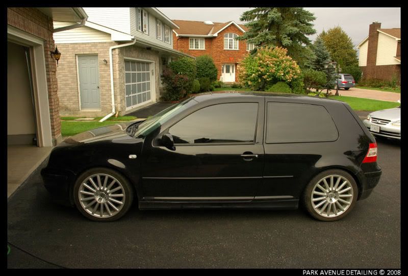

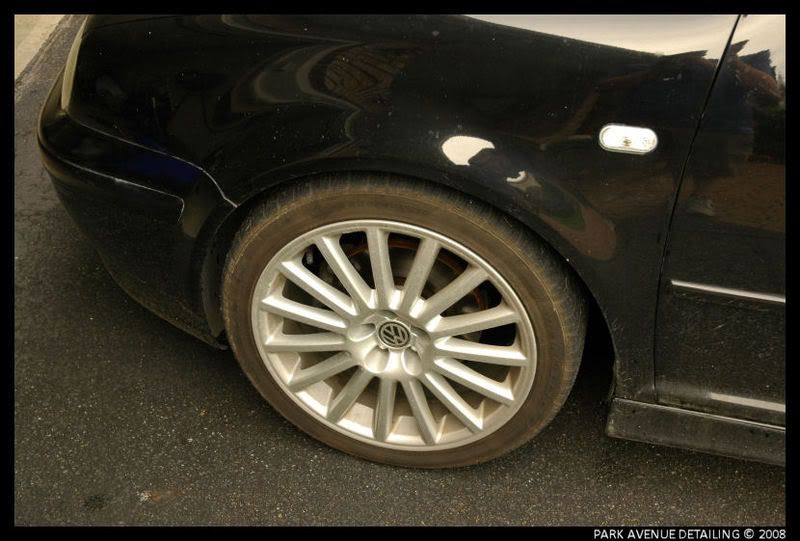

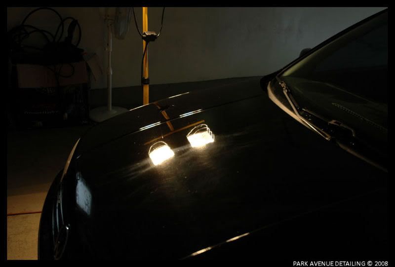

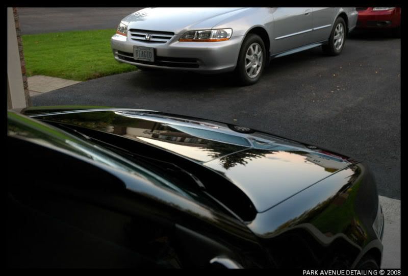

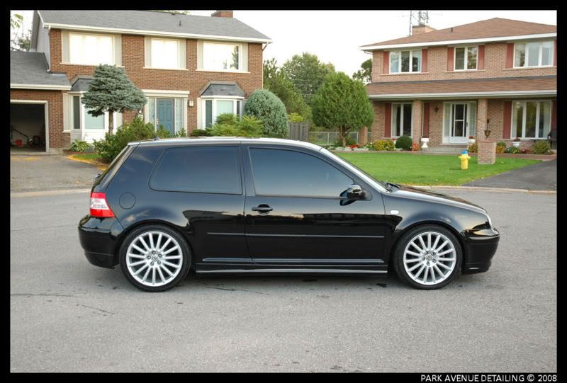

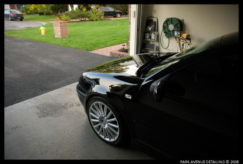

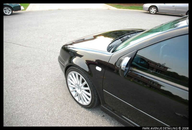

This car kicked my ***. Swirls, scratches, deep scratches you name it. The clear was rock hard, and didn't respond well to many combination's. A previous detailer hacked the car, holograms, wax residue everywhere.
Process:

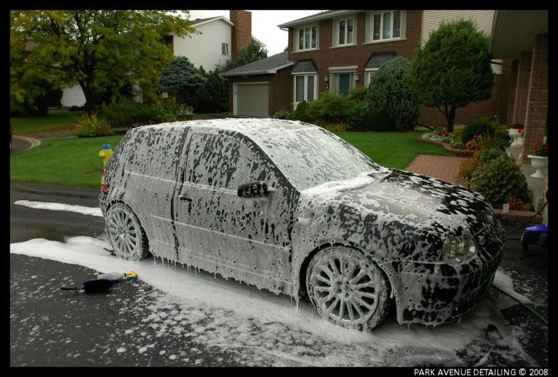

Foam with APC (car was covered in sap)
Wash/Clay

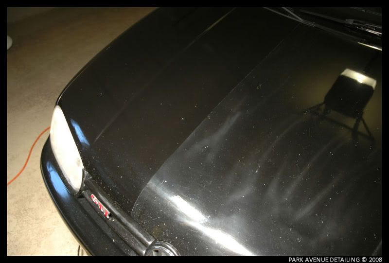

First try:
SIP with Orange CCS via Flex - no dice
Second try:
M95 with Yellow CCS via Flex - no dice
Third try:

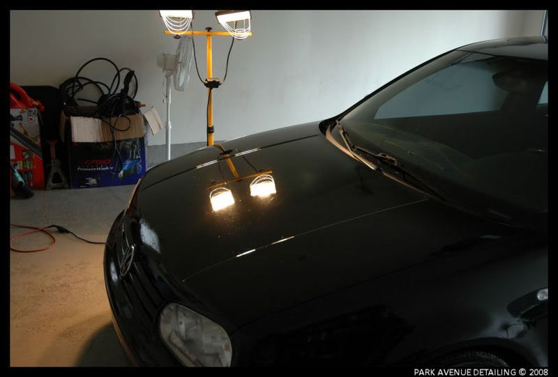

M105 with Orange CCS via Flex - worked somewhat
continued on with PO106FF with Green CCs via Flex
followed with Collinite 845iw
I wet-sanded the trunk area with 3000 to level some scratches. I also wetsanded certain door scrapes and scratches with 2000-3000 and found that M105 barely made a dent the initial pass in trying to remove the sanding scratches! ***!! I kept on going and eventually got them removed.
