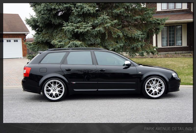

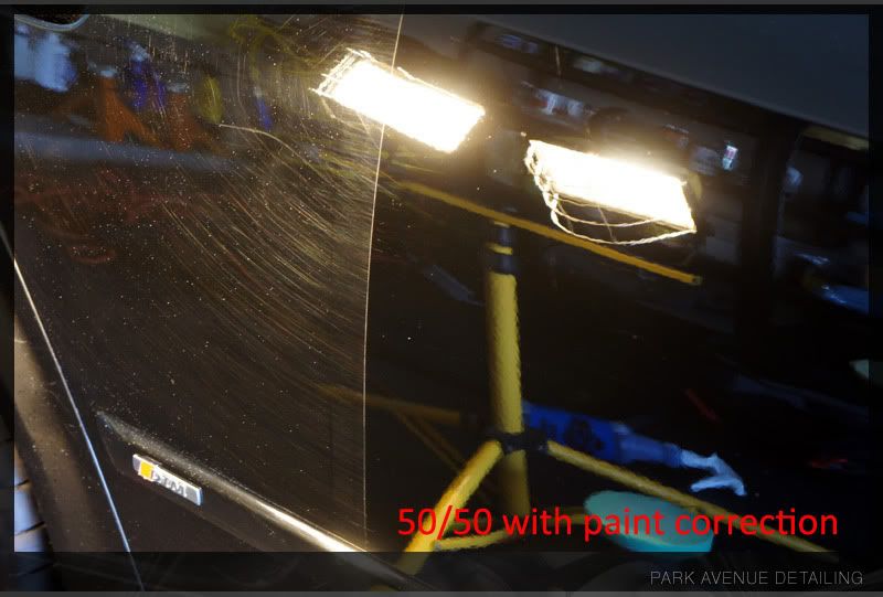

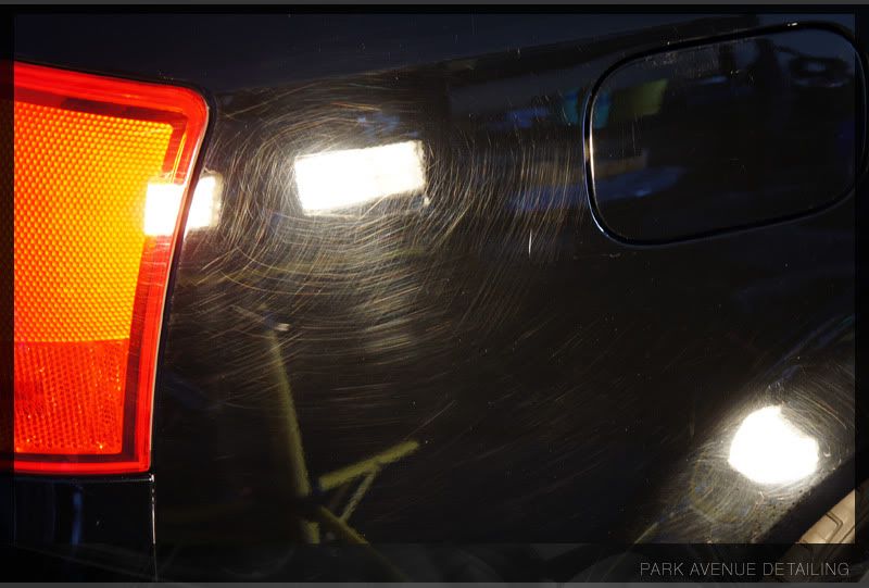

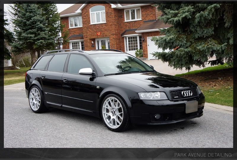

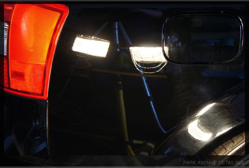

This Audi came to me looking in decent shape..although after a decon, thorough wash and clay.. holograms and swirls were massively present.
Exterior
Thorough Wash
Iron-X Decon
Clay/Tar Removal
Paint
M105 with PC/Yellow B&S
M205 with PC/Green B&S
FK1000p

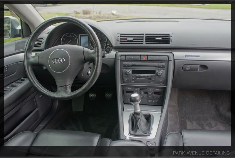

Interior
Every surface scrubbed with APC+
Carpets cleaned and extracted
Leather conditioned with 3D Liquid Leather
