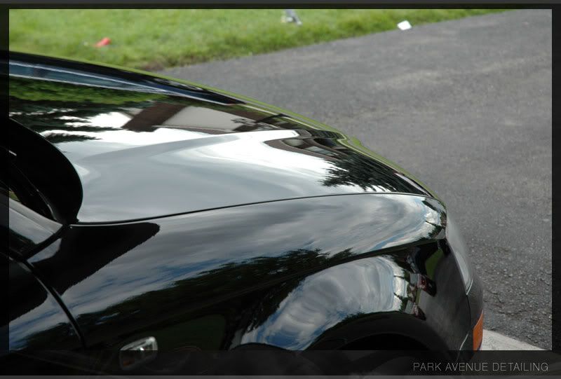

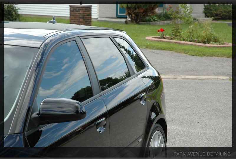

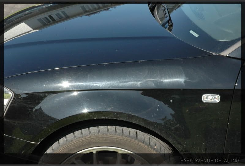

Paintwork Process:
Hood and front fenders were hologrammed:
M105/OrangeCCS/PC
M205/GreenCCS/PC
PO106FF/BlueCCS/PC
DG Aquawax
Rest of vehicle received:
M205/GreenCCS/PC
PO106FF/BlueCCS/PC
DG Aquawax

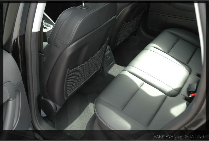

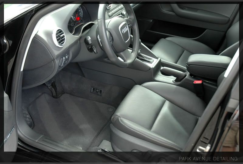

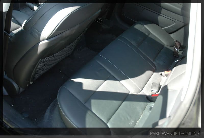

Interior was shampooed and extracted with Mytee Lite II and APC used to scrub stains, APC on all interior surfaces topped with Meg's QID.
mshu7 said:
Nice turn around! That car was trashed inside and out.
Was AW the only type of protection that you applied to the paint?
Thanks, AW is the only LSP I put on this vehicle for two reasons.
It's been on my DD for 2 months and it still beads very well. Also, this car is being returned (lease end).
Hmmm, I like AW for sure (have 2 gallons sittin on the shelf), but I've never really used as a stand alone LSP. Good to hear it's providing that much protection. And considering that car was a lease turn-in, can't say I blame ya for going with AW.
