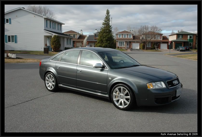

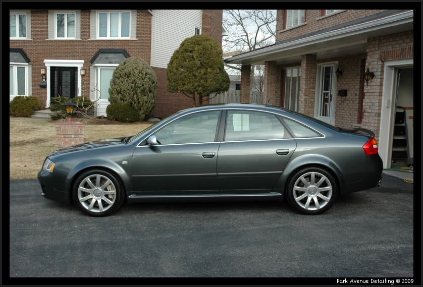

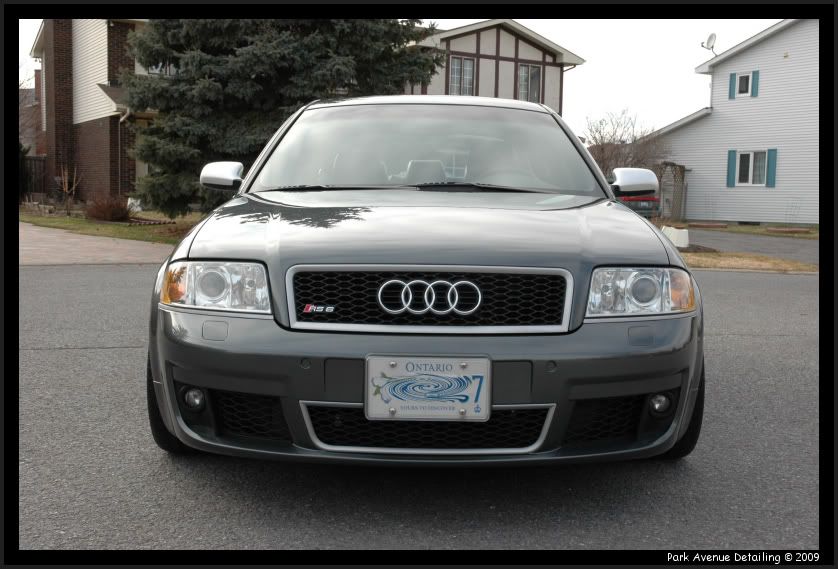

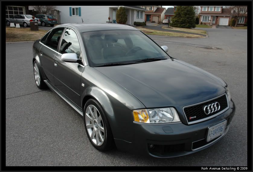

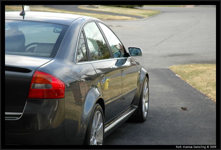

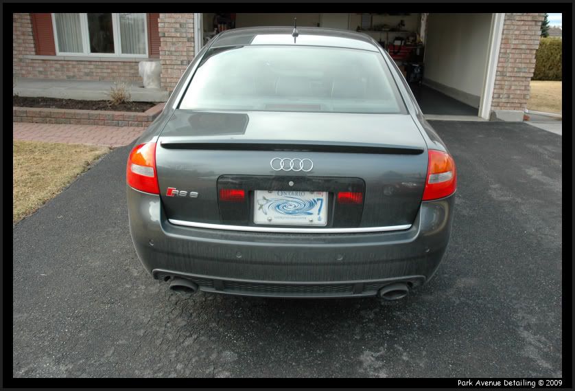

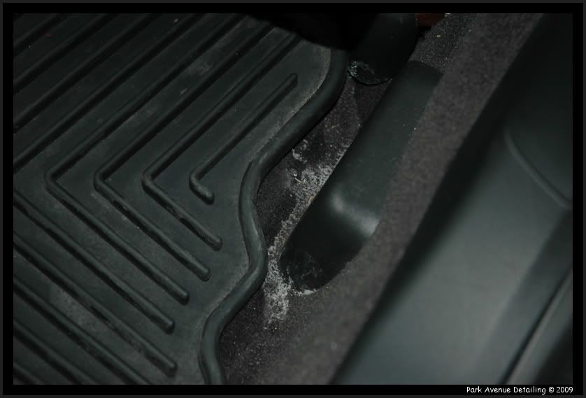

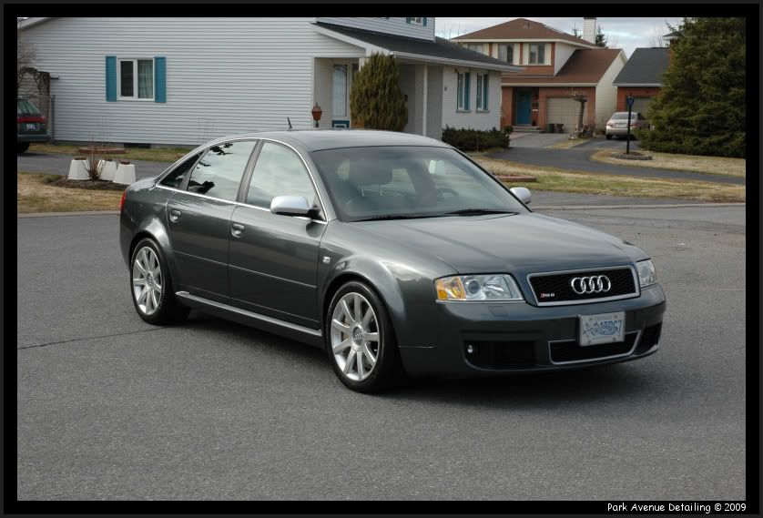

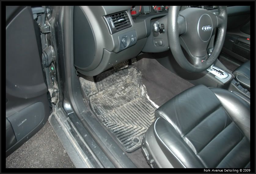

This Audi RS6 suffered from salt and winter grime on the interior. On the exterior it was your typical dirt with road tar and brake dust contaminating the paintwork.
Process is as follows:
Exterior:
Wash
-Meguiars Super Soap + DP Xtreme Foam

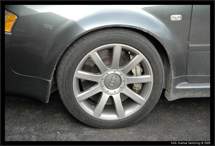

Wheels/Wells
-Meguiars WB
-APC on tires
-Megs Hyper Dressing 1:1 on tires and wells

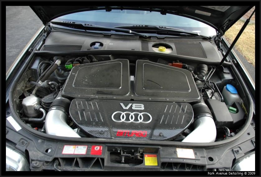

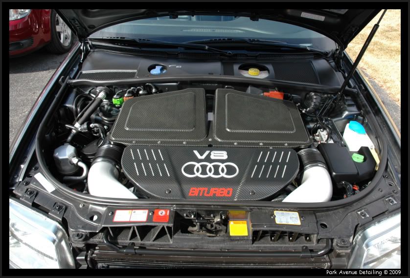

Engine
-APC and scrub
-Megs Hyper Dressing 2:1

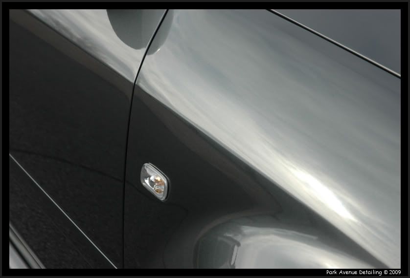

Clay
-Riccardo Blue Clay
Paint Correction
-PO203 w/Orange CCS/Flex
-M205 w/Blue CCS/Flex
LSP
Blackfire Wet Diamond
Toppings
Optimum Car Wax
Optimum Instant Detailer

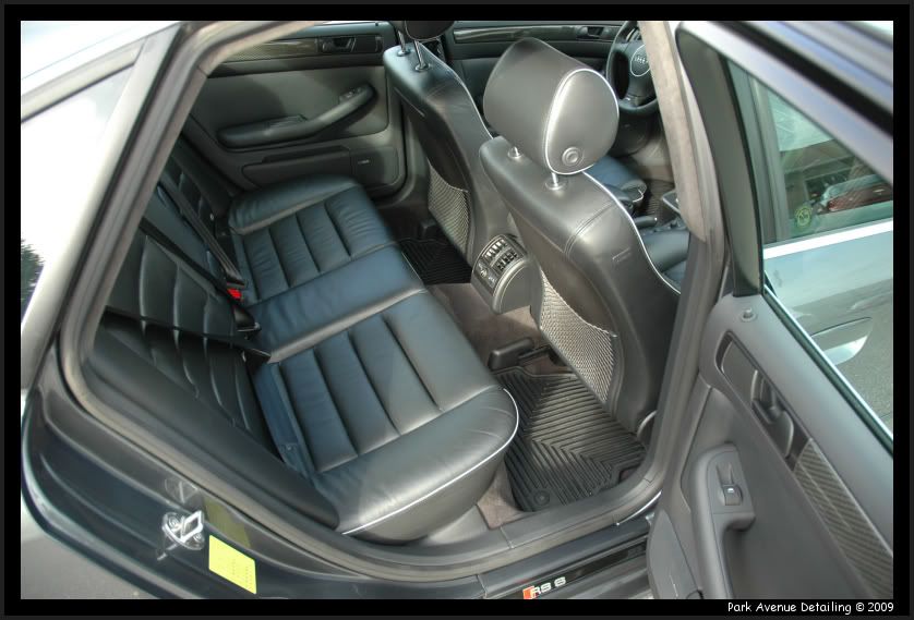

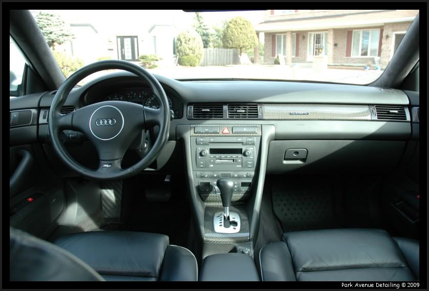

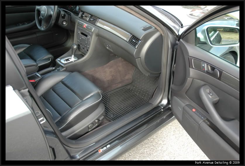

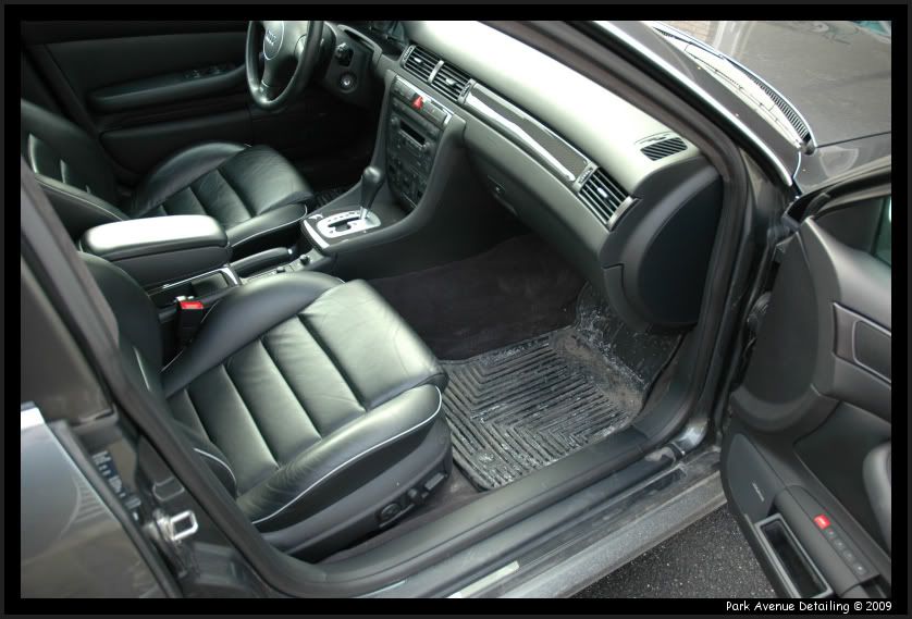

Interior:
Vacuum
Crevices Blown Out with Compressed Air
Megs APC presoak on salt
Pedals scrubbed with Megs APC
Carpets extracted with Mytee lite II
Panels wiped with Megs APC
Panels/Console/Dash treated with Megs QID

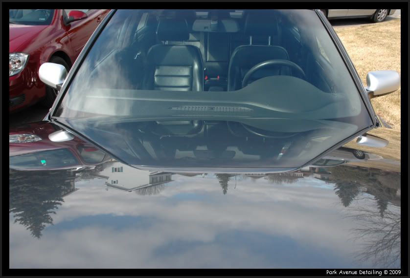

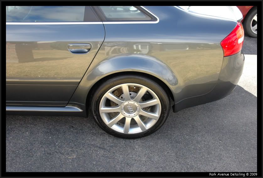

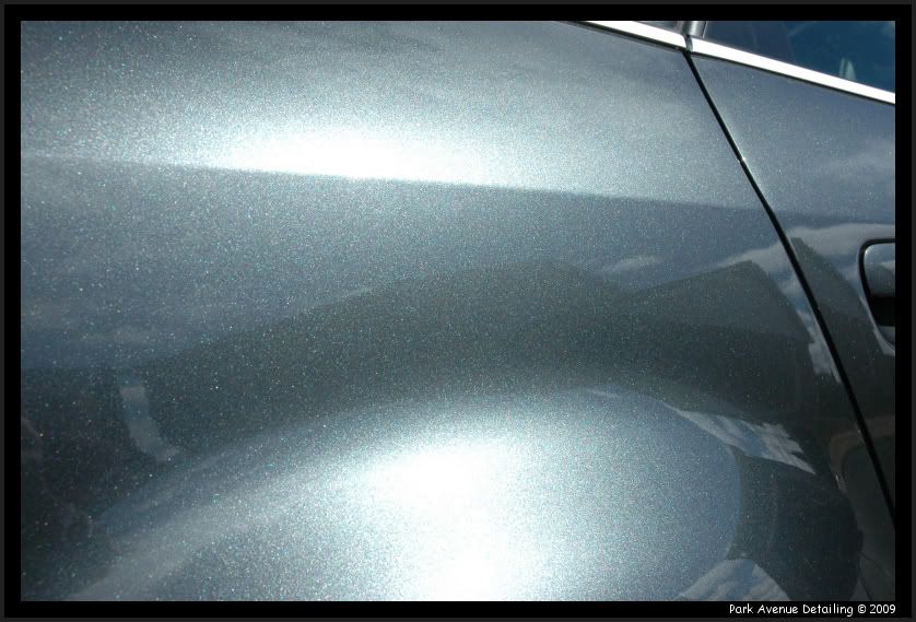

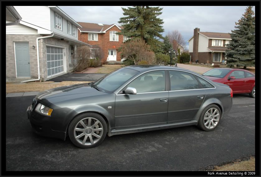

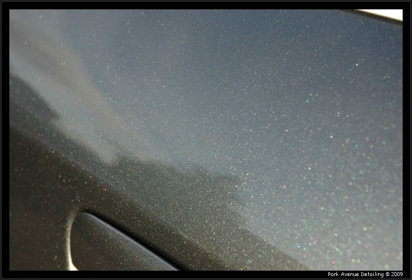

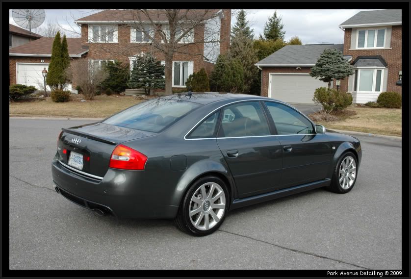

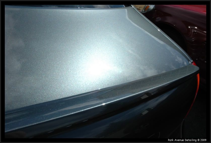

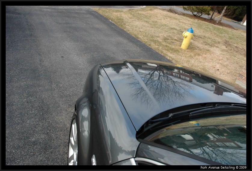

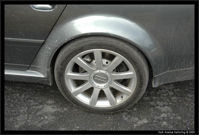

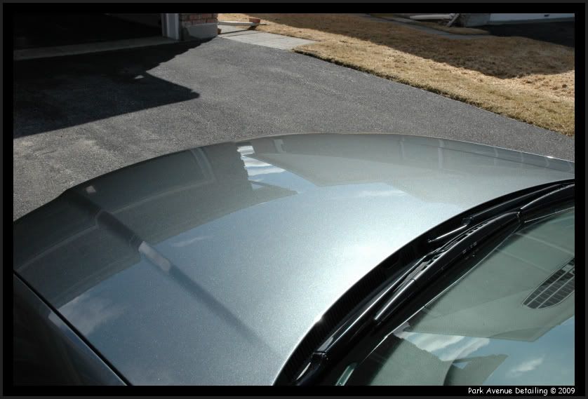

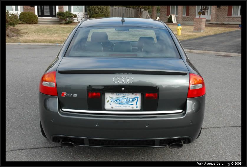

Pictures:
Engine Before:
Engine After:

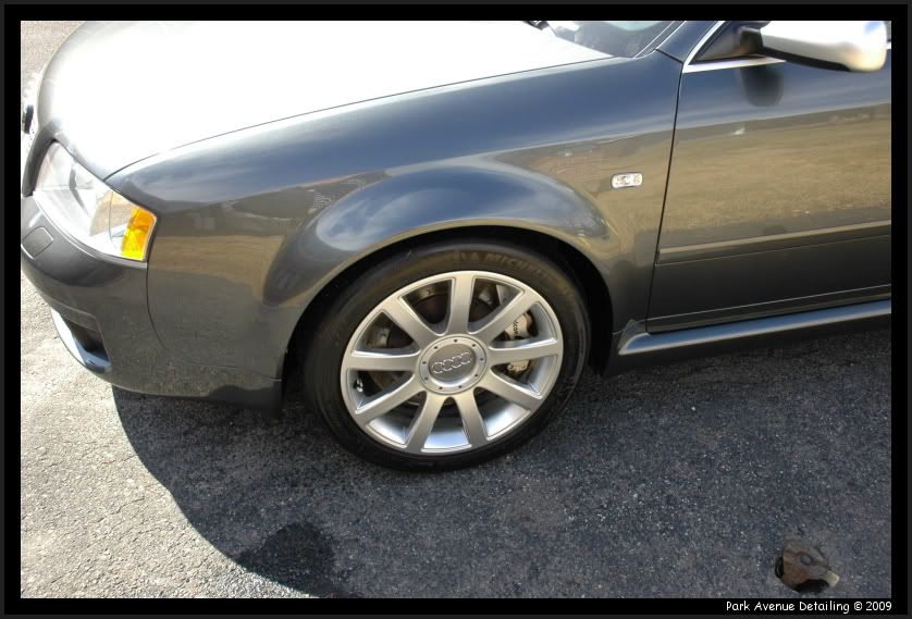

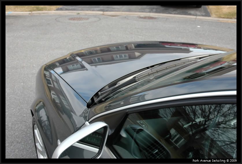

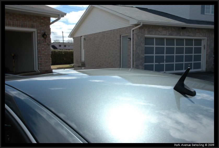

Exterior Befores:
Exterior Afters:
continued...
