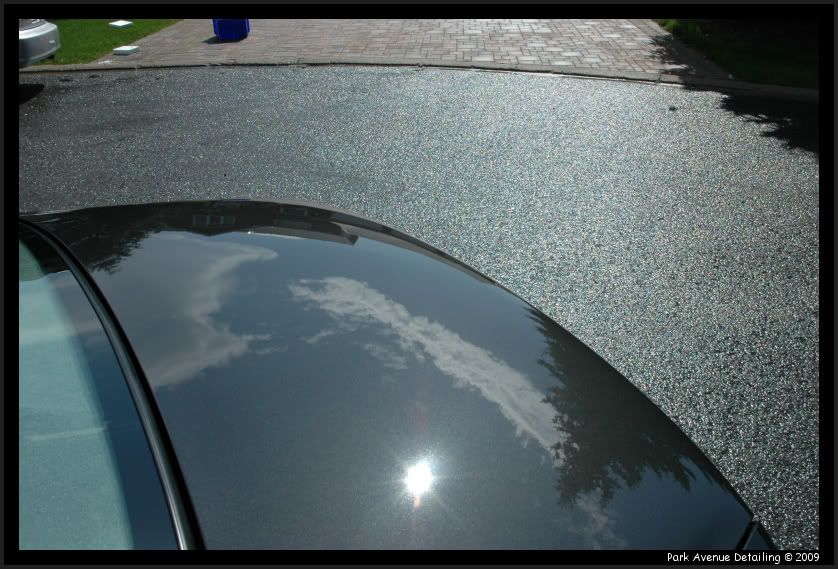

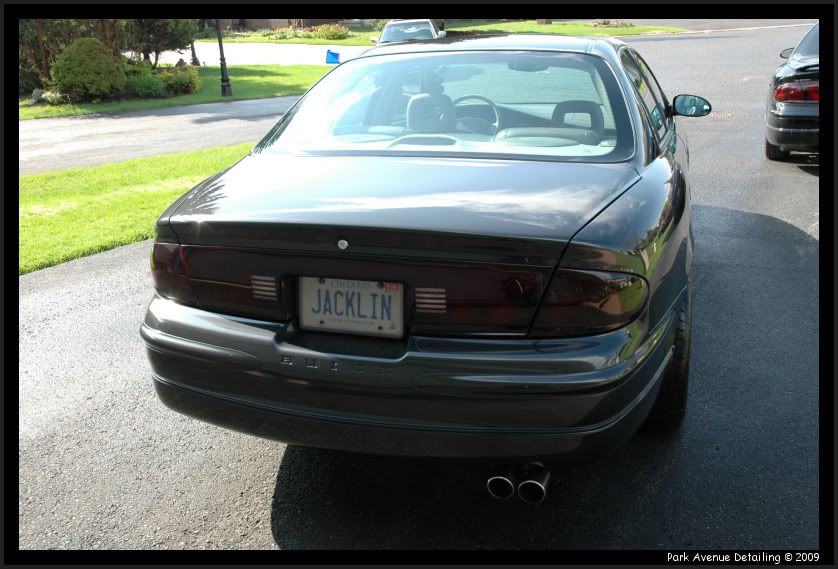

This 2003 Buick Regal with some goodies under the hood comes packed with hologramus maximus and 200,000km's on the odometer. Paintwork came back real nice. Tailights were tinted with VHT niteshades and were extremely matte...wetsanded with 2000/3000 and polished back to a great shine.
Process:
Correction
M105/OrangeCCS/Flex
M205/WhiteCCS/Flex
LSP
Blackfire Wet Diamond
DG Aquawax
Opti-bond on tires.

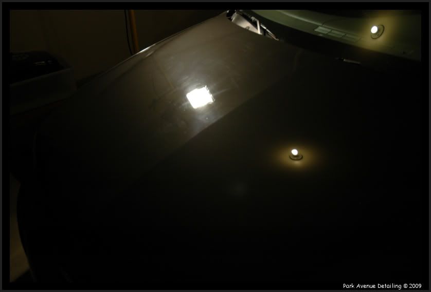

Paint 50/50's
Afters
