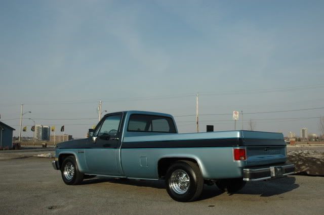

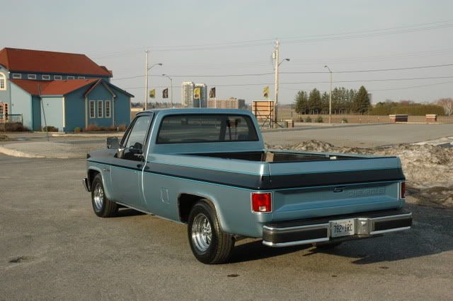

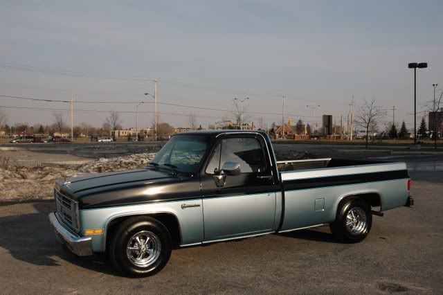

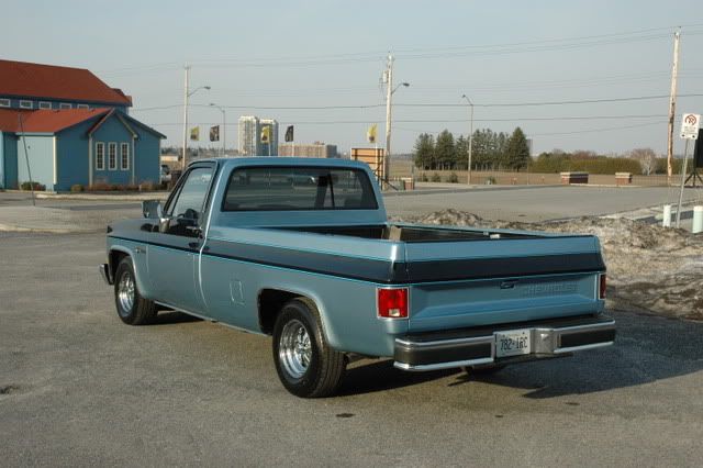

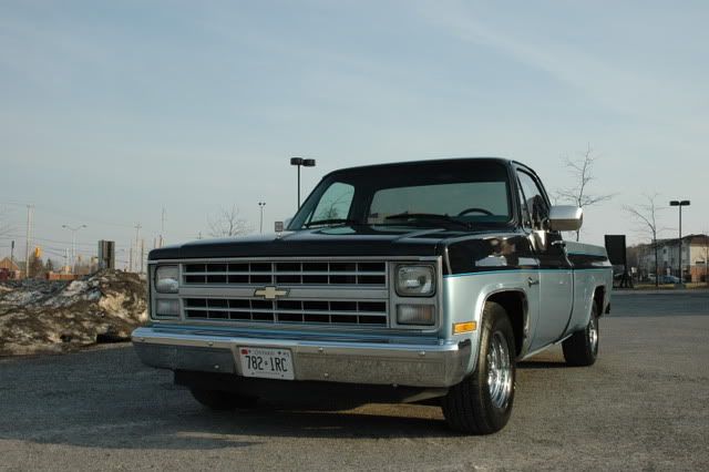

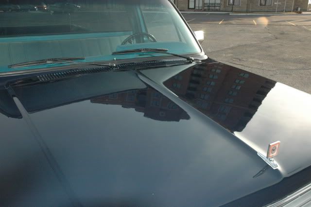

Park Avenue Detailing: 1987 Chevrolet Wrangler
gtpaul

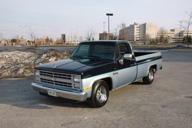

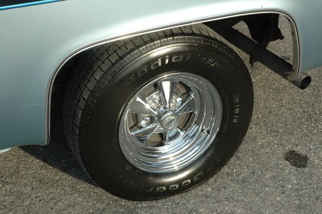

Process:
wetsand roof
PowerGloss/SIP w/Orange CCS with Flex on Speed 6
SIP/106FF mix w/Blue CCS with Flex on Speed 6
Z-AIO w/Black LC with Flex on Speed 4
rest of truck (really finicky)
What a beauty! I have had the pleasure of owning a truck just like this for the past 10 years. Same colour and everything although mine had a visor on the cab and I added lights to the visor. It does not look this good of course but it still turned a few heads. I noticed you had "rest of the truck - finicky". What problems were you having? I went through a lot of replacements with this truck and eventually ended up fairly problem free in the last few years. Never stopped loving it through all of it.
