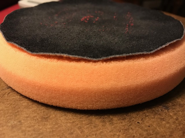

This pad is a griots pad. I have used this pad on three cars. It was on the third car that the edge of the backing began to peel away. The cars were done about 4 weeks apart from each other. First time I washed the pad I used Dove Dish Soap and warm water. After the second car I used Vinegar and Dove Dish Soap ( worked better for me then the soap and water ). I was on the third panel of the third car when I noticed this starting to happen. I use a compressor hose to clean off the pad after every panel. I am running at speed 5 on the DA. I did not catch any edges, panels or trim on the pads. I have two pads that this has happened to. Both of them Orange pads. I was using the Griots AIO. I am assuming that it is me and that the pads are good. Any idea of what I could be doing wrong ? Also I am very new to car detailing. Thank you for any help

Fishing,
Sorry these pads delaminated on you..
If you are using only 1-2 pads for the entire paintwork of 1-2 cars, it is amazing they held up as long as they did..
Random Orbitals are harder on pads because they are constantly jerking them around and trying to rotate them at the same time, so the pads get more heat and beat up, than using a direct drive on lower speeds..
I think you will have better results if you get a foam pad cleaner to clean pads; the one I use for over 15 years has never damaged a zillion pads in that time..
Perhaps you used these pads so much they overheated too many times and that weakened the glue holding the backing enough that when you washed them it started pulling off.
Another thing to watch out for - how you pull the pad off the machine`s backing plate -- make sure you reach down far enough to grasp the back of the pad AND as much of the Backing on it, so you are not pulling the foam only and starting to weaken the glue bond around the pad and the backing...
If these 2 pads are fairly new, you might be able to talk to the Seller and see if they will help you this time..
But you have to know that to correct an entire vehicle takes a lot of pads to do a good job, and to keep the pads from breaking down quickly..
Good luck with this !

What Stokdgs said.
Even with "just an AIO", I bet those pads did a whole lotta work.
And while I don`t use the Pad Cleaners (devices or products) that work so great for so many people (might start using them some day), the Dove Dish Soap and Vinegar sound like, uhm...funny...ways to clean an AIO out of a foam pad. You might try thinking of the AIO as "a mix of a polish with some oils and some kind of LSP". Neither the Dove nor the vinegar would be my choice for cleaning such a product out of anything; regular dish soap is pretty gentle on such stuff and I`d expect an acidic product to be going the wrong direction (I`d lean towards alkaline if not keeping it relatively neutral).
Easy for me to spend your money, but I bet that using a lot more pads and cleaning them with a real Pad Cleaner (do as I say, not as I do ;) ), and maybe turning down the speed (hey, I run `em fast too, but Mike lambert insists that a lower speed is better and he`s all about Griot`s stuff), will make a big difference.
EDIT: Oh, and if you`re doing a whole panel before cleaning the pads, well..uhm, maybe OK/maybe not. Even with an AIO that could be waiting too long. More frequently is generally better.

This pad is a griots pad. I have used this pad on three cars. It was on the third car that the edge of the backing began to peel away. The cars were done about 4 weeks apart from each other. First time I washed the pad I used Dove Dish Soap and warm water. After the second car I used Vinegar and Dove Dish Soap ( worked better for me then the soap and water ). I was on the third panel of the third car when I noticed this starting to happen. I use a compressor hose to clean off the pad after every panel. I am running at speed 5 on the DA. I did not catch any edges, panels or trim on the pads. I have two pads that this has happened to. Both of them Orange pads. I was using the Griots AIO. I am assuming that it is me and that the pads are good. Any idea of what I could be doing wrong ? Also I am very new to car detailing. Thank you for any help .
Lighten up the pressure on the machine and lower the machine speed to four, if you need something more aggressive step up to a more aggressive pad and/or polish. As another said, that is delamination and it is primarily caused by heat, not by compressed air cleaning or cleaning chemicals (unless left overnight in solution). The adhesive gets heat cycled by the polisher and when the heated up adhesive comes into contact with something wet, it will loose its adhesion power. Wait to introduce the pads to soaking until the pad has cooled. With Wolfgang Uber AIO I find that I need to clean the pads with Super Clean at 3:1 to completely remove the sealant, I`ve never had a pad delaminate due to brief cleaning, just heat and in the odd case soaking overnight (my mistake). What polisher are you using? What was your ambient temp of the doing work? I have also noticed that thicker pads are more prone to delamination on orbitals, specifically long throw machines. Your climate also plays a role, maybe you might need to invest in higher quality pads in the future? Griots Boss pads are pretty effective, but after playing with my Lake Country HDO Wool pads, the Lake Country HDO foam are in my future, the foam interface built into the pads allows the machine to be more effective on contours compared to the Griots pads. I`ve never had a Griots Boss pad delaminate, but I have had trouble keeping them spinning in really tight curves, not as much of an issue with the Lake Country HDO Wool pads nor ever an issue with CCS pads.
Agree with what others have said. Lower your speed, lighten up your pressure. You are generating too much heat which causes those Griots pads to peel. Also, you should be using 3-4 pads minimum, even for just an AIO job. I usually switch to a new pad for each panel. Especially with foam cutting pads, the pads soften up when heat is generated through them. So after about a panel or two it basically turns into a foam polishing pad in terms of softness instead of a foam cutting pad. You need to change the pads often to continue to get good cut.
