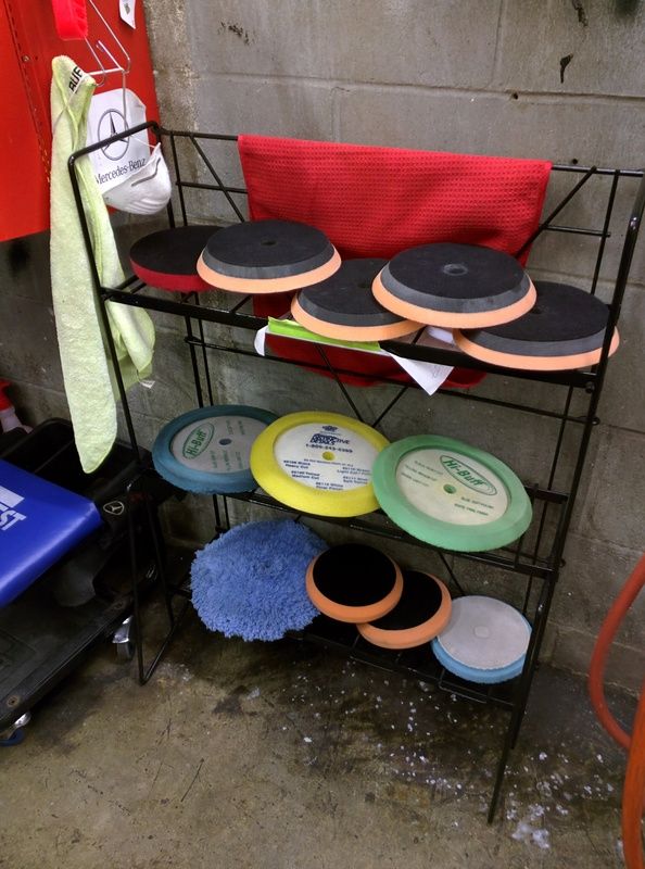

If your looking for a simple way to dry the pads after they are cleaned! Now it's getting colder out(at least up here in ontario) I put a fan on to accelerate dry time
