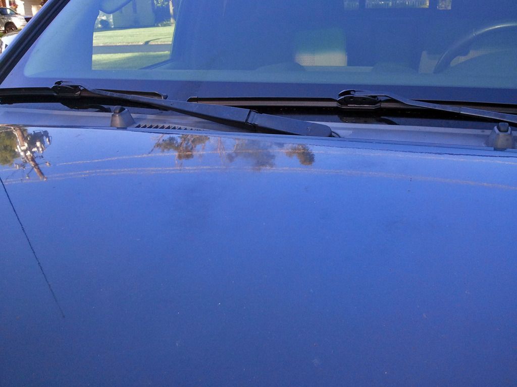

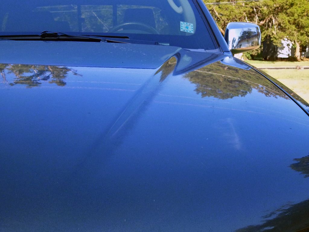

This spot on the hood started to develop about a month ago. Noticed it one day after washing the truck. Now, it seems the hip and back of the hood is doing the same thing. I realize my sealant (PB EX with Carn.) is about the end of its rein, but the truck still beads decent. Is this an oxidation issue, or something else? I'm 95% sure the hood has been repainted, and am unsure how much they removed during the wetsanding process. There are a couple burns from when they buffed the passenger side that was painted as a blend, so I'm pretty weary.

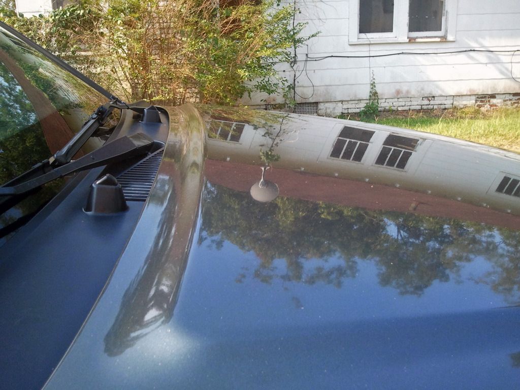

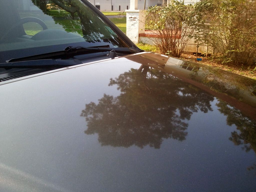

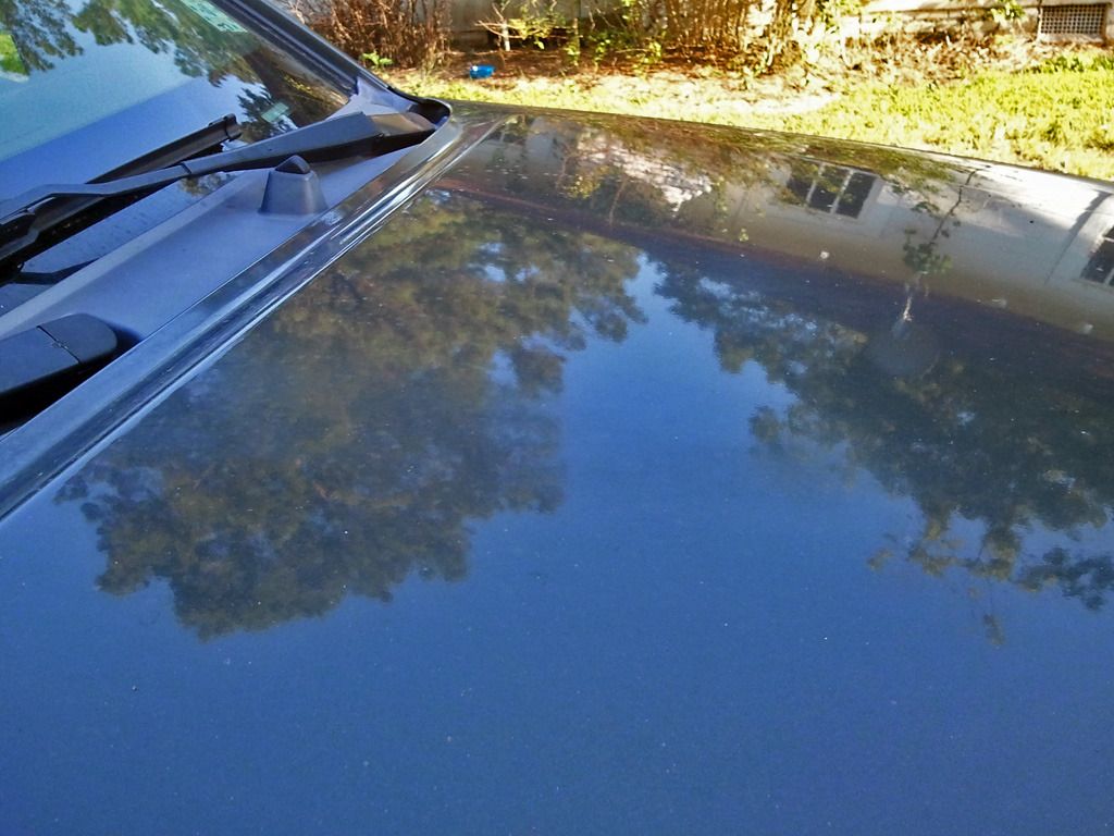

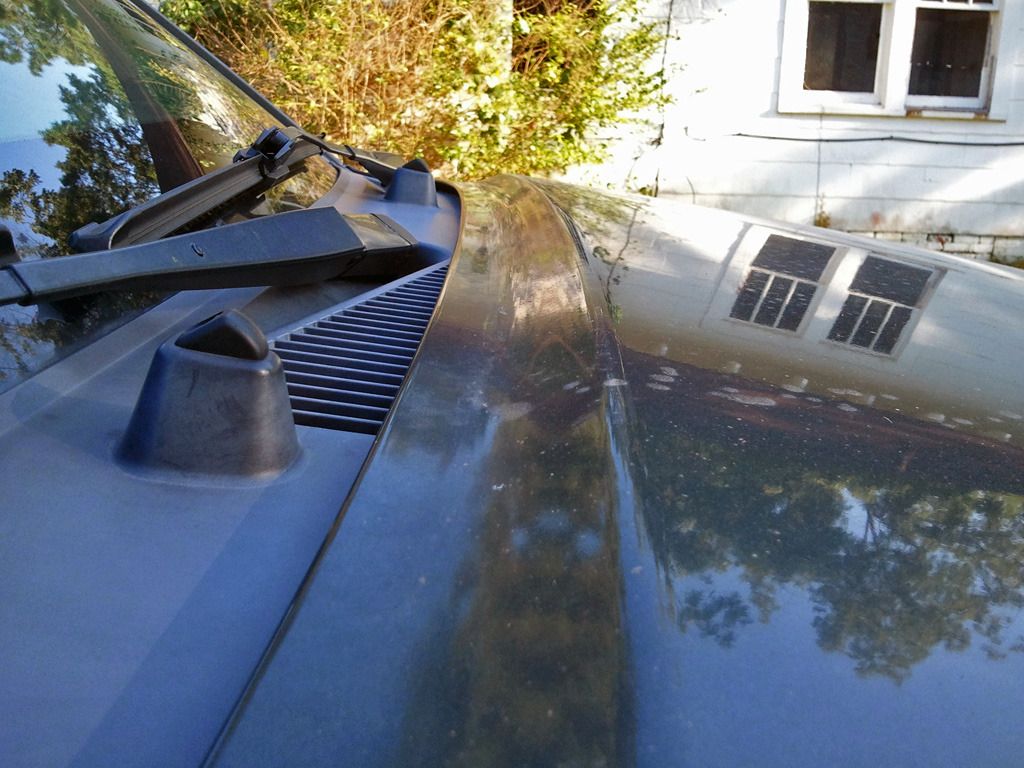

Pictures (yes, it's been a week or so since I washed it, terrible dust at work, and the blobs are from dust sticking to the windshield washer fluid since one squirter is broke and going in the wrong direction :lol:)
That looks like the start of clear coat failure. I started a thread about this last week.
The tell tale signs are it starts to look cloudy and that seems to be the case with yours.
Not much can be done about it, other than repainting.
I would try lightly polishing it and see if it clears up. It could be oxidation from a cheaper clear coat used during a repaint or it could be the beginning of clear coat failure.
