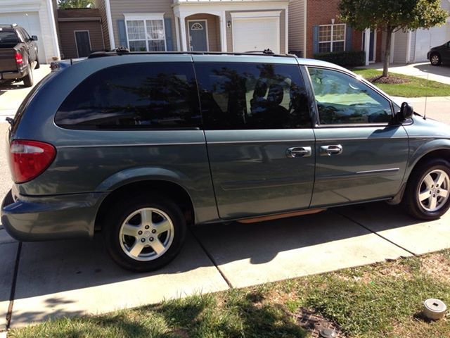

So here is my project for the next month or so:
Sexy it isn't. But if it's going to sit in my driveway you can bet it's going to at least look good. I estimate I will put roughly 30 hours into it when all is said and done. (:crazy:I should have my head examined.)
I will be working on it in small blocks as I have a very busy schedule on top of having a baby consuming my time. A minivan can be a daunting task to detail which is probably why so many are often neglected. I figure this is a good opportunity to demonstrate how breaking up the project into small pieces can make it much easier. If you have a neglected mom-mobile at home that needs some love, detail along with me and post your progress.
And so we begin:
The van was bought from someone who flips so it was overall clean. He did a reasonably good job on the interior; about what would be expected from a high volume detail shop. Cracks and crevices were missed but the carpet and seats were clean. The prior owner of the van did not have small children so it hasn't been abused as many are. I will postpone the interior detailing until it has developed a little more dirt.

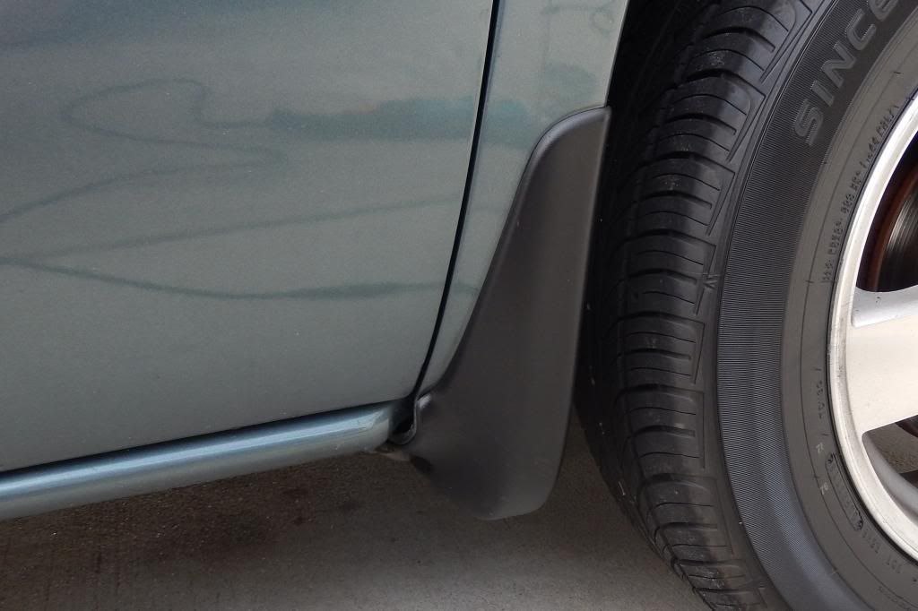

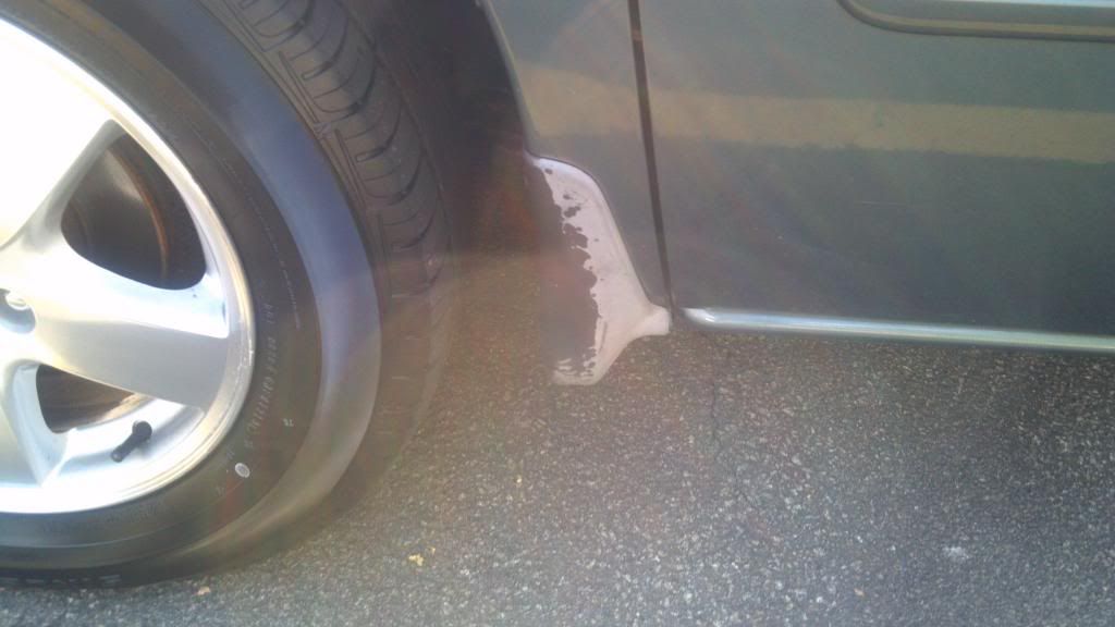

One of the first things I noticed when I looked at the vehicle the first time was the tire shine.:inspector:
I think more of it was on the mud guard than the tire.:lol2:

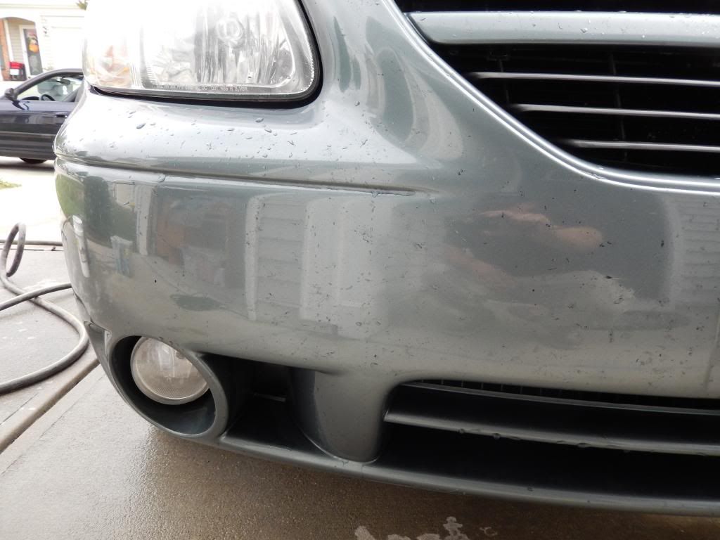

The first priority was to wash and decontaminate. As is so common with taller vehicles the top does not get washed thoroughly, if at all. The build up along the roof channels, particularly under the roof rack had heavy build up.
I began with some Optimum Power clean and a soft brush to work on the roof grime, behind the fuel door and the slung tire shine.
I then did a rinseless wash with ONR. Then IronX. Not as fun as it is on white but I think I nicked an artery on the rear.
Once that was rinsed off I clayed it using a Speedy Prep towel with my own mix of ONR and CGMS2.

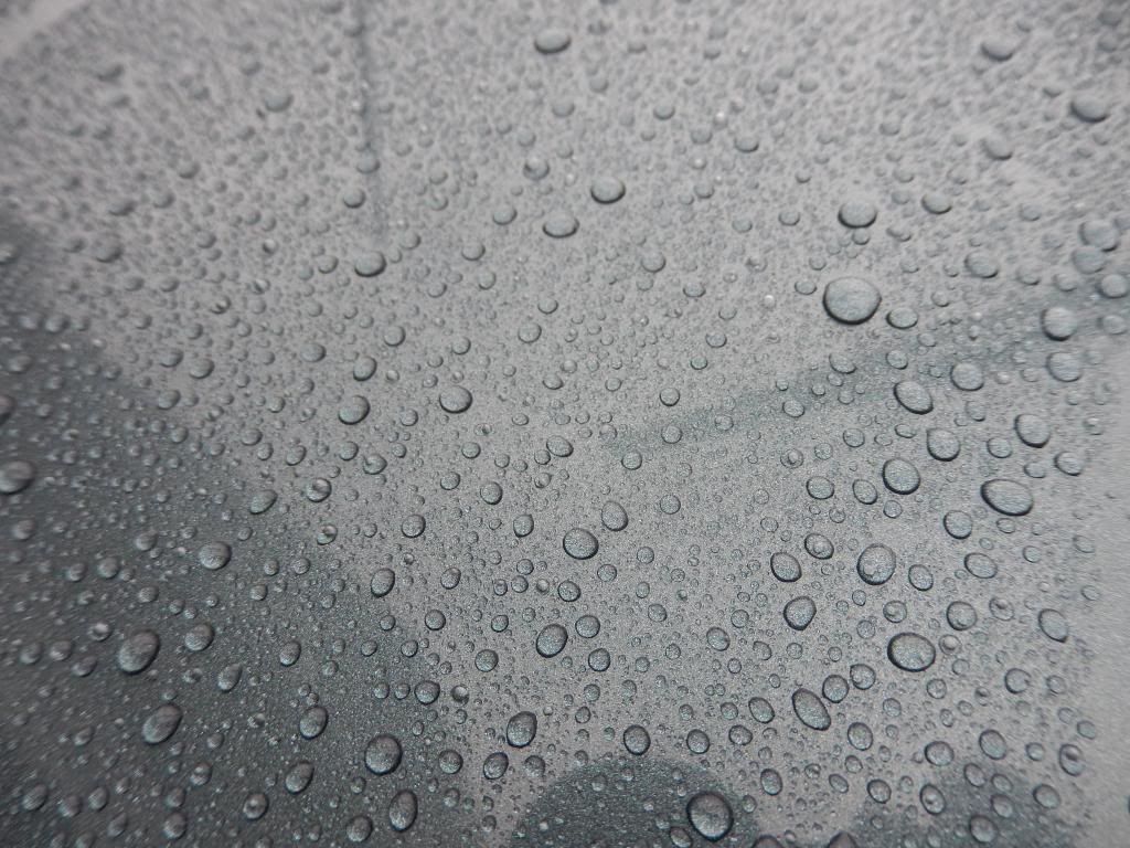

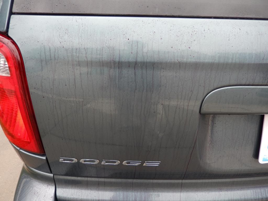

I was quickly running out of time but didn't want to leave the vehicle with no protection since I would not have any time for a few days to get back to it. I have had a 100ml sample of Hydro2 sitting around waiting to be tried. Since it was drizzling I figured; what better time?

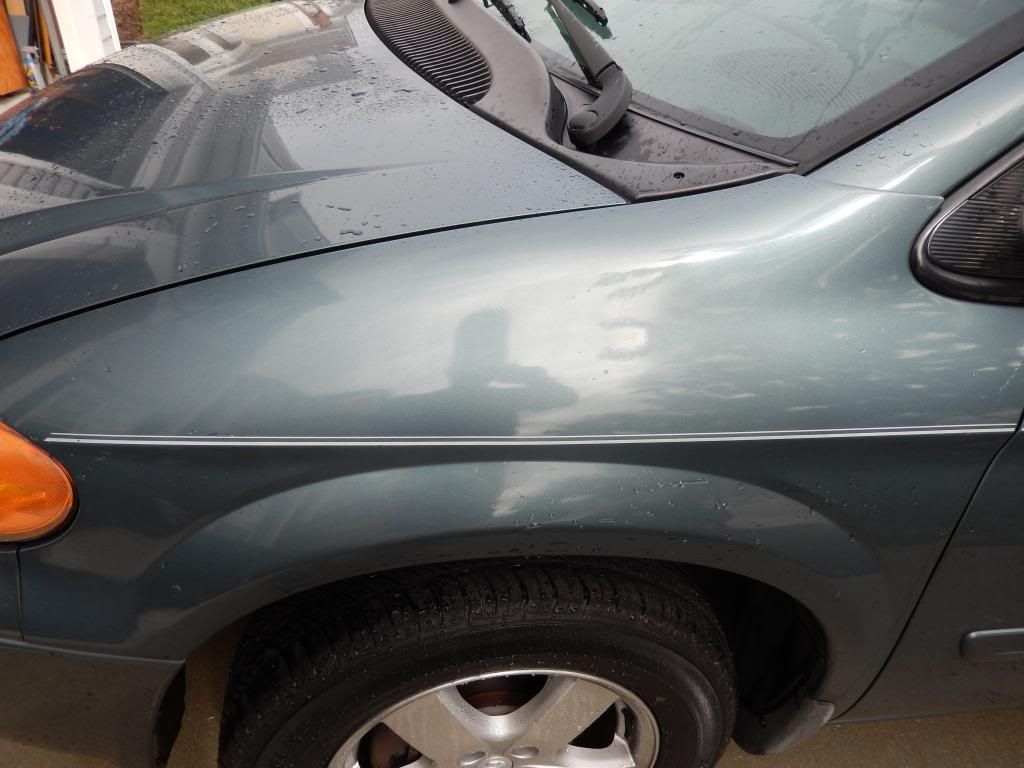

I have heard nothing but good things about Hydro2 and now I see what all the hype is about. Insanely easy to use. You can see from the photo of the roof above that there was absolutely no beading. Here is the beading after Hydro2.

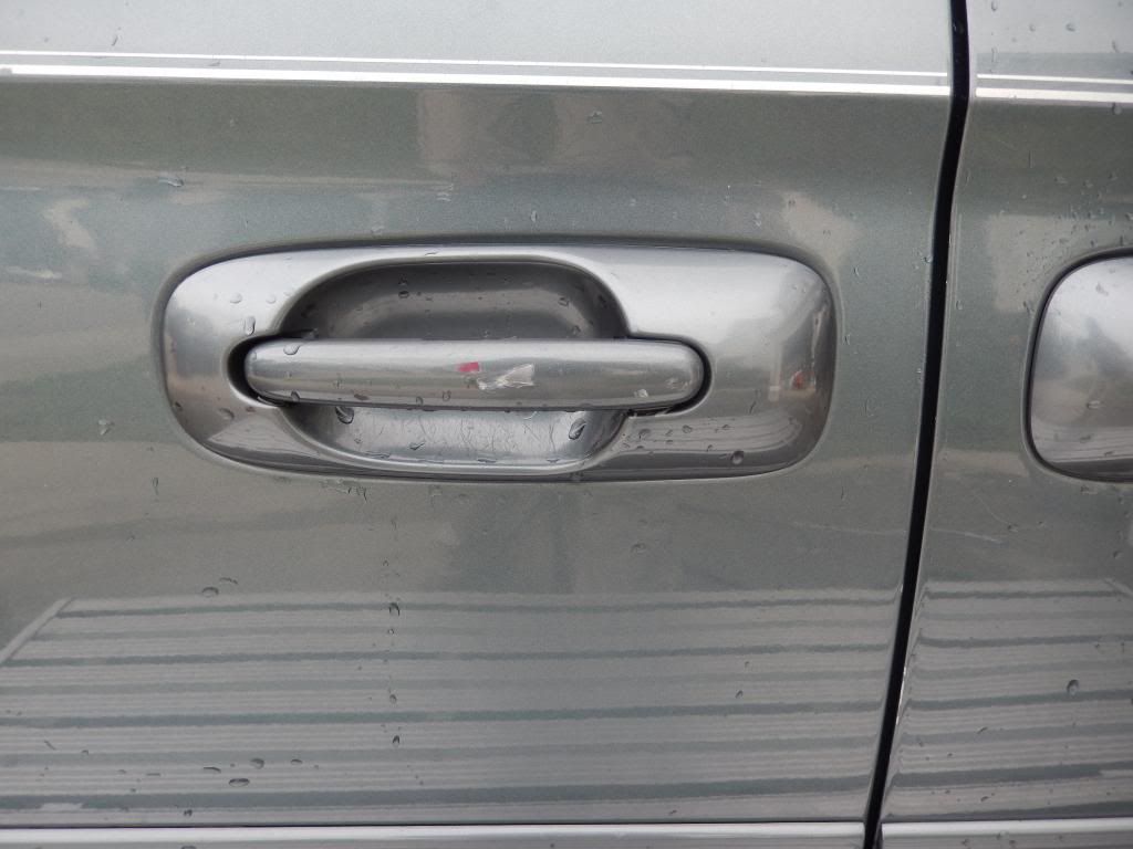

Paint transfer from doors & scratches in the door handle alcoves.

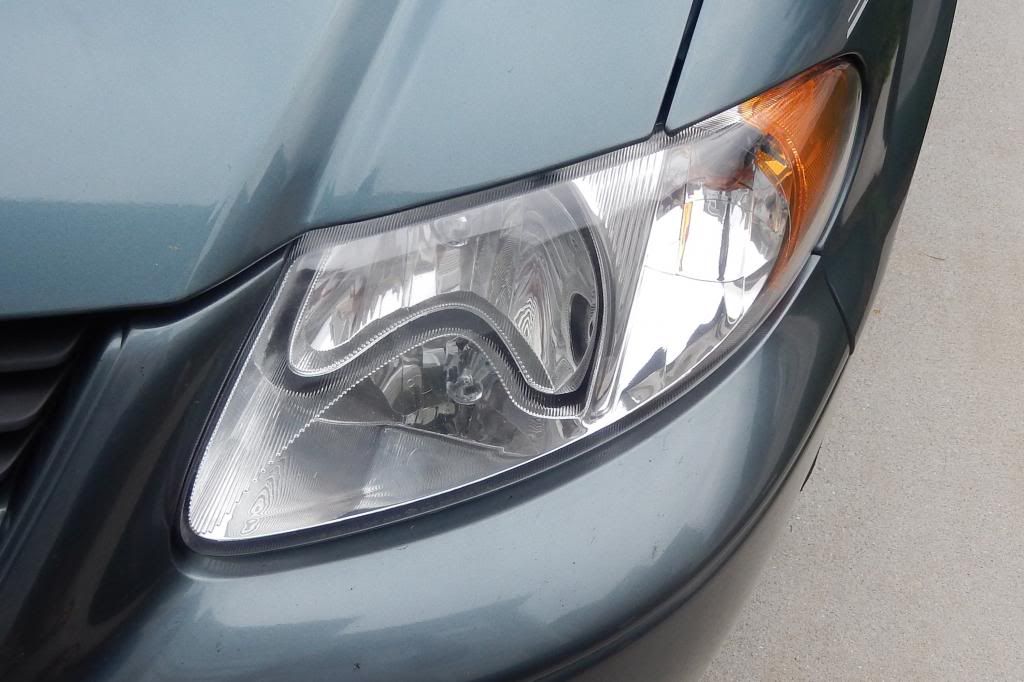

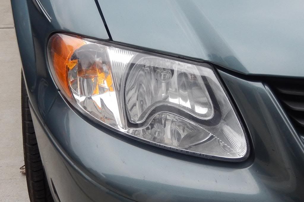

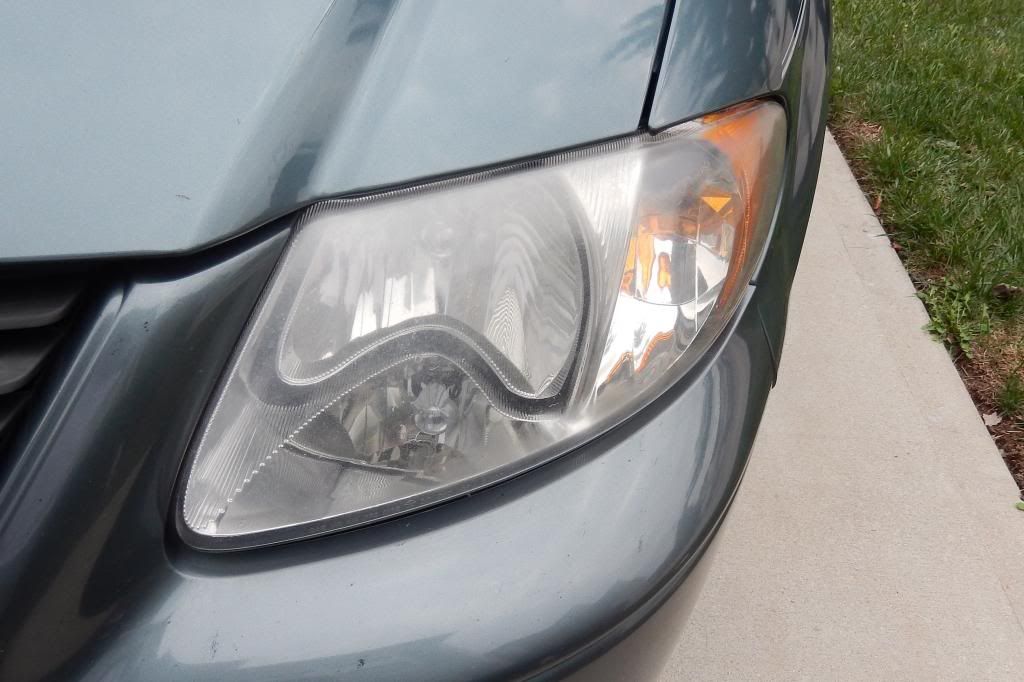

The headlights weren't horrible but there was room for improvement. These are very easy headlights to remove so it wasn't too difficult. Unfortunately the plastic had some cracking and crazing from the heat of the headlamps. The results are satisfactory. For anyone looking to have these headlights restored, I priced them online and can replace both sides for less than $100. Probably easier to replace than to restore, but since it was only my own time I didn't mind.

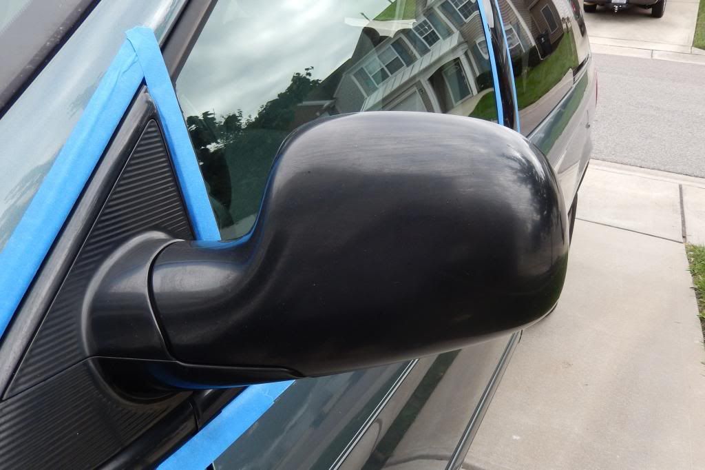

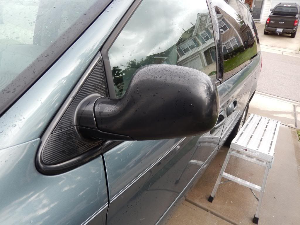

Next up was the plastic door trim, including the mirror housings.
A 50/50 after some FG400 on a 4" orange pad on a rotary. The pad was jet black after only this section due to the heavy oxidation.

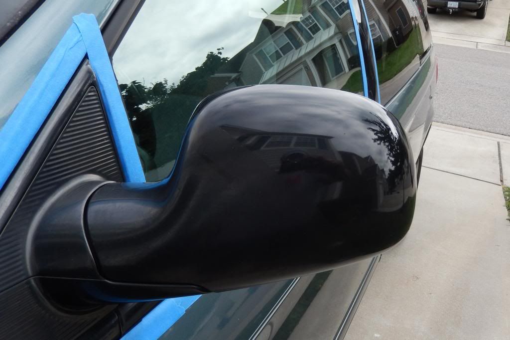

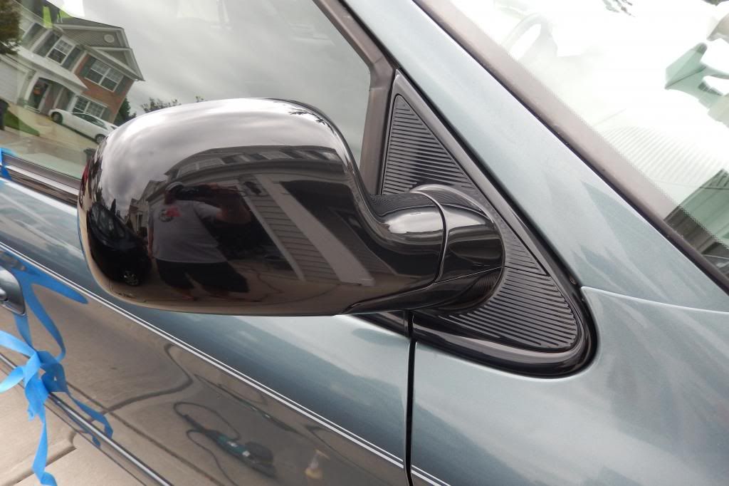

Then finished with KAIO:
And the rest of the door trim too:

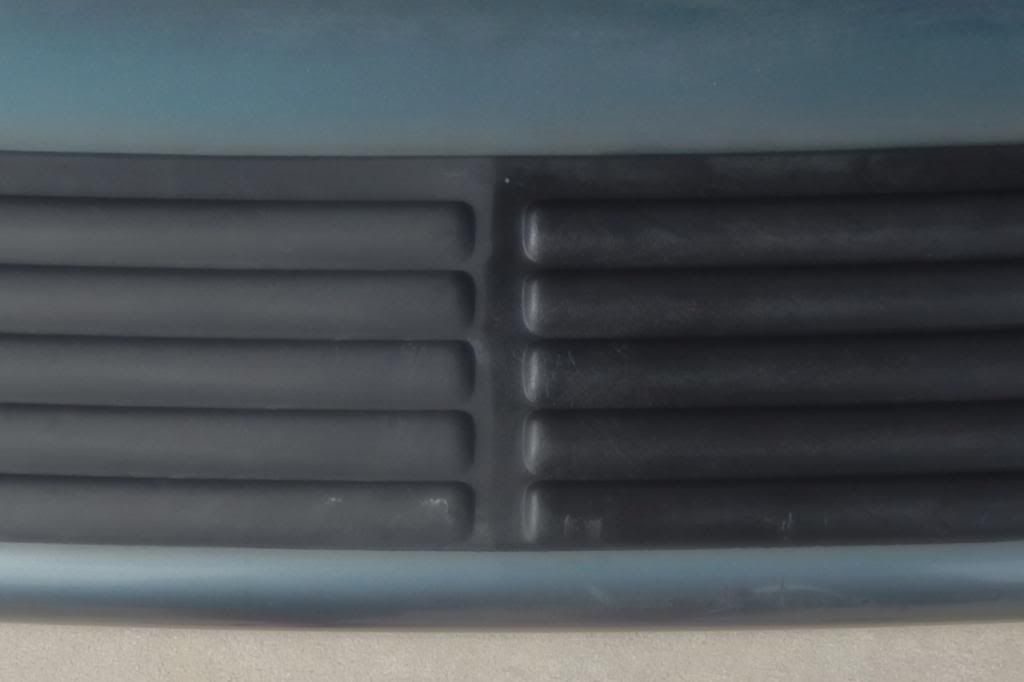

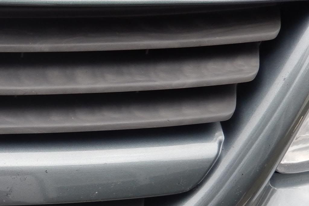

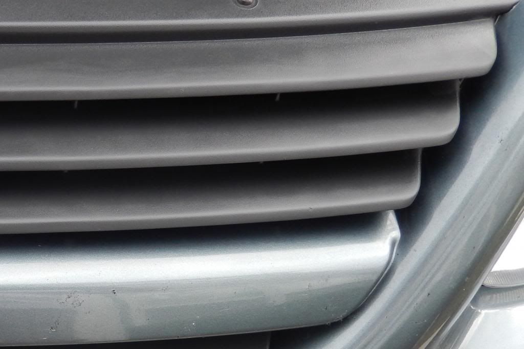

Then I restored the plastic trim. Since it is gray and not black the options for trim restore products is more limited. I went with Gtechnique C4. It is a permanent trim restorer, not a dressing. It gives a natural, new look to plastic trim and should last years, not weeks or months.
A 50/50 on the rear bumper trim. The texture has become inconsistent from years of things being dragged in and out of the cargo area.

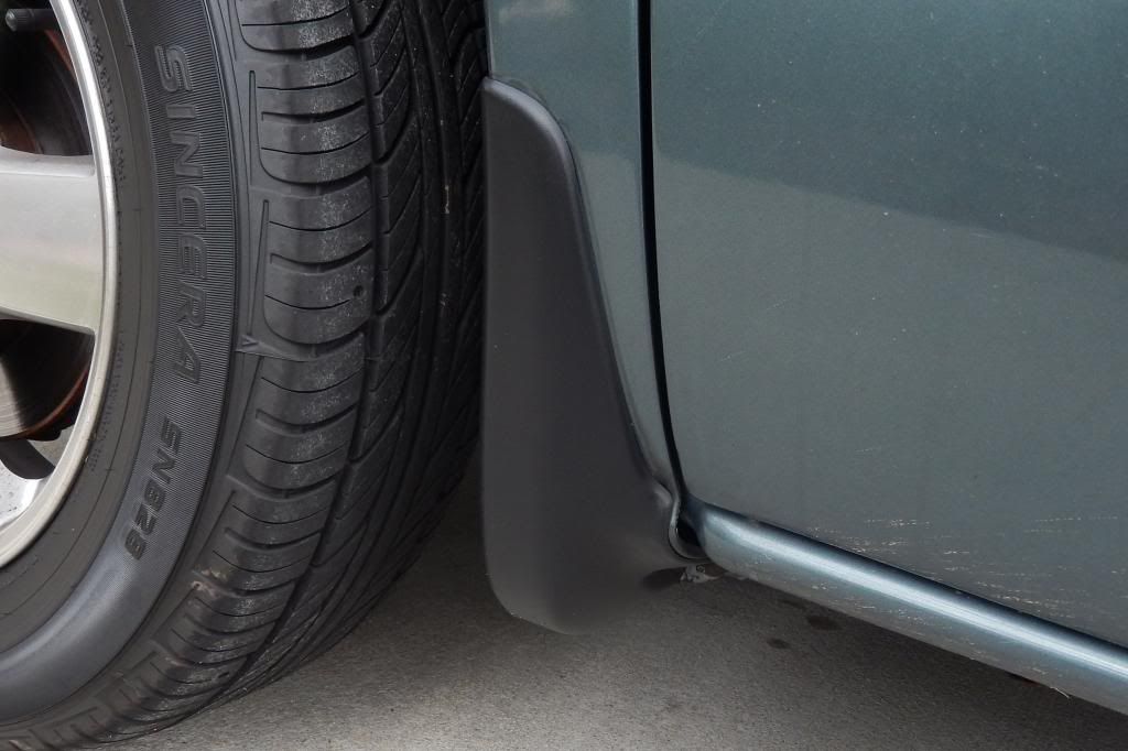

Remember those mud guards that were covered in tire shine?
