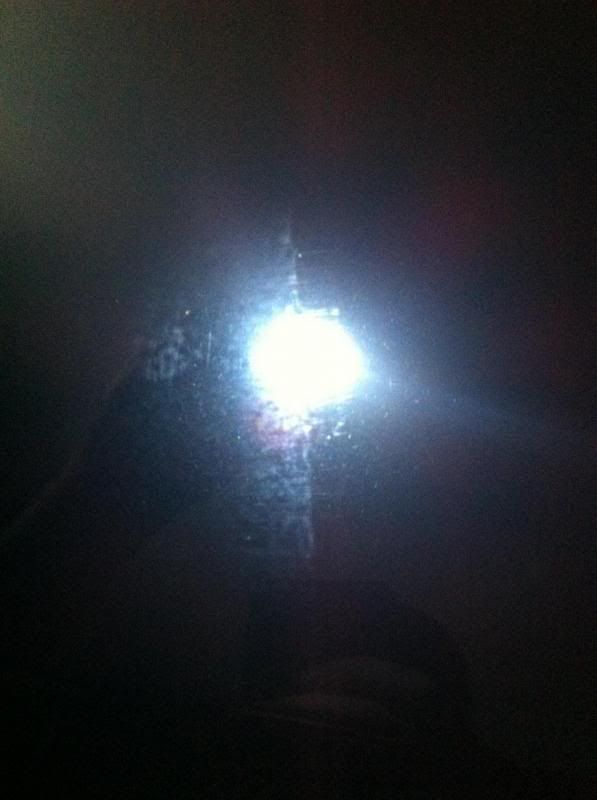

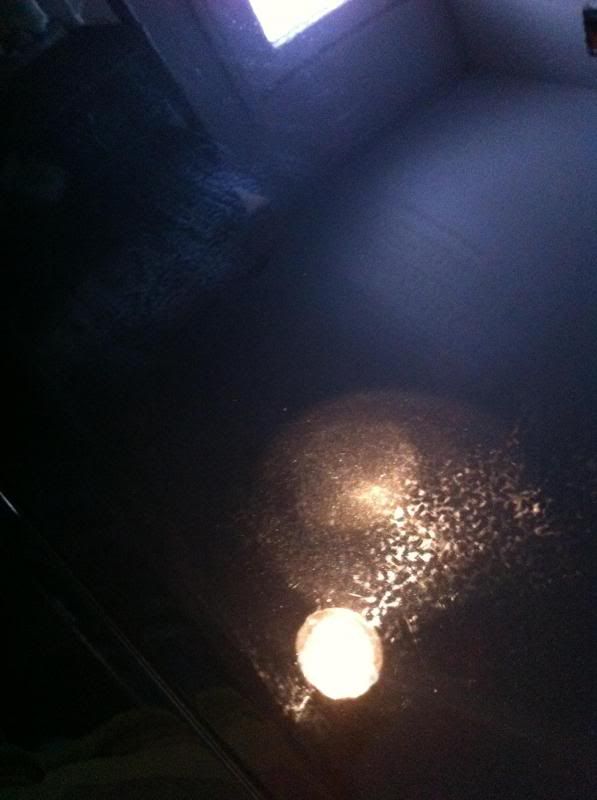

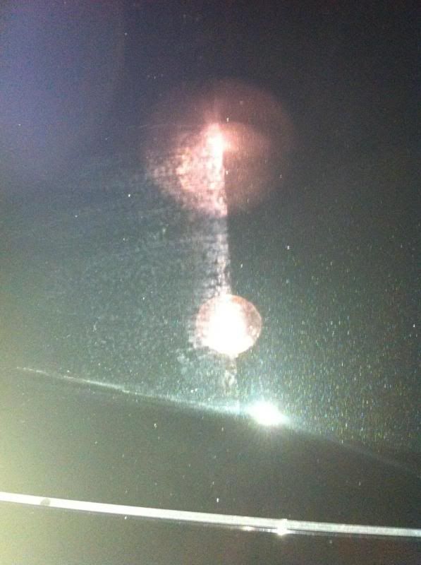

I then proceeded to clay the hood. I wiped off the clay lube and suddenly found that :
The web swirls here are kinda 'normal' cause of the snow broom but the 'marrings' around the light is quite noticeable.
Now I was very disappointed. I thought at first sight it was maybe because of my clay bar. So I used a brand new Ricardo clay on a little spot near the sunroof and it did the same thing.
The whole hood + fender are like in the pictures :(

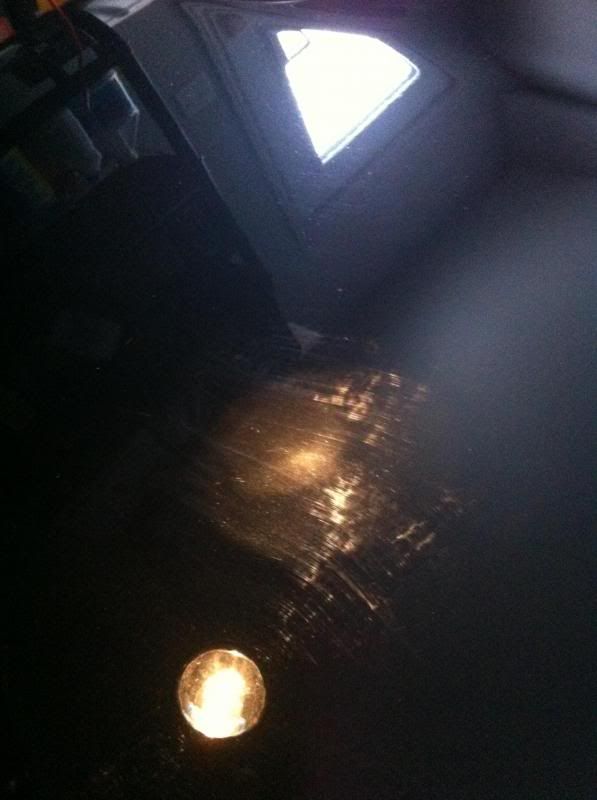

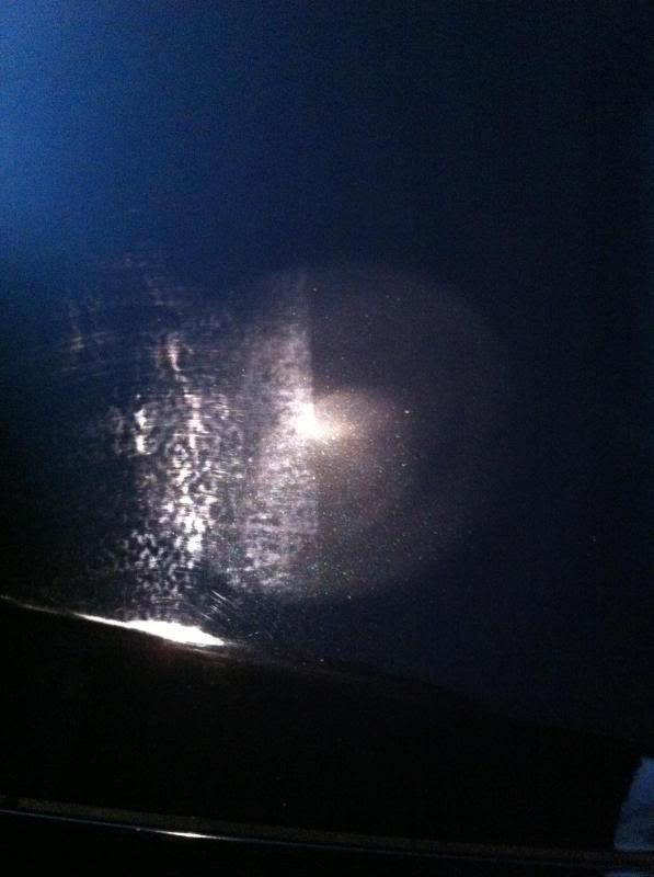

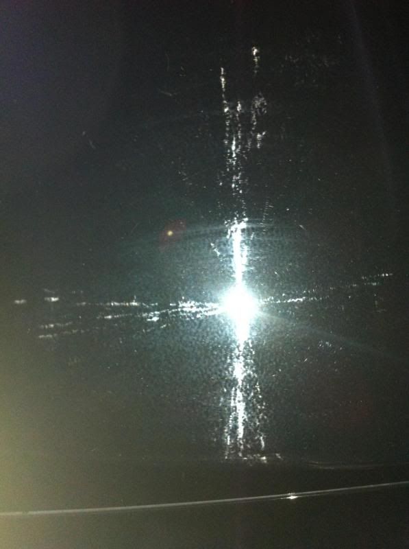

I decided to make a quick 50/50 polish spot just to see if it would be easy to polish away.
I used a PC + black pad + PO85RD (I know it's not an aggressive approach, but I just wanted to touch base).
Here are the results:
I think it turned out not that bad after that almost not abrasive at all approach.
So in the end, did my clay bar did that? I mean ... it has to be the clay bar, because after my ONR wash, those 'marrings' (can we call this marring?) were definitely not there.

Yes, that was from your claybar. Medium to aggressive clay will in fact induce marring on the paint. Even a light clay bar will mar soft paint sometimes. Don't sweat it, this is normal....we all learn this the hard way!
Yes.  Very normal on soft paint.  Could possibly be avoided or reduced by using more or better lube and a lighter touch when claying.
