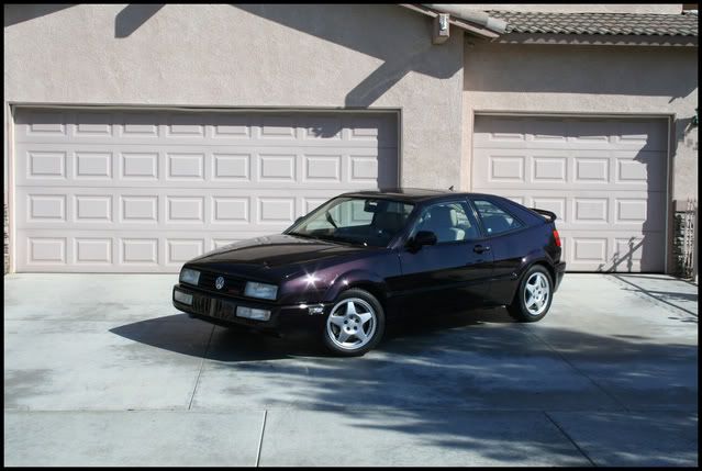

Here's the pic of the car I want to able to use a OXO mini duster on and QD it every day. :bow

Here's one of our Corrado forum moderators who recently used a UDM on his Corrado, the results are just BAMazing! Especially since he said it was pretty scratched up prior to using a UDM:
