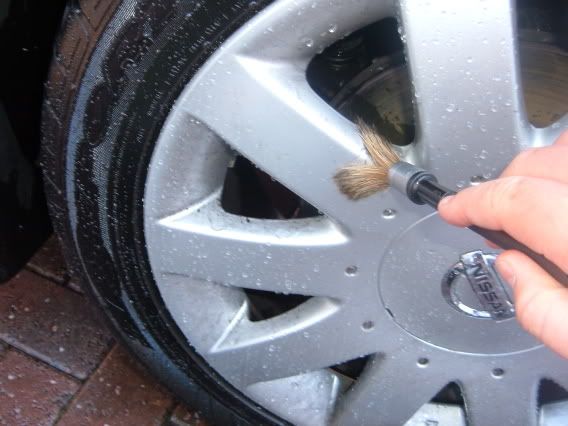

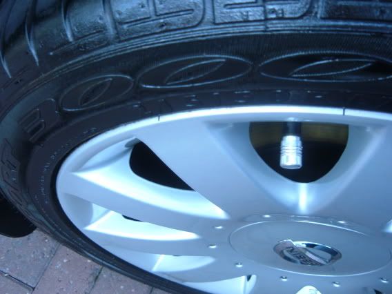

WHEELS Rinsed with Hose
Sprayed with Wonder Wheels cut 6:1
Washed, MF Mitt and Brush, Megs NXT
Rinsed, Dried With Tesco MF's
Tyre's Dressed TW Platinum Series Tyre Dressing

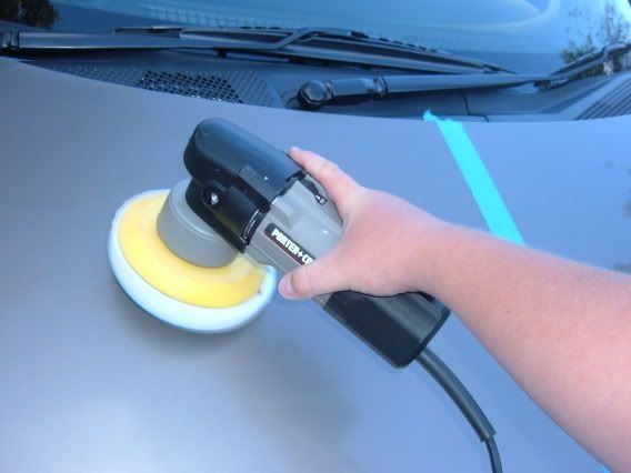

PAINTWORK: Clayed with Megs Quik Clay, QD as Lube
Coat of SSR2.5 with SFX-1 Cutting Pad (6" yellow pad)
Coat of SSR2 with SFX-1 (4" yellow pad)
Megs DC2 Polish with SFX-2 (6" white pad)
Megs #16 Wax with SFX-3 (6" Blue Pad)

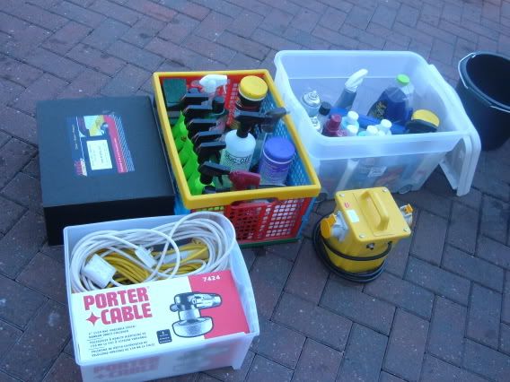

Todays Products....
Cleaning Wheels...

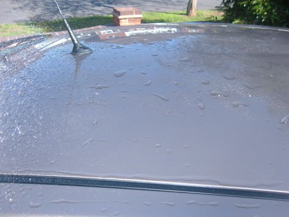

Badly Needed Waxing, Just look at the Lack Of Beading! :eek:
PC'ing The Bonnet (1 handed grip for photographic purposes only!)

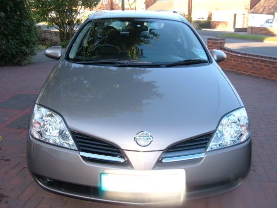

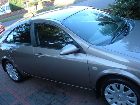

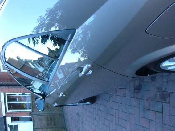

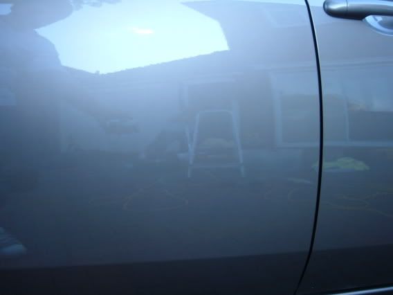

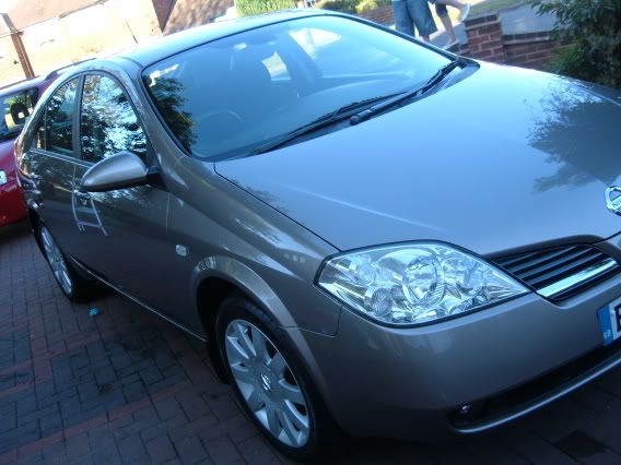

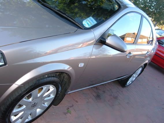

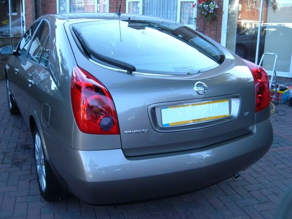

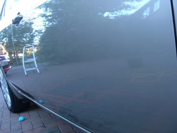

And Now.....**Drum Roll** THE AFTERS! :D
The Tree Shots... :cool:
Car looks great. Make sure you throw the cord of the PC over your shoulder so that won't scratch any cars. Other than that it looks like you have the eye of a detailer.
What are the 6 lime green colored bottles in your first picture?
I see that you said the car was "very very lightly swirled". That being said, a 3 step polish with SSR2.5, SSR2 and the Megs polish with the cutting pads seem way overkill and almost too abrasive IMO (for that car). I'm not trying to scare you or anything but there is a reason why people say to "use the least abrasive polish as you can".
