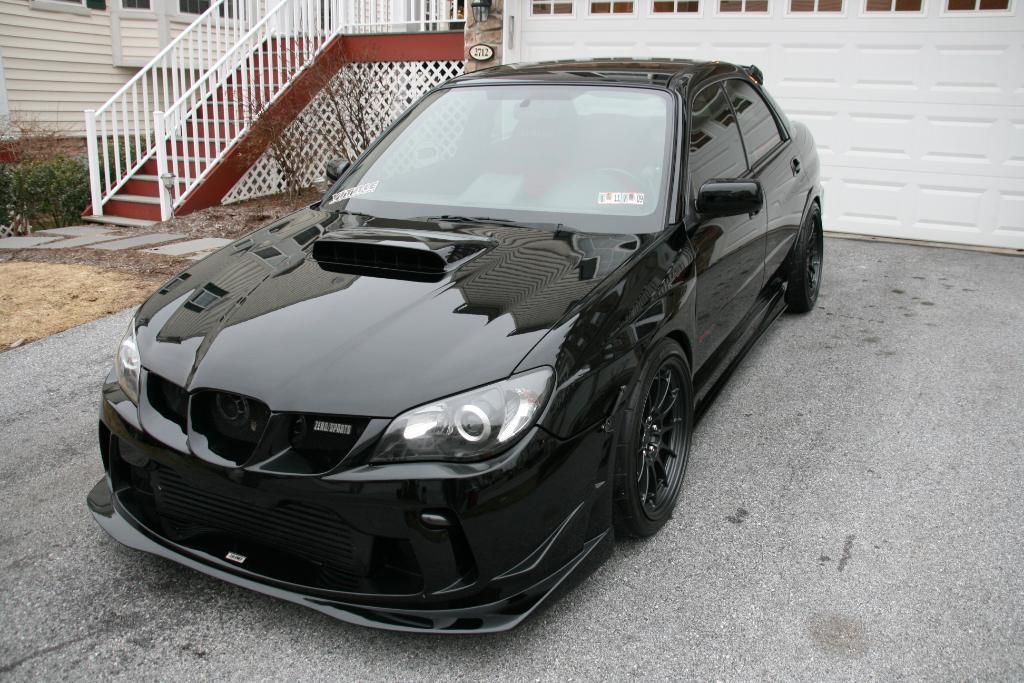

The first car is a 2006 Subaru STi, boasting a Zero/Sports body kit and a GT3076 turbo under the hood putting out 410 whp on a very conservative tune! The only downside to this car, which isn't a very big one at all, is the Subaru paint. As you can see it fell victim to many swirls and such, due to it's softness, however we were able to fix that.

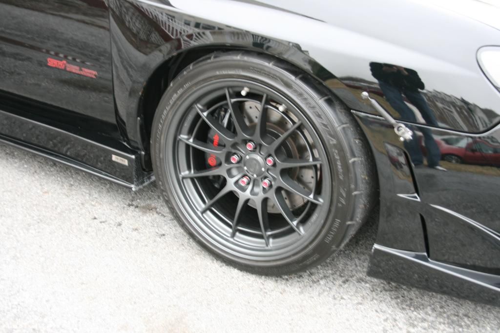

Starting it off with the STi:

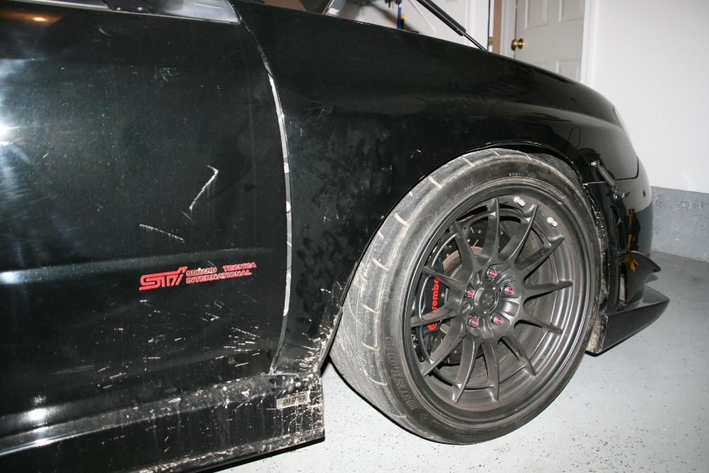

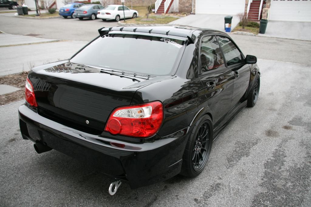

The car as it arrived:

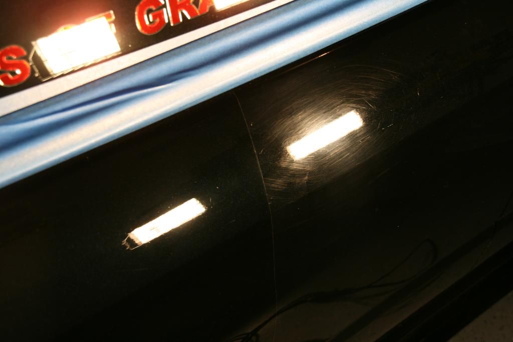

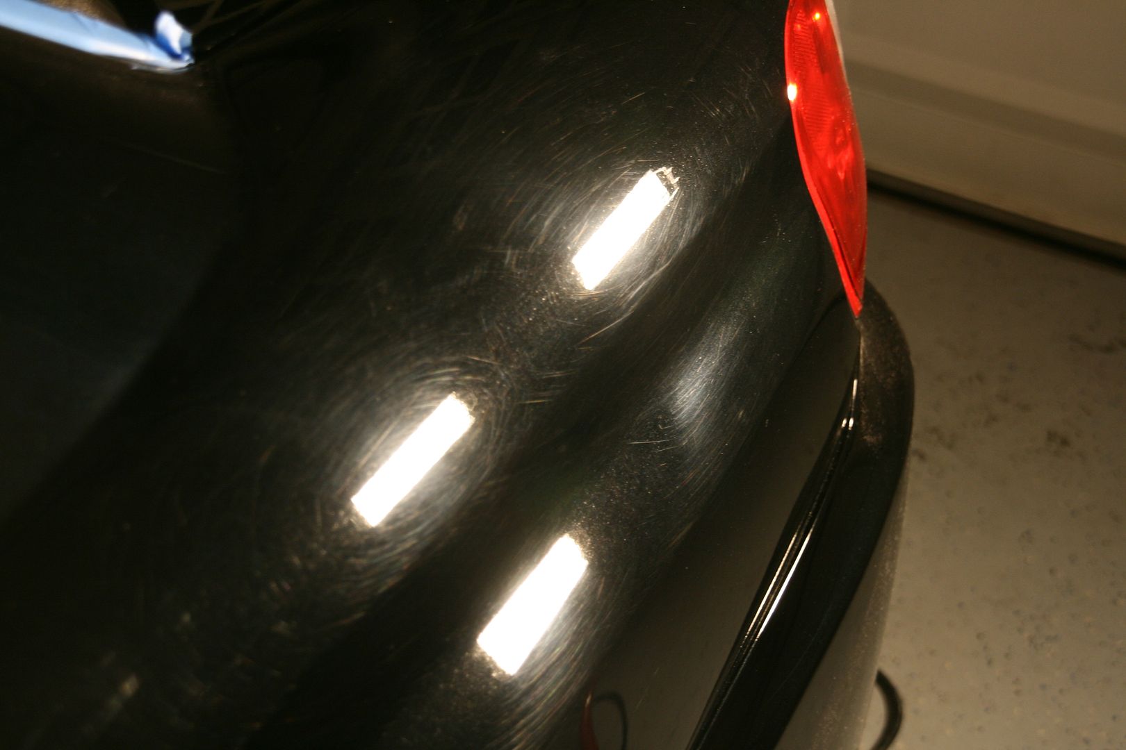

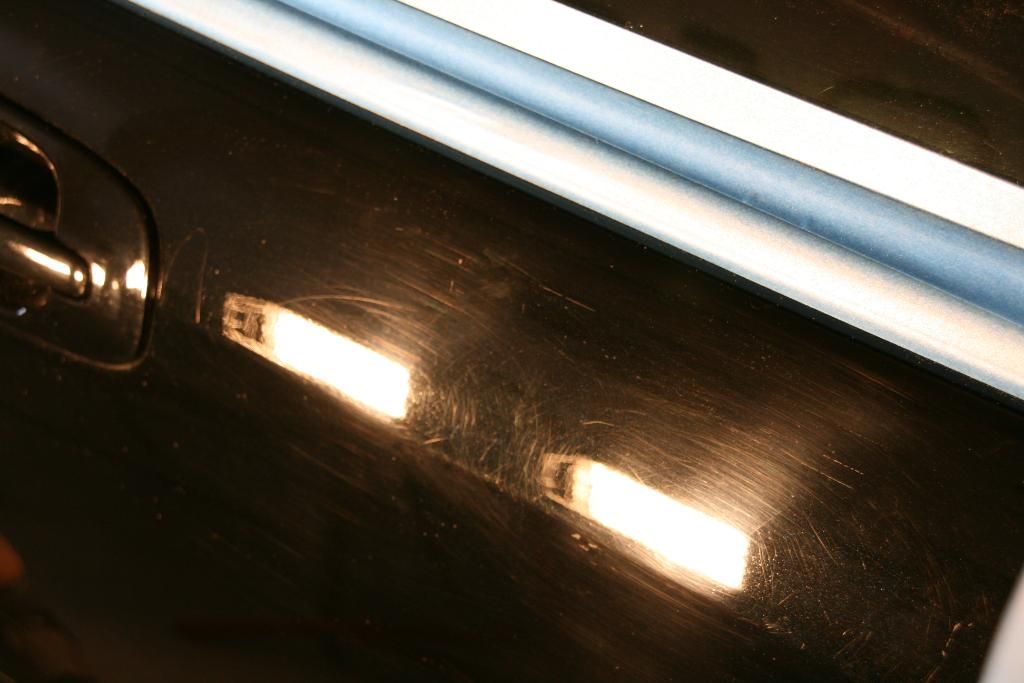

The paint was then inspected after a full degreasing wash/prep, the healthiest readings were 103-105 throughout.

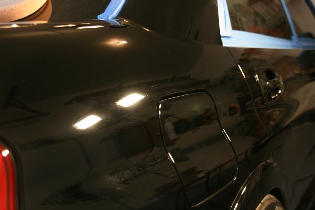

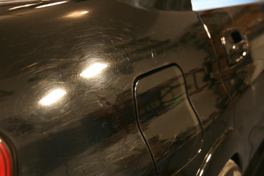

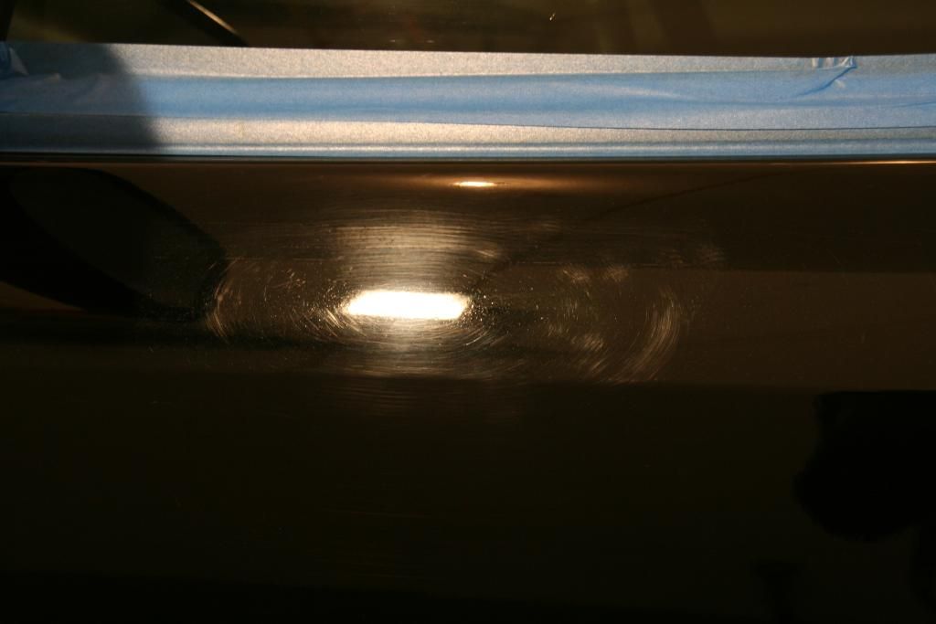

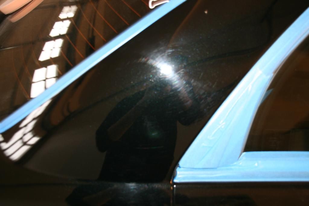

Here are some before/after shots of the paint correction in a few places
Rear C-Pillar
Rear Quarter Panel

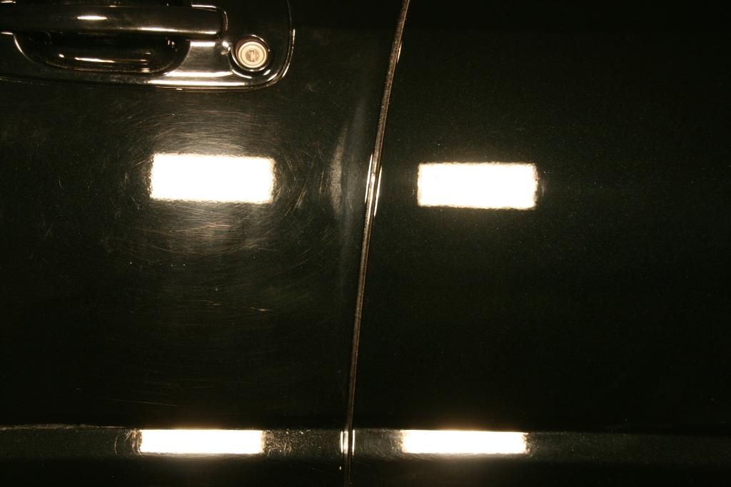

Now for the 50/50 shots, to show the real differences throughout the correction process

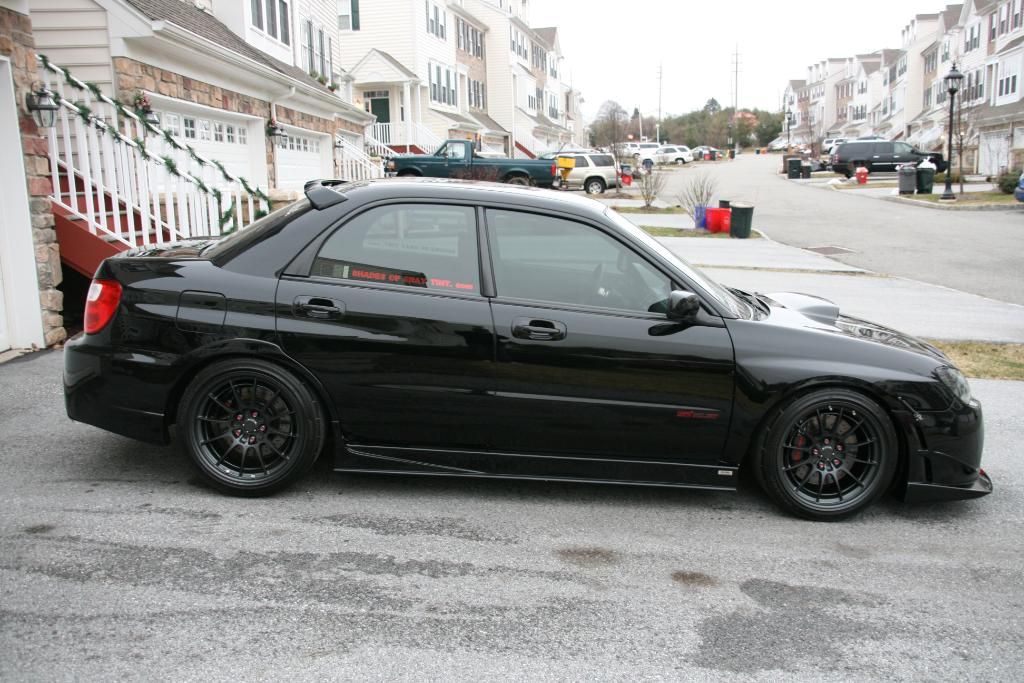

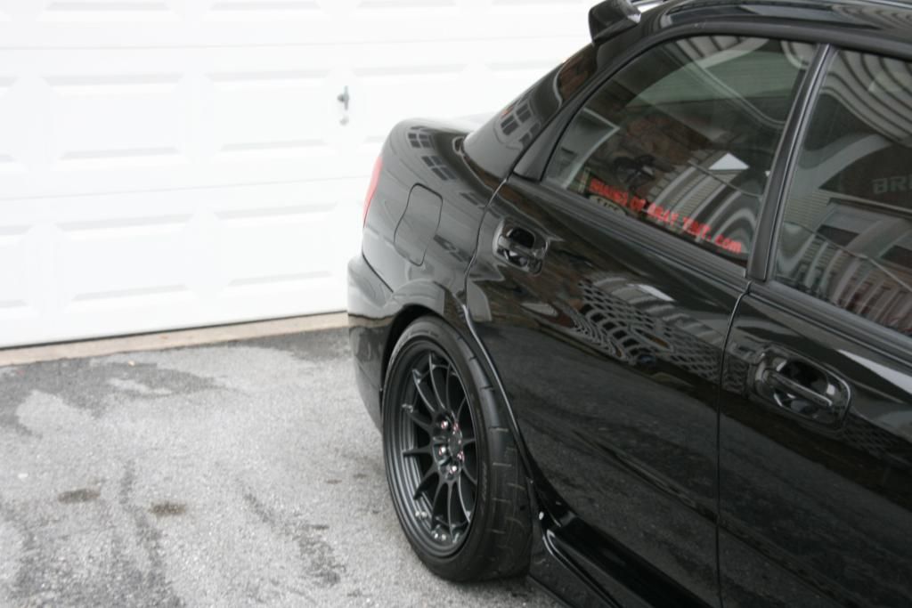

Managed to grab a few reflection photos before the trailer arrived

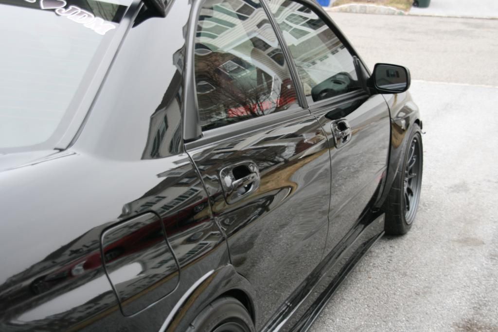

Finished vehicle photos

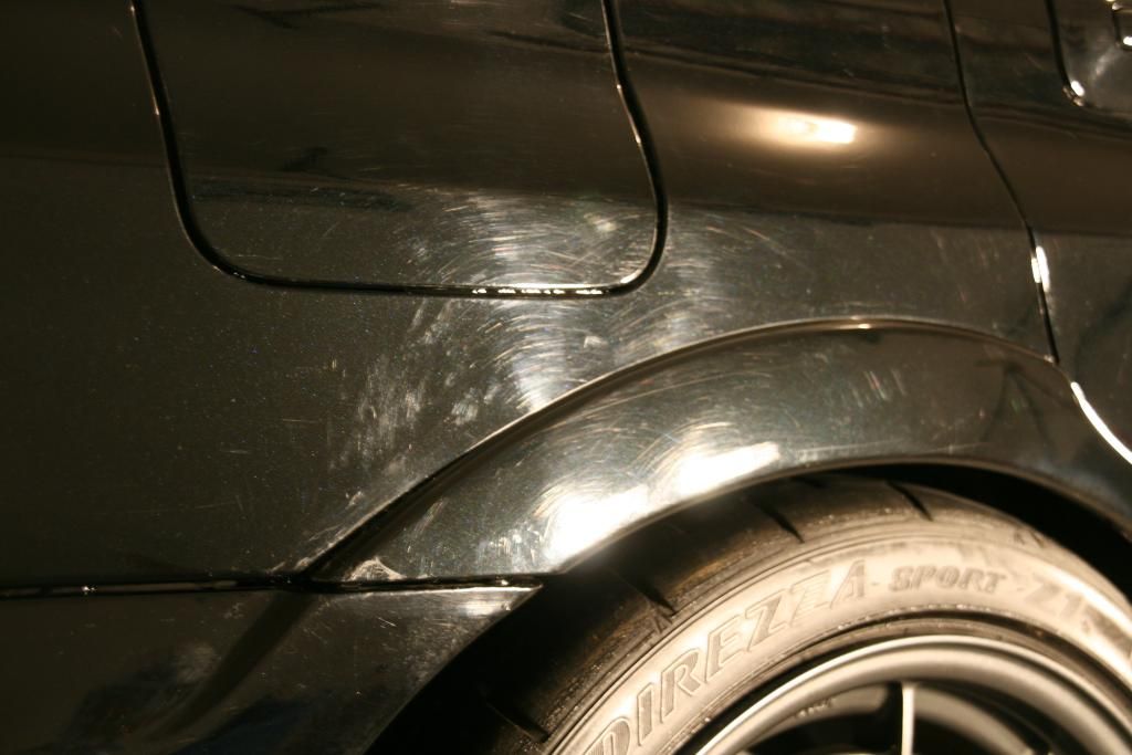

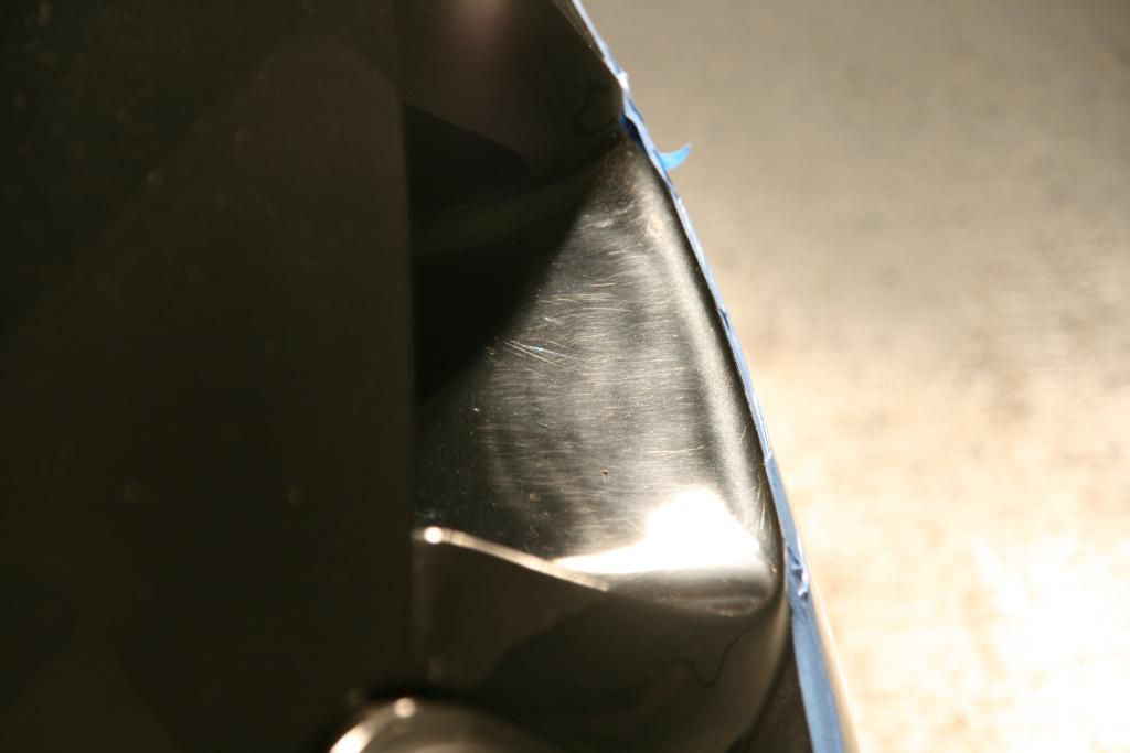

Paint shots before correction

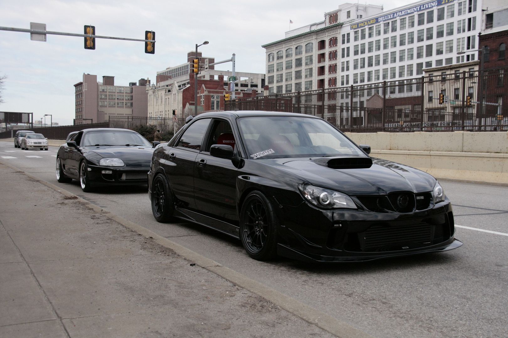

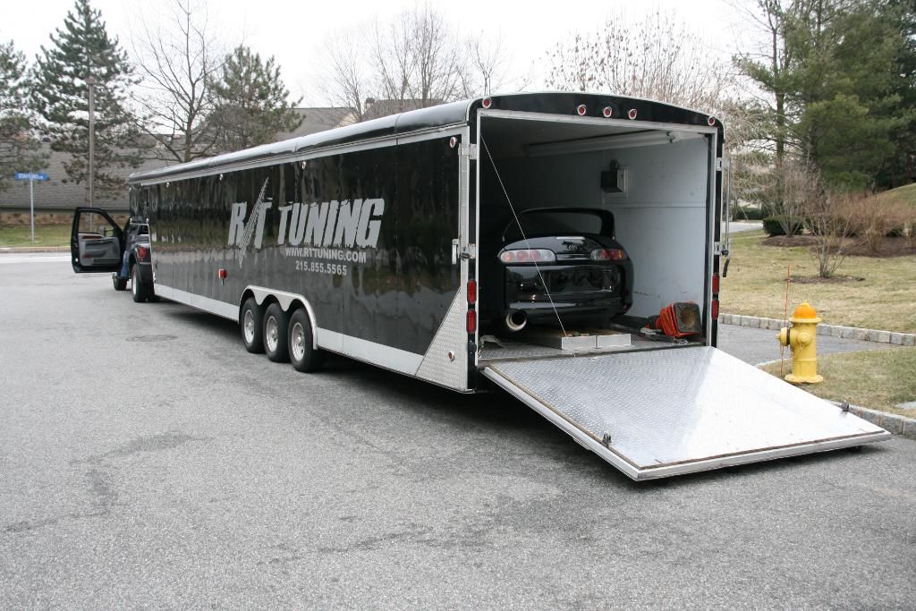

Here are the cars on the trailer, thanks to these guys they got to the show just as clean as they left!
Here they are, shortly after being unloaded by the Convention Center
