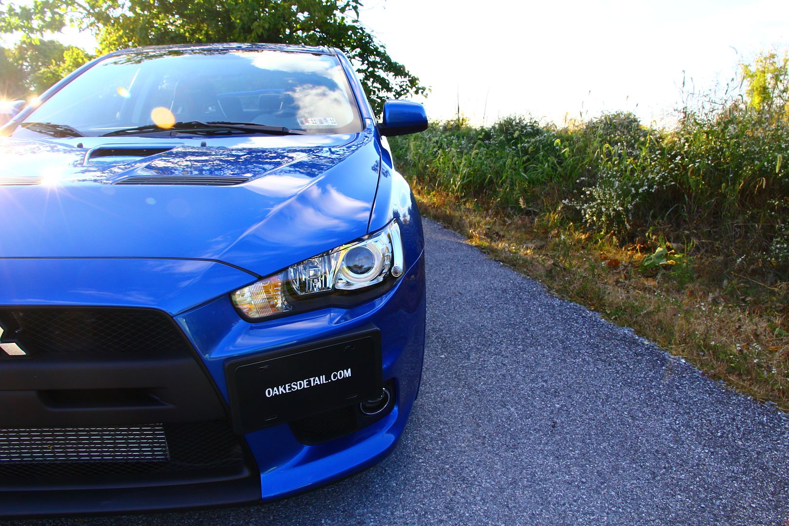

even though car only had 2100 miles, looks like dealer did wash it and left scratches all over. Paint readings were taken and were in 80-106 range. Even though compounding would not be recommended probably but without it car would not turn out like that. Car was compounded with Megs M106 and purple wool pad on PC, readings stayed the same after compounding, after compounding followed up with Menzerna 106 and white pad, thanks to M105 having great finish, medium polish is often not needed. The car will be getting a coat of CQuartz and front end will be wrapped with clear bra within a month.
Onto the pics
After finishing polish and IPA wipedown
Finished pictures
HDR pic
