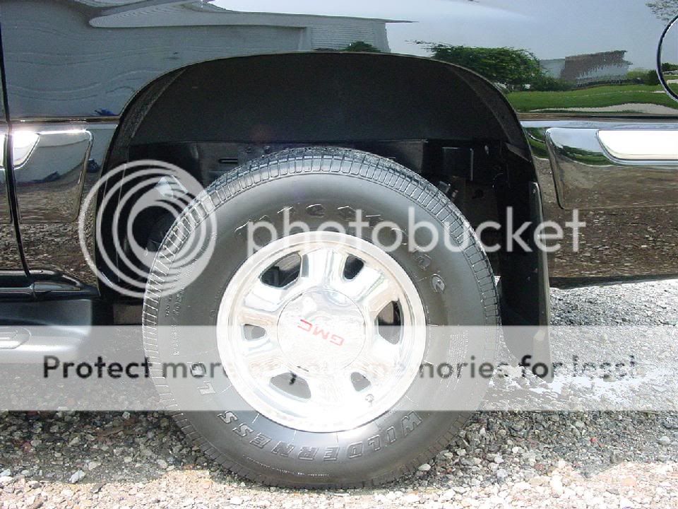

-Armor All on wheel wells and tires
-Gliptone Probuff on all chrome trim, lights, and rims

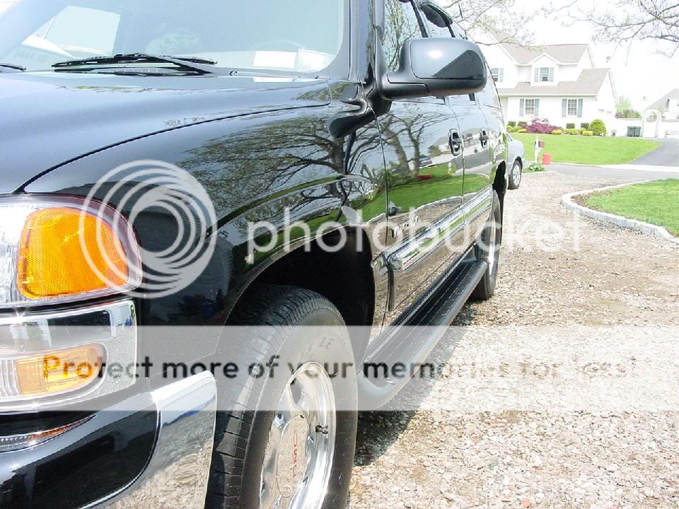

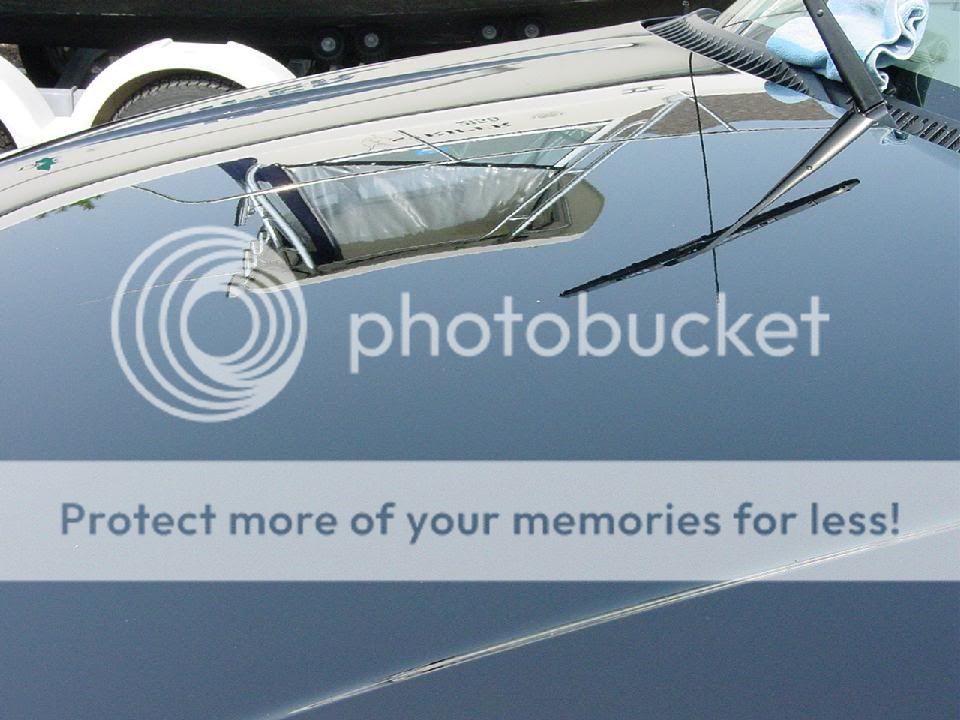

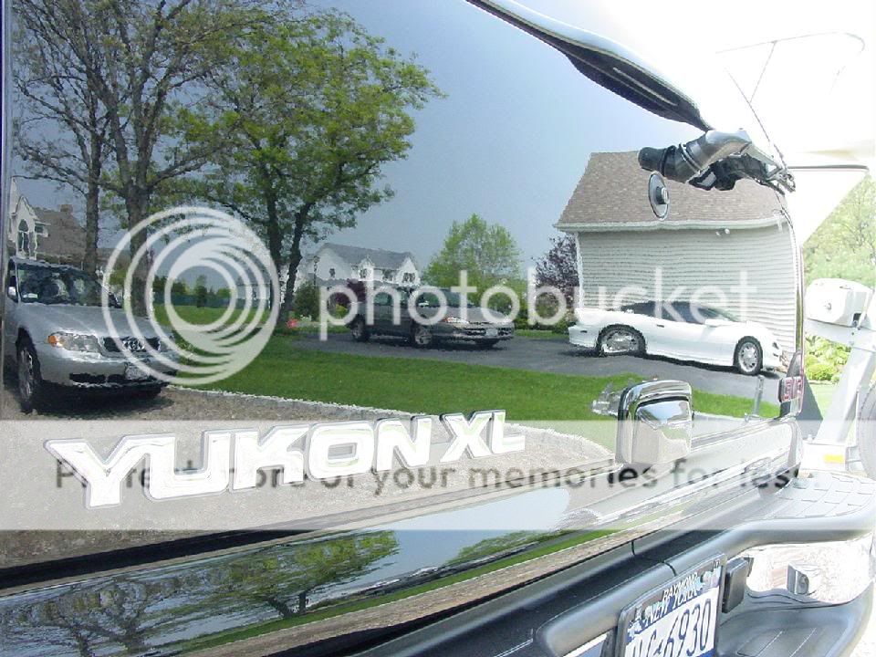

First, here is the paint before. Remember, just washed and dryed.
This is right after removing NXT via Rotary :shocked

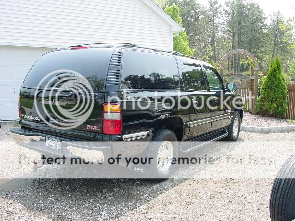

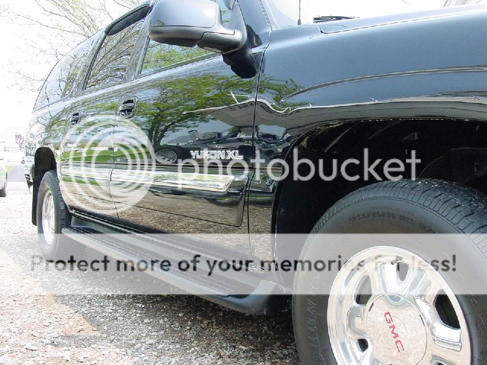

More After Shots
Enjoy!

Great shine. Damn GM orange peel. It does make some of the photo's look like artwork however.
<RANT ON>Why do most GM cars always have this? You would think that they could figure out how to paint a vehicle. They have been doing this for a few years now and you would think they could perfect this process. <RANT OFF>
