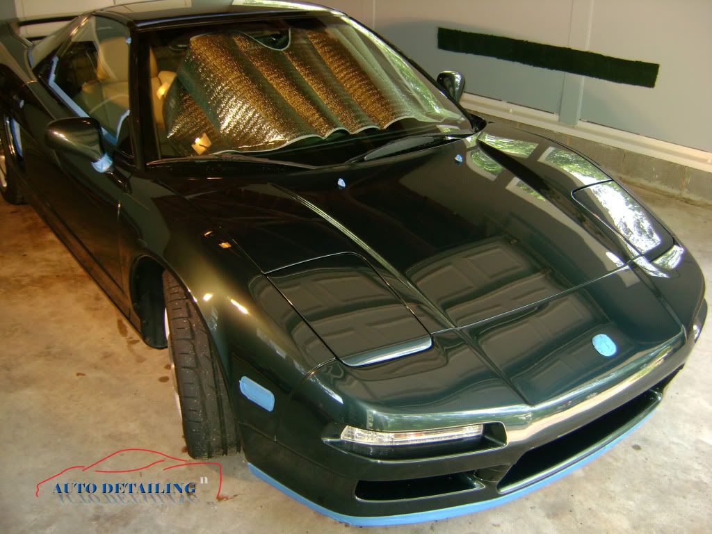

A low mileage, well maintained garage queen. The paint had some correction done in the past, probably multiple times. Swirls were very light and minimal RIDS existed. The goal was to achieve the deepest possible gloss while being careful, as I was uncertain how much clear coat had been removed in previous details.

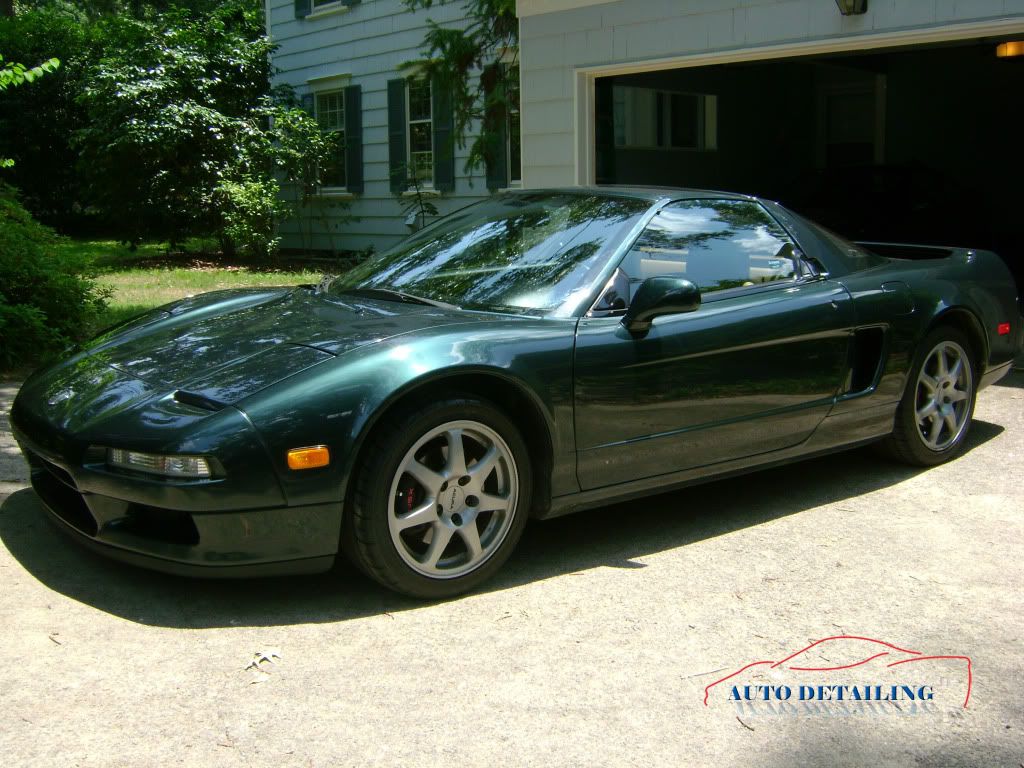

The car in its starting condition:
Only so much can be seen in a photo, and even a close inspection didn’t reveal much.

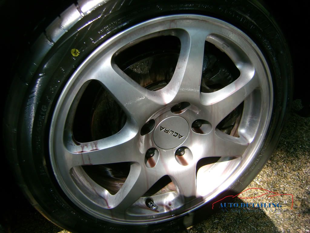

So we move straight onto the wash. I started with the wheels useing Sonax all wheel cleaner.

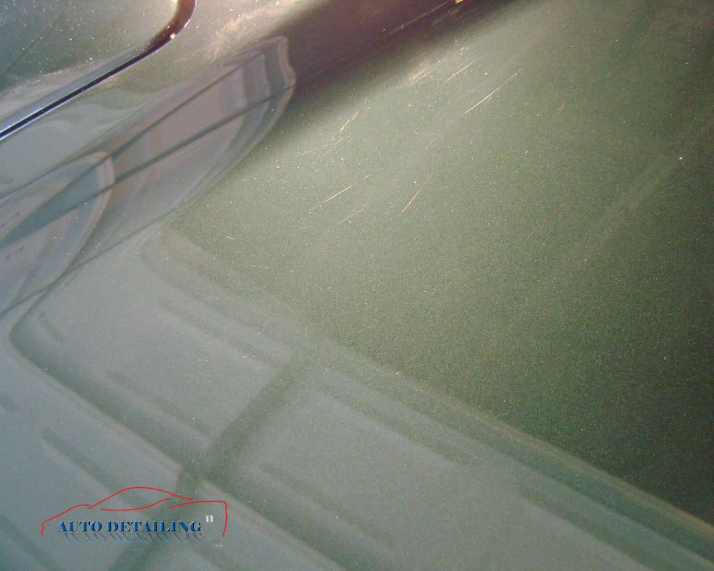

A rather crisp reflection and the flaws are not picked up by the camara. (A good sign.)

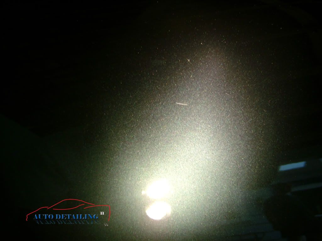

Further inspection with a Xenon light shows one of the RIDS that will ultimately remain, as it was too deep to safely remove.

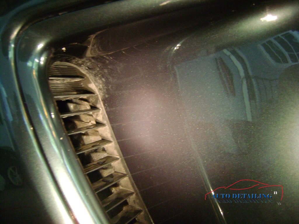

A few RIDS on the hood show that some significant correction was needed in areas.
50/50 during correction. The metallic color made photographing difficult.

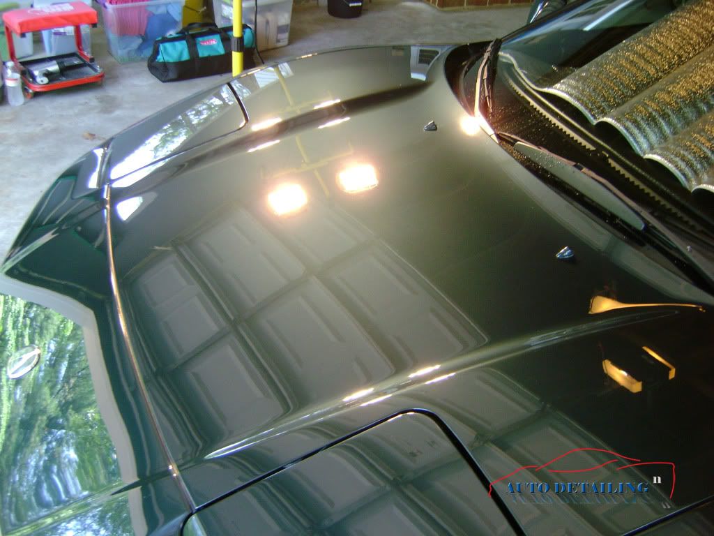

The car was polished, then given another IPA wipe down to remove any oils left by the polish.
After polishing with Menzerna 85rd:

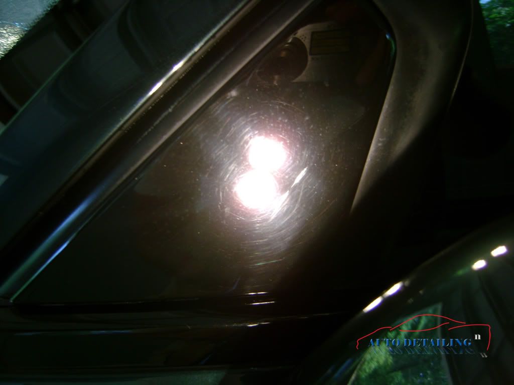

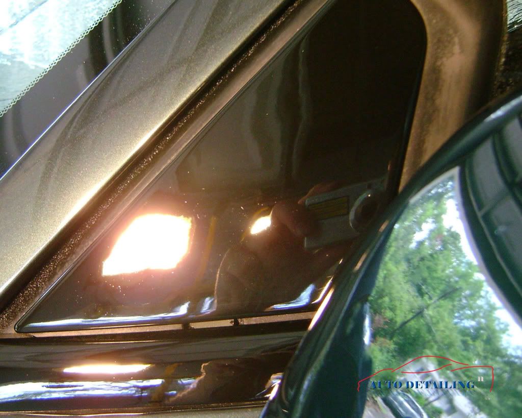

The taillights were also polished using the same process with 4” pads. Doesn’t photograph well, but marring on these lights stands out against the highly polished paint.
The hard, black, plastic trim on the door and door handles were also polished in the same manner. Sorry for the use of different lighting. But the results are evident.
