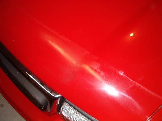

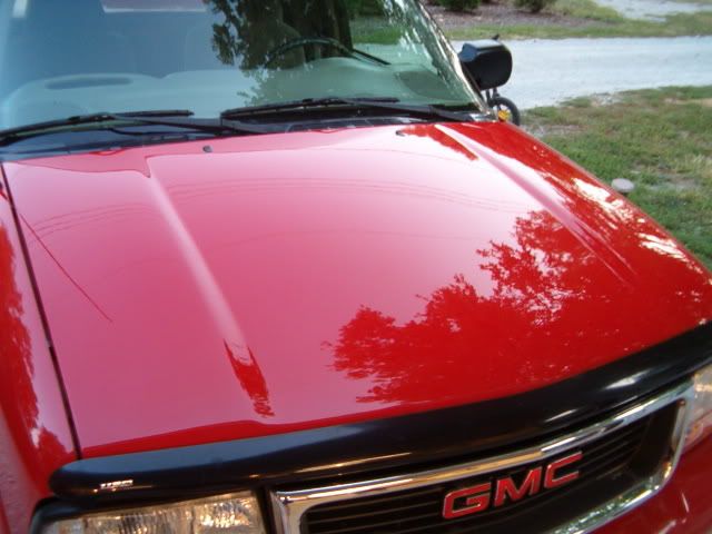

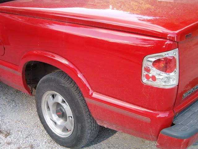

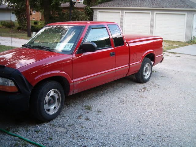

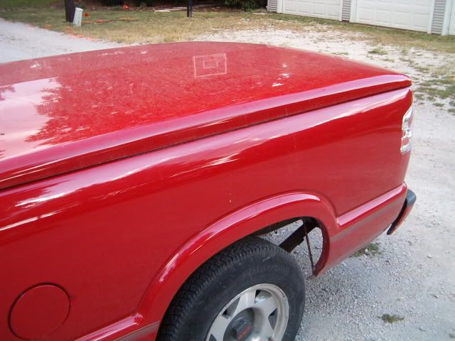

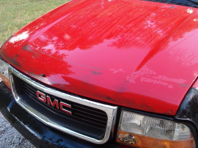

Got this thing and talked the owner into leaving the HIDEOUS bra off this thing, they have NO idea what a bra does to a finish.
Had to wetsand the hood for two hours to get the marks our, then buff and polish. Red is so eye popping when its clean
when it got dropped off...

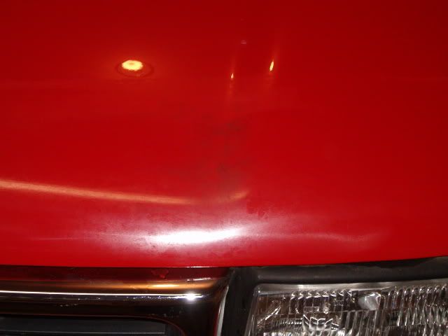

what lies beneath the bra

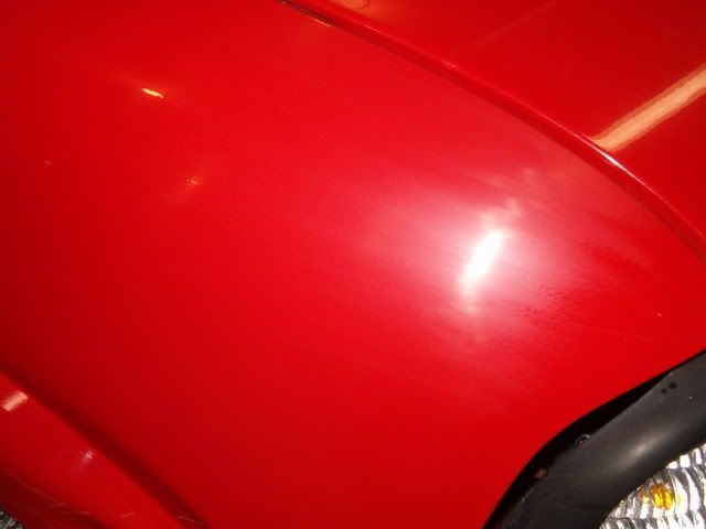

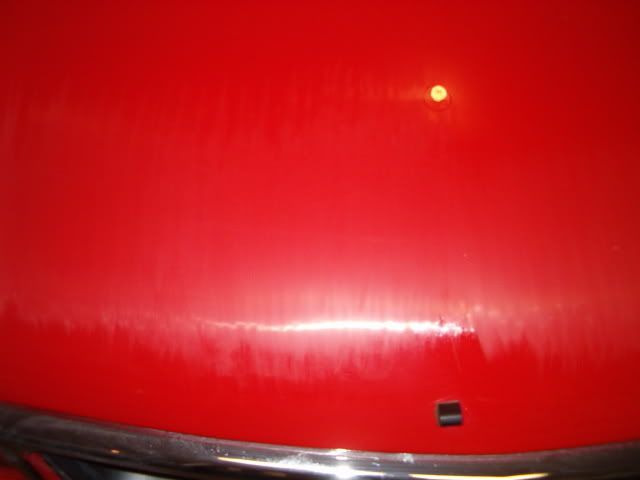

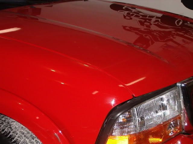

during wetsanding

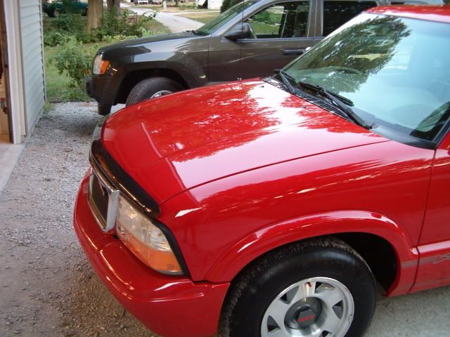

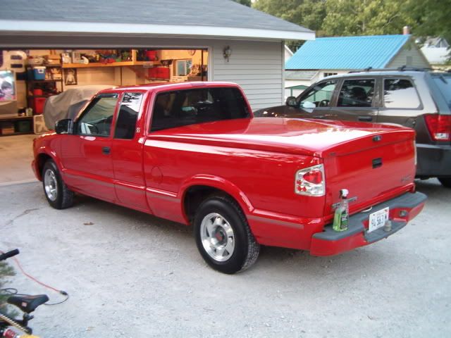

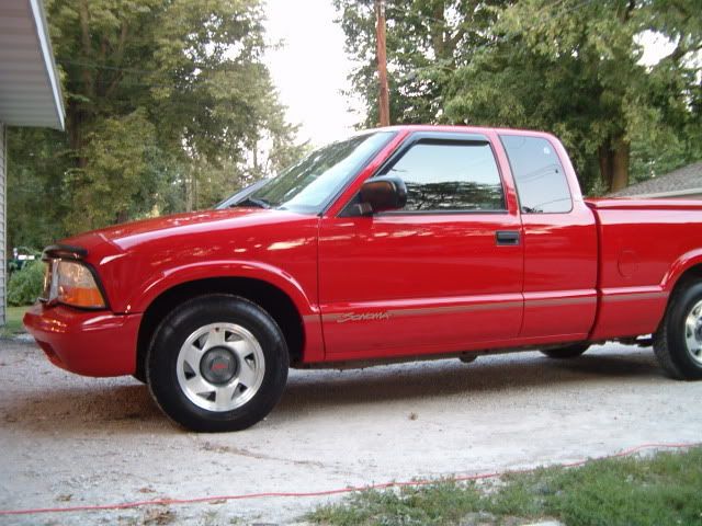

Afters:
Never understood the idea of those bras either. Aren't they suppose to protect the paint, not destroy it? I rather have a few paint chips than that kind of damage. Or a clear bra.
Great work,yeah the bras do more harm than good when left on for any length of time.Dirt/grit works it's way underneath,and when combined with vibration/movement from driving,the paint gets slowly abraded away.
