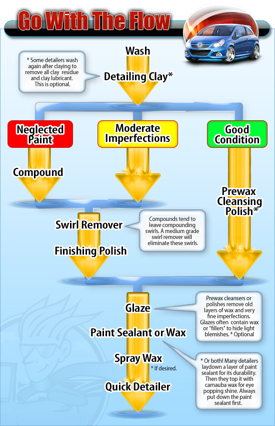

The flow chart Gearhead found is a great place to start.
