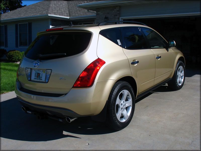

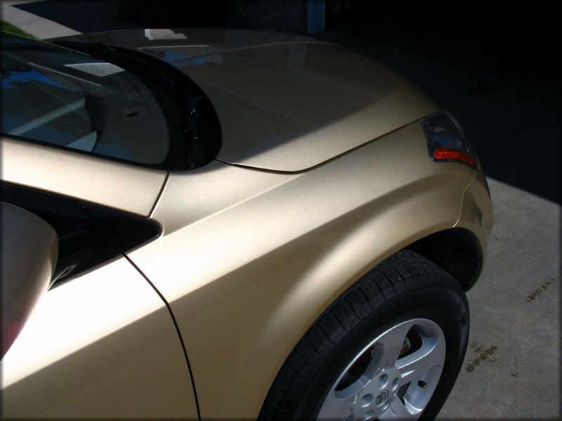

Well, it has been a while since I have posted much of my work, as I have been very busy with school. Today, I had the pleasure of perfection this Nissan Murano.
Interior:
Vac
Shampoo with Mytee Lite II
Meguiars WB Dressing 1:1
Z9-10 on leather
Exterior:
Z7
Z18-clay
-touchup paint and wetsand chips/scratches. Unigrit 2k-3k
ZPC/LC purple foam wool pad/1500
ZAIO/LC CCS black finishing pad/1000
Z5pro
Z8

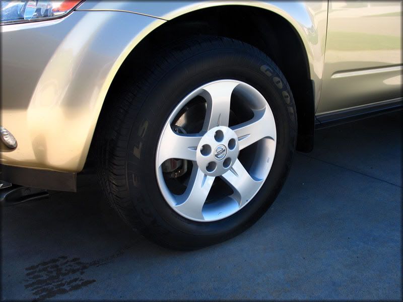

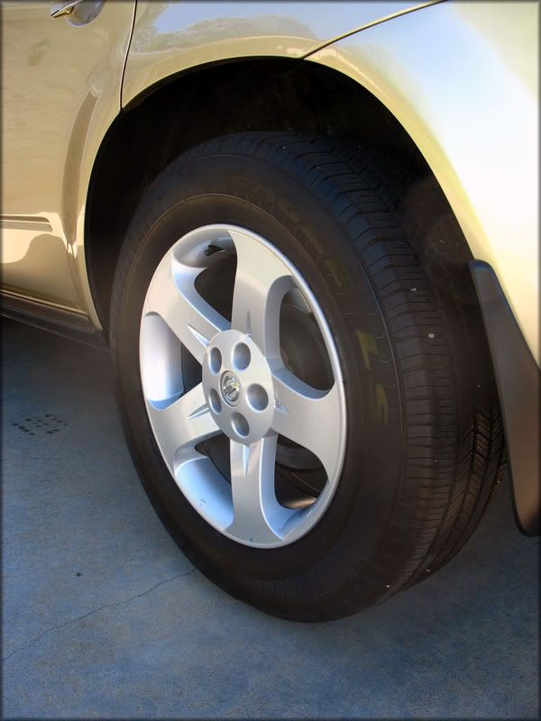

Meguiars Hyper dressing on wheels 1:1
Zaino Z14 on plastics, lighting.

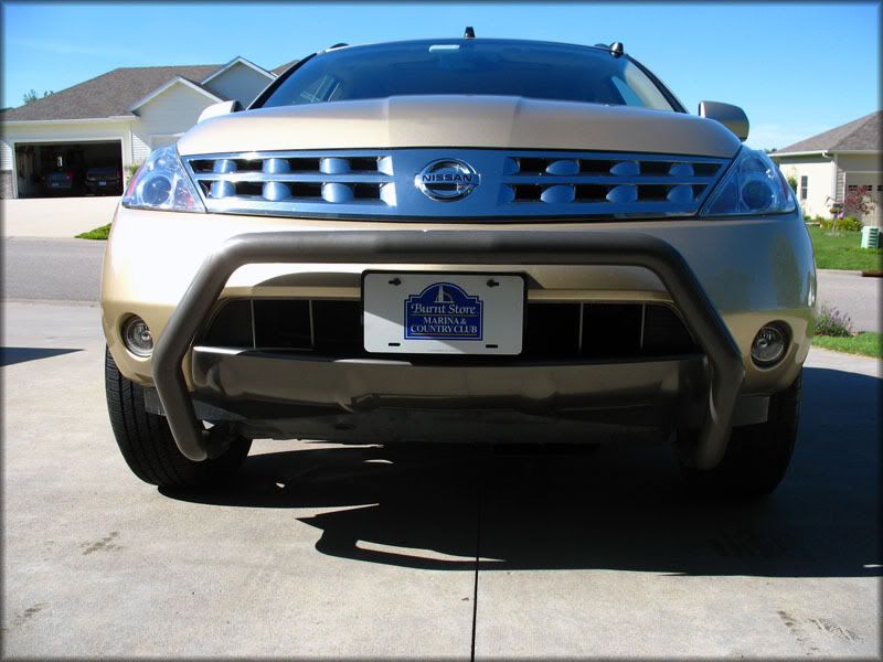

Looks good. I don't really care for the owner's front bar-thing. How are the driving dynamics on those cars? The Infiniti FX and Nissan Murano have always interested me.

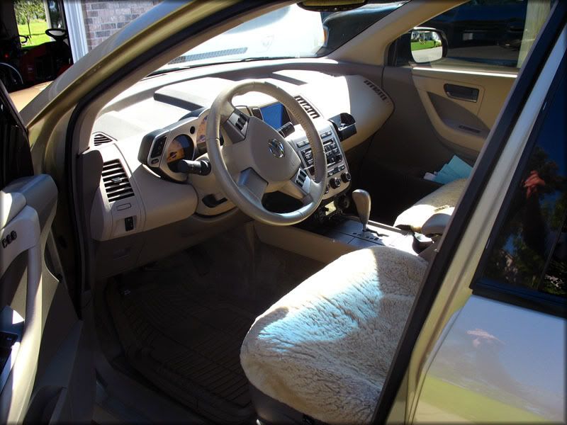

nice job. I havent seen sheepskin covers on a car since the late 80's HAHAHA. In FLA those damn things will keep you sweatin' like a pig.
If you ever drop your lambswool mitt you'll always have a backup LOL :P

Beefhouse- I don't know the story behind the bar, either. At least it looks good covered in Z5pro. :) As per driving, it's a nice ride, but having driven the Infiniti FX, I would choose it over the murano.

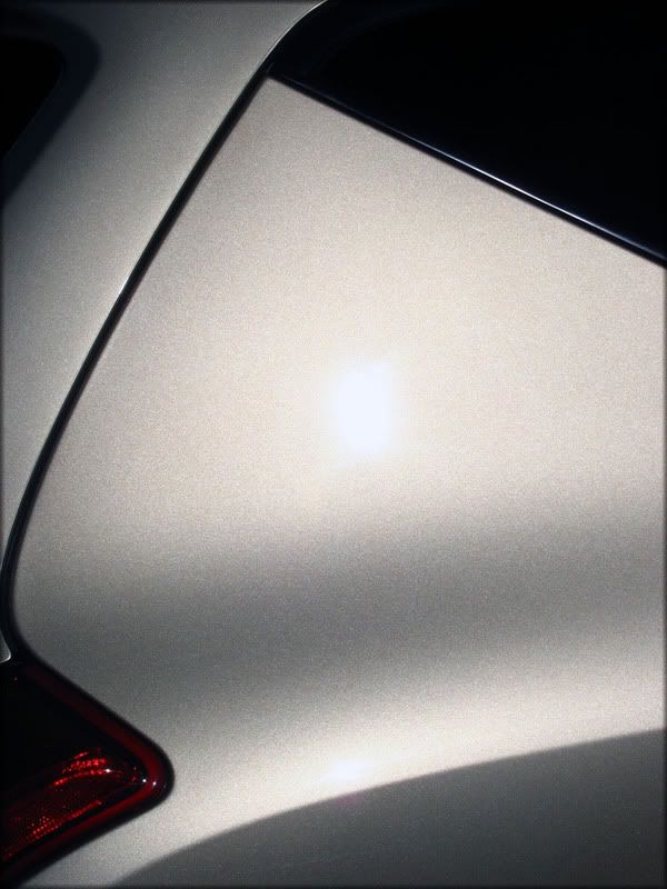

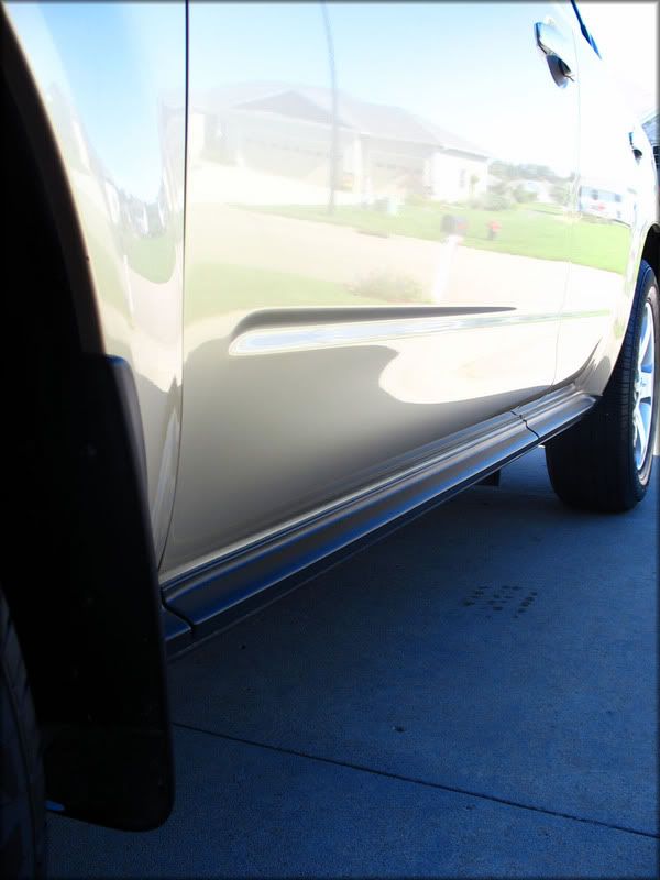

The second pic from the last is very nice and wet looking, just check out the rocker panel. How long would you say to work zpc via rotary? how many passes, correction ability?
VaSuperShine said:
Looks brand spankin' new. Great work no question.
Thanks! With the finishing pad and low speed, I work ZPC for about 5 passes, and then check work. If it needs further work, I do so. I have found the optimum speed for ZPC to be 1250 rpm. Correction ability of ZPC is totally pad dependent. I removed sanding marks with ZPC and a foam wool pad, but can finish down perfect with a finishing or polishing pad.
