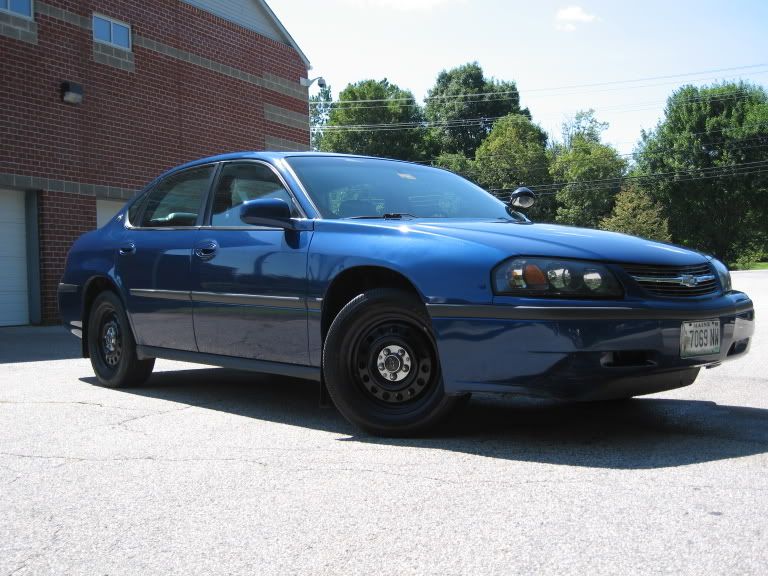

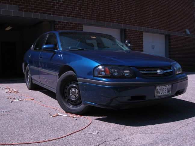

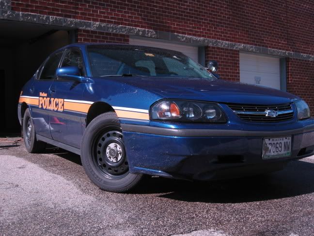

New undercover cop car.
imported_cj99si

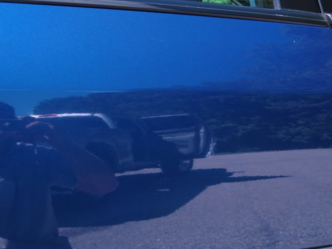

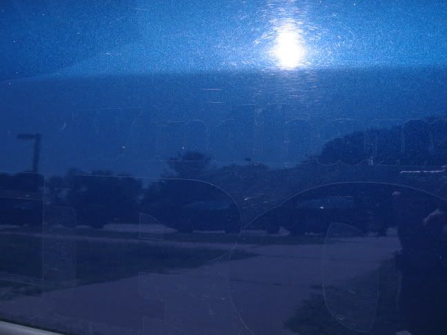

That reflective vinyl is a huge pain to get off! and the interiors get pretty messed up in these!
process was: lots of heat for the lettering
-clay the raised edge from the vinyl

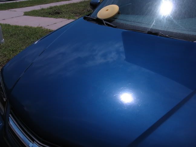

-pro duz all with rotary yellow pad

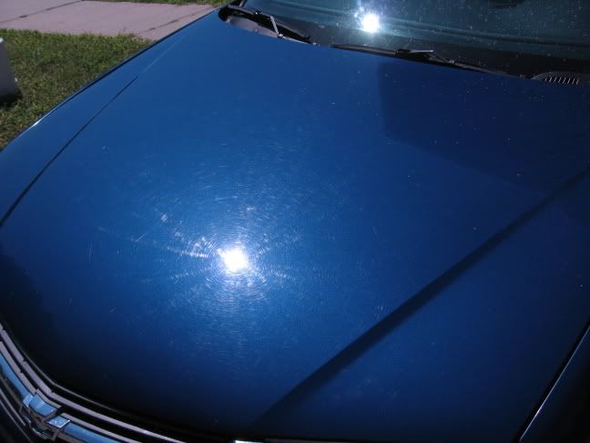

-pro swirl remover with rotary black pad
-pro duz all with pc white pad speed 6 and 4
-toped with pro satin cream
this hood pic I took too soon, I went over it again but forgot to take another pic. (no wax either)
I pick it up at a local distributer. check prowax.com they may have a dealer locater or something......It seems to be a bit cheaper if you go in.
Pretty sneaky undercover car, Impalas are a dime a dozen, pretty easy to just blow by that and not realize what it is. :nervous2:
Excellent job on the detail, the paint looks very deep and wet. :)
There are a couple of those unmarked Impalas in the town I work in, pretty tough to keep in mind when everything has been Crown Vic's for so long.
