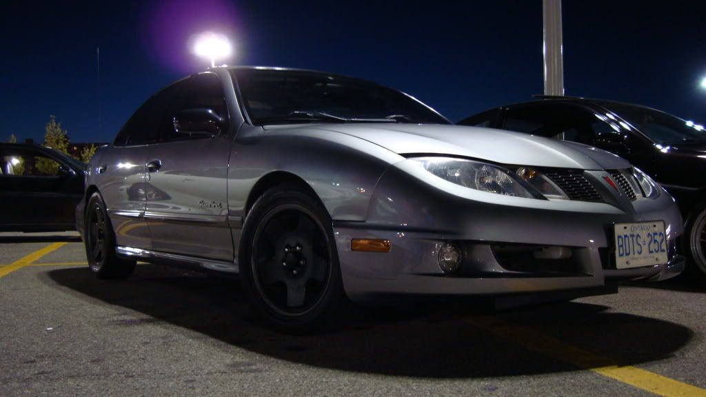

My Car

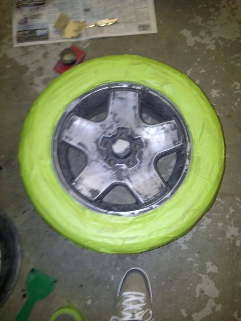

Taking Paint off with paint stripper (sandblasting didn't work)
Rim Sanded and Taped off

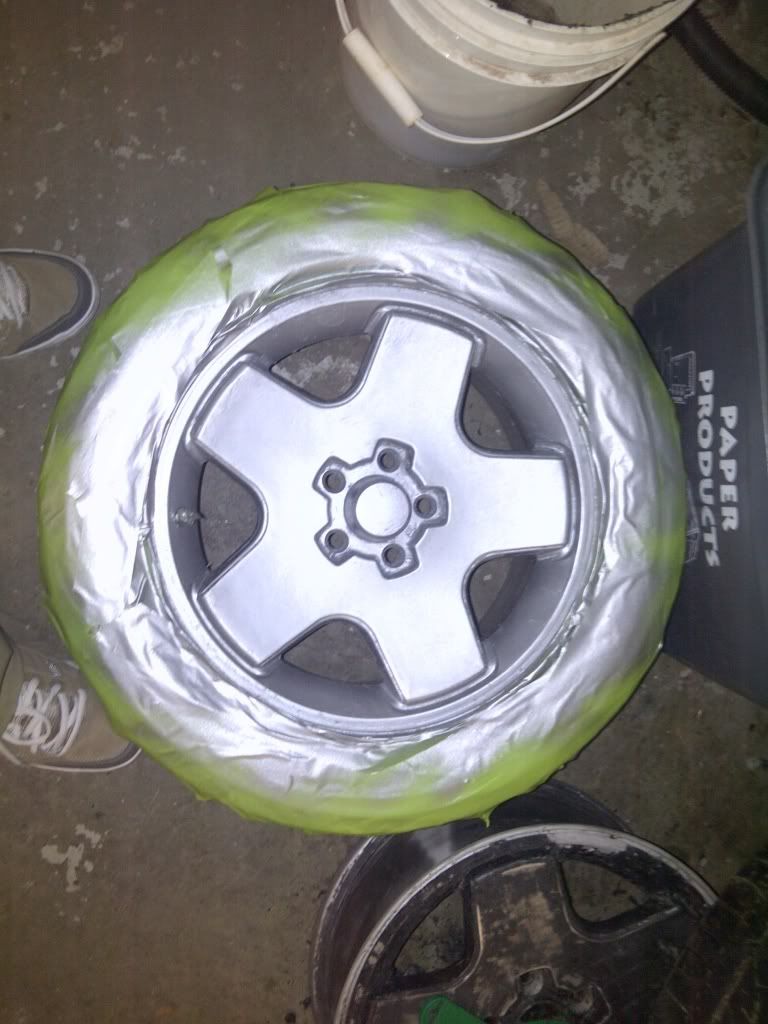

3 coats of Primer

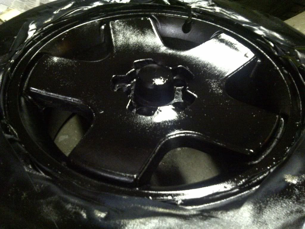

How it sits now, 3 coats of black and one coat of clear coat (not wet sanded yet)
