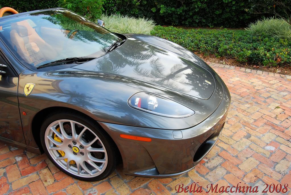

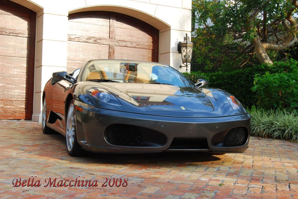

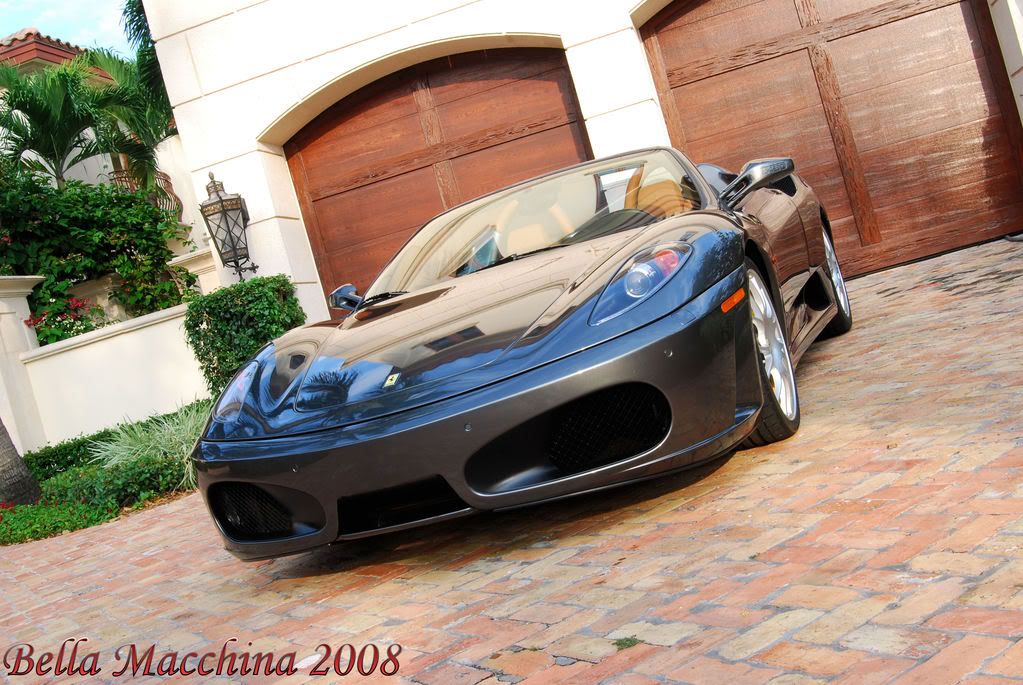

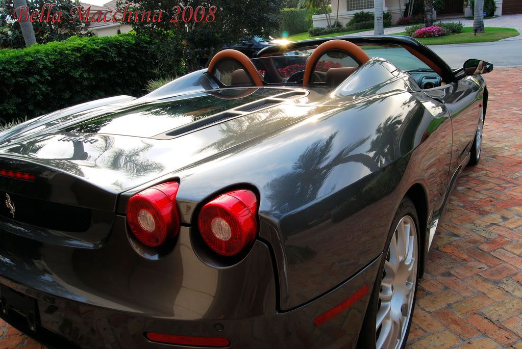

The owner of this car had just recieved a red '08 F430, but couldn't stand the color (he likes to be different) even after we detailed it. He returned the Rosso Corsa Ferrari and took delivery of this beautiful Grigio Silverstone F430 Spyder. As will all new Ferrari's I have detailed (this being the 23rd), the paint was far from perfect and required a days worth of work to get this amazing car in the shape required by my client.

Brian and I began by treating the paint with FK1's decontamination system to ensure we where working with the cleanest paint possible. After throughly decontaminated and washing the entire exterior, we used Sonus gray clay to remove what felt like light overspray on serveral spots, then clayed the rest of the car using Zaino Z18 clay and cut ONR as lube until the paint was perfectly smooth.

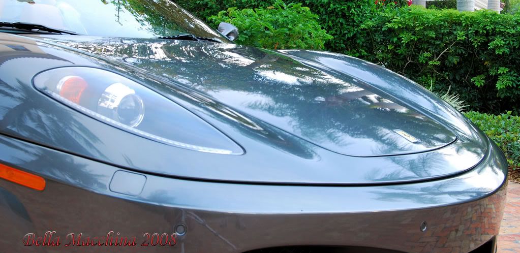

After throughly drying the Ferrari, we pulled into the garage and set a 500w Halogen light to inspect for paint damage. Because of the high flake content of the paint, it was very hard to spot defects except at angles. However this Ferrari had it all: hologramming,swirls,rids,deep scratches, etc... Paint gauge readings where all over the place, not uncommon on Ferrari's, but nothing to alarm us to a repaint. Very typical of the 20+ brand new Ferraris that Bella Macchina has perfected in the last couple of months.

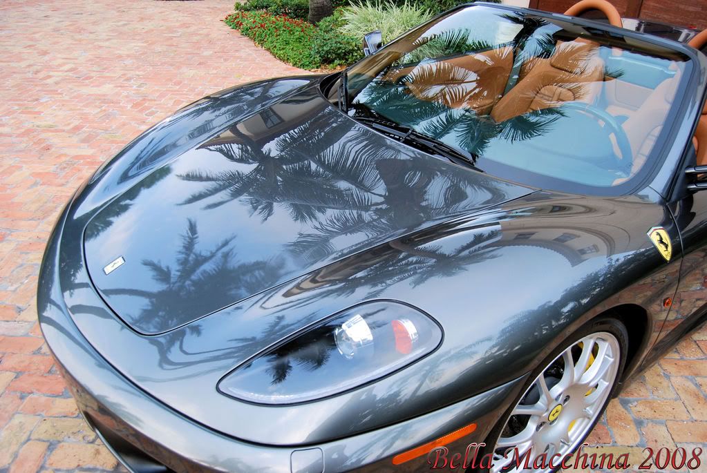

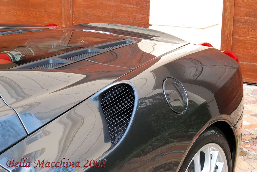

The paint work was polished using a variety of pads from Lake Country and Meguiar's, and various Menzerna, 1Z, and Meguiar's polishes until it was absolutely perfect. After polishing the paint was wiped down with DuPont Prep-Sol to remove any oils that could lead to false appearance and the potential of pad abrasion showing up later on. After determining the paint was perfect, we washed the car using Z7 soap from Zaino, then reinspecting.
