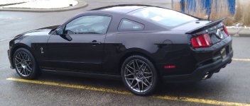

pictures as requested (Phone camera)
Polish it with Prima Amigo (don't underestimate Amigo)
Seal it with BFWD (two applications)
Top it with Midnight Sun (two applications.)
Warning: with the shine, it will not be street legal. :D
