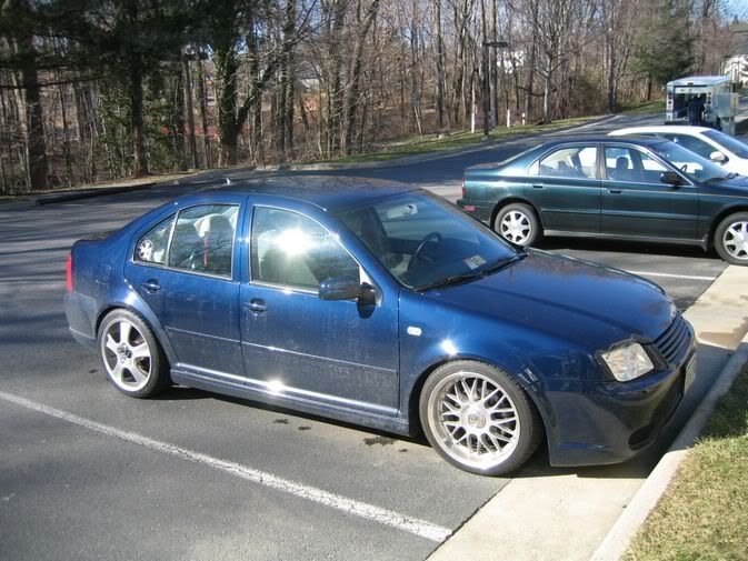

im trying to achieve a shine below
Would this be close enough?
Yes! Very Nice.
What steps/products did you use?
Also, what would best describe that finish? im trying to learn about the different types of finishes. would that be considered depth? glossy? reflective?

steps:
wash
clay
ip
pwc
fk1 #2180
fk1 pink wax x 3
