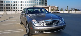

Some finished pics from ShowCarDetailing.com.

Just a few more process pix from the prep. Thanks Harvard4!
Richard
