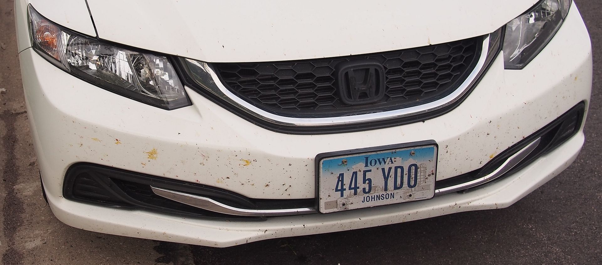

Last month I polished and coated my daughters car with CSL/EXO here is a before wash and after of the front. I used the Poor Boys bug squash (1:1 mixture) and towel which made removal quick and easy.
Bugs.jpg~original
Bugs1.jpg~original
