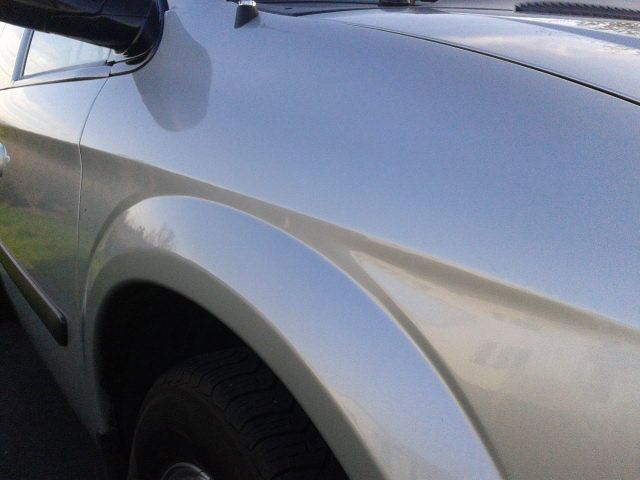

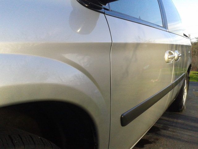

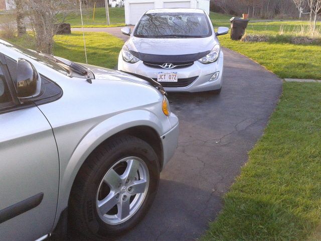

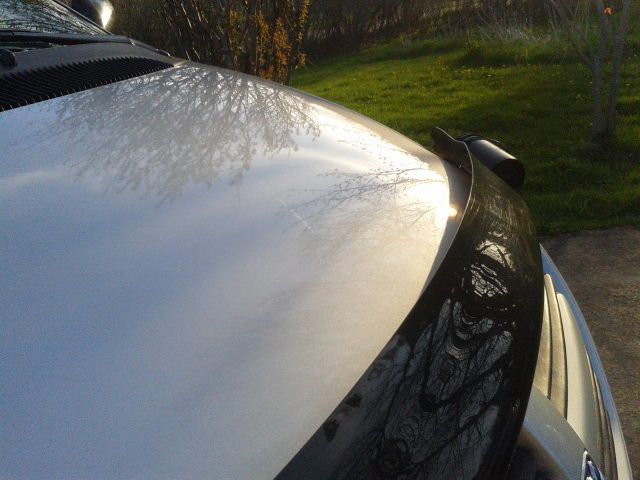

Pic...Not bad for a van that was neglected for a few years before we bought it. Zero rust as I drill, spray and undercoat with Rust Check every year.
Having trouble uploading other pics.
