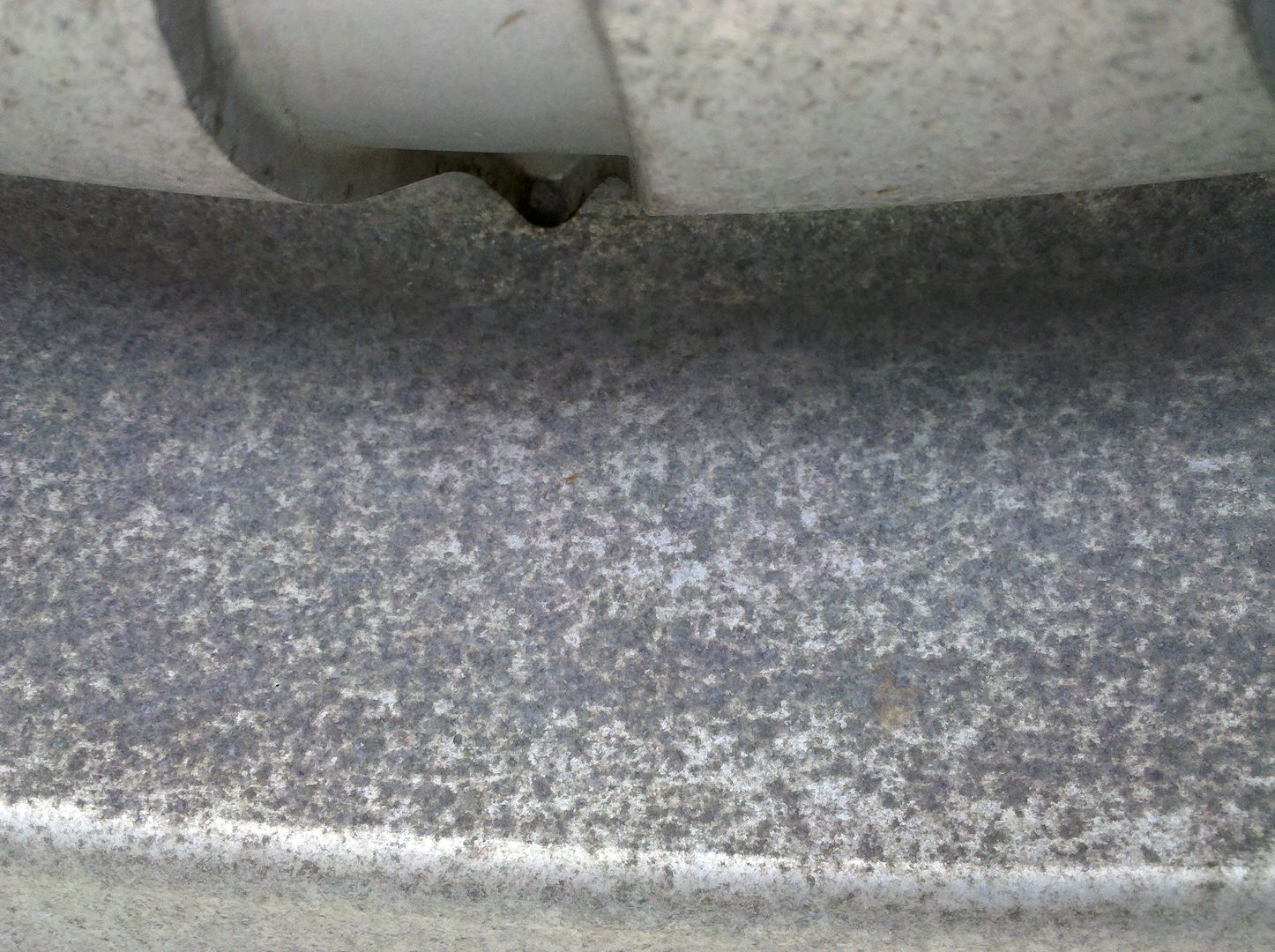

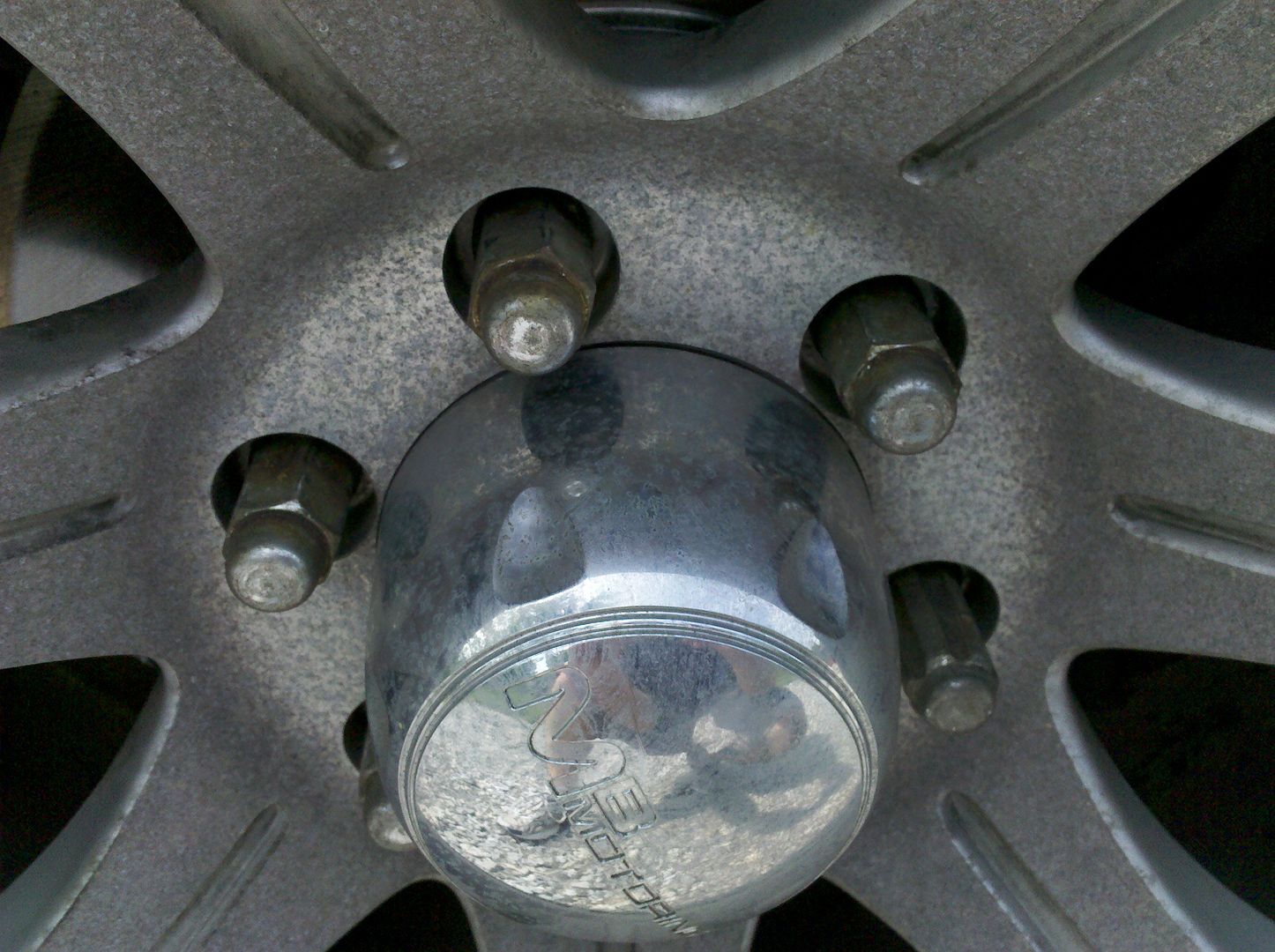

I have a friend that has aluminum rims that look like they've been neglected. Her husband just put new tires on them, and convinced her to keep the Tahoe rather than buying a new car. So, she's wanting the Tahoe to look great, but I'm not so sure about the rims. I don't have a lot of experience in wheel restoration, though I detail all the time and clean lots of wheels of all types. These are extremely rough and gritty, as if the brake dust has etched it's way into the wheel itself. I don't think that the wheels have clear on them, or at least I can't tell that they do.
How would you go about trying to restore them? Is there a ph neutral cleaner that would remove that stuff? Maybe an acid? Should I consider sanding or wet sanding in some manner? Possibly some steel wool, or a steel brush of some sort? Perhaps a combination of everything mentioned?
IF I can restore them, I'll be sure to apply protection afterward.
Here is a pic of the wheels, taken from my phone. The second is a closeup of the damage:
that looks really bad, assuming its raw aluminum here's what I'd do. from the looks of it it's all pitted and covered with oxide which is kinda like rust on aluminum.

Well, they didn't want to compensate me for wet sanding, and instead opted for me to purchase Flitz Aluminum Preclean to see what it would do. It did pretty much nothing, and I told them that wet sanding was the only option that I saw. They declined, as the guy that changes their oil says that a local detailing shop can "put the wheels in some chemical" and they'll come out looking like new. More power to them, but I really think that sanding is the only real option. Oh, and I actually think that these wheels have a clear on them, it is just so hard to see because the wheels are so severely damaged. I think stripping them down and sanding them, then waxing or re-clearing is the only option other than buying new ones. In the end, they just want them to look better, I don't think they're looking for perfection, but I think that they may be so far gone that the only things left to do are extreme enough that they will have to go for perfection or leave them looking like they do.
