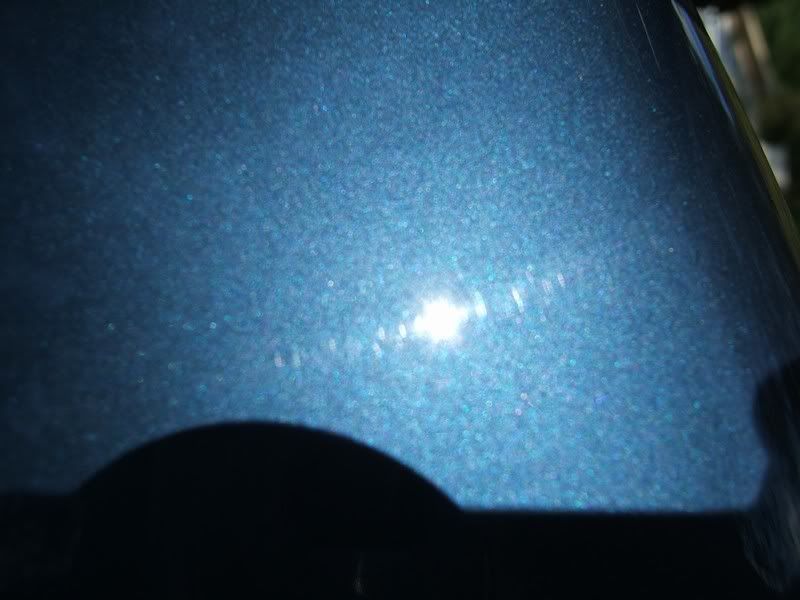

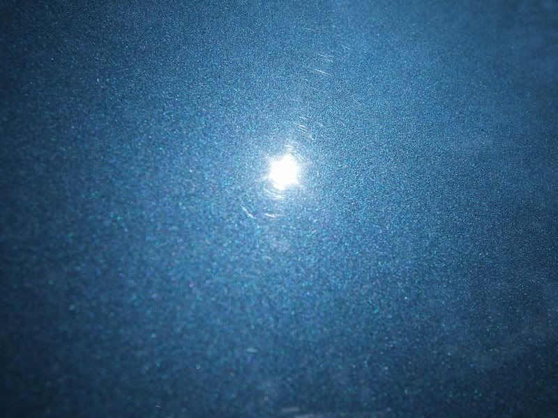

Ive done so much reading on this crap its not funny. People talk like its the miricle product, so i got me some. I just wanted to remove some swirls but Im having some troubles getting them all out. Can anyone give me some tips and tricks to this stuff. I posted this on MOL also but want your alls' opinion.
Just go over some things like speed of the DA, what the #80 looks like when it breaks down(ive heard it turns clear?), and how much pressure you all use. Any movies or short clips would be nice. I cannot afford Mikes DVD or I would get it. :doh
Thanks guys.
Some pics of the swirls..
what kind of paint are you dealing with here? also, you need to work in the product with a slow arm movement and a good amount of pressure (to determine a good amount of pressure, find the middle ground between pressing too hard where the machine almost bogs down to letting it go freely with hardly no pressure at all). while you're buffing, you can check by swiping the area with your finger and feeling/seeing if there is any product left behind you. sometimes multiple passes are needed and if #80 doesn't work, try #83

Blue- Since you got some responses here and im sure you will get some more response on Mol hopefully Mike P will chim in over there, but just remember shrink your work size down for ex a 2by2 shrink it to 1by1 (example) also Slow your arm speed down plus apply just engough pressure that it doesnt bog/ just jiggle also work the product in Real good and sometime you may have to make another pass or step up to #83 again i am not suggesting that just stating the 80 might not cut it cause some paint is harder to polish out then other.... just thow on your ipod and "take your time polishing"

Thanks so much guys! Since Im new at this, Im just afriad Im going to ruin my paint by going over it to many times. Ive went over one spot twice with #80 on speed 4, and once with #83 on 4.5. Ill up the speed to 5 and see what happens on a different section. I was working in the garage last night and its hard to tell if the swirls are still there or not. Ill pull it out into the sun and work today.(The earth tilt is changing so the sun isnt very strong at all, no worries with heat)
Ohh, its an 04 jeep libby. The paint seems to be very hard.. Ive heard it would be.
