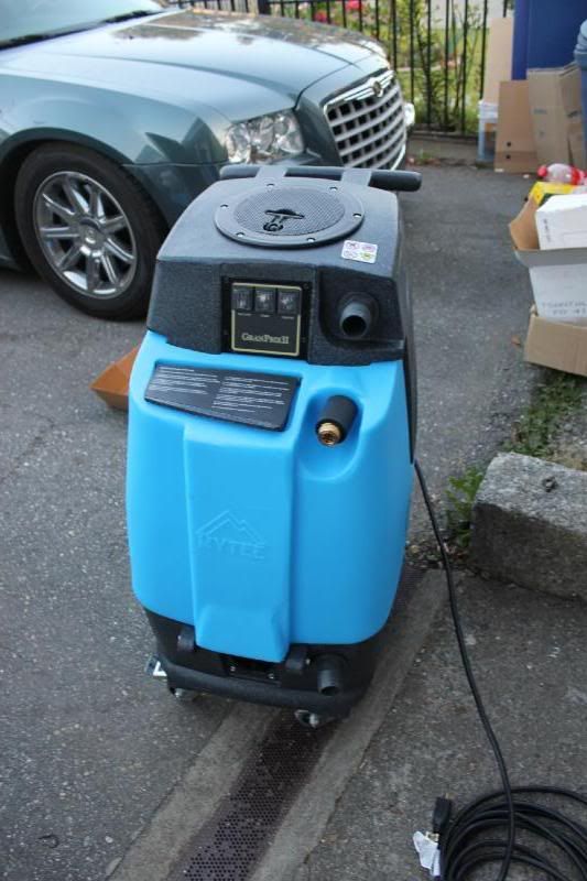

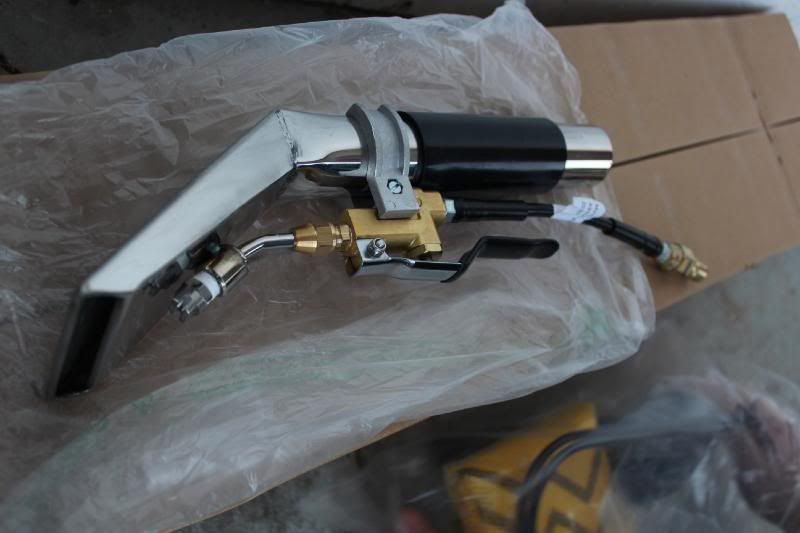

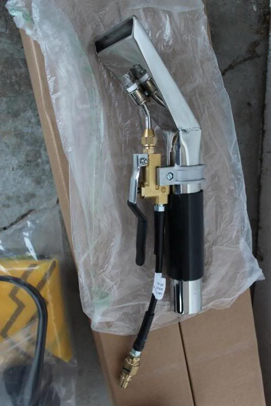

After getting the machine out I examined all the accessories (nozzle, hose ect.) After that I immediately assembled the racks for the hoses and power cord onto the machine.
and filled her up with some hot water to try it out for some testing.

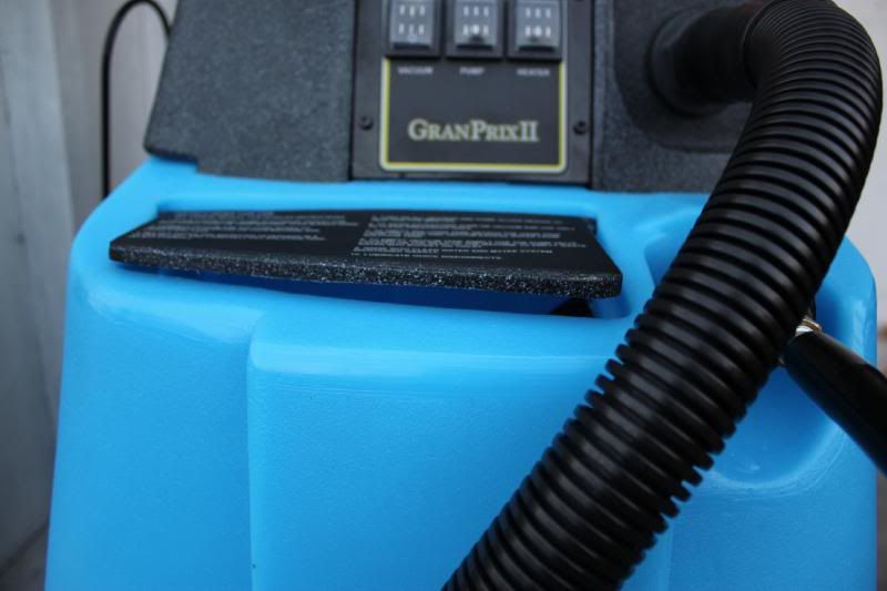

After filling it up with water (no solution) I right away noticed that when you shut the solution tanks lid it doesn't fully close. Its nothing crucial but a little bit more attention to detail would be nice.
Notice how the lid doesn't exactly fit nicely as there's a huge gap on the side. To me it looks cheap and unprofessional especially when you spend this much money.

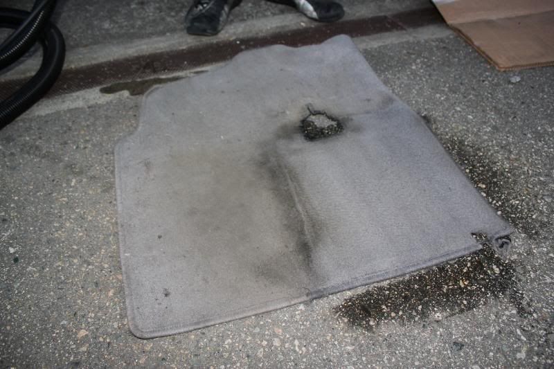

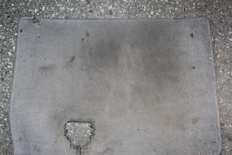

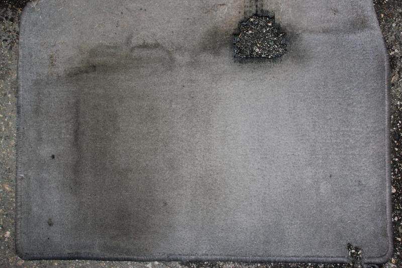

Now it was time to find myself a victim piece of floor mat carpet that's been neglected and abused to test the machine out on.
Method of cleaning:

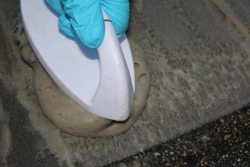

1. Pre-soak
2. Agitate
3. Hot water extract with the Mytee HP100

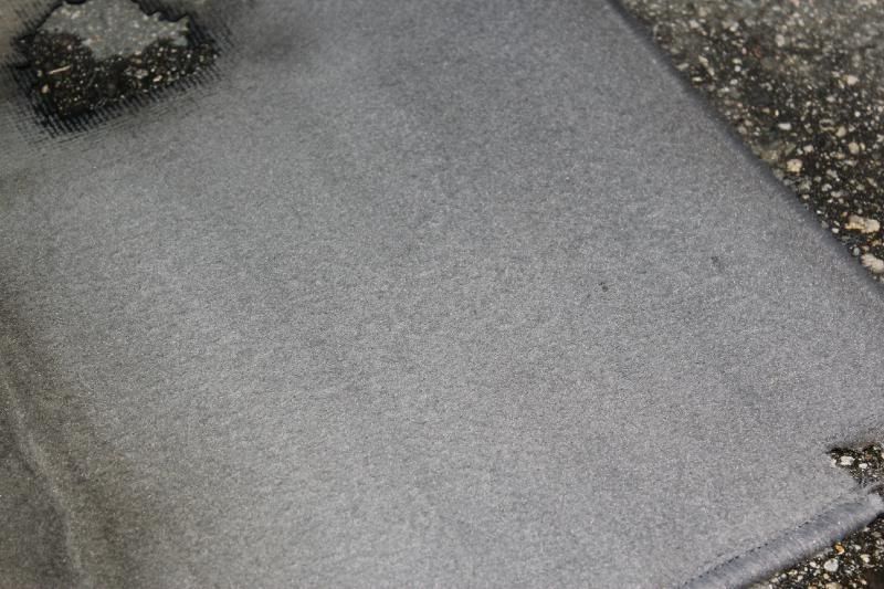

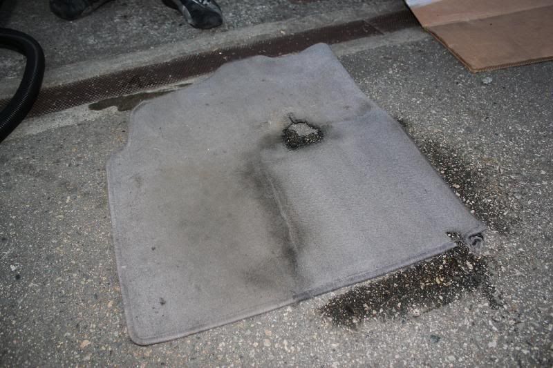

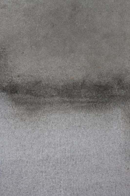

AFTER HOT WATER EXTRACTION:

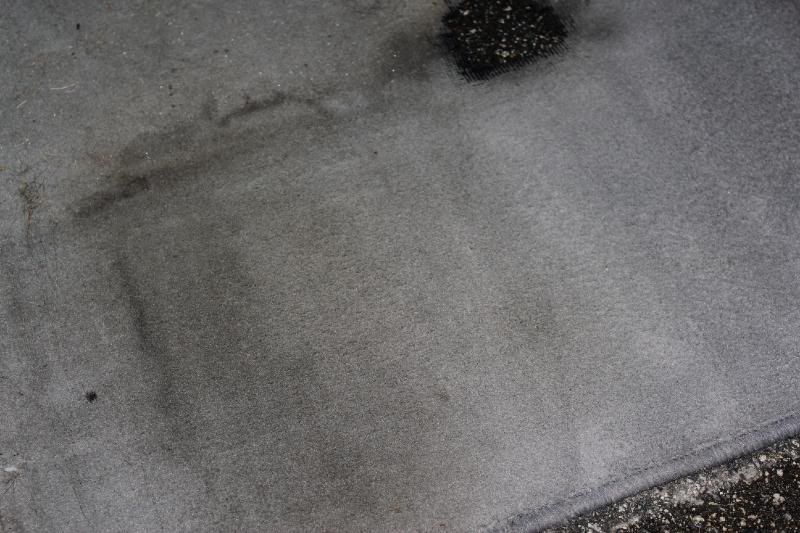

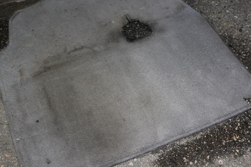

Results: I was very happy and satisfied with the outcome especially for a grey carpet!
So after going about cleaning the carpet with that method I figured I would give it a shot with only using the Mytee HP100 hot water extractor and NO solution and or agitation.
The results: POOR cant really say it did much, the pictures speak for themselves. I don't believe you can get a carpet clean without pre-treating it and agitating prior to the hot water extraction.

Thanks for the review ! I wonder if something happened to your solution tank lid ? To me, it looks like it melted and deformed somehow ? My Mytee Lite II has perfect fitment, this just doesn't seem to add up.
