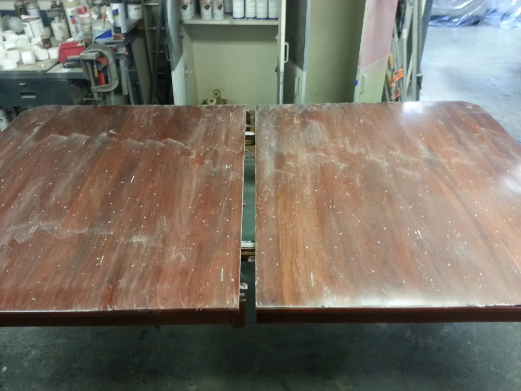

Well heres some pix of a side job i did tonight after my 10 hours of my FT job and another 4 with the side job. Customer wanted the dining table top to re finish with the same sheen and wanted the skirts (apron) of the table and legs a Satin black finish.

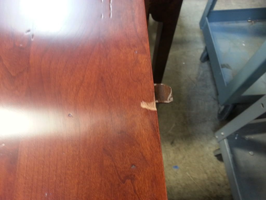

Nice chunk missing

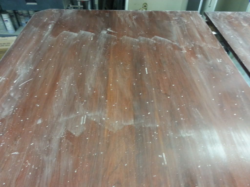

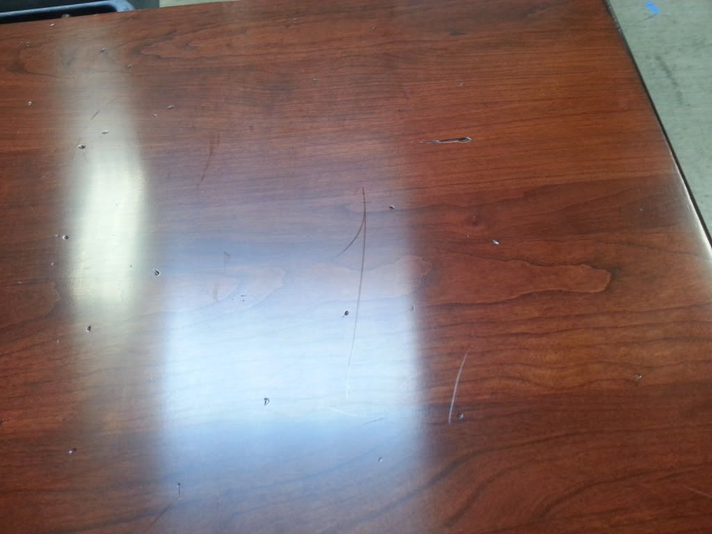

Surface scratches

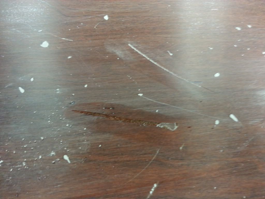

Deeper scratches that went into the wood
I told the designer that the deeper scratches cannot be removed unless the table gets stripped down to raw wood and re stained re sprayed etc
So the cheaper alternative is to blend it in with the rest of the table which is called "distressing" man made nicks and dings created by man to make it looked "aged" old.
Sanded down with 320 then 400 and then 600

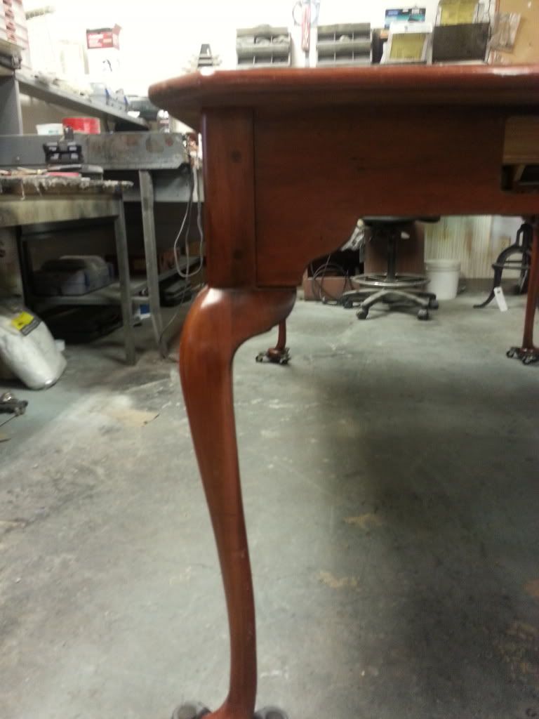

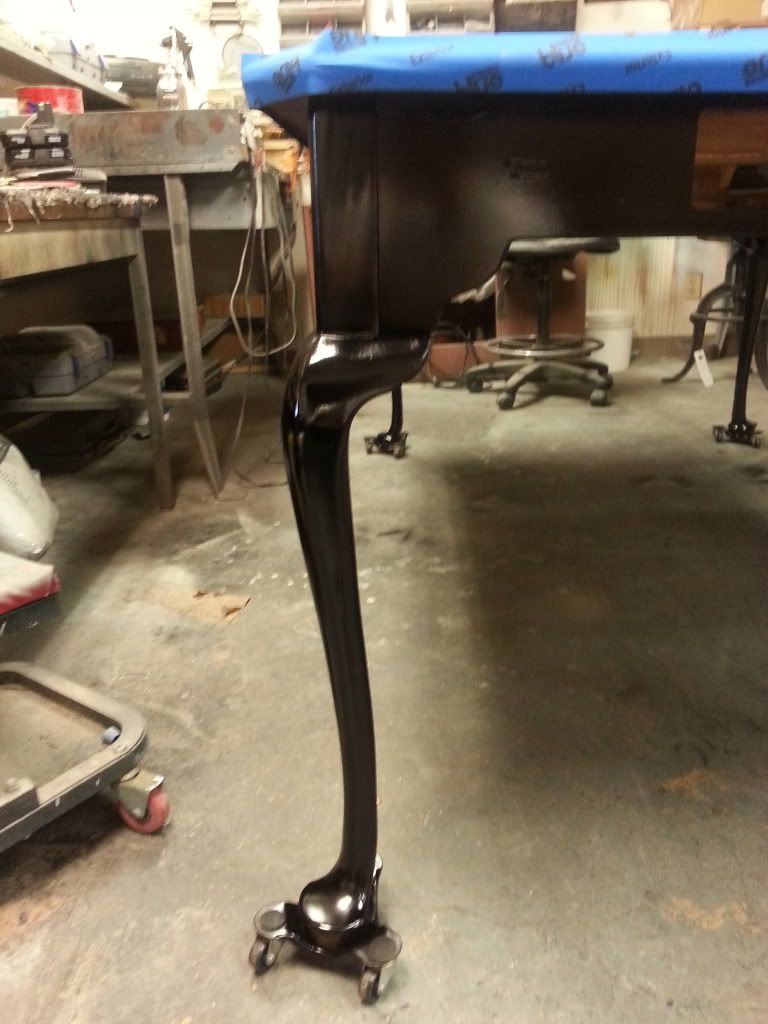

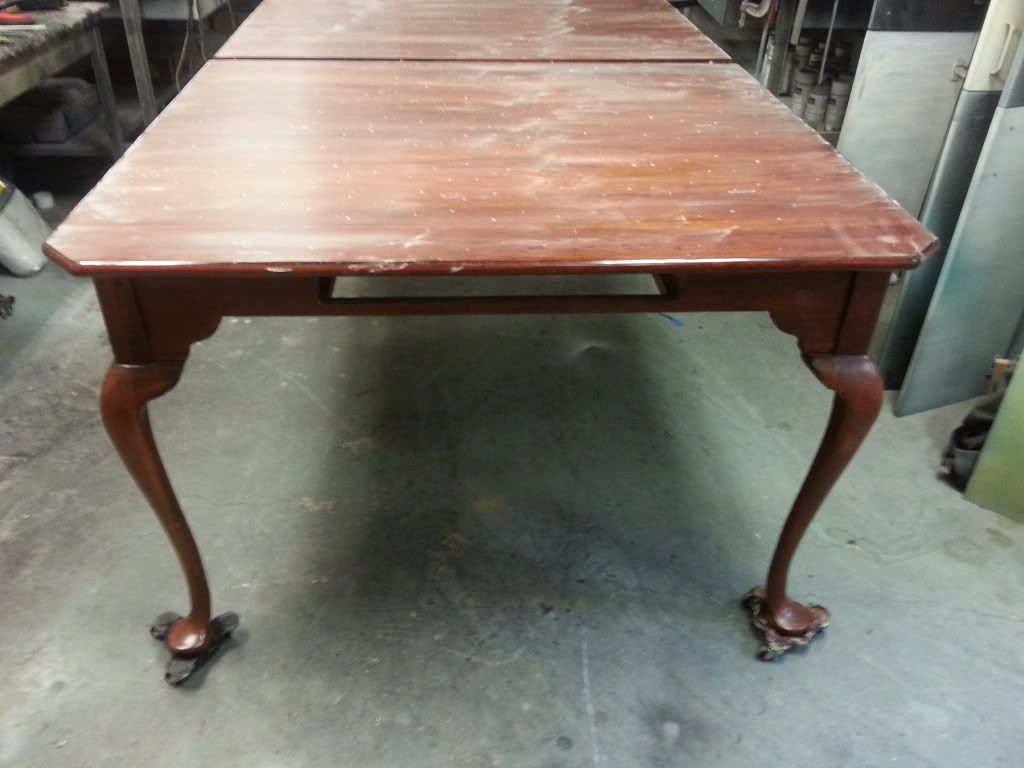

The legs and apron before
After
Before

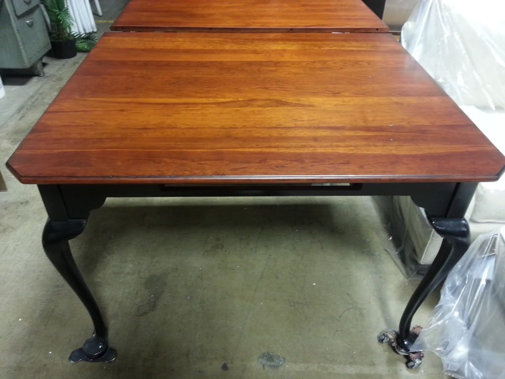

After

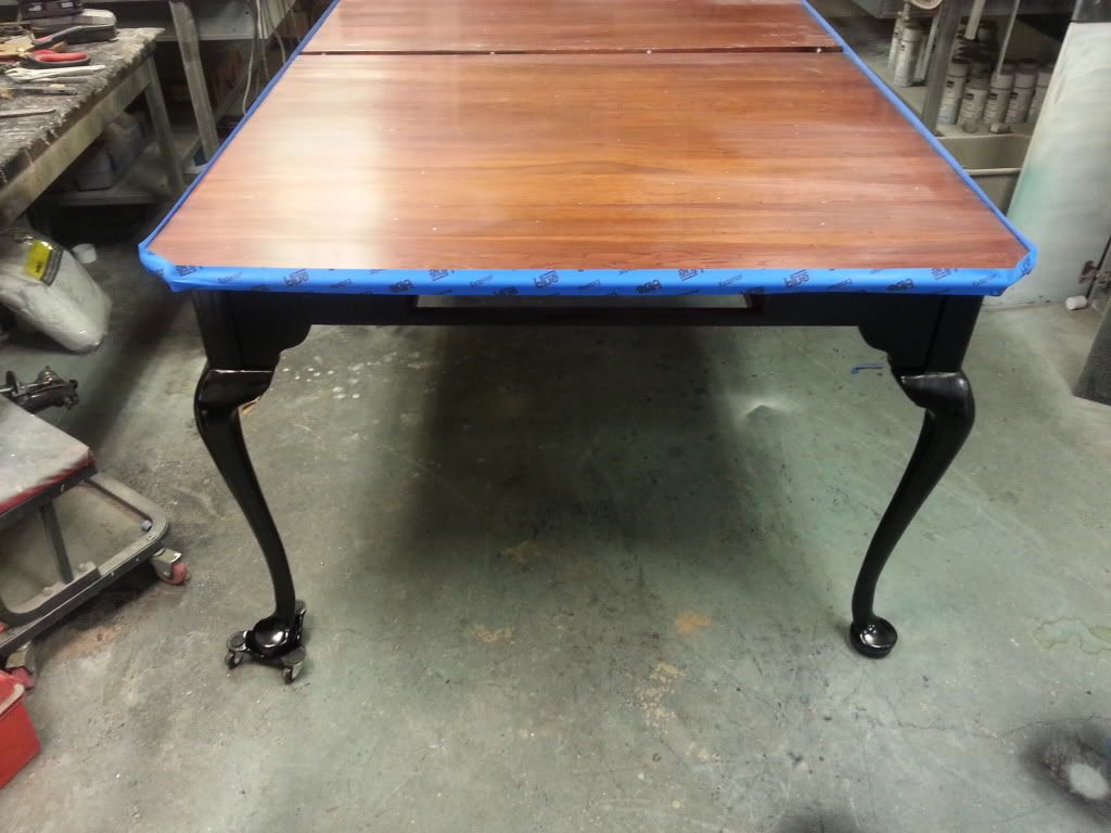

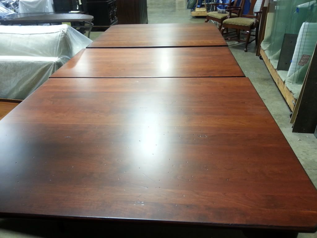

Heres the table all done
The table had 2 leaves "extenders" which had to be preped and sprayed the same.
