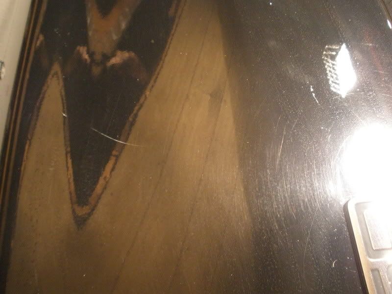

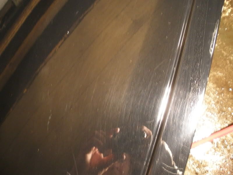

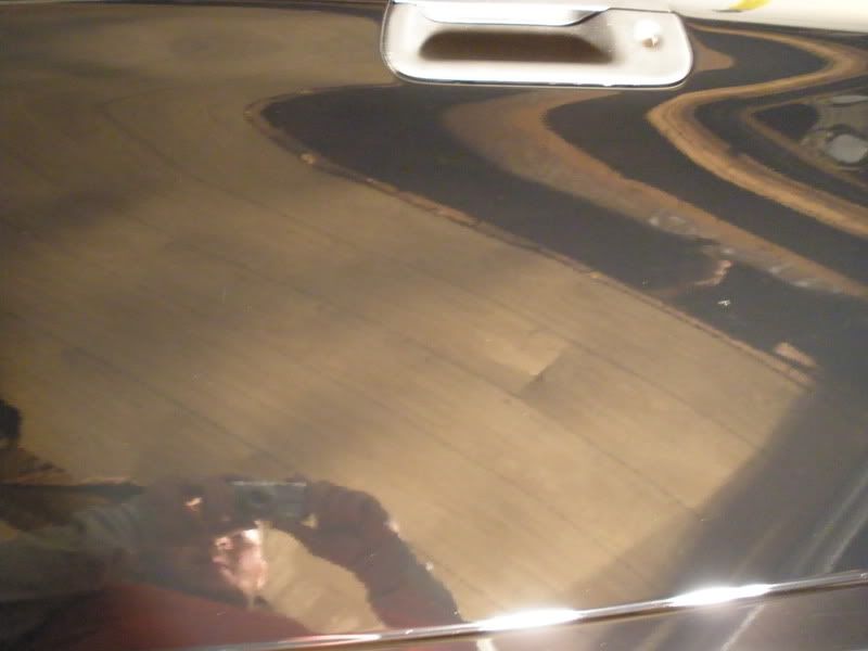

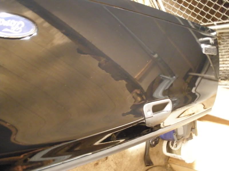

I dont really think this should be here because I am not braging but I want to show everyone my first polishing experience
Well I just got my Danase complete detailing kit from Dave... THANKS DAVE!!! and I couldn't wait to use my stuff so I took my tailgate off and polished it in the basement.
So I washed it with Dawn, Clayed it, I started with the SAII but then decided it was worth trying SAIII. So..
I did SAIII with the sonix 1 pad
SAII with Sonix 2
and SAI with sonix3
Wet Glaze
then Sealant.
All danase products.
It didn't come out perfect but I was a little scared with being my first time and on my black paint but I am pretty happy, it looks way better in person than my crappy pics.
I can't wait to do the whole truck.
