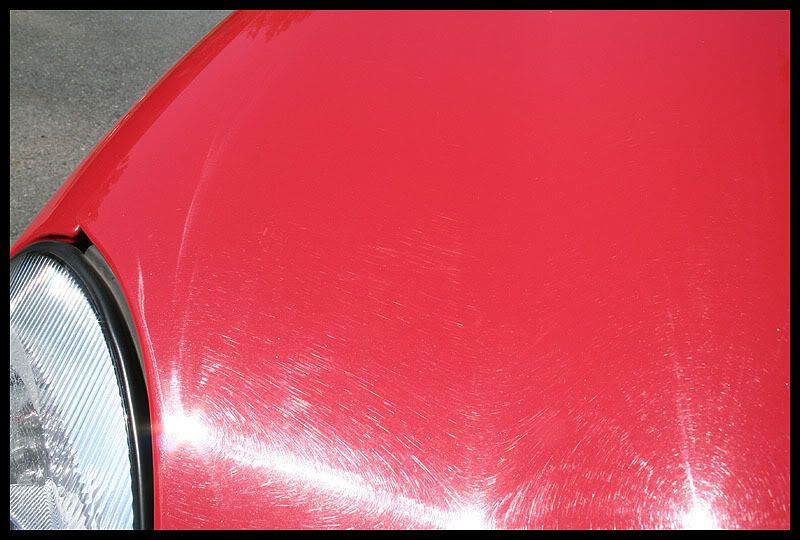

heres the only before he posted:
as you can see it wasnt pretty... and i wasnt really sure how to approach it... so i started off hitting it with the 2.5 and an orange pad... that wasnt doing enough so i stepped it up... using the trunk as my test section... i hit it with ssr3 and the paint looked hazy after that... i was about to crap my pants as ive never had to deal with this before... so i calmed myself then hit it with the ssr1 to reduce the haze/micromarring, this looked ok but not quite what i wanted so i hit it with some Red Moose... i liked this and knew it would look great with the PBNR on it so i decided to do the whole car like this... HOWEVER... even after getting IMO aggressive with the compound i was still left with some visible marks/mini swirls in the paint that just didnt want to come out... and i knew they werent inflicted by me because of the shape and such... so if you guys can give me some confidence/tips on how to defeat such things itd be greatly appreciated.. ok on to the afters... he didnt post any of the interior shots :( so here they are... and enjoy!

The swirls look pretty heavy in the before pics. You probably needed to use a yellow pad or a LC foamed wool first with SSR2.5 or 3. Then step your polish down and use a white pad to finish out. The orange pad is a light cut pad and the yellow is a heavy cut. It also sounds like you were moving the PC too quickly since you did the entire detail faster than I would do an exterior only. Try making slower passes next time. It just takes practice. Keep up the good work.
yea i was thinking i shouldve tried the LC yellow pad... and i definitely agree about the speed... it took me 3-4 hours to do the exterior including prep... i mean he's super happy with the car but i know i can do better... i mean... look at my car haha....
I think you stepped down too far in going from SSR3 to SSR1. IME SSR3 doesn't finish down well enough for SSR1 to fix it, which may be why you weren't happy after the SSR1, and you may have just covered up the marring with the RMG (never used that myself). SSR2.5 finishes well (although it leaves something behind, do an IPA wipe if you intend it to be your last polishing step), so you could have used that in the middle, and then gone right to the RMG perhaps.

ill have to give that a try next time... i was trying to save time for him to drive home... i was going to go from 3 to 2.5 or 2.. then down to 1 but he had a long drive so i tried to go as fast as i could and still have the car look good.

Get a bottle of Menzerma SIP and use a yellow pad!! Work slow, apply medium pressure and it will finish down nicely!!
I agree with the others, SSR3 is too aggressive for SSR1 to remove the hazing it leaves behind.

Next time try working down through the SSR line. If you start with SSR3 for example, step down to SSR2 or SSR2.5 and then to SSR1.
