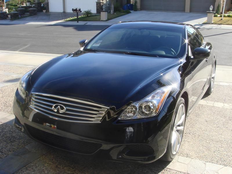

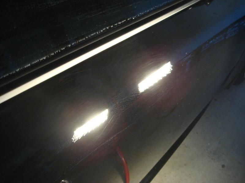

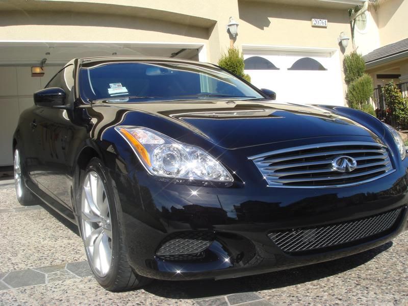

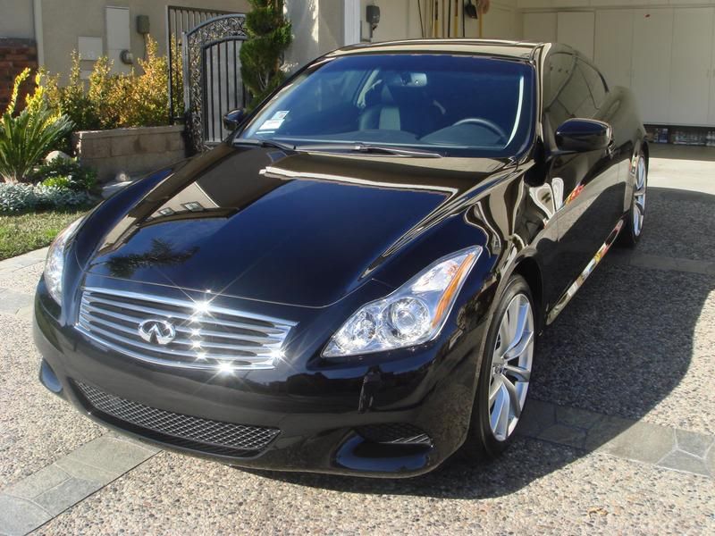

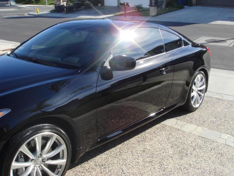

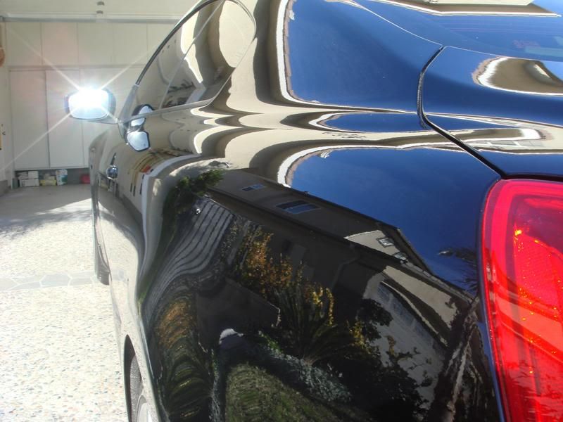

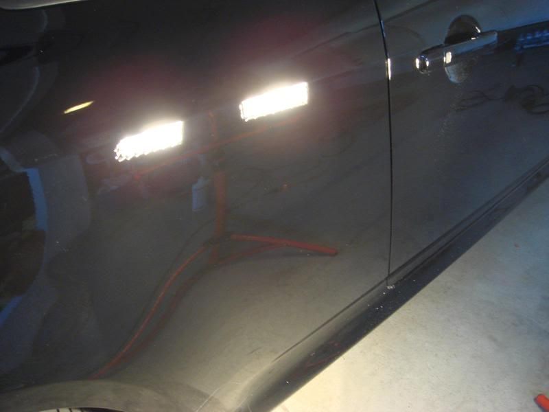

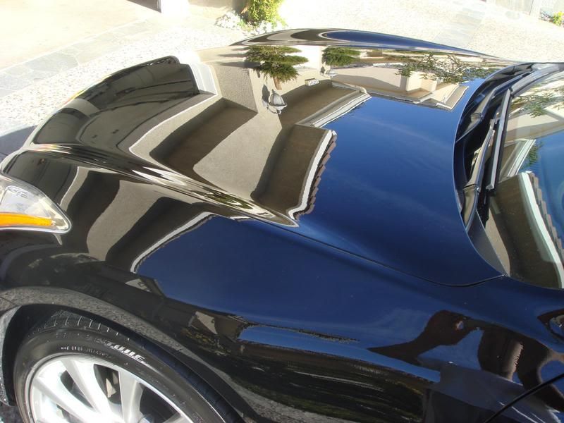

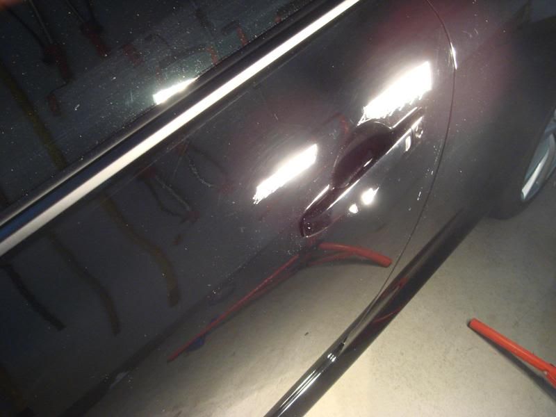

Hello everyone. I posted pics of my new car a few weeks back but it was not detailed. I finally got the time to give it a nice detail!
Process:
Wash
Clay
SIP w/ orange pad @1500 rpm
106ff w/ white pad @ 1300 rpm
z5pro x2

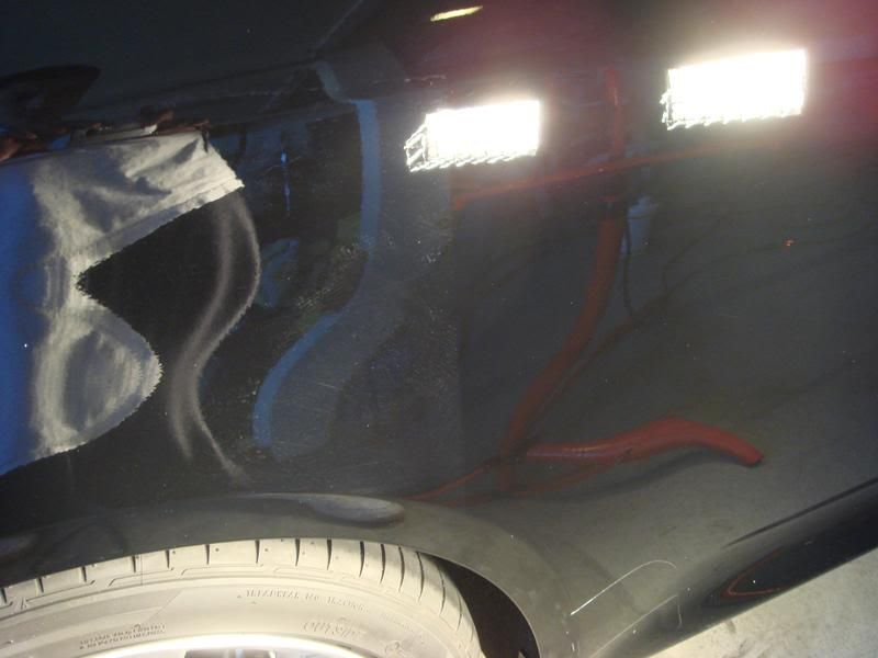

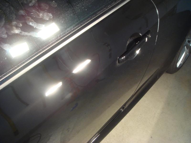

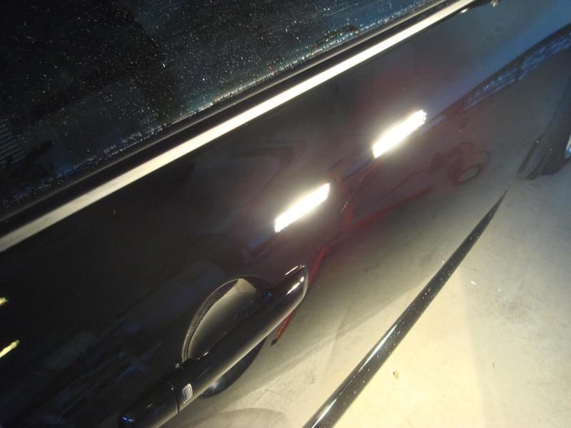

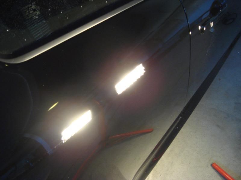

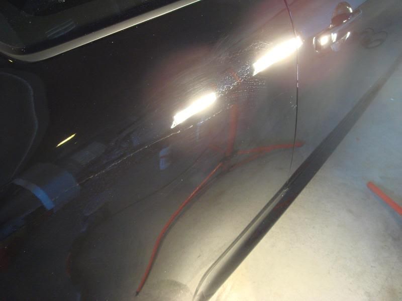

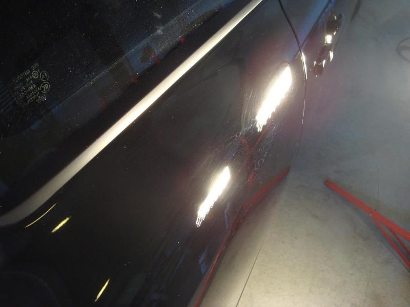

before:
after:
before:
after:
before:
after:
before:
after:

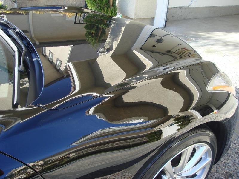

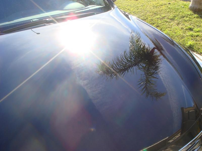

50/50

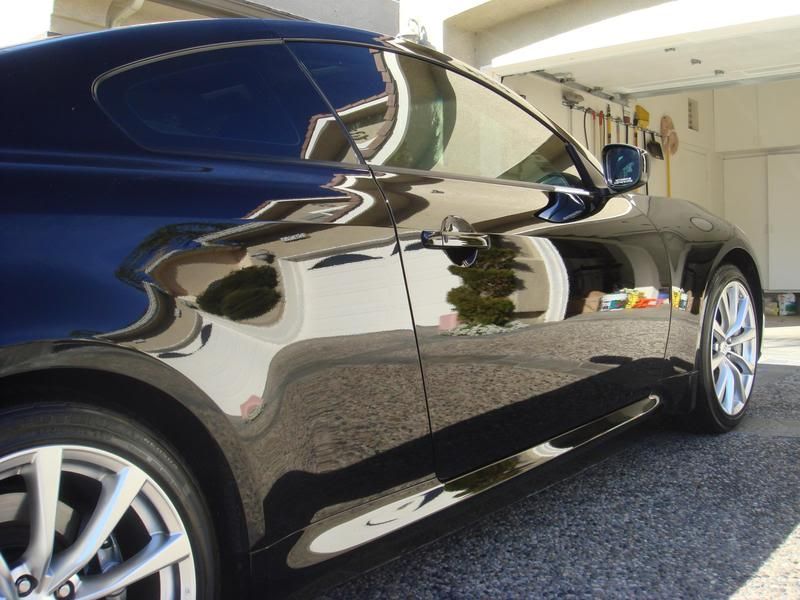

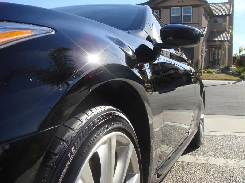

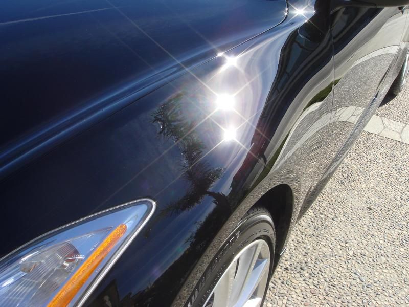

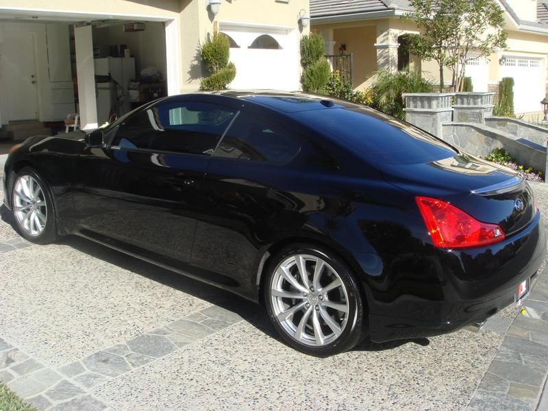

AFTERS!
Enjoy!
Can't fail with that combo!
Love that deep black.
btw, what did you use one the wheels and tires?
Oh and good job!
So how do you like the new G37 compared to the G35? Nice work btw! I love the wheels and the de-badge as well!
now that's true perfection in the paint.
do you know that you own my dream car? lol.. and now you made me love it more
