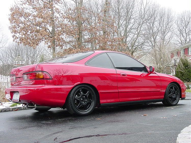

First up is my Teg...
Washed With PB SS&S, then did Zaino Z2 x 3 with the ZFX Accelerator. With the Z2 I noticed and enhanced 'gloss'...If I were gonna do it again, it would be Z5 x 6 total. I felt Z5 gave better depth for dark colors where the Z2 would look great on lighter colors due to the added gloss. Regardless, I'm not unhappy at all. I think it looks great. As it sits now,
-AIO
-Z5 x 3
-Z2 x 3
-WG Gel on tires, rims, wells, and plastic trim

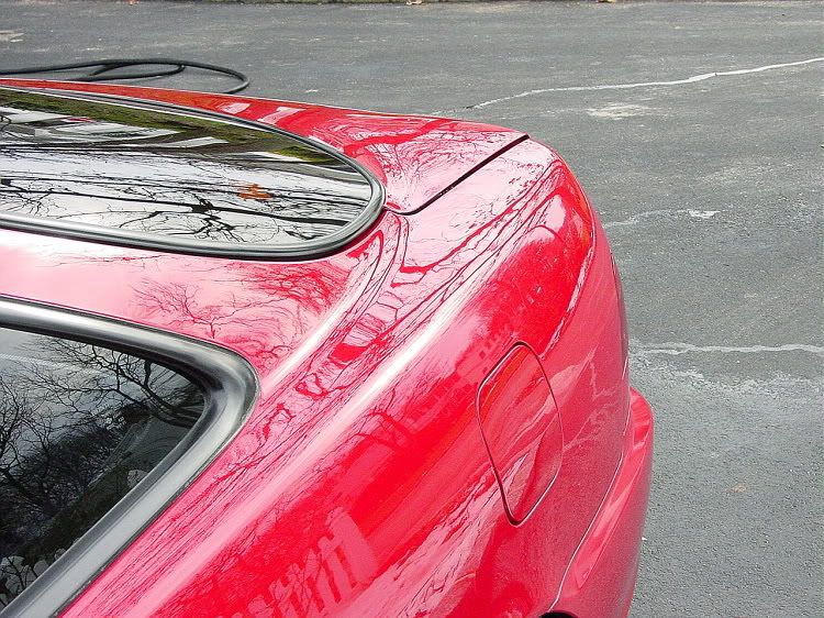

I liked this shot because it's a commonly neglected area
Oh yeah, new suspension went in this week ;)
-Tokico Pro-Kit in the front...3 'dead' coils removed
-H&R Race Kit in rear
-KYB AGX 4-way adjustable shocks all the way around
It is a 2" drop all the way around. I went with stiffer in the rear, 1) I got a nice deal on the set and 2) A lot of suspension guru's believe stiffer in the rear for better cornering.

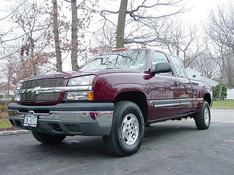

Next up, my mom's new Silverado.
She picked it up a little over a month ago and due to the horrendo! weather, no detailing until now. I did the interior and engine on separate days this week, but they're pretty un-impressive...it's new for god sakes :)
Anyways, the paint was lightly swirled from the dealer...Anyone here surprised? The paint was pretty smooth though, so I didn't clay. My final processes were:
-PB SS&S Wash
-Menzerna Final Polish via rotary and LC polishing pad @ 1500rpm
-Blackfire Sealant by hand
-PB Trim Restorer on all black trim
-PB BnB on tires

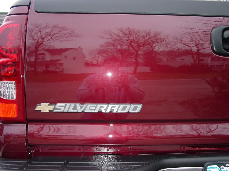

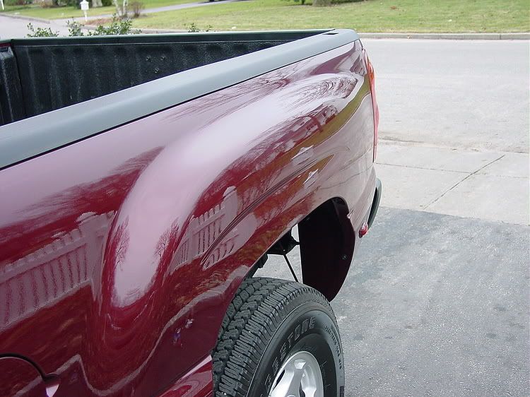

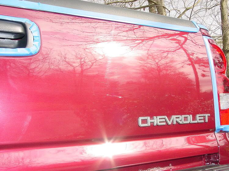

For the Blackfire, so far I'm not crazy about it. The look is what many refer to as "artificial"...lots of reflection/gloss, but little warmth/depth. I don't mind the look personally, but the application and removal were not that fun. At first it went on great, but then I noticed a little didn't go a long way. I applied more, but had to stay as thin as possible. I tried removing per panel, then let the last batch sit for 15 mins...No matter what, still took effort...This isn't a final review, but just initial thoughts. More when I experiment.
Before
After
So far the mods (for those who care) we have done...
-Removed "4x4" decals off rear fenders
-Removed "LS Quadra Steer" decal off cab
-Polished Billet Grille
-Polished Billet Bowtie
-Amber DRL's
-Sylvania Silverstar's (low/high beams)
On the way, chrome nerf bars, painted cap, tint the windows, Flowmaster exhaust, OE fog lights (w/Silverstars), and a rim/tire package.

O4Cobra: It did a nice job on them. I do single, overlapping passes with light pressure. I just go very slowly over the surface...2-3 secs per foot of panel. It was FP by the way, not FPII. The tape I use is 3m Painters Tape. It is a clean release type and works great. I think it's about 2 dollars per roll and I get it at Wal-Mart.

They both look great Sean! Don't you just love getting to that lip under the badges on the tailgate. ;)

blkyukon: SUCKS! I changed positions a lot...Thank god the rotary works quickly, but yes, the worst part of buffing out this one.
