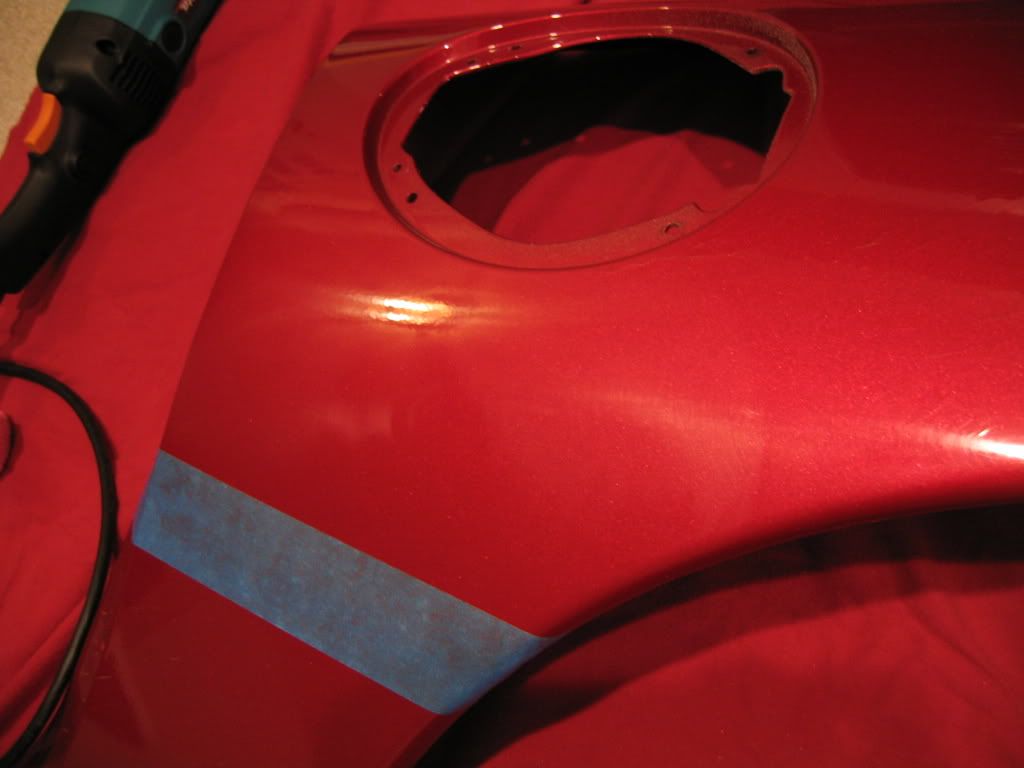

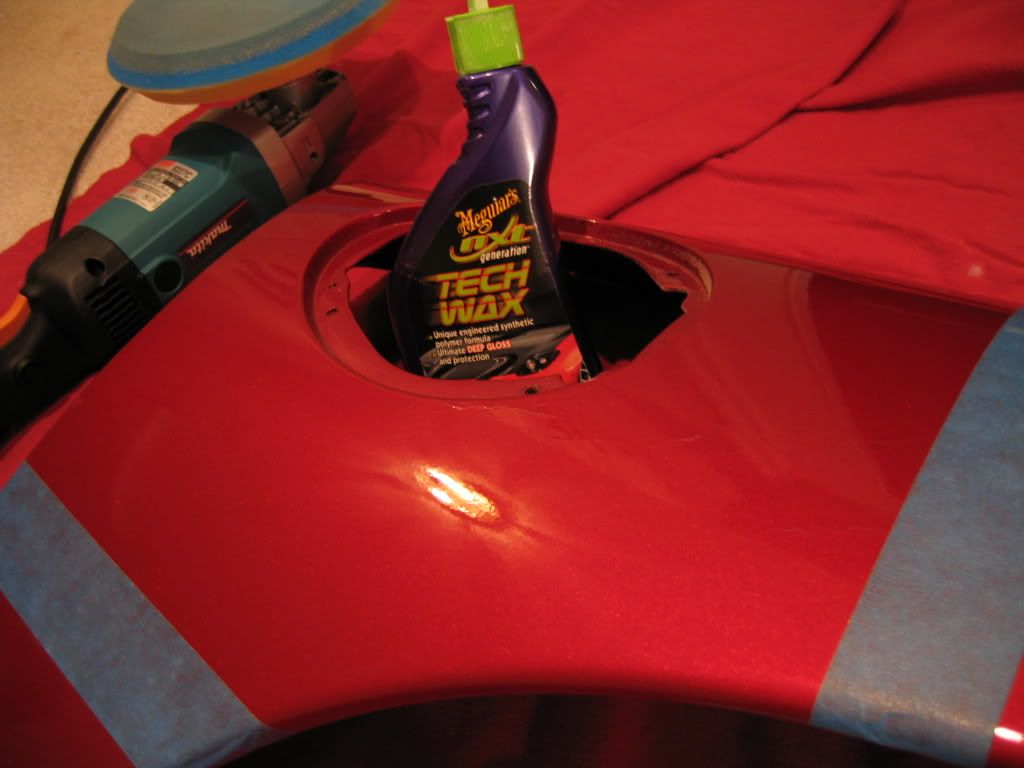

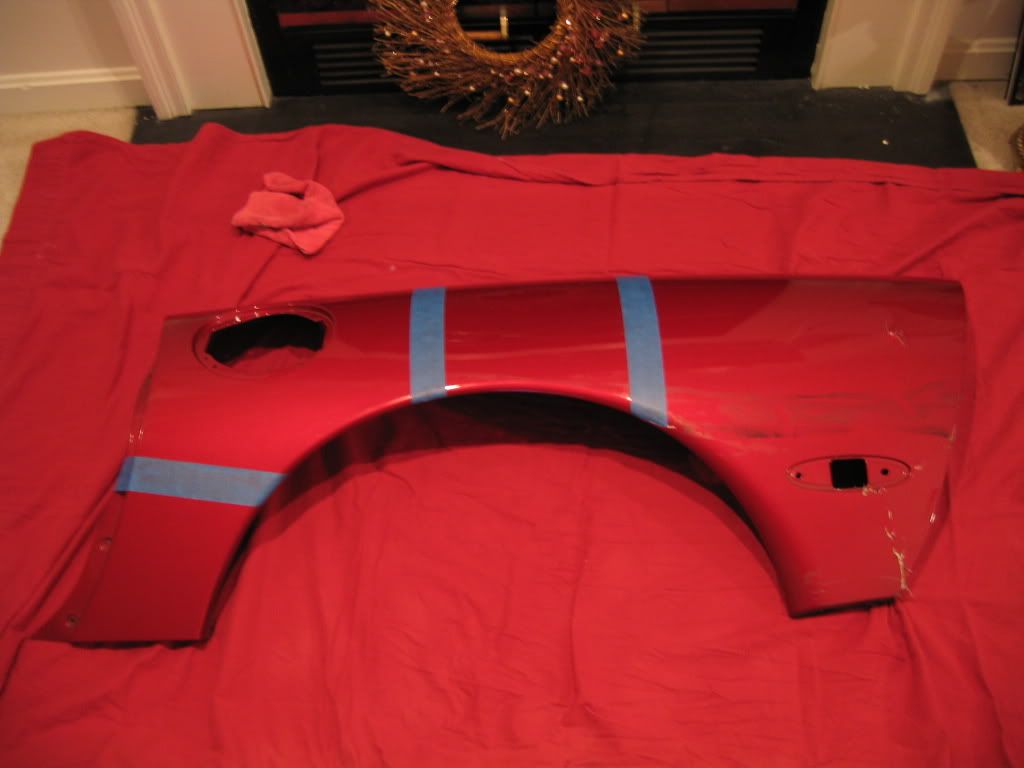

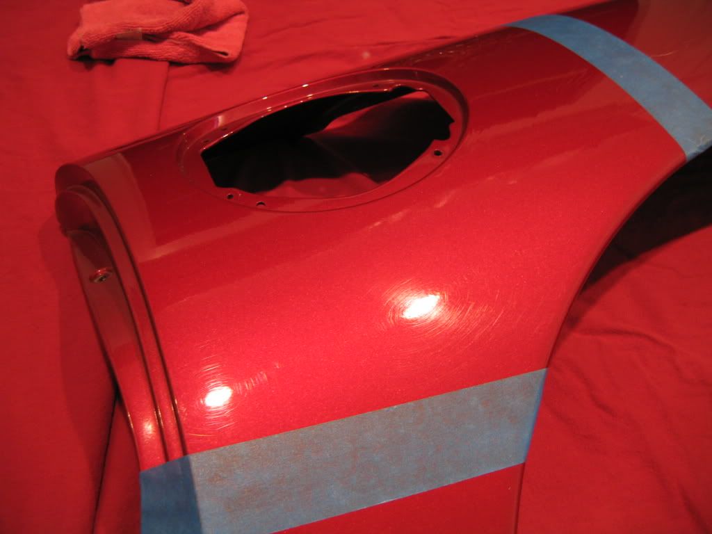

with this combo, it was really hard to burn the paint - I would just hold it down and stayed still for 20 to 30 seconds and at that point I started smelling the burnt paint and stopped. I guess I could have kept going but It was long enough for me to have an idea.
the small panel
before
scretched

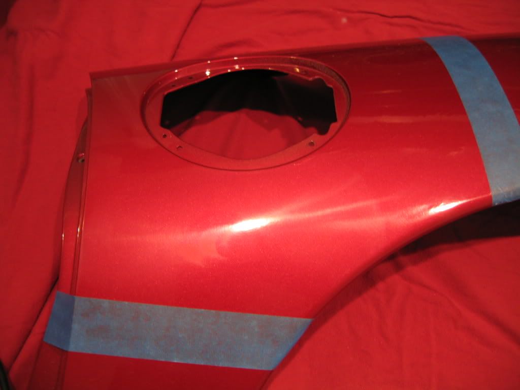

burned with yellow Edge 2000 cutting pad at 1500 (these are huge pads) and ssr3
left side burned, right side untouched - should see the the line

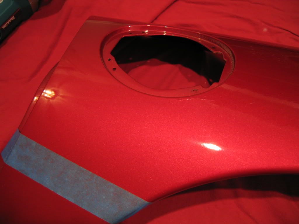

#80 with polishing pad at 1200 (2 passes) - boy, does #80 behave different with a rotary! (better)
nxt to top it.

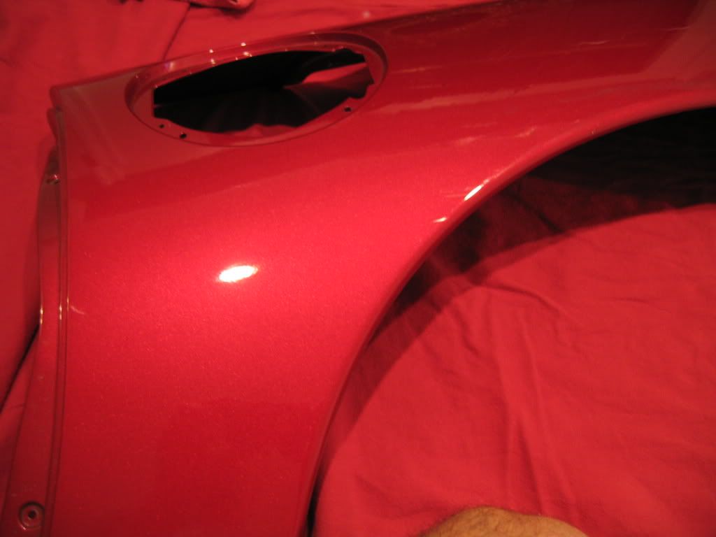

EDIT - Took another picture from the same angle as the others.
Looks perfect, but does it feel any different? Do you think the cells from the foam might have 'warped' at all from the heat? How hot was the paint surface after you lifted the pad off of it? (Or were you smarter than to actually touch it like some certain teen would have... :o)
I put another NXT picture up - look at it. I spun the pad and it feels fine. I'll recheck tomorrow when it is dry. I did touch the paint but not right afterwarss! It looked too hot. Even after awhile it was hot.

Great job. All in all with the rotary as long as you keep it at 1800-2000 max and keep it moving its not "easy" to burn the paint. Are you using the 8" pads? I actually like the 7.5-8" for rotary work.
