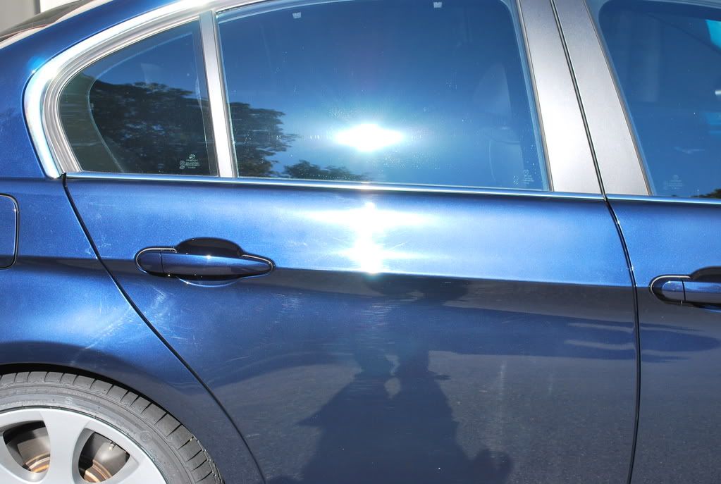

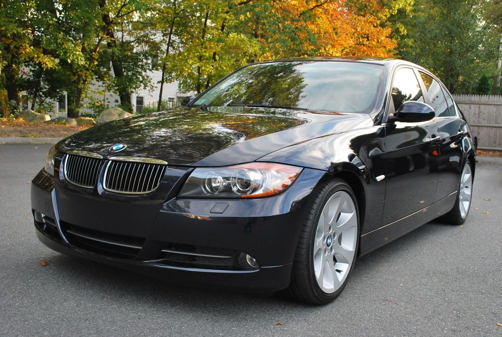

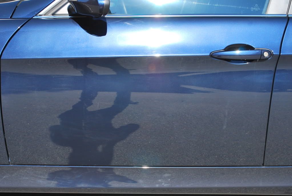

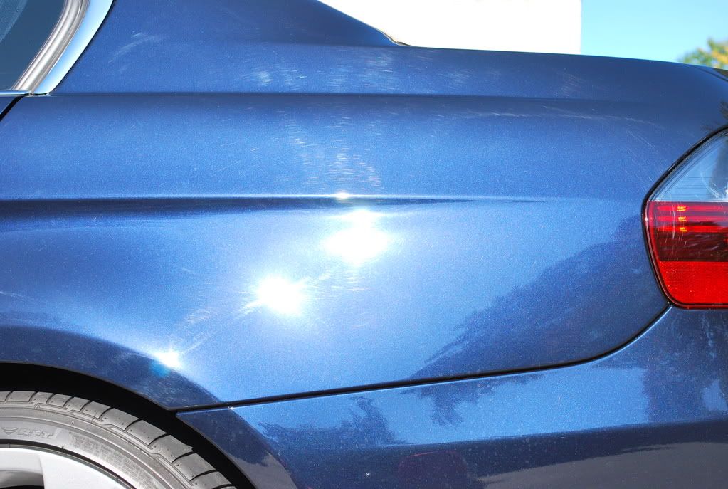

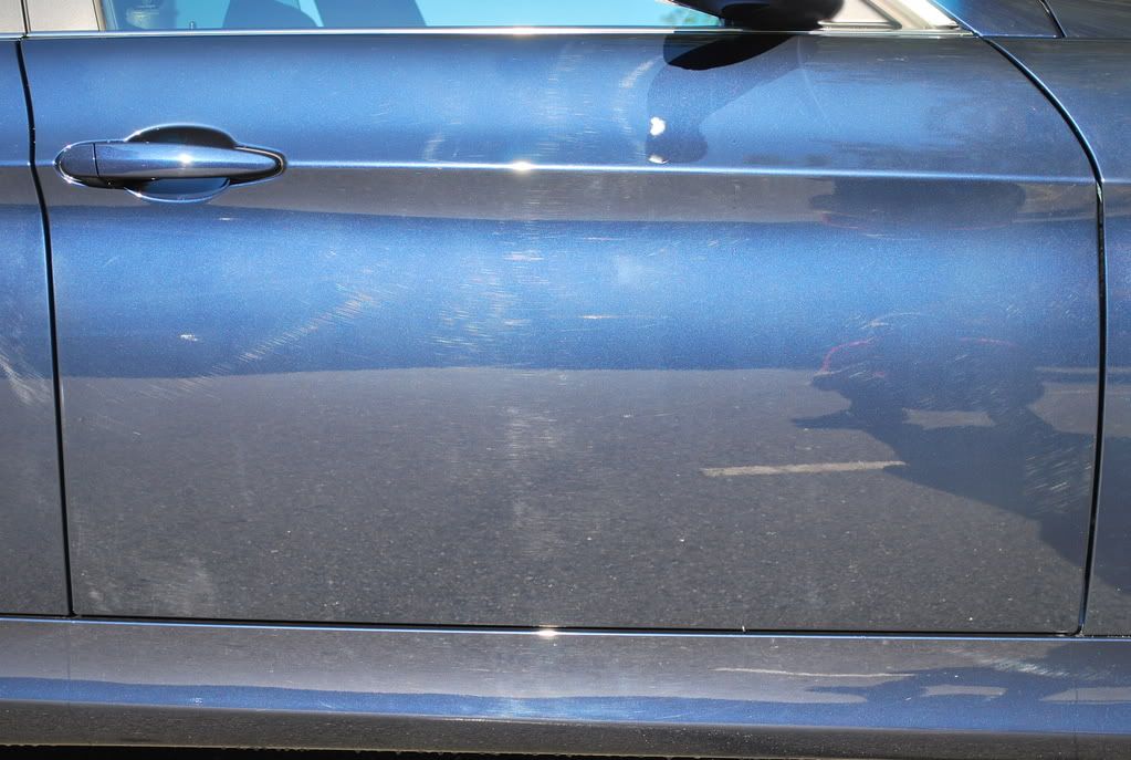

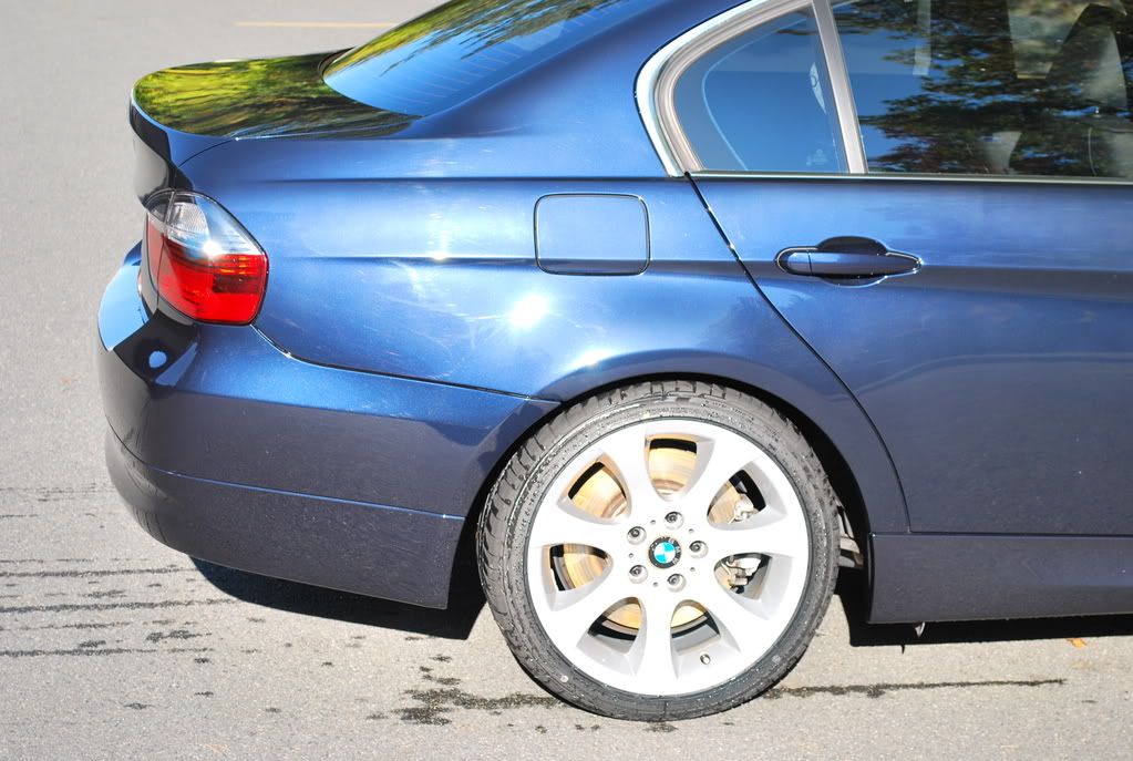

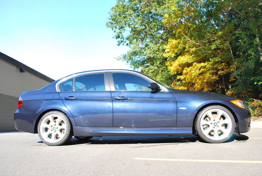

When the vehicle arrived at the shop, the paint had a very dull and sterile look to it. It lacked any depth and gloss and seemed to have a satin/semi-gloss finish.
Below is what the vehicle looked like upon arrival…

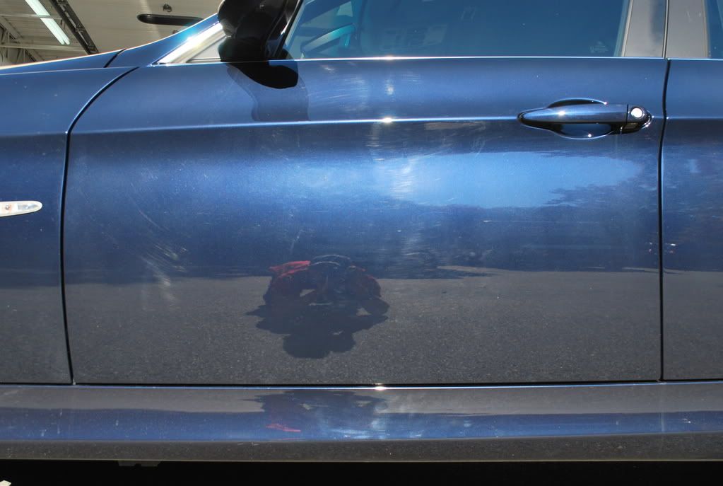

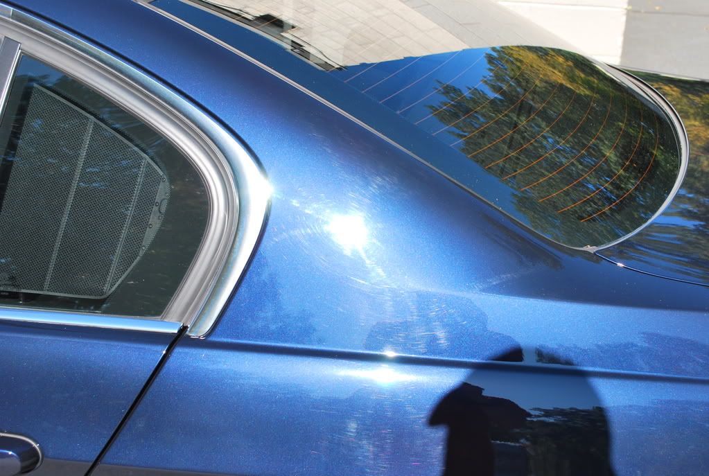

After the washing process was complete, I pulled the car into the shop and began prepping it for polishing. I dried the car, wiped all door, hood and trunk jambs clean and wiped down the complete exterior with 91% alcohol to ensure a perfect foundation for polishing. I brought the vehicle back outside one last time to inspect the finish now that the previous wax, polish or silicone had been stripped from the paint, revealing the true condition.

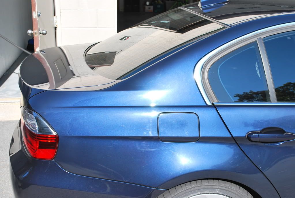

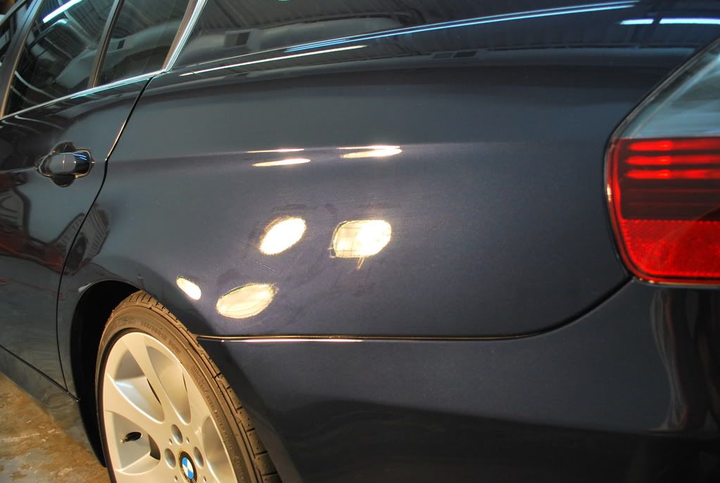

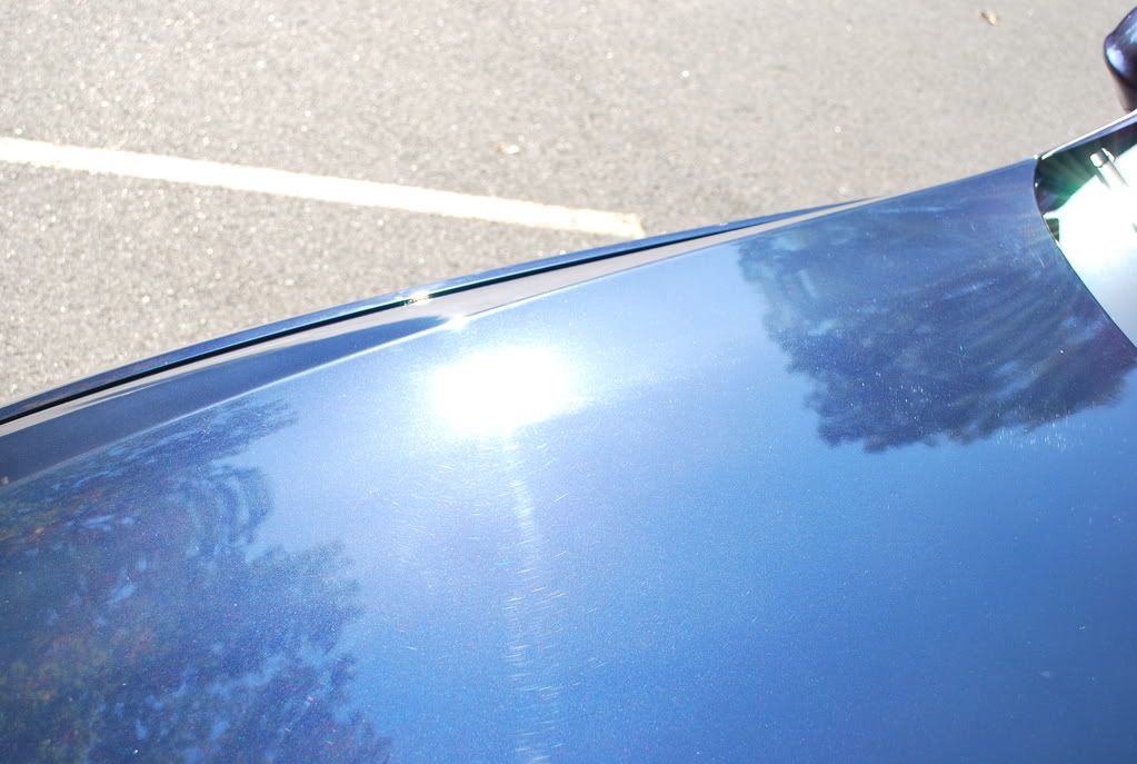

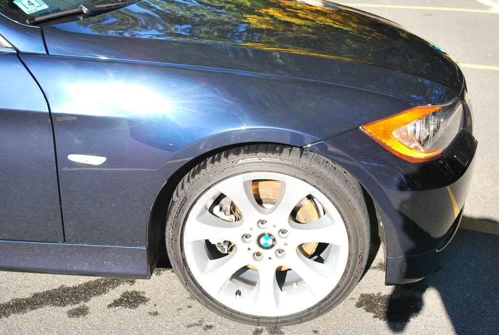

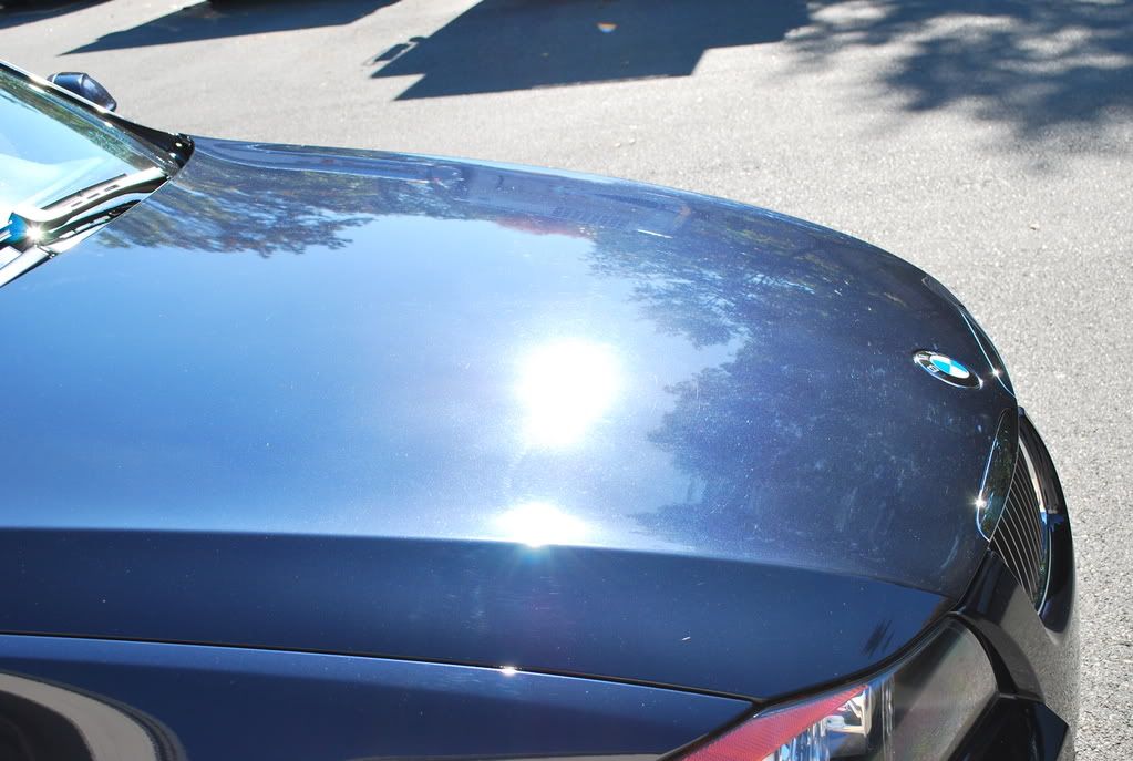

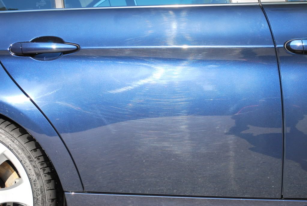

Below is what the car looked like after the wash…
As you can see, the finish looks a bit more dull now that the paint was stripped free of any previous products which were concealing the true condition of the paint.

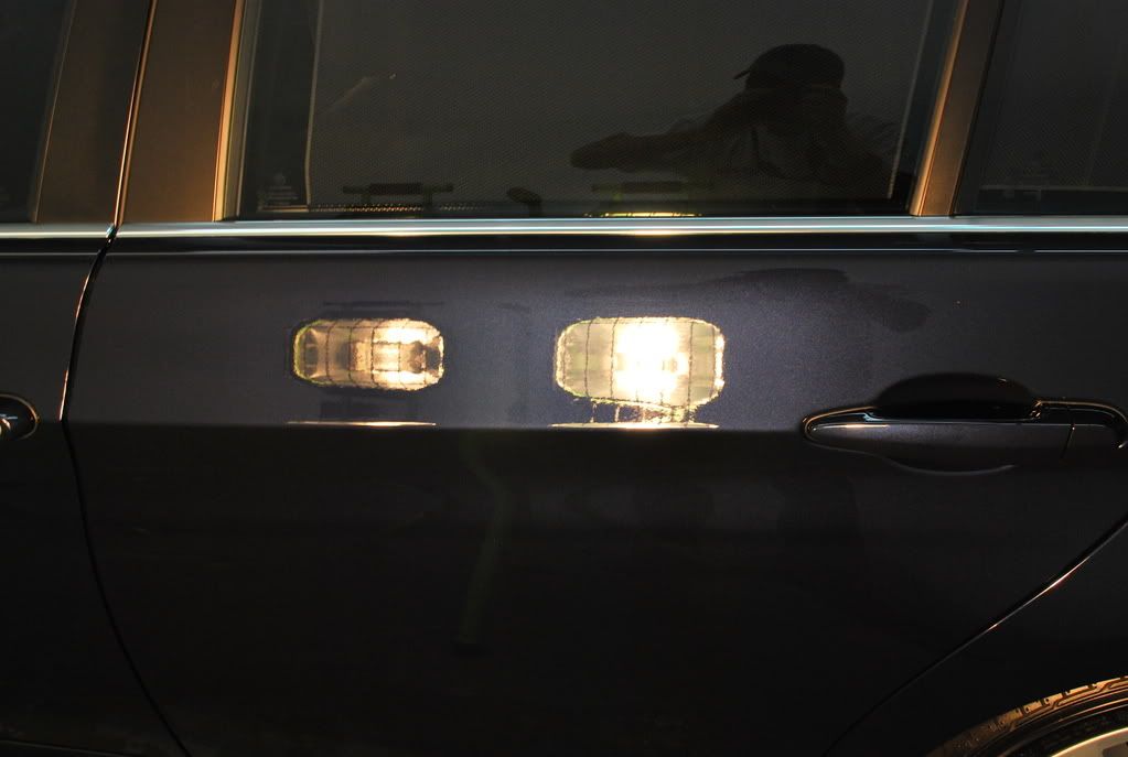

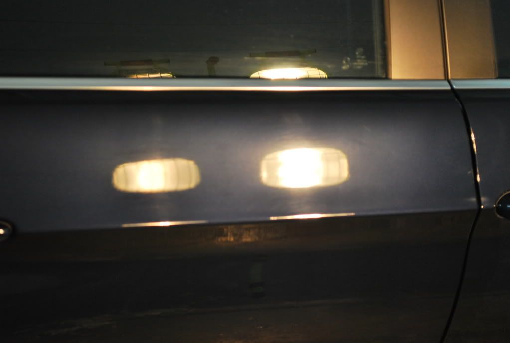

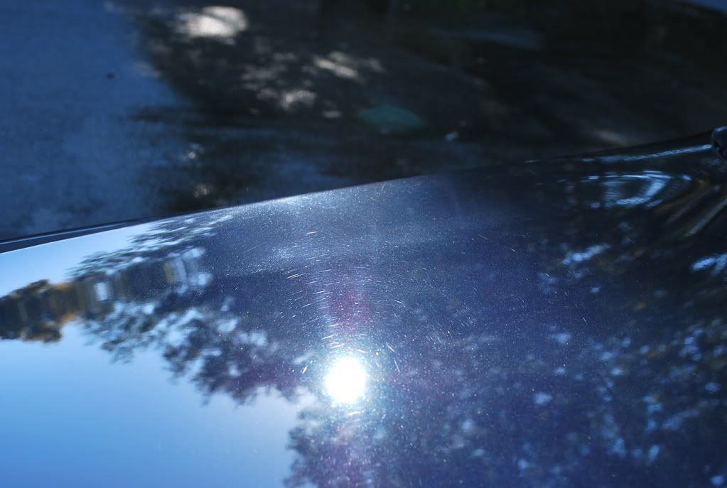

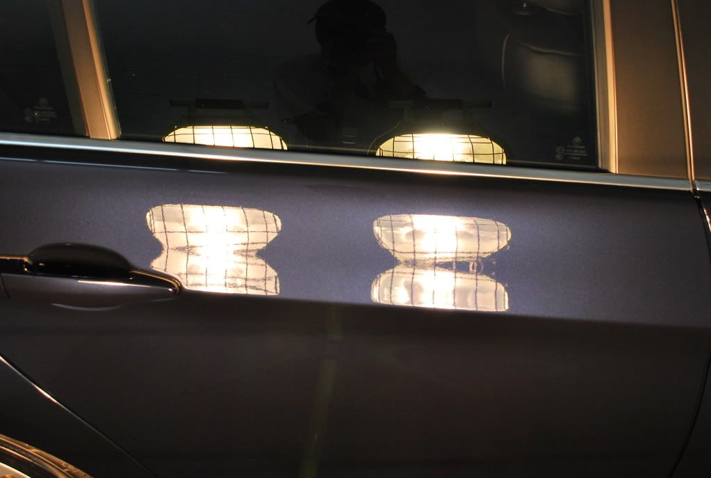

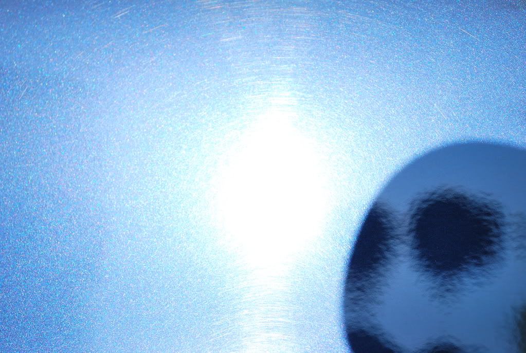

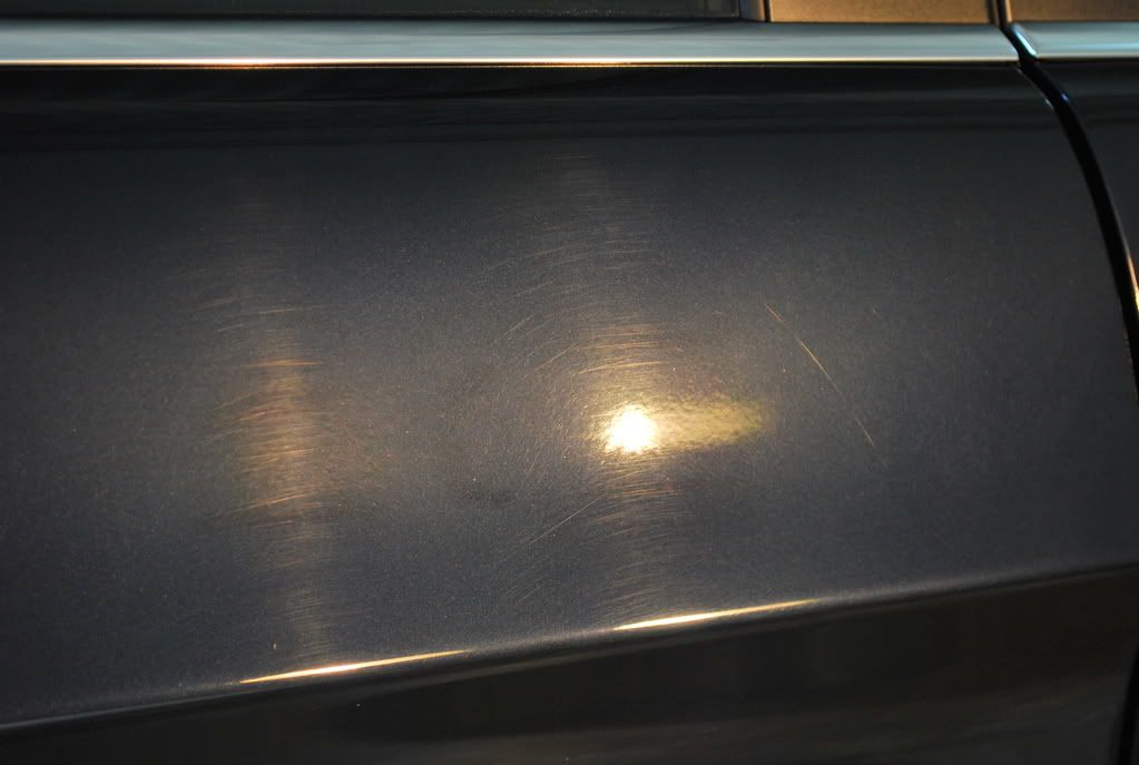

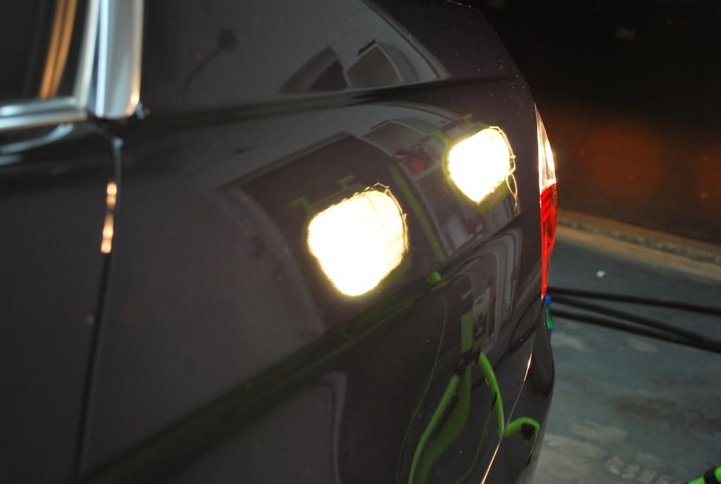

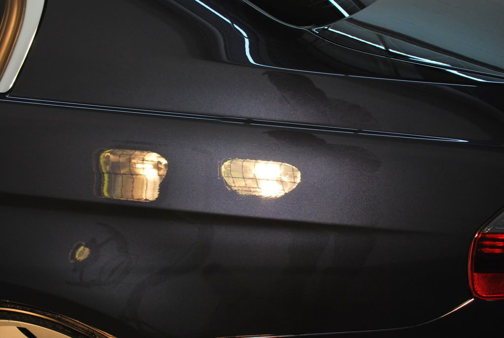

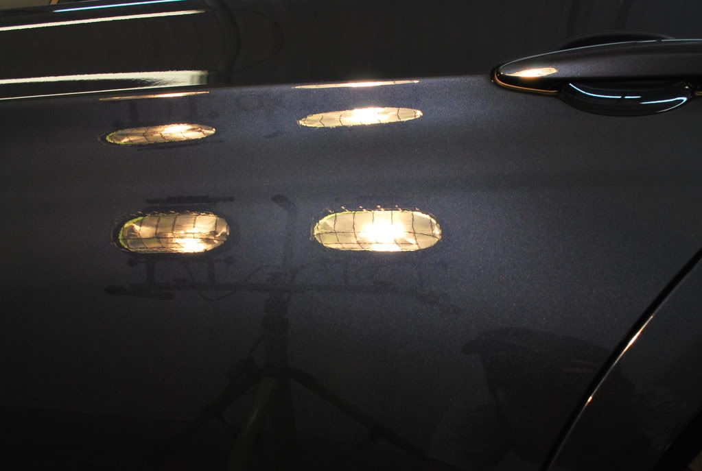

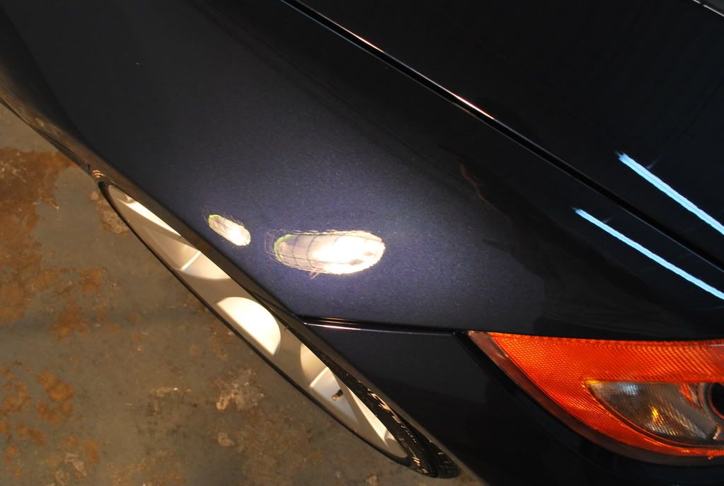

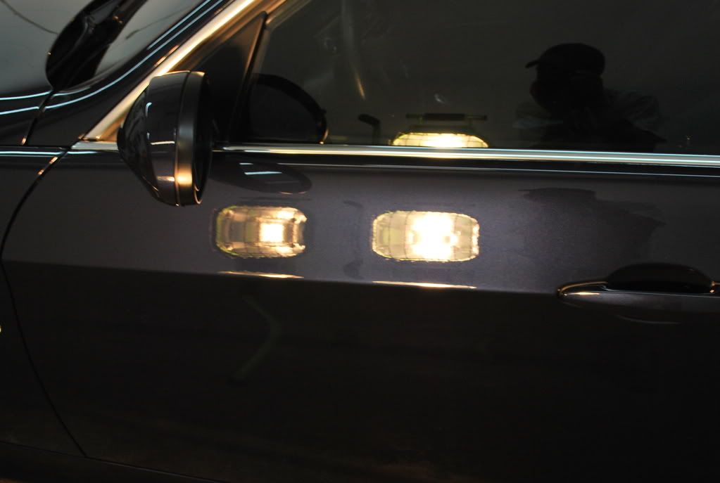

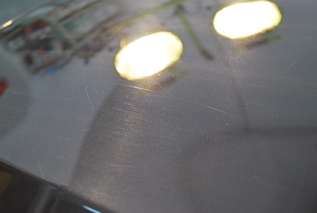

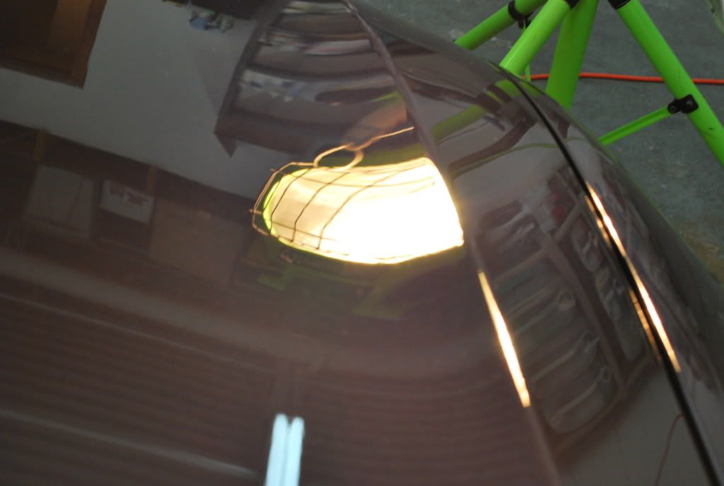

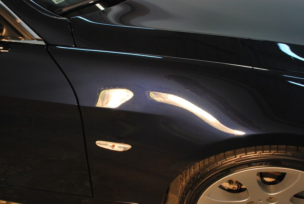

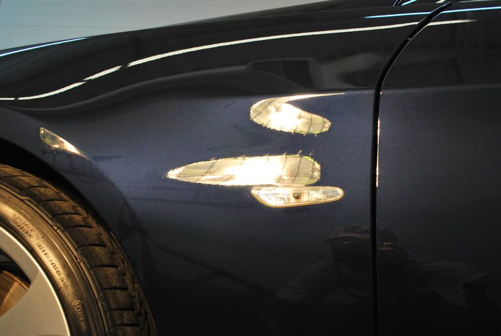

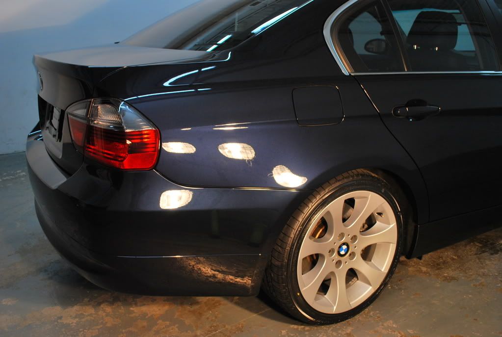

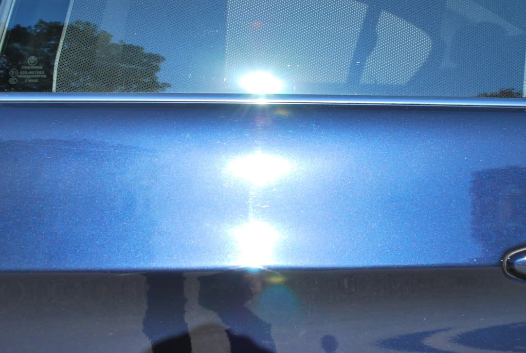

After inspecting the car in the sunlight, it was clear that whatever products the dealer tried to use did not break down properly and mircomarred the finish, giving the paint a very dull look. My theory is that a random orbital polisher was used with a product that was too aggressive for this particular paint. There were very fine squiggly marks present, which are often caused from a random orbital polisher and some straight line scratches which were most likely from the dealer when washing it.
Below is what the finish looked like under halogen lighting…

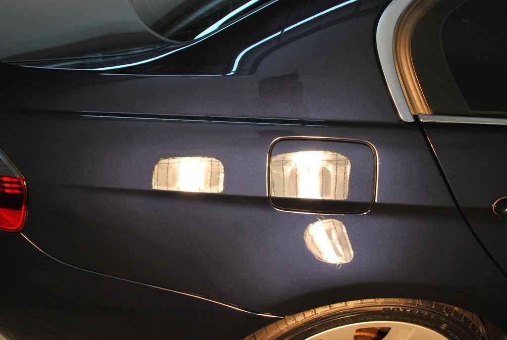

Specific areas were masked off with masking tape such as the door handles, side moldings and other critical areas.

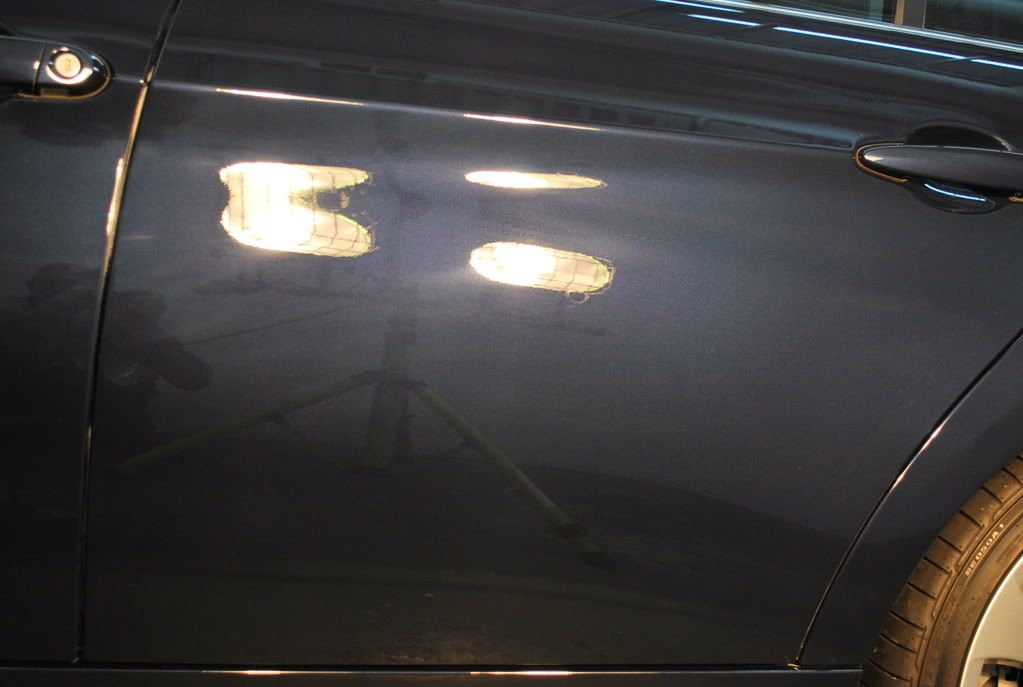

I chose a test panel to decide which products/pads worked the best on this particular paint. After some testing, I found that Menzerna Power Cut using a black Tuf-Buf lambs wool pad worked great at removing all of the serious defects.
I buffed the complete exterior with Menzerna Power Cut using a black Tuf-Buf lambs wool pad, polishing each panel 2-3 times until all major defects were removed.

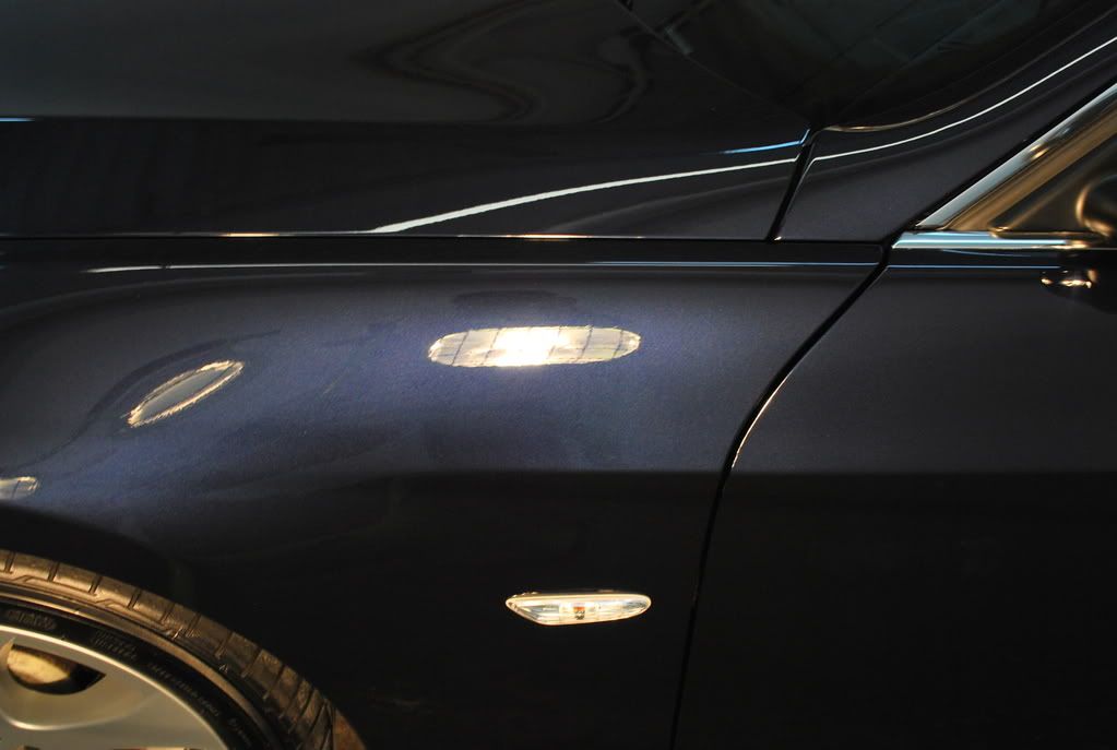

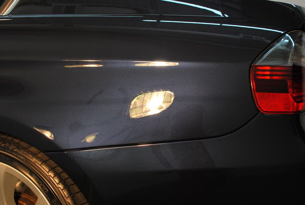

Below is what the finish looked like after Menzerna PC/black lambs wool combo…

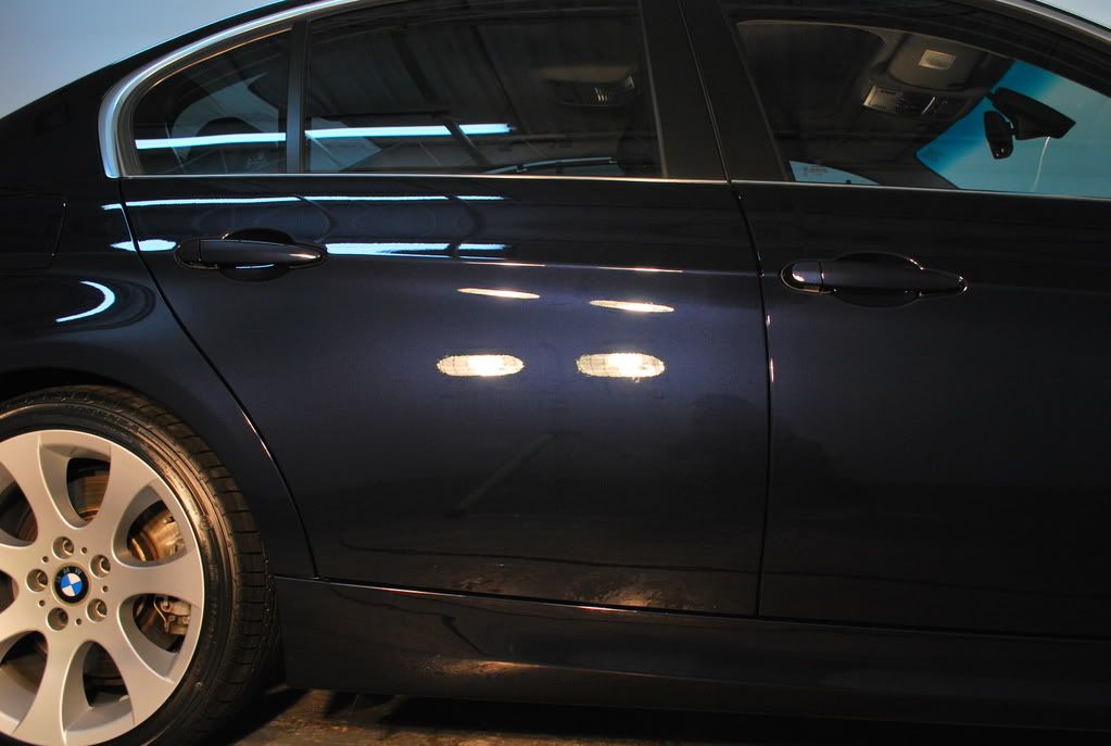

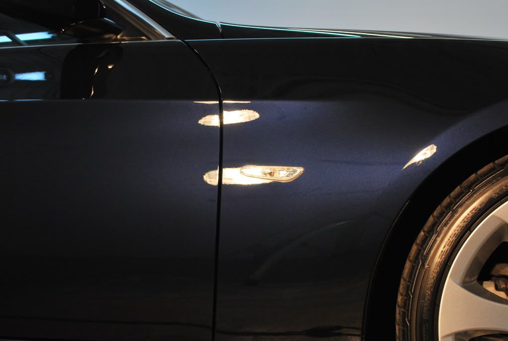

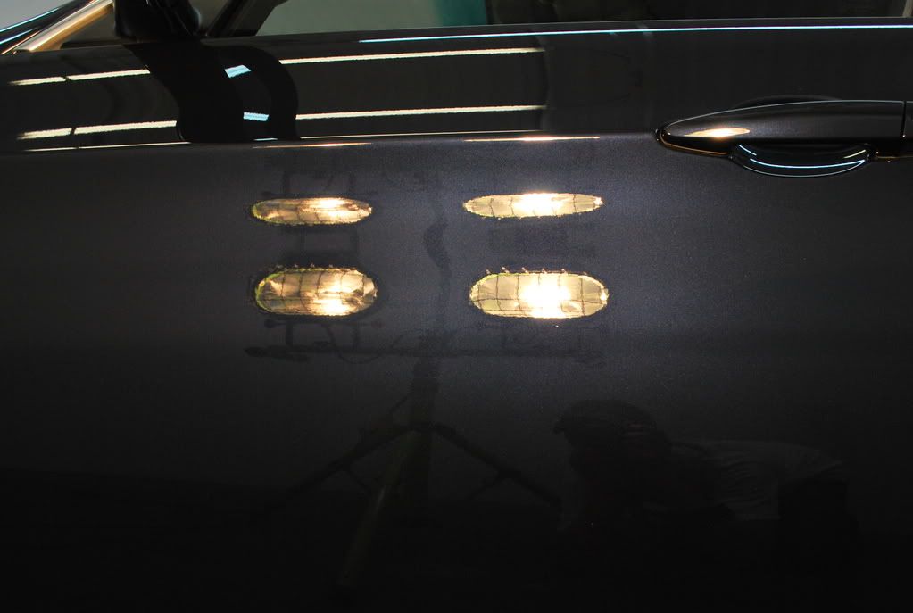

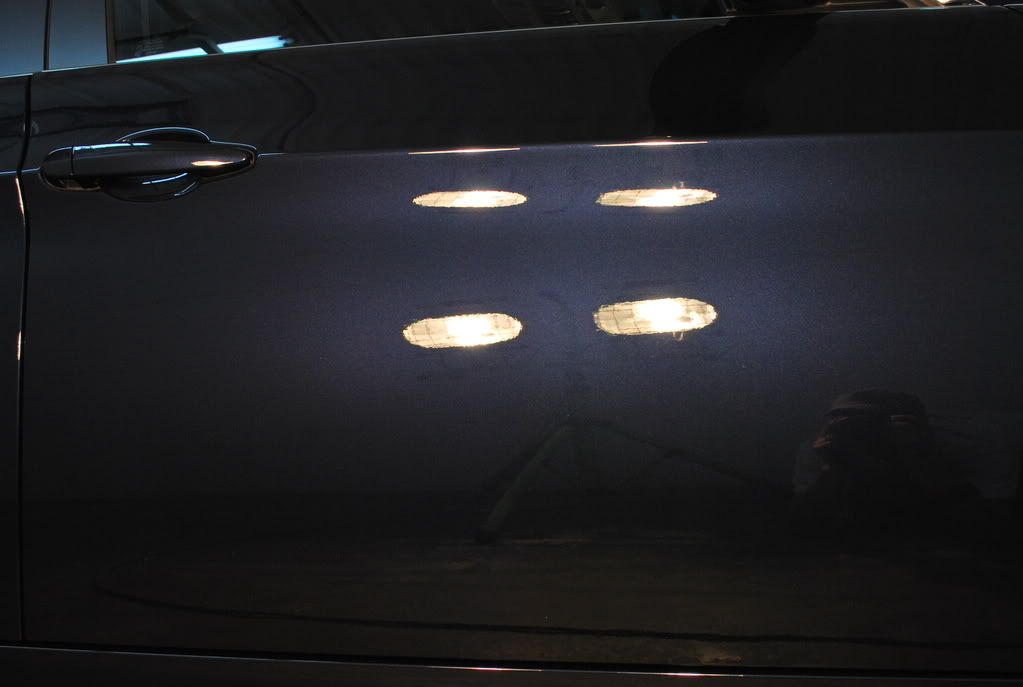

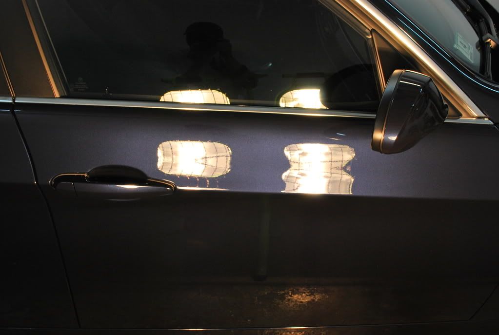

To remove the holograms caused from the previous step, I polished the complete exterior with Menzerna Super Intensive Polish using a white Sonus foam polishing pad. This step dramatically improved the finish, leaving the paint swirl-free and ready for the final polishing step.
Below is what the finish looked like after the SIP/white Sonus foam pad combo…

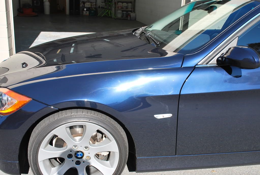

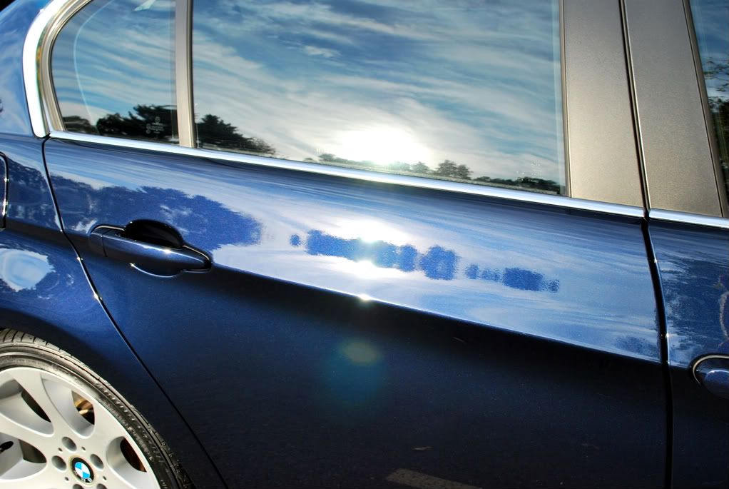

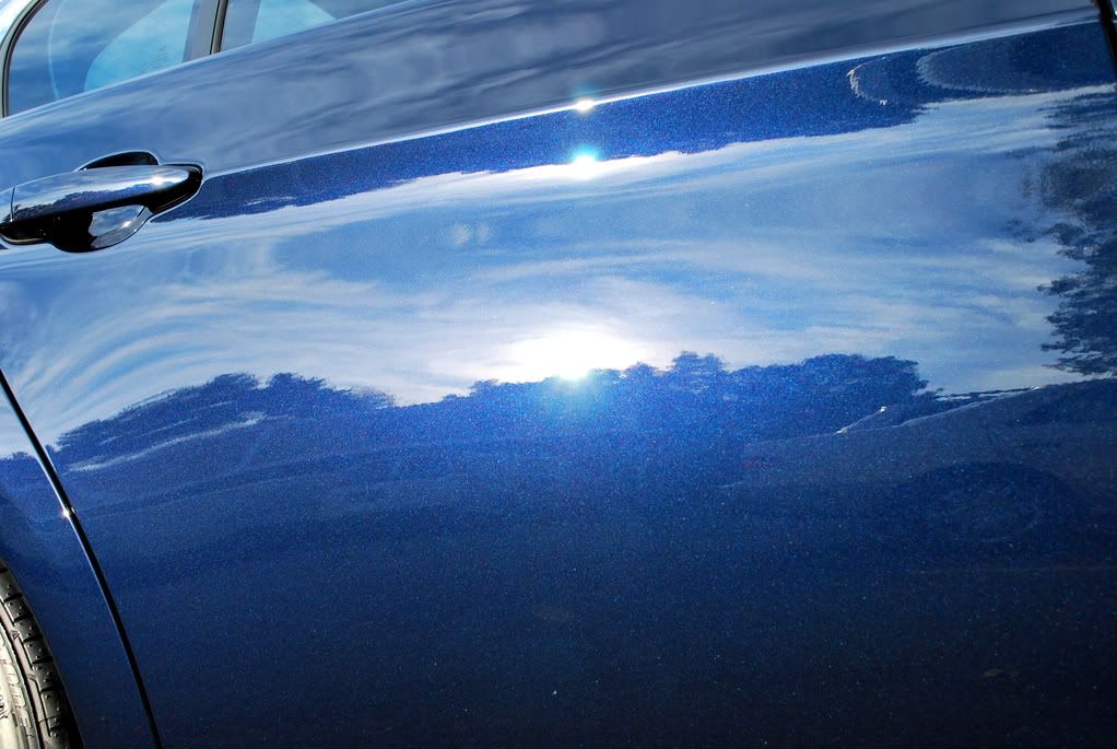

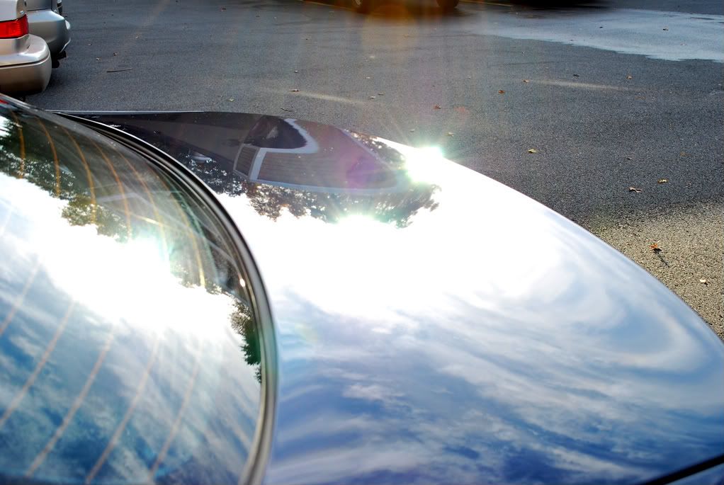

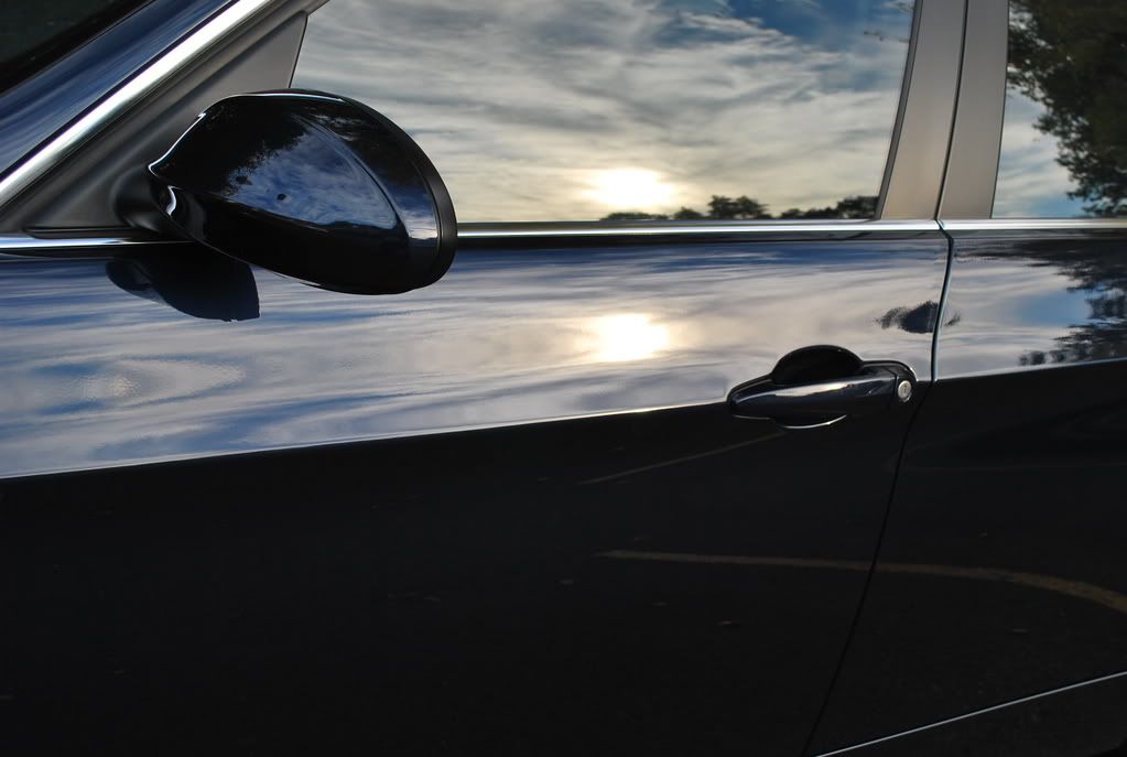

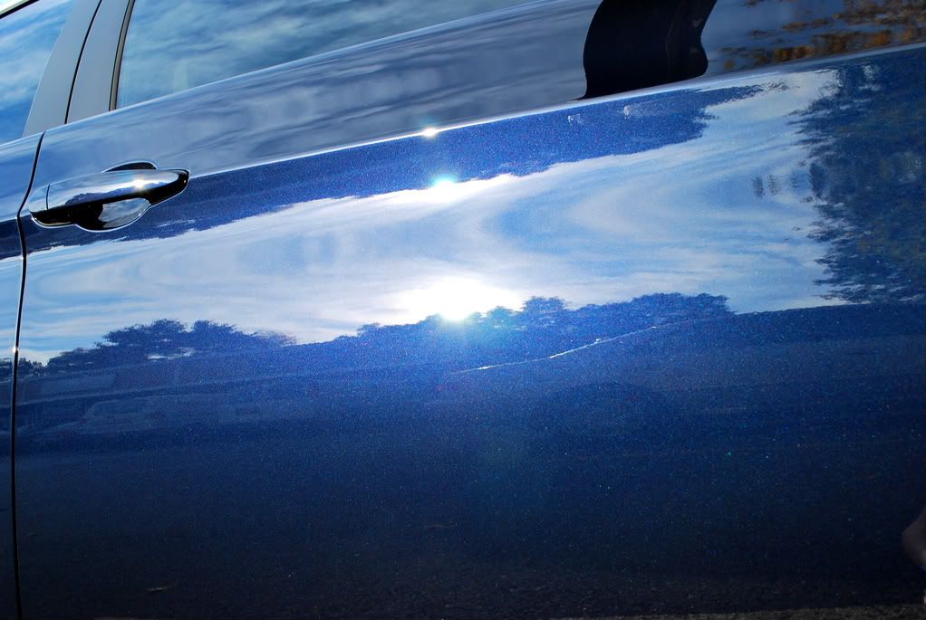

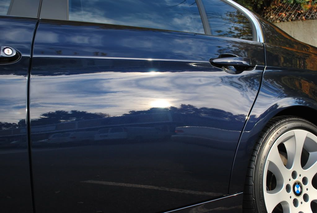

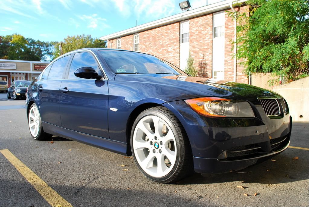

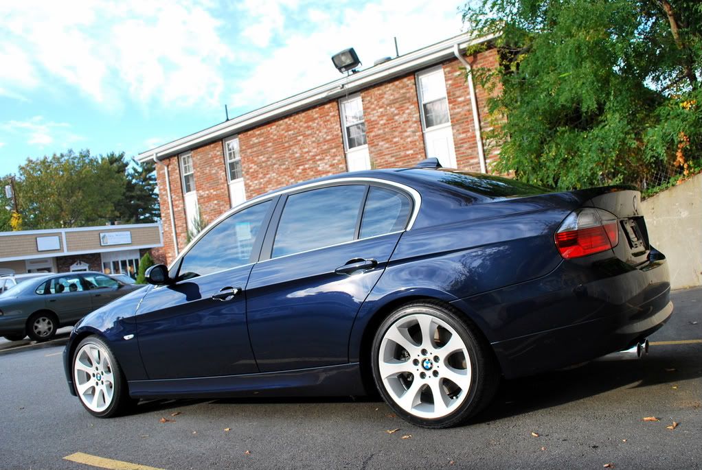

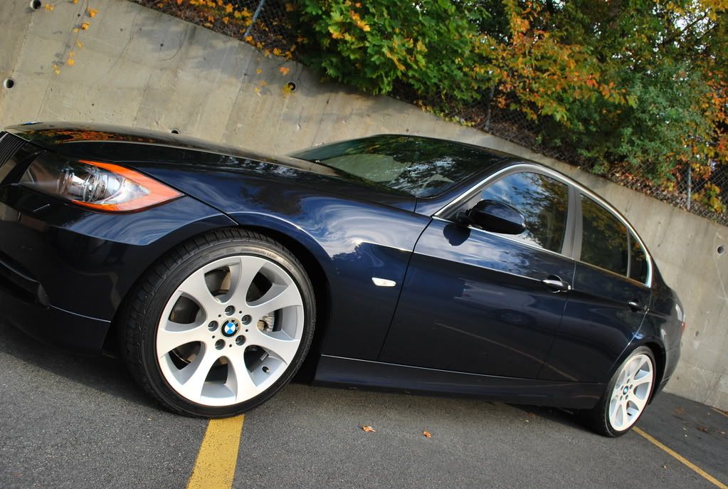

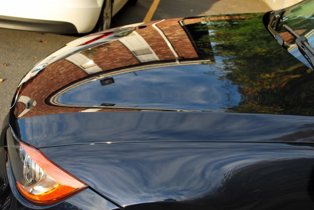

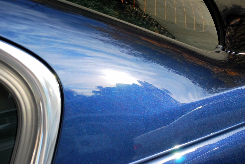

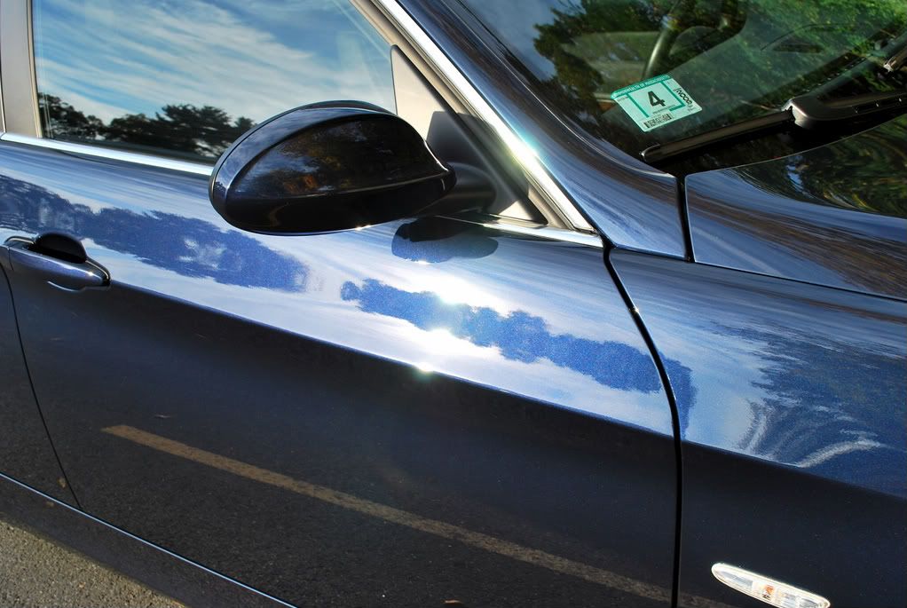

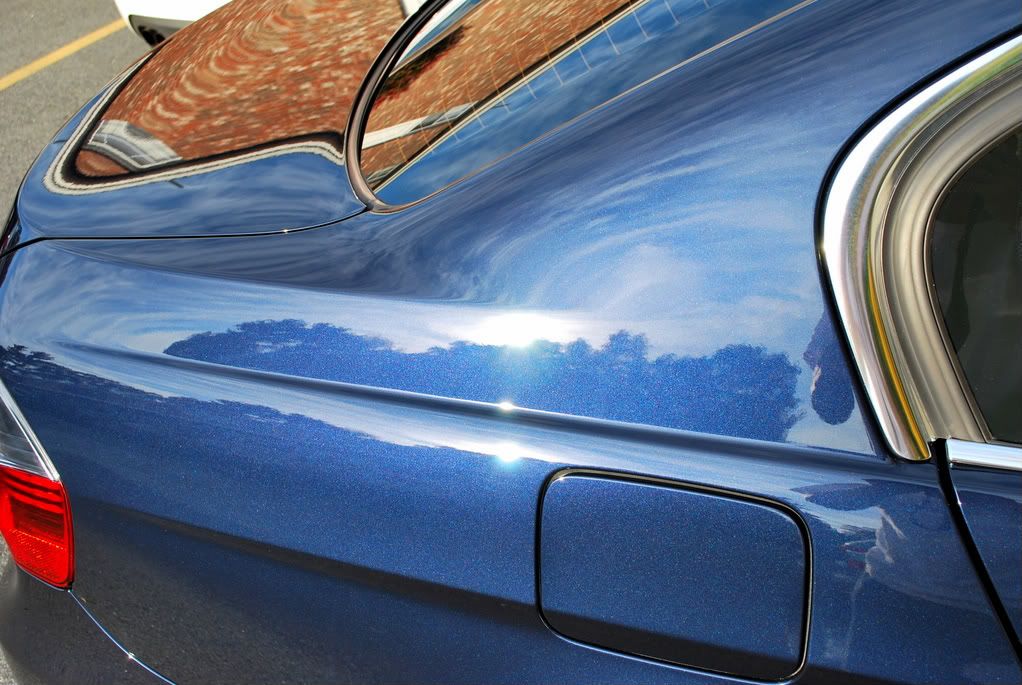

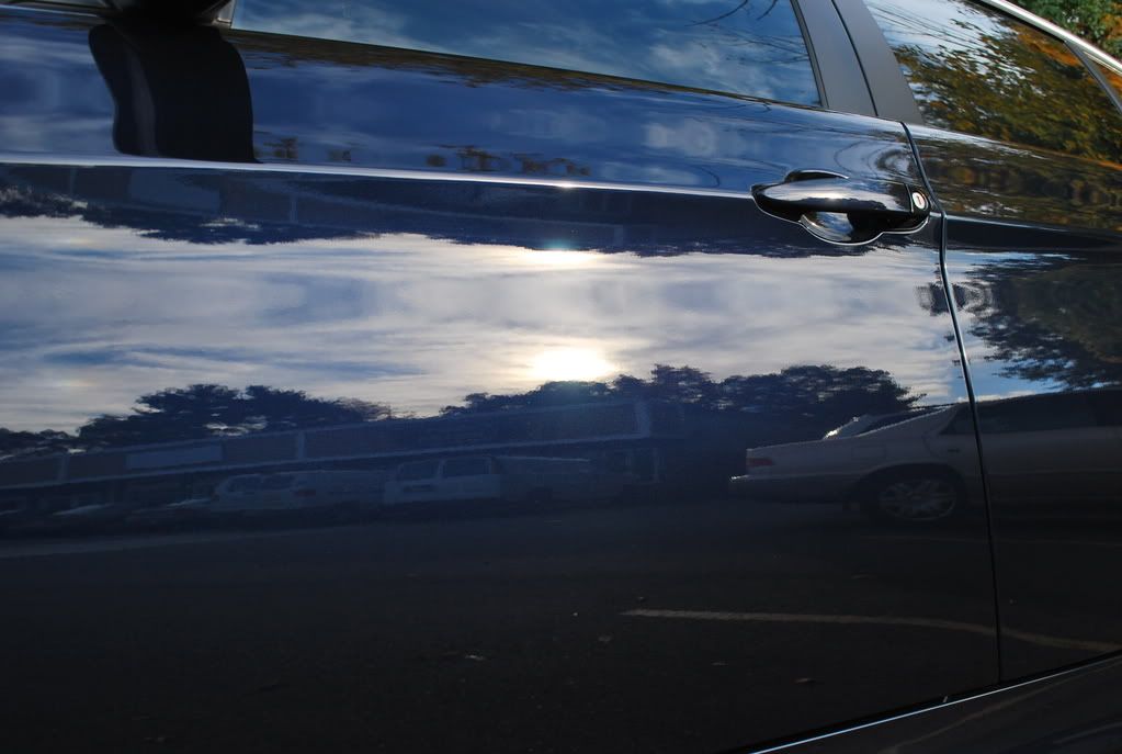

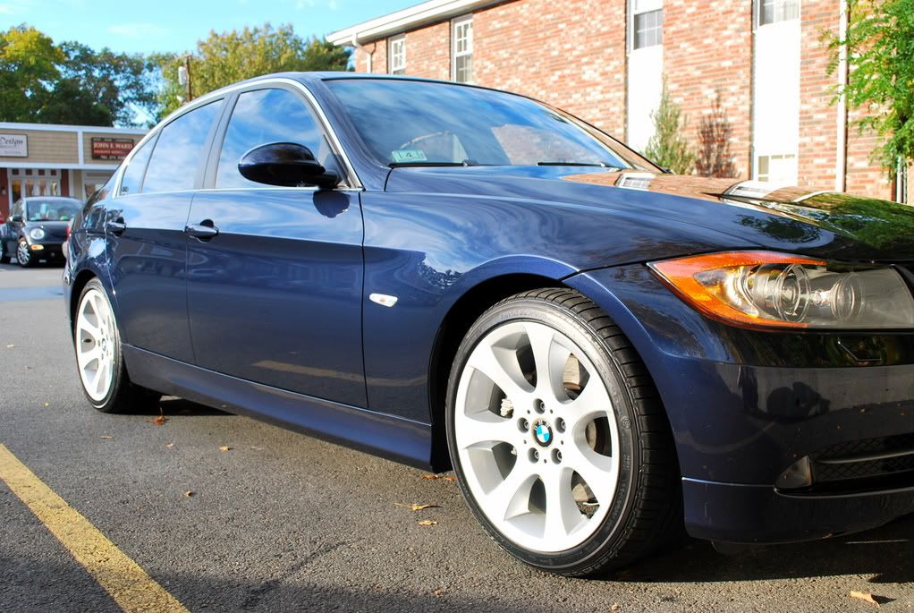

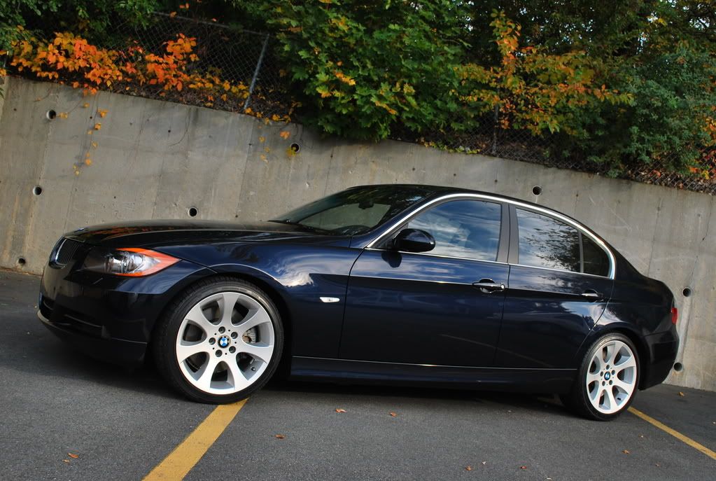

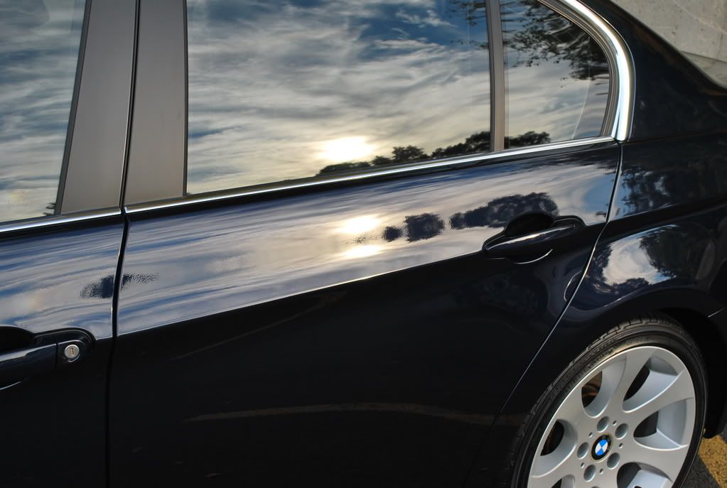

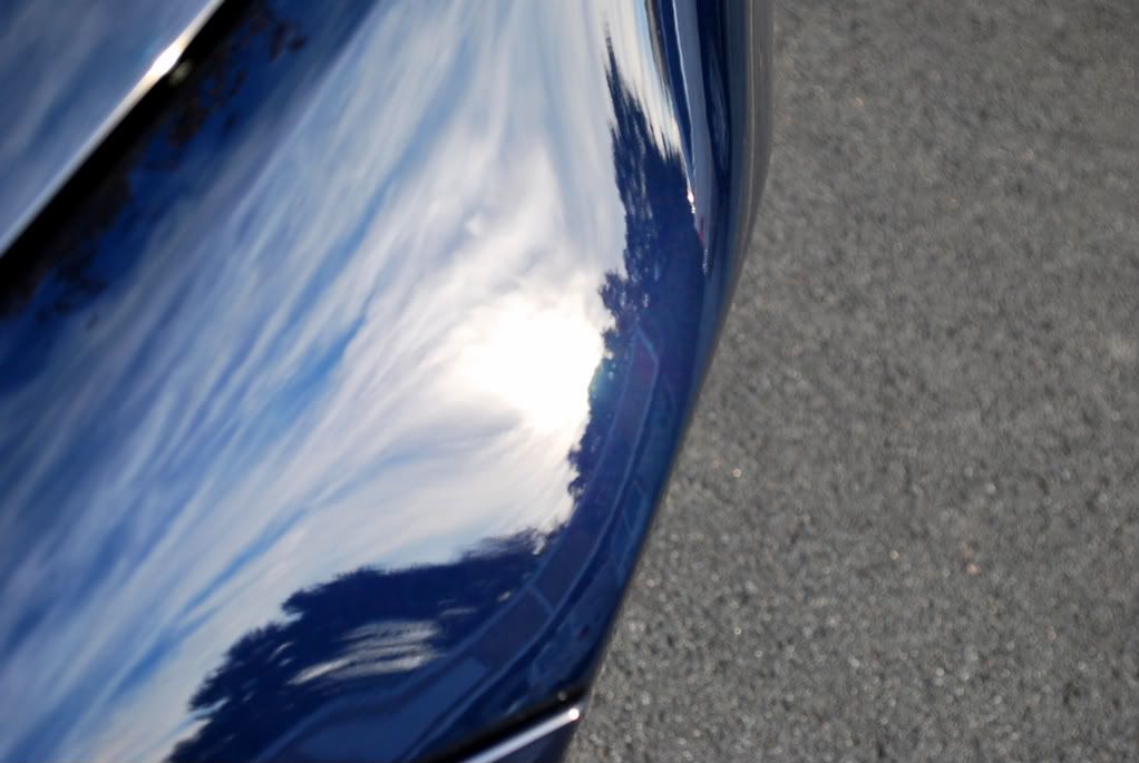

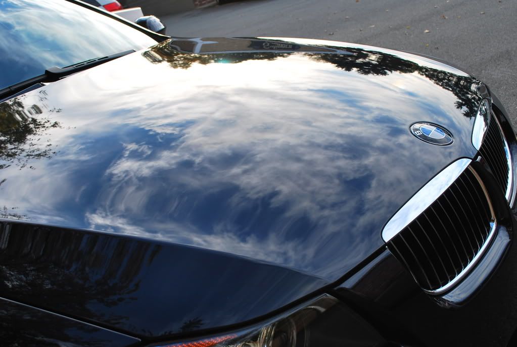

Next, the complete exterior was polished using Menzerna 85rd to ensure a perfect high gloss finish. Upon completion, I wiped the entire vehicle down with 91% alcohol and inspected the finish under halogen and xenon light sources to ensure the finish did not need any additional polishing. After passing inspection, I decided to bring the car outside to get a few sun shots before the sun went down.
The pictures below were the only sun shots I was able to get before the sun went down below the trees… These were taken before any wax or sealant was applied to the paint, windows cleaned, exhaust tips cleaned & polished, etc…
After taking the previous pictures outside, I pulled the car back into the shop to do the finishing touches. I applied a coat of Bilt-Hamber Auto Balm by hand to the complete exterior and wheels, removed it using a microfiber towel and did a Zaino Z8 wipedown.
All tires and wheel wells were dressed, the chrome exhaust tips were polished with Deep Chrome and all exterior glass was treated with Opti-Seal. For the final step, I applied a thin coat of Collinite No. 915 followed by Z8 for added looks and extended durability.

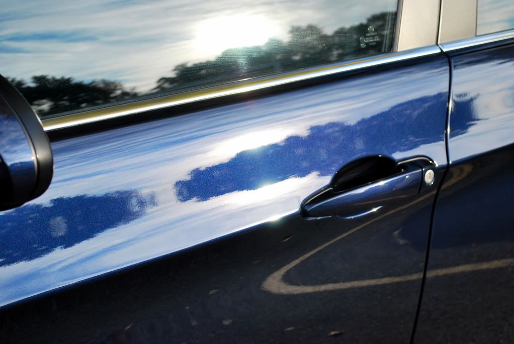

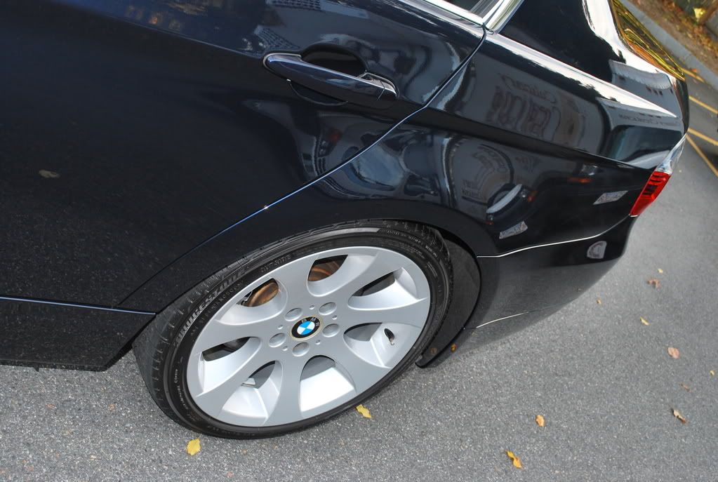

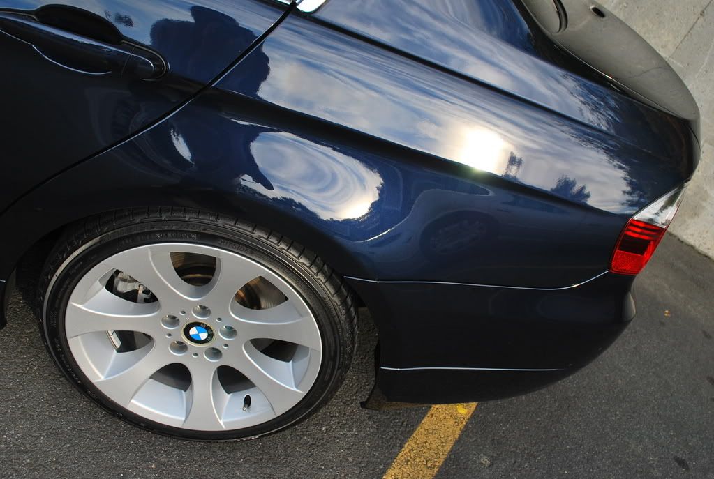

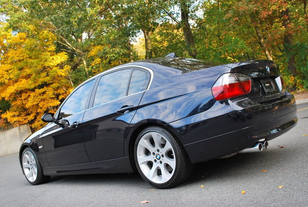

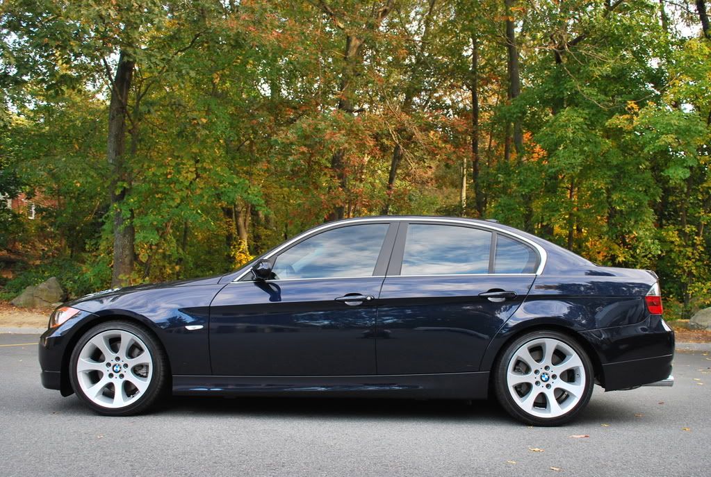

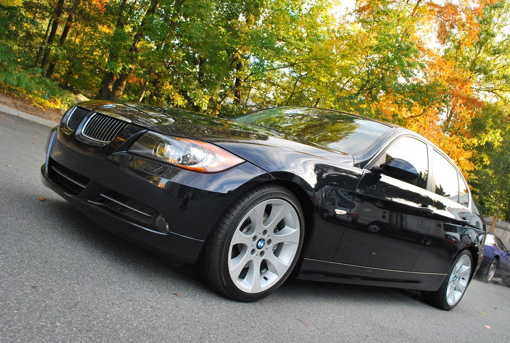

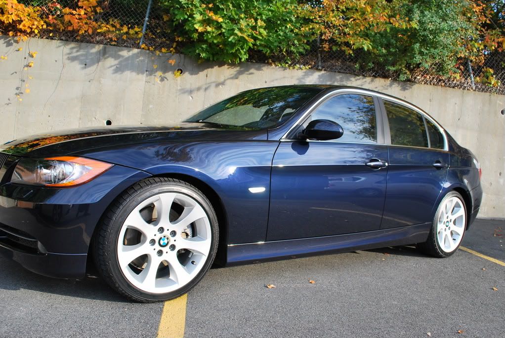

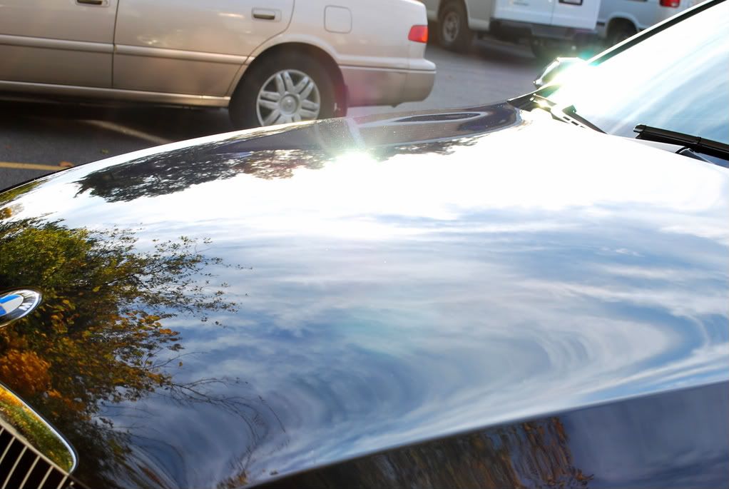

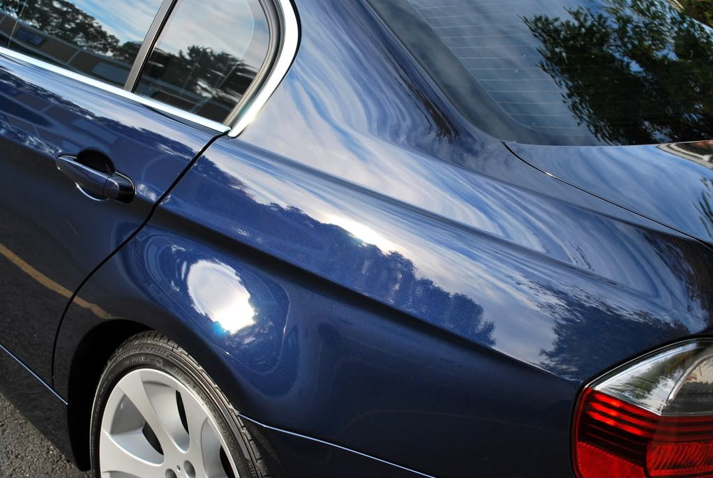

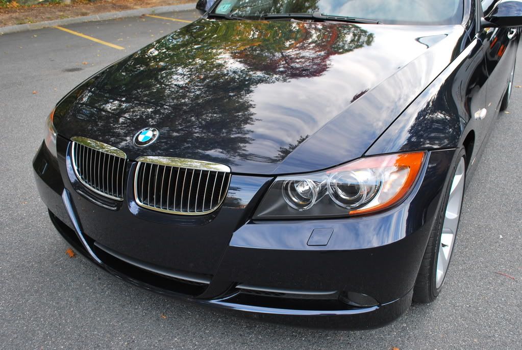

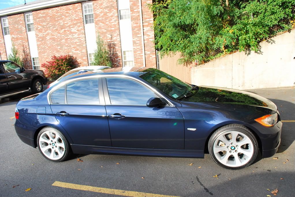

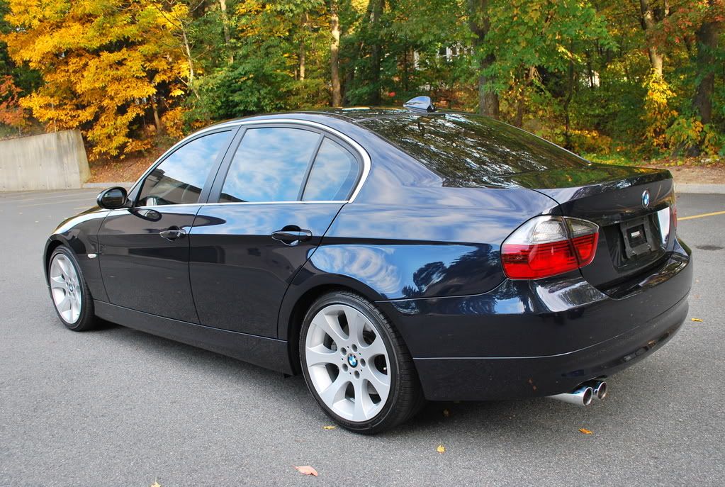

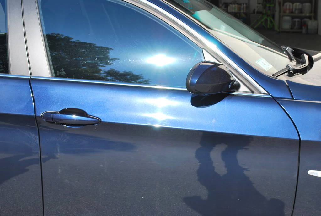

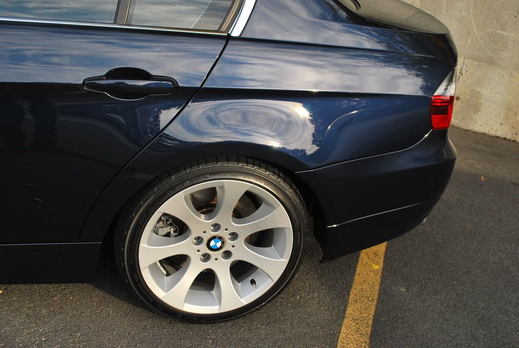

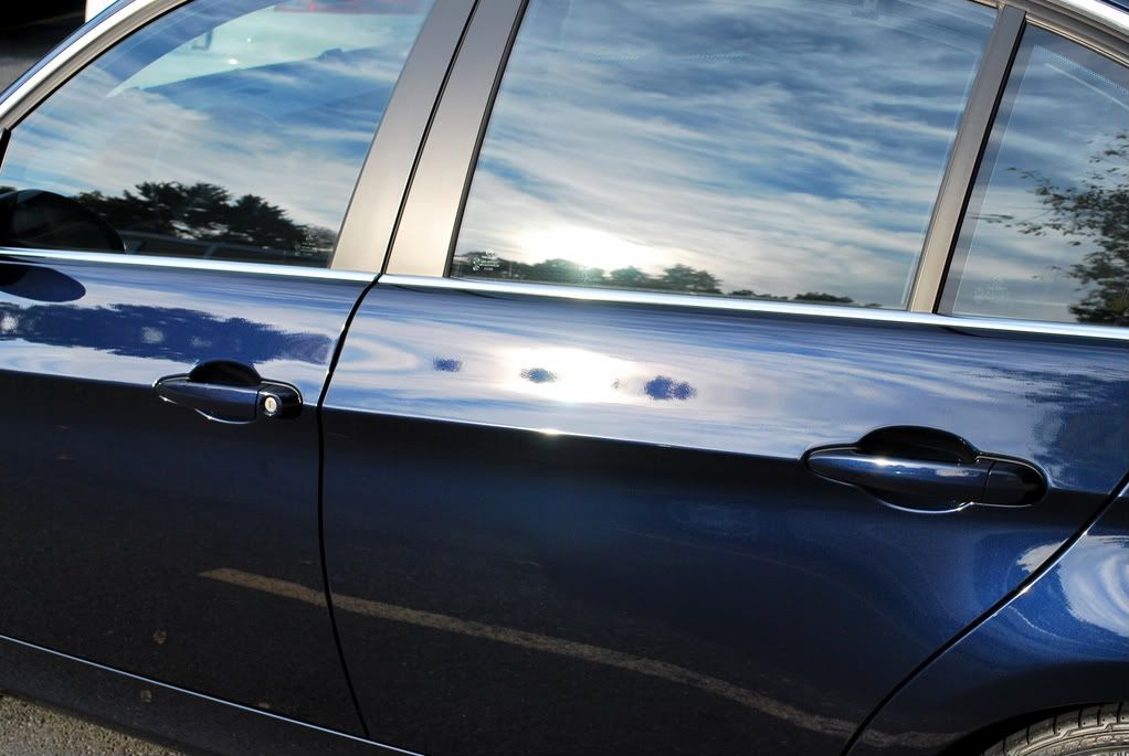

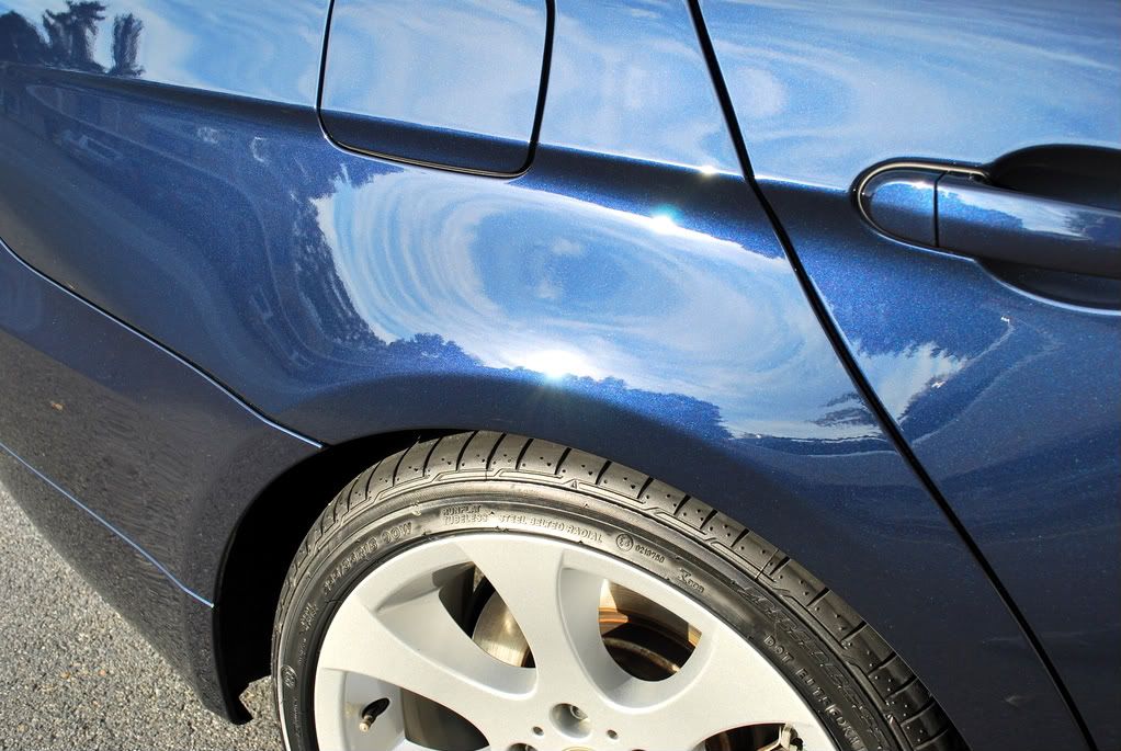

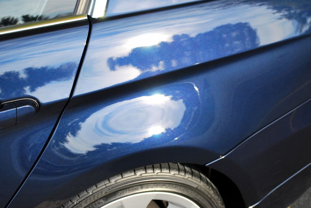

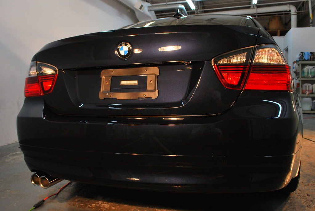

The car looked absolutely amazing upon completion and had an amazing glow which was hard to capture by camera.
Below are some pictures of the finished product…

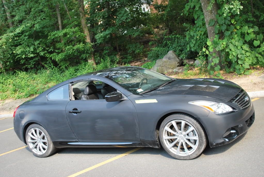

Ha, ha... This one?? :D
