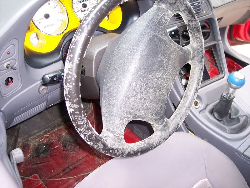

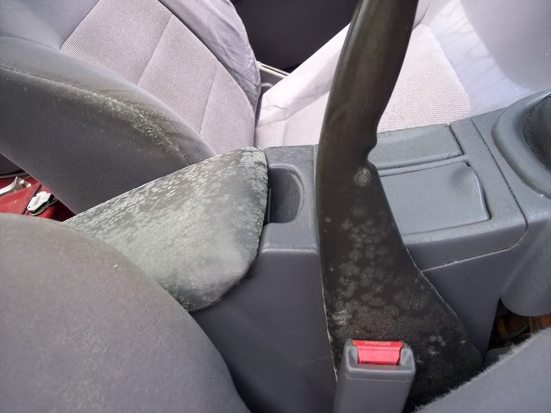

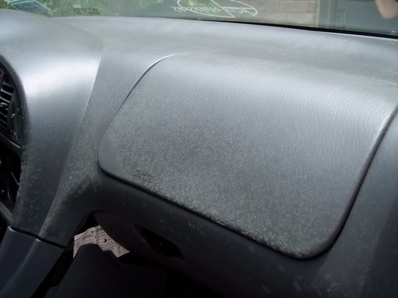

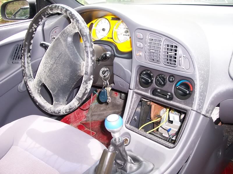

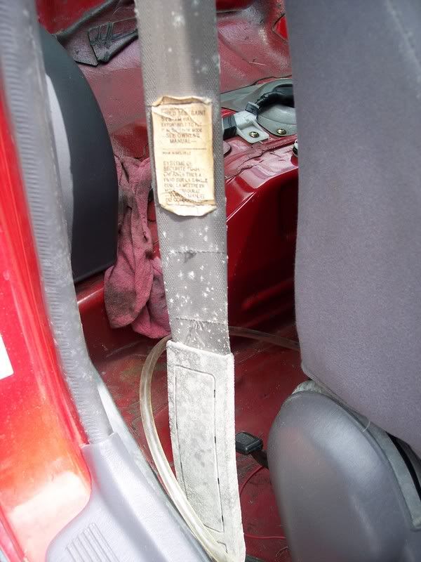

I don't know how it happend but I came out to the garage one day and noticed that my interior was "dusty"....Yeah, NOT DUST! My steering wheel looked like a dalmation and and so did everything else. I have been working on my car for a long time, and its been in my garage for a few years. Never did my interior get mold on it. I think it might have been because these last two months has been pretty much nothing but rain. All the humidity must have caused this I guess. Anyway here is the process and pics.

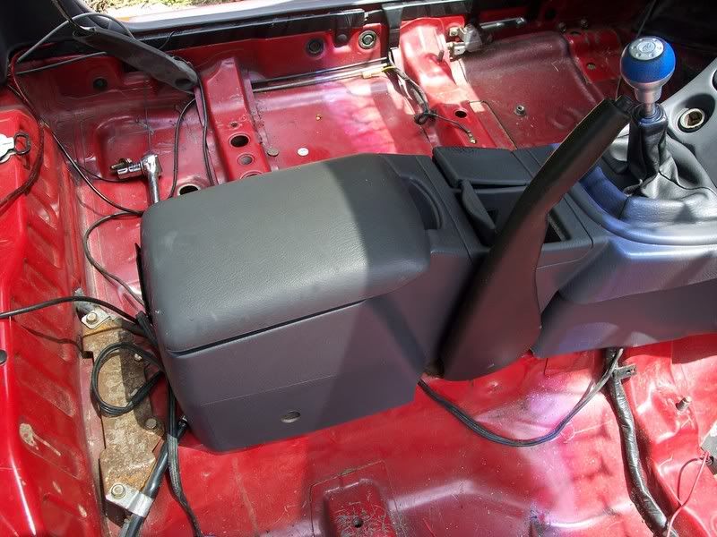

Seats were takin out and light shampooing with auto magic product

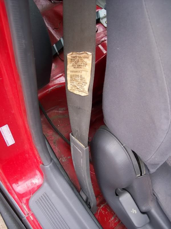

gloves were on my hands and simple green was used to wipe EVERYTHING down with an MF and brushes.

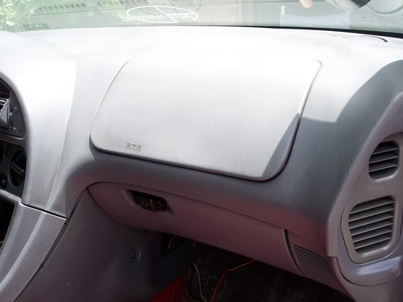

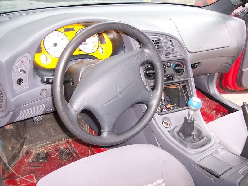

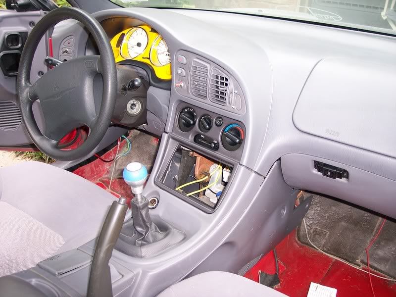

After I waited for the simple green to fully dry I used my new bottle of 1Z cockpit premium(I think thats the name) and wiped Everything down with it. As for the product and if I like it, not sure yet. Then I put everything back in and hopefully wont happen again. Here are the before and afters.
100x better and safer haha
In person, did the 1z cockpit make the interior trim look factory new as many people claim?
Well it made the top of the dash and the controls look fantastic. The thing I didn't like at the time was the steering wheel. You can't really tell in the pics, but the last picture, the middle of the steering wheel looks really grey. In person it looks REALLY REALLY grey. Today I got in it to let it run for a bit and noticed the interior and the steering wheel was growing on me. I just didn't like how grey it was. I was thinking about it and it was probably that grey when I first bought it and I'm not a fan of grey interiors, but yeah, it really does look brand new. Its just wierd because I'm not use to seeing that, just used to a clean, barely shiny interior. I don't know if I'm making sense. It just looks new with no dressing on it, like I have to put something on it. lol

Nice work. That would scare me to death.. not even sure I'd be willing to take the time to clean it.
Oh believe me, I considered paying someone else to do the job but since I do this for a living, I just sucked it up and went to town. LOL when I first saw it I did this:shocked then this:hm and almost this:bolt LOL. I put it off for 2 weeks and noticed it had gotten worse so I HAD to do something about it.
How long has the car been sitting? I had a 911SC get moldy on me, but it had been sitting around 4 months. I did pretty much the same as you; in fact, the interior was cleaner than it had ever been by the time I was done.
Did you use an emzyme based cleaner. (Don't think Simple green is) If you didn't the mold will come back fairly quickly unfortunantly. And what happened to the carpet in there?
Much better but I doubt I would ever want to ride in that again, mold is very hard to completely remove...
