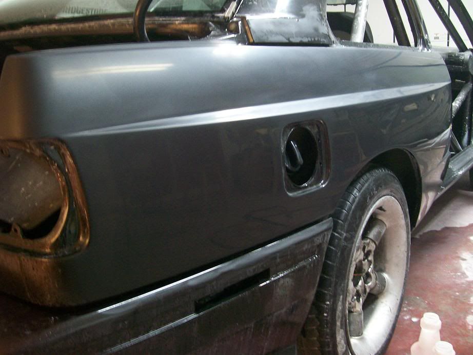

This quarter panel displays those "primary components" to the best of my abilities. Mind you, this surface is displaying the "trueness" of the paint in the last stages of wetsanding.

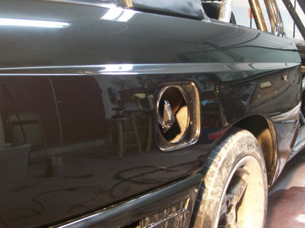

This is displaying a single, yet correctly applied, pass with M105.
The whole panel after completing the single compounding pass.
I hope this helps show how this system of components works. After this first pass, I sometimes think and view it as a "raw mirror". From here, the individual adds specific features (from selected products traits) to the mirror in a way they feel is artistic and expressed as "perfection" in their eyes.
