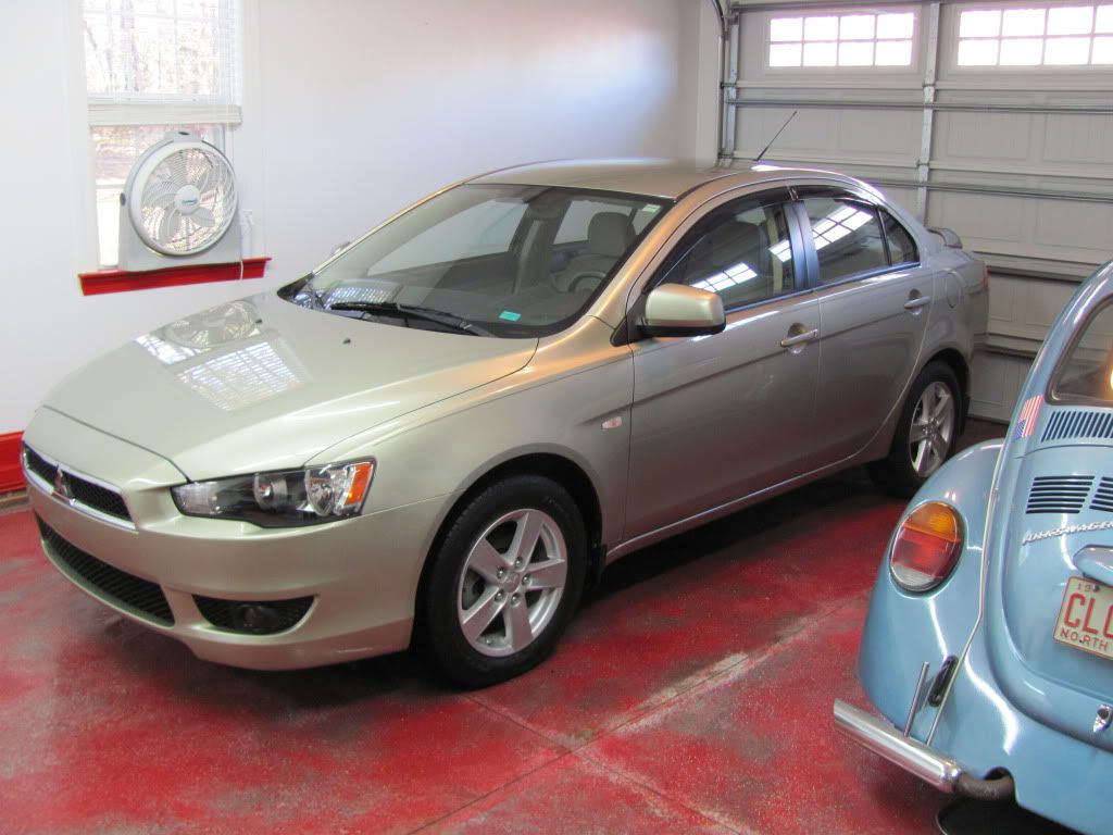

I decided to apply Opti Coat to my wife's daily driver. The vehicle is a 2008 Mitsbishi Lancer, that we have owned since new. The car has 34k miles on it, and has been cared for.
To start the process, I took a few pictures. There were 0 swirls on the car, a couple of small RIDS, and a little water spotting.

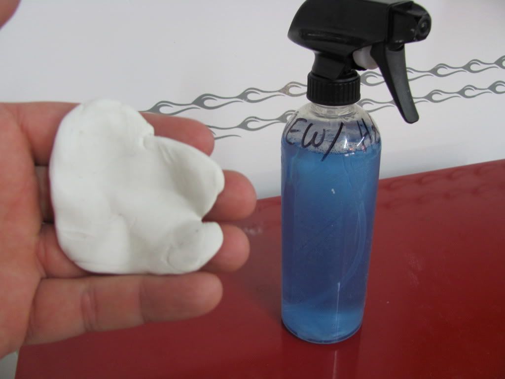

I then decided to clay, using Meg's white clay, and QEW/Water as the lube:

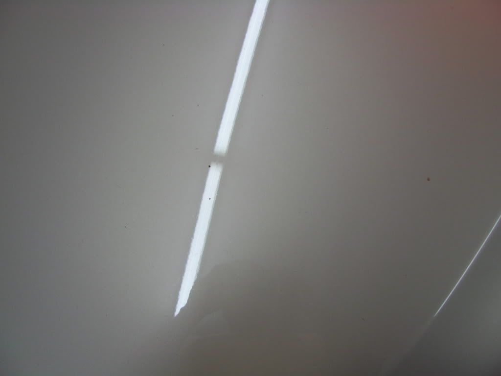

Paint shots after the wash, before polishing:

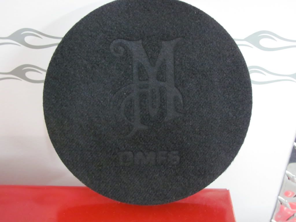

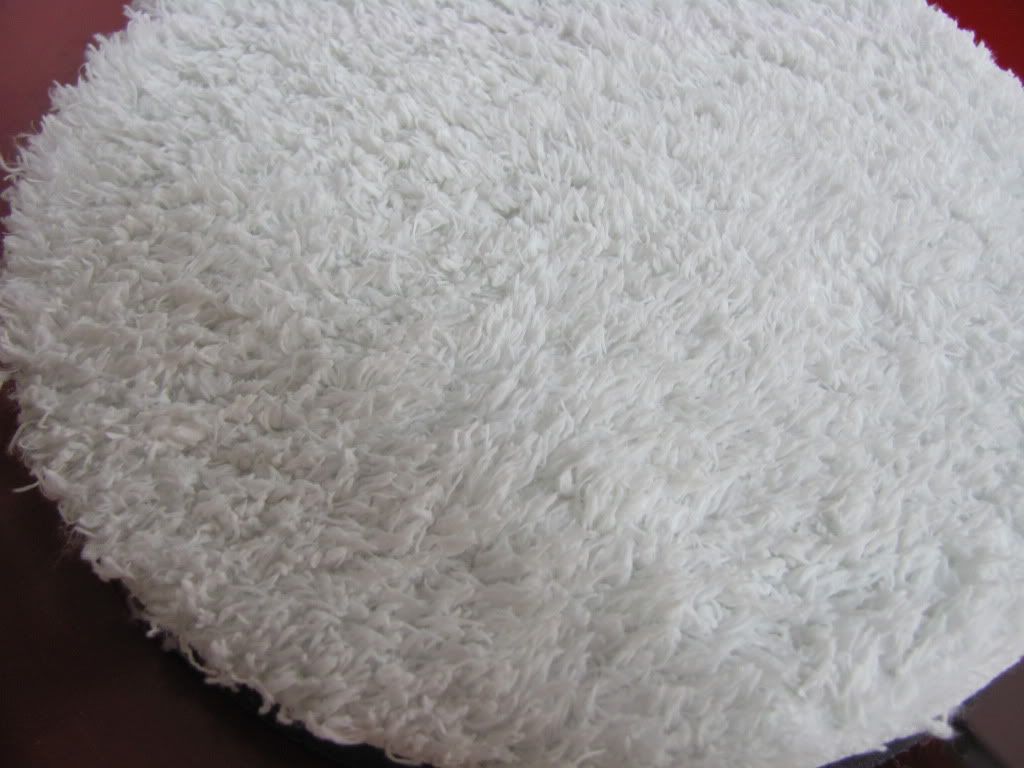

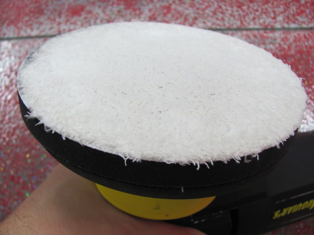

Here are some shots of the pad:
Here is the weapon of choice, along with the compresser (key item when using the MF pad):

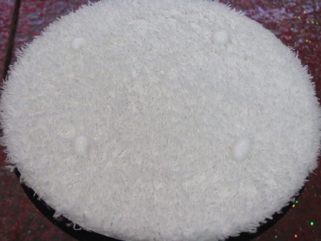

Primed Pad:
Ready for 1st section:
Basically, after talking to Bryan, he suggested polishing for 3-4 passes at speed 3 with moderate pressure....then, fluffing up the pad with the compresser, then going back over the area at speed 3, with no pressure for a couple of passes. After some experimentation, I found that speed 3.5 with moderate pressure did better on this car. When I came across a RID, I just bumped the speed up to 5 momentarily, and that knocked them out.

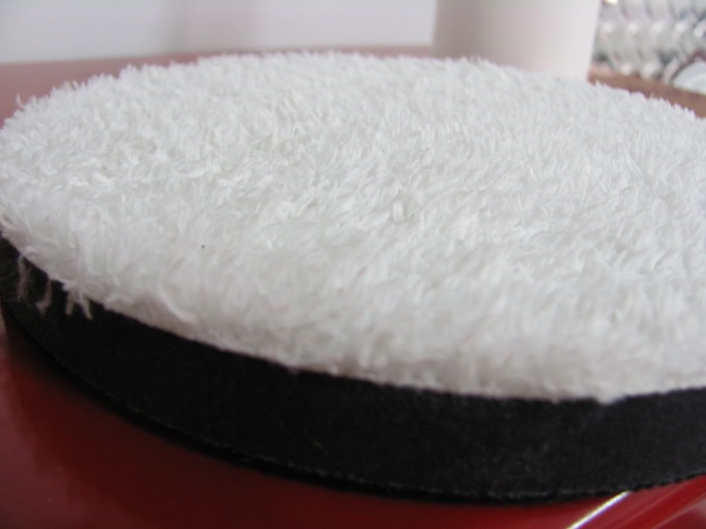

Here is the pad after polishing the first area. Notice the matting down of the fibers:
This is why the compresser is handy. A blast of 45psi air, and it fluffed back out for the next section.

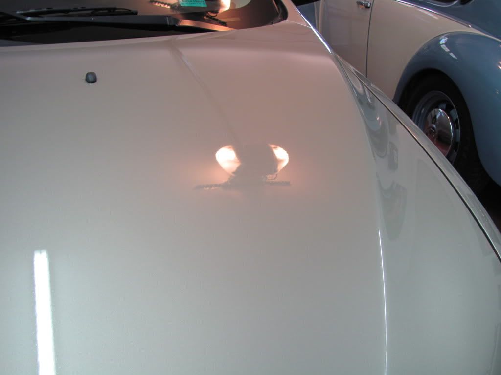

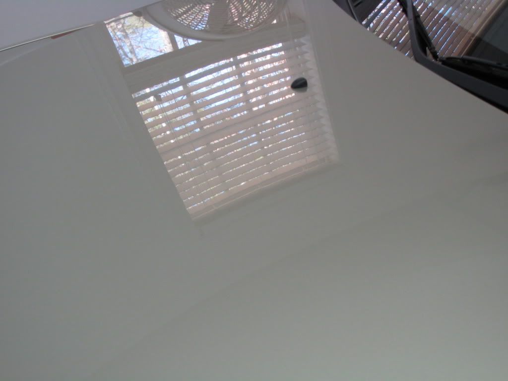

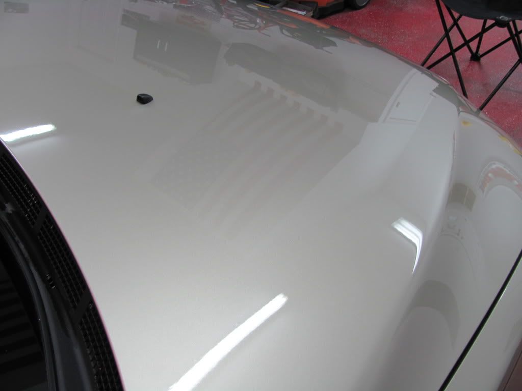

Here are some areas after polishing. I noticed that the gloss seemed higher than with a foam pad:

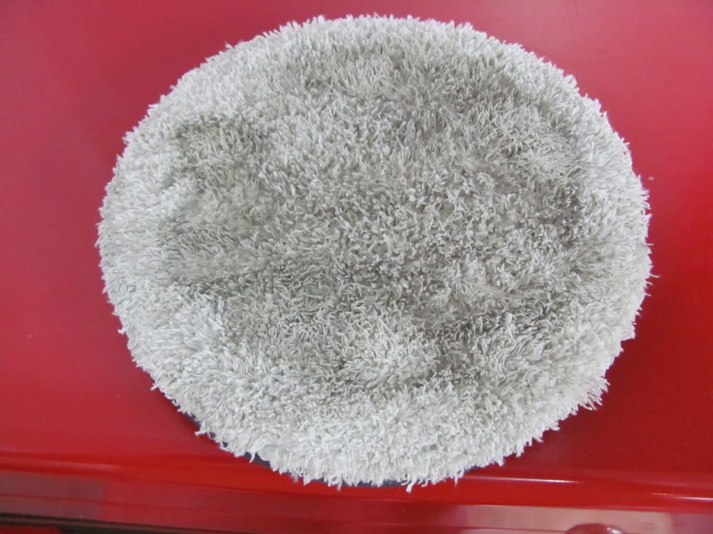

Here is the pad after polishing the entire car:

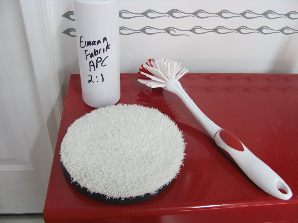

After a few spritzes of Eimann Fabrik APC mixed 2:1, and some agitation with a nylon brush under warm water, and a blast of compressed air, the pad came out looking brand new:

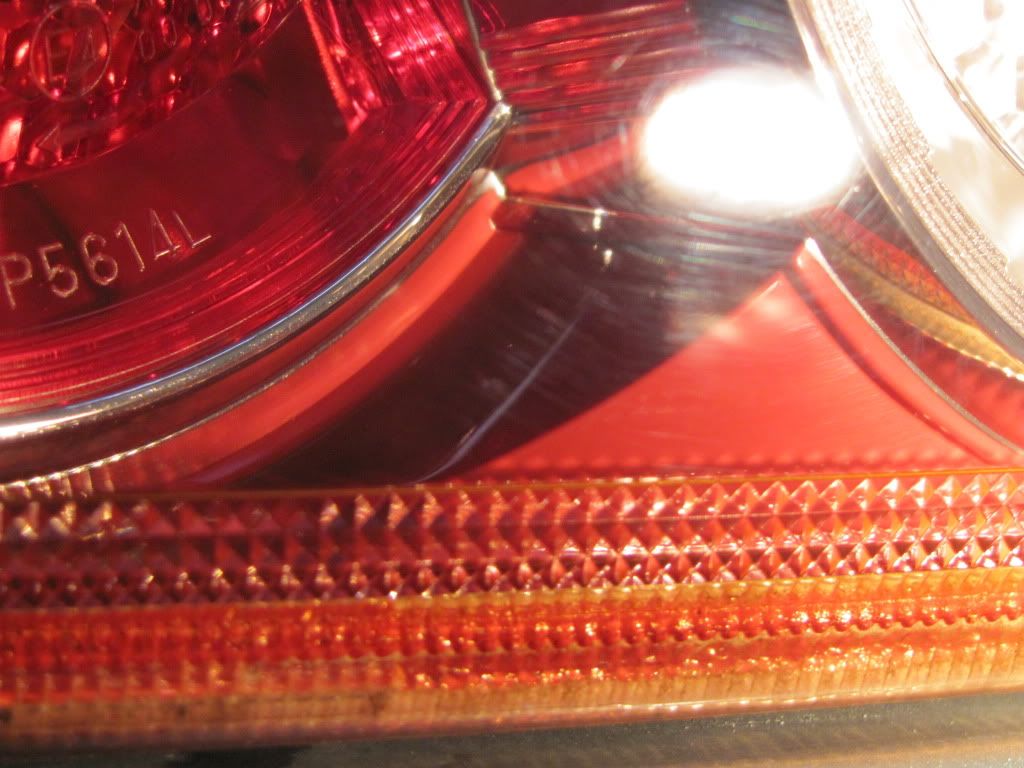

Since the Opti Coat will go on the lights too, I ecided to correct them with the PC, 4" Orange, and 105:
Before:
After:

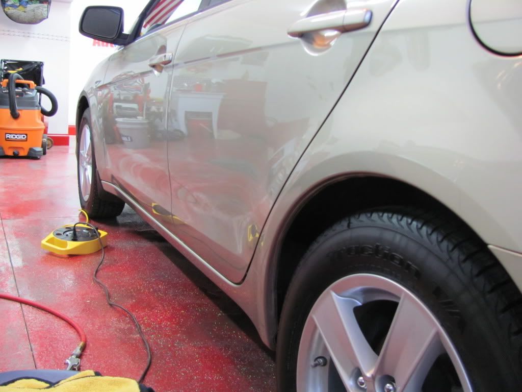

I brought the car back in, dried it off, and took a couple of pics:
