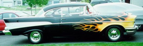

Here is a link to a pic of my 57. The pic is about 6-7 years old but it's the only one I have here at work.
http://mypics.denerah.com/images_pers/toms57_2.jpg
Thanks again for your help.
Tom

If your finish is pretty good shape to start with, and it looks like it is, then I would apply the #9 Swirl Remover 2.0 by hand using a foam applicator pad. This is a very gentle cleaner/polish and it will help to mildly clean the surface of any contaminants and prepare the surface for application of wax.
If you haven't tried the NXT Tech Wax, then I would whole heartedly recommend it to you. Apply two coats for maximum coverage and uniform gloss and protection. If you can, wait till the next day to apply the second coat, if not then apply them back to back. Two thin coats always looks better than one coat.
Nice car by the way...
Mike

Thanks Mike...that's exactly what I'll try. I'll let you know the outcome and post pics.
Tom
