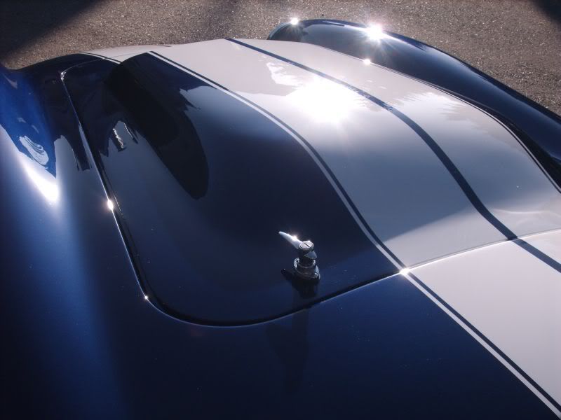

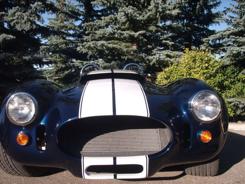

Would you be concerned about using meguiars UQD on a fresh (1-month old) paint job? I used it to remove water spotting today after washing it, but then began to wonder if there's anything in there that might be harmful to 'fresh'ish paint, that wouldn't let the solvents finish degassing?
Should I do anything, like go over the car tomorrow with a very very very mild polish, or do you think I'm okay? :think:
edit: this isn't production paint btw, it's dupont, not baked to my knowledge.

Well, I polished it with 106 and a white pad. Hey, good excuse to go over any defects I missed when I did orange/PFW+SIP ; black+!06. :chuckle:
