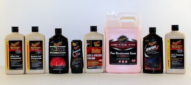

Here is a chart I got from somewhere that shows the line of aggressiveness of the Megs Compounds and Polishes.
Hope this helps.
Odd, that chart shows d151 having more cut than 205. That has been the complete opposite for me.
Makes me wonder if the way I treat d151 is not aggressive enough in pad or pressure.

IME, I've always found 151 to be a good deal stronger than 205, even after IPA'ing to check for filling.
I too have found D151 to be more aggressive then M205 (I actually misread the first reply). I would say Ultimate Compound is more then D151 though.
