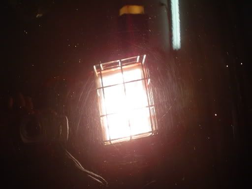

Here is a pic. I worked on a small section for 15 minutes. I broke out a new pad, its yellow medium cutting pad from tropicare.com. Worked it with ssr2.5. Hopefully I just need to work it in more or grab some ssr3.
Here is a pic of what Im battling. Is my paint terribly hard or do these marks just not come out??
They don't resemble finger catchers so they should come out. I would speed up the PC and slowly work the areas in question. It is very difficult to get black perfect, so I would recommend you get the paint to a point where you are satisfied and then grab the RMG. It's a real life saver on daily driven black autos.

Turn off the halogen lamp. Done :grinno:
Just kidding. Your process seems right on target. However I’d pursue a bit more cutting action with the yellow pad. Give yourself a 2 x 2 area and focus solely on the scratches. Though I’ll be the first to admit that I do not use a PC for correction . . . take more time or use a combination of lighter polishes and glaze. Good luck.

Thanks for the reply guys. Yeah I know that halogen light sucks. It was the only big light I had.
