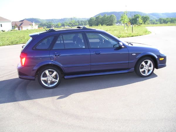

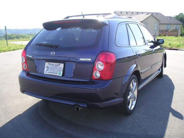

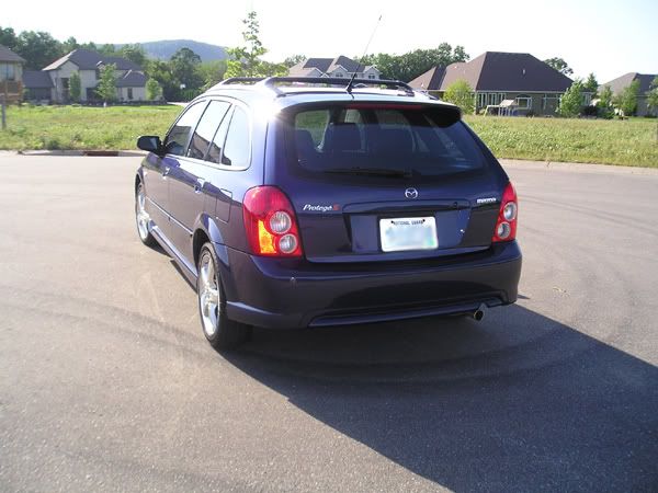

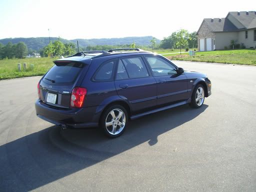

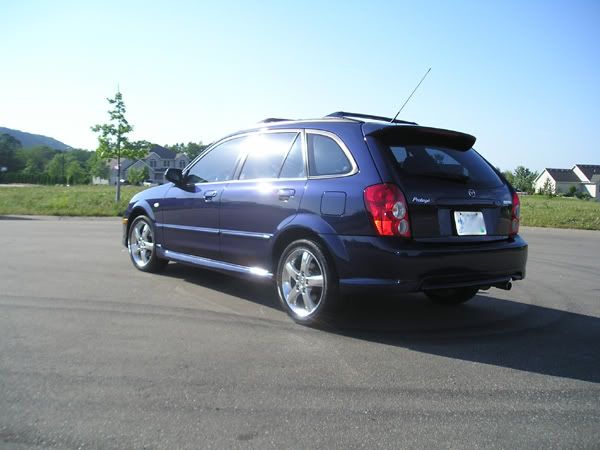

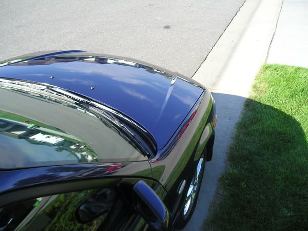

Hello everyone! Today gave me great weather for detailing. I detailed this car for our pastor. I did ext int and engine but forgetful me only got exterior pics, so I will only layout my exterior process. If someone wants to know what my other processes were just say so and I will post em up.
Process
Wash NXT
Clay - took about an 1.5-2 hours. Paint prior to claying was like sandpaper.
SSR2 via 6" LC pad (free sample) on speed 5. Very low pressure on pc.
PwC blue via hand
BSG via hand
TS via hand
S+G
Hi Temp light cut on rims
VRT on tires and on all trim
No-touch dressing in wheels
50/50 water/vineager on windows followed by IG to remove water spots.
PICS
Questions and or Comments?
