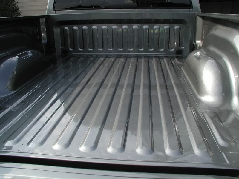

The bed was sealed with OCW & Gliptone Spray and Gloss.

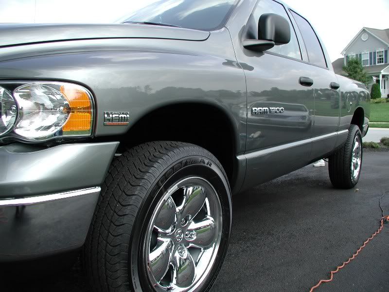

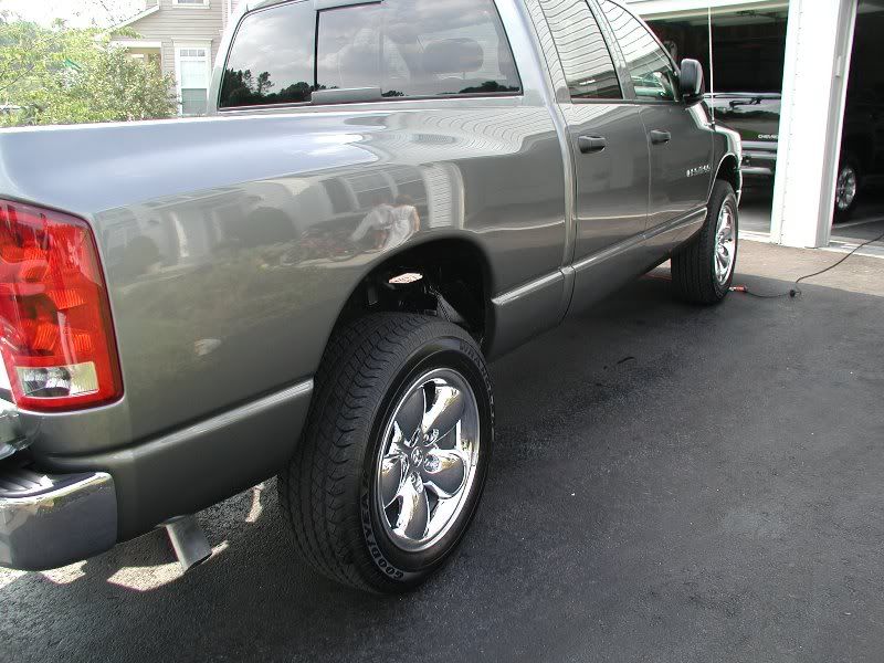

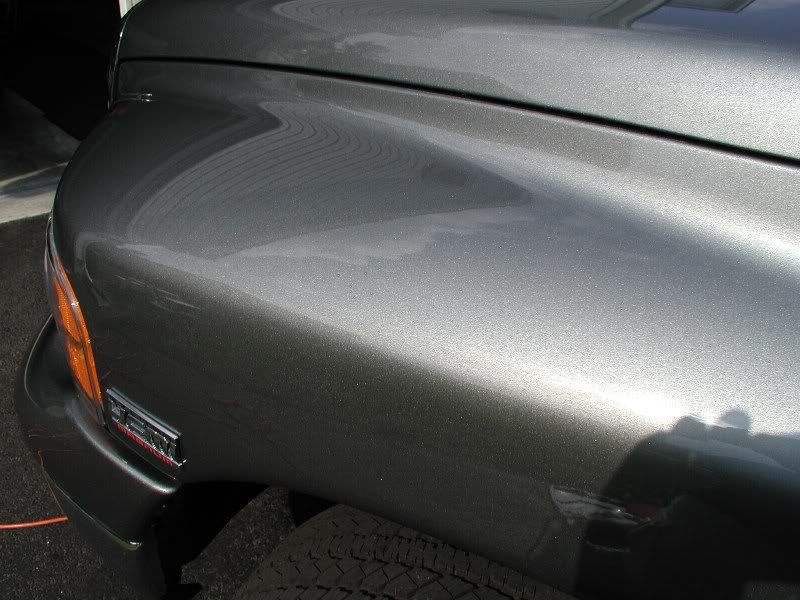

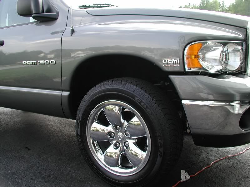

Here are a few after shots:

I like the look that OCW & DQ+ produced. Very clear with lot's of met. flake in the full sun. It will be interesting to see how it holds up.

What do you use to clean the bed lining? :think: I always wonder how you guys do the bed on those pickup?
klnyc said:
Great job!
To clean, I used optimum car soap & an old wash mitt. Then I hit it with a clay bar, which got rid of most of the surface scuffs. I sealed with OCW & Gliptone Spray Gloss.

Looks like it turned out really good! The metallic really pops the the paint has a nice wet glow.
Does the truck have a plastic bed liner or a spray in liner? Mop and Glow works great on spray in liners.

Scott, The bed was cleaned with OCW and Gliptone spray gloss.
