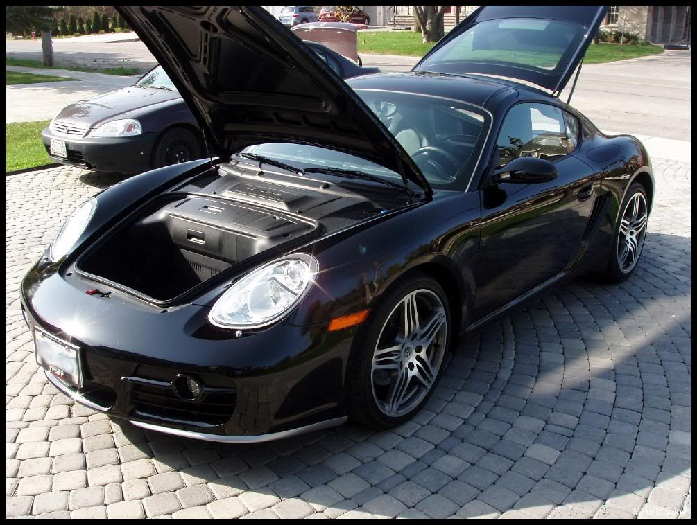

Pics of when I arrived. The car had been washed that morning so it was looking clean.

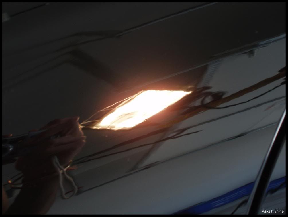

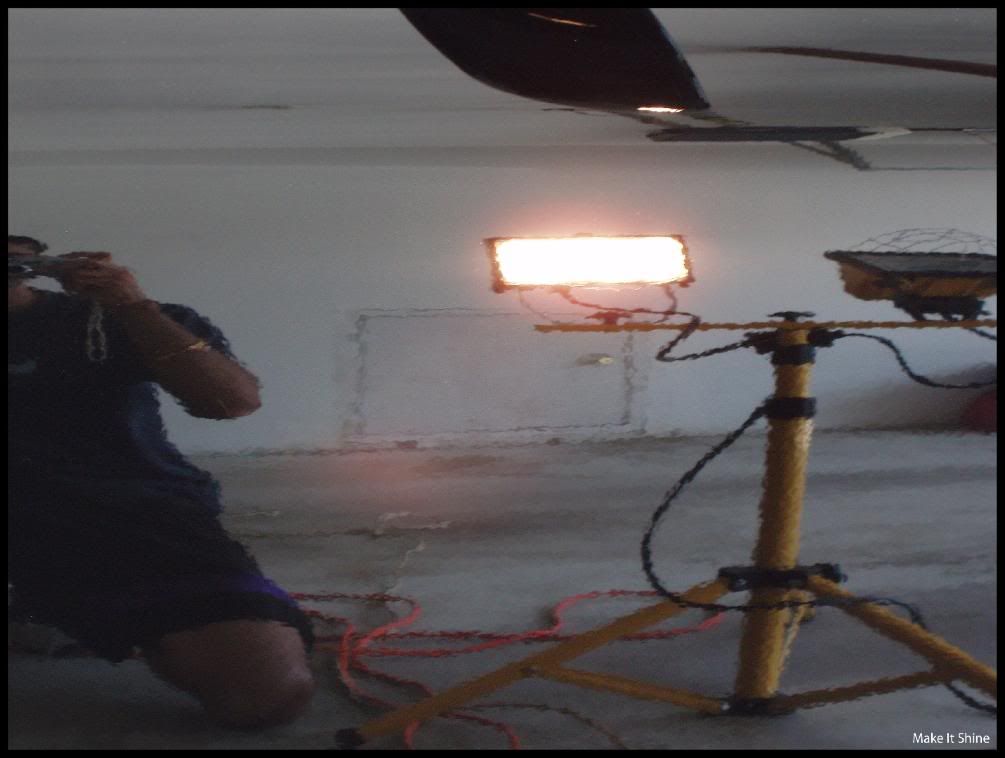

After doing this I brought the vehicle into the garage and took a break to let the paint cool down as the sun was beating down quite heavily. While I let the paint cool, I took a couple of before shots of the hood.
I recommended a One-step to the client as I felt this would be able to remove the defects in the paint.

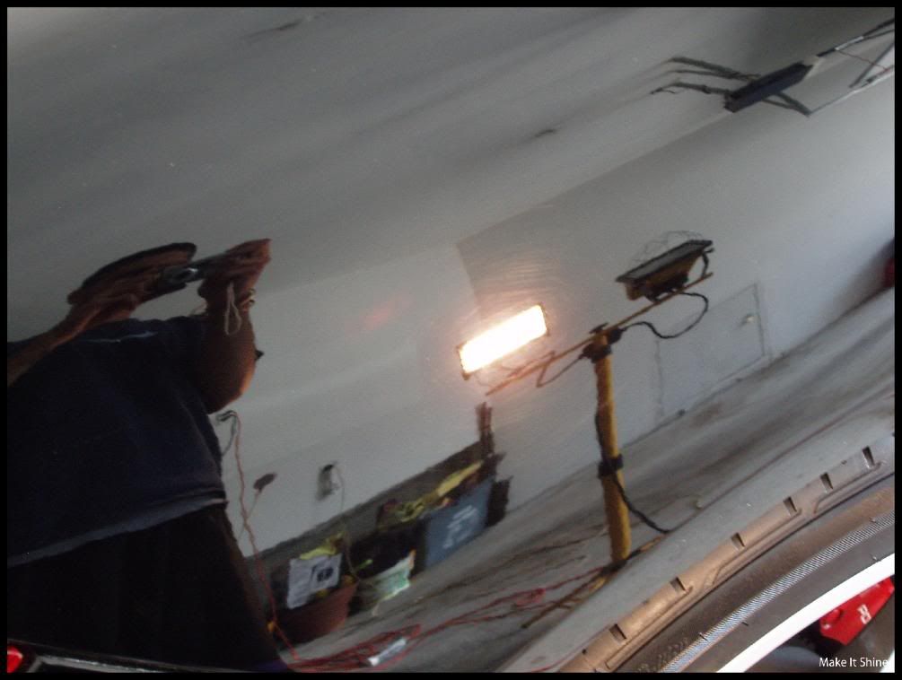

Given that Porsche paint is soft, I opted for a white pad and SIP on the rotary @ 1400rpm. After 2 polishing sets and IPA wipedown:

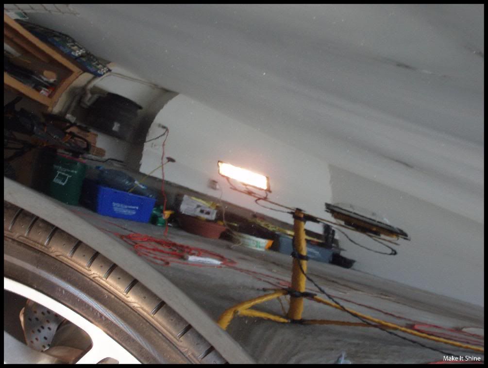

After this, I proceeded to do the rest of the car in the same order. Pictures:

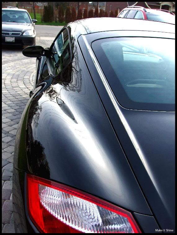

All polished up:
After polishing, I rinsed the car down to rid of the dust, check my work for holograms and trails, then wiped down with IPA and checked everything over once more.
After rinse:

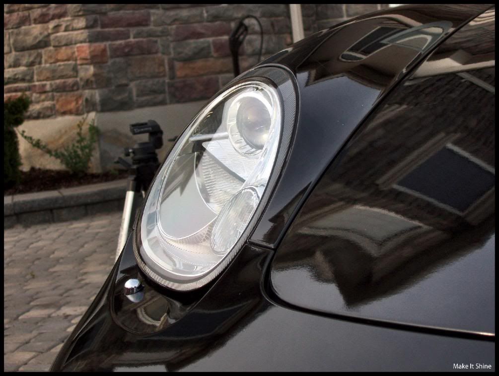

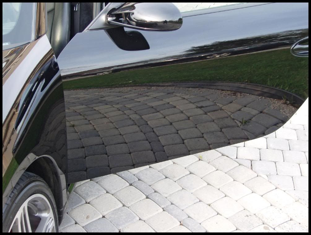

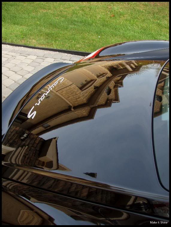

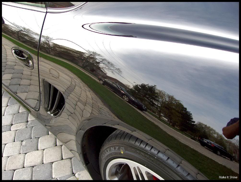

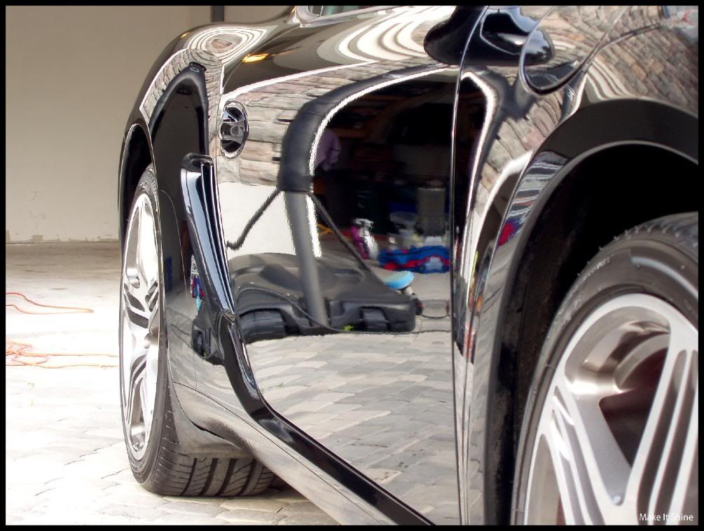

I was SO disappointed because the sun was stuck behind the clouds for the rest of the day so it took away from how wet the paint looked. These pictures were taken about 1 hour after the Opti-Seal was applied (waited 30 mins between coats):

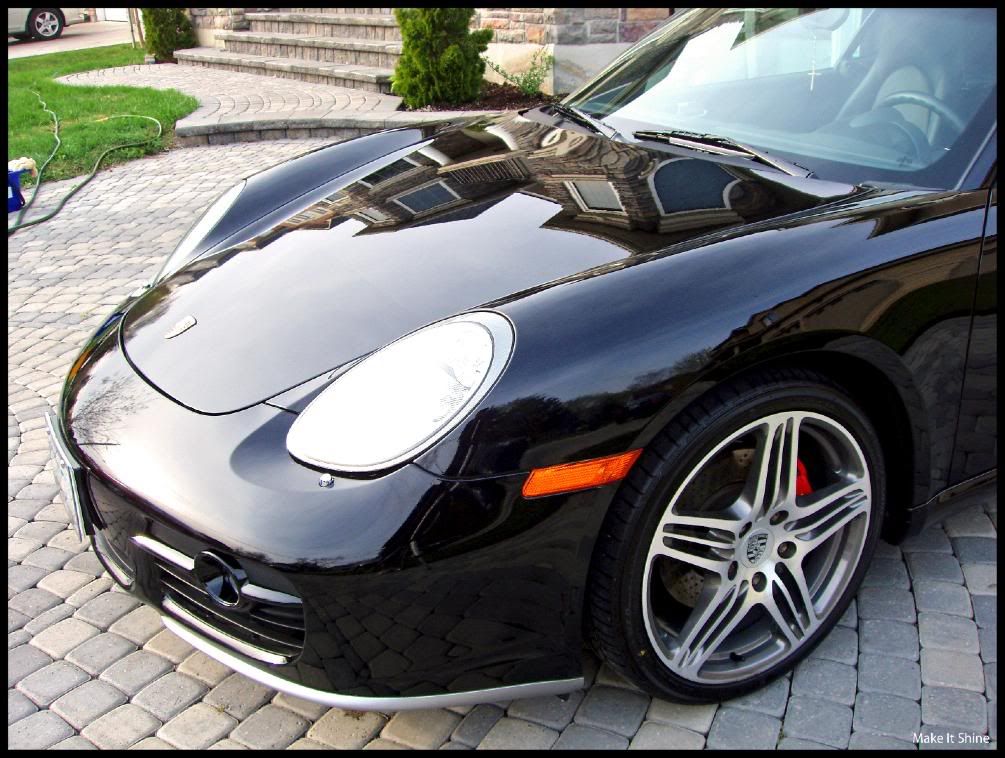

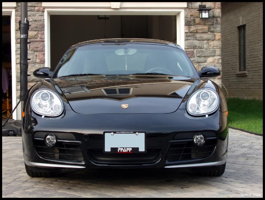

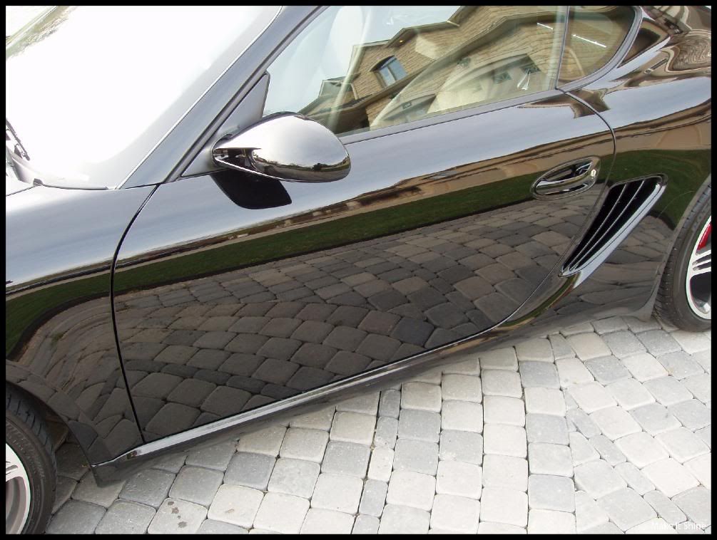

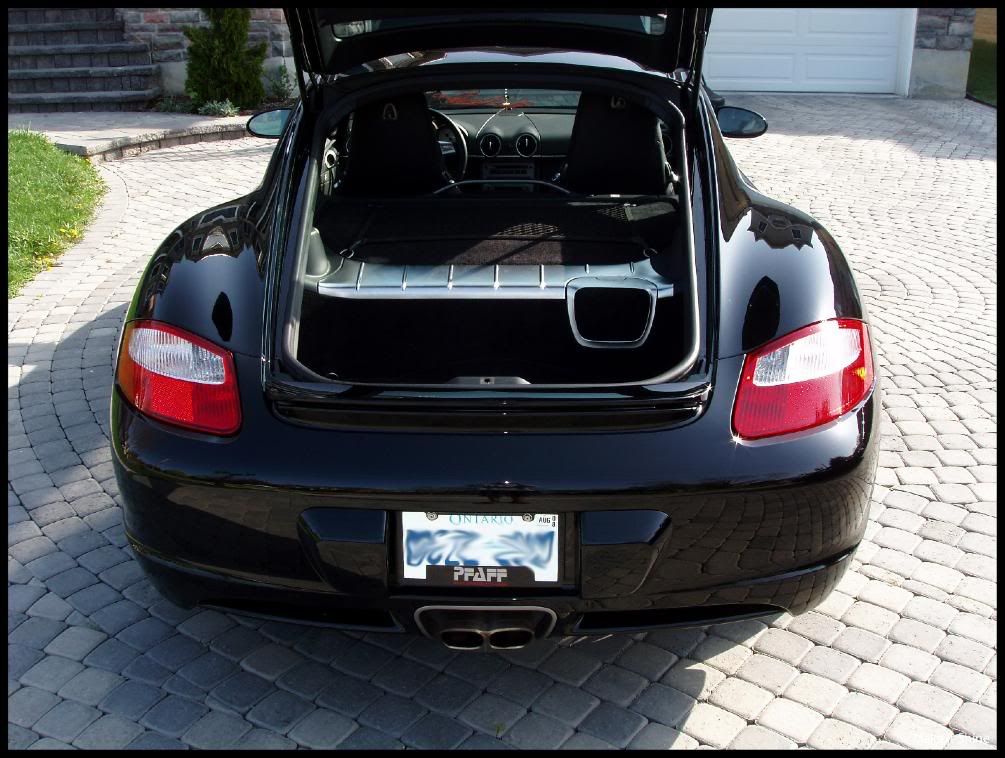

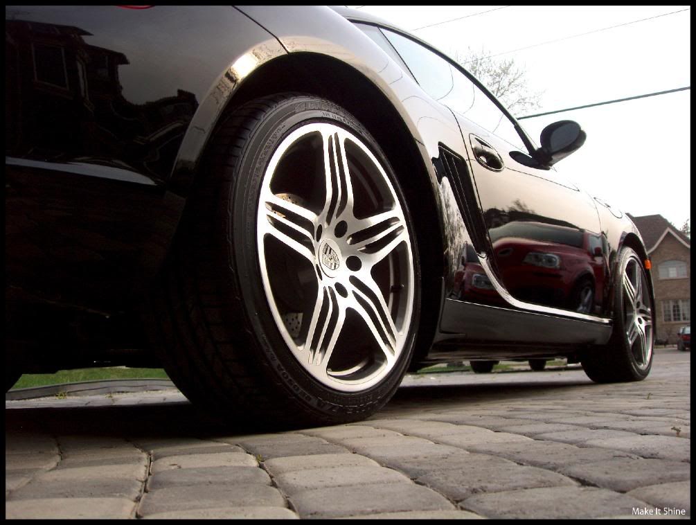

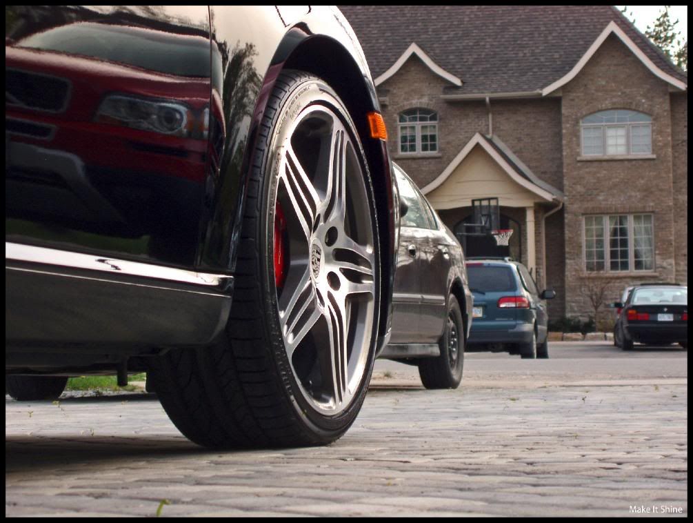

Final pictures, and LOTS of them :D:
