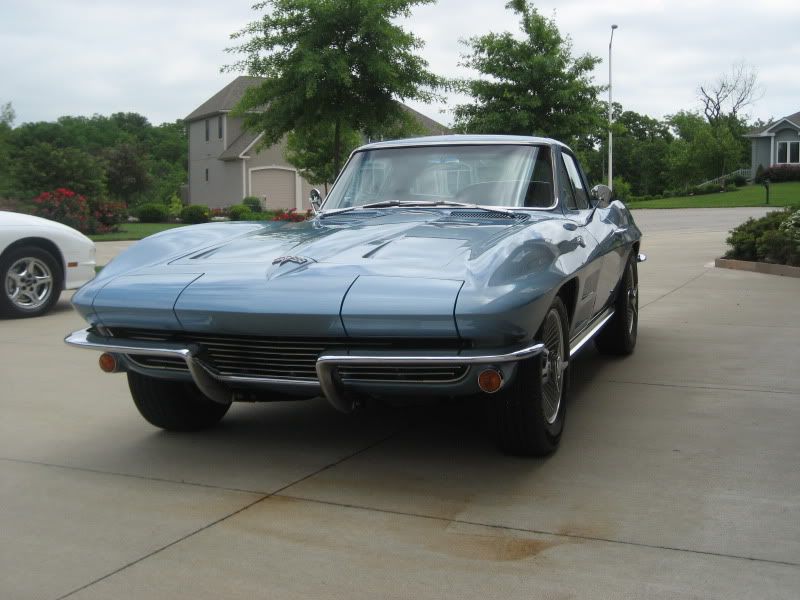

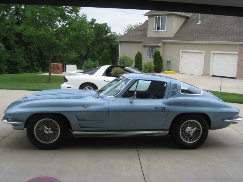

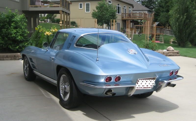

This is a '64 Corvette Coupe, 327/300, 4-spd, 100% correct, strong #2 car. Very nice and well maintained.

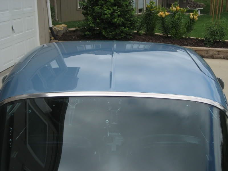

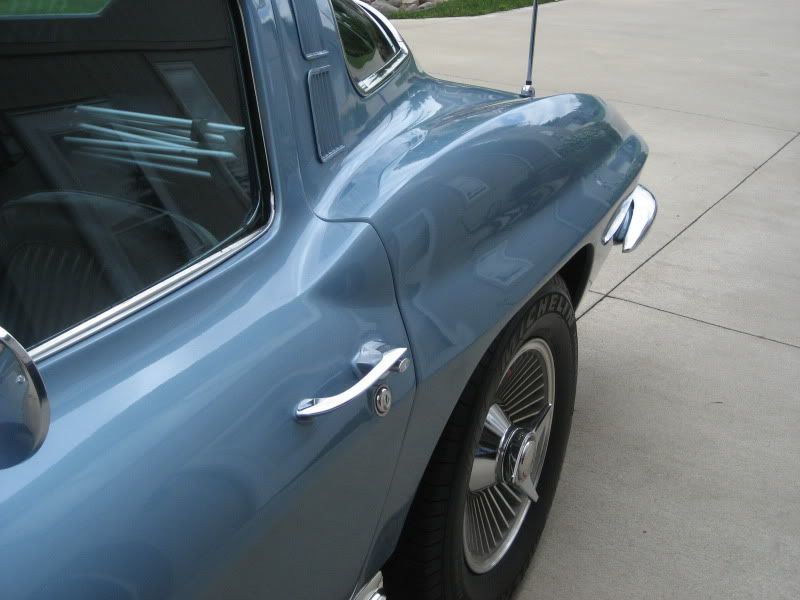

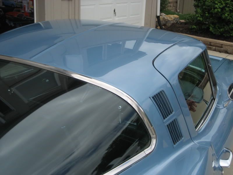

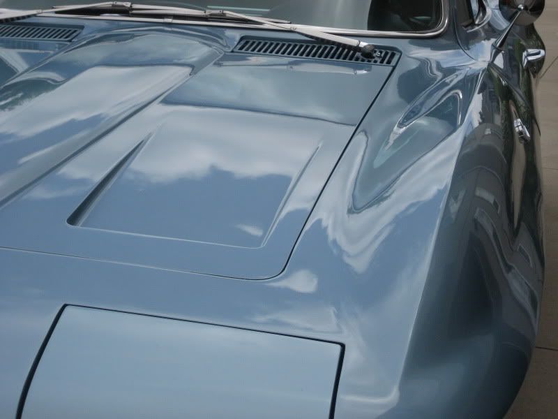

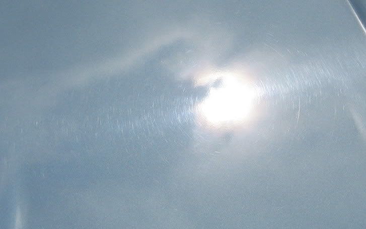

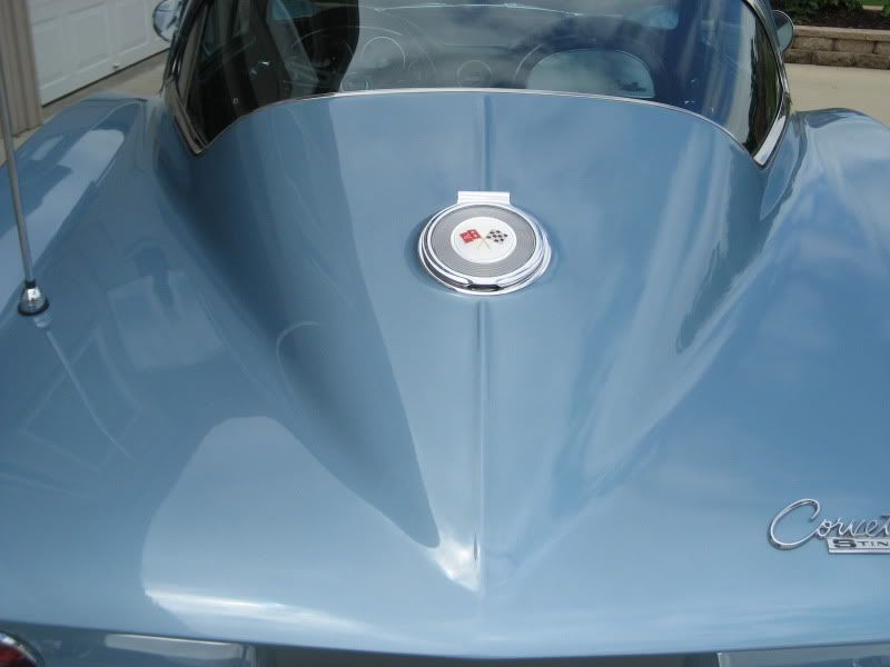

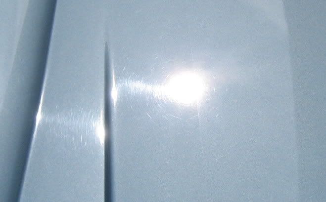

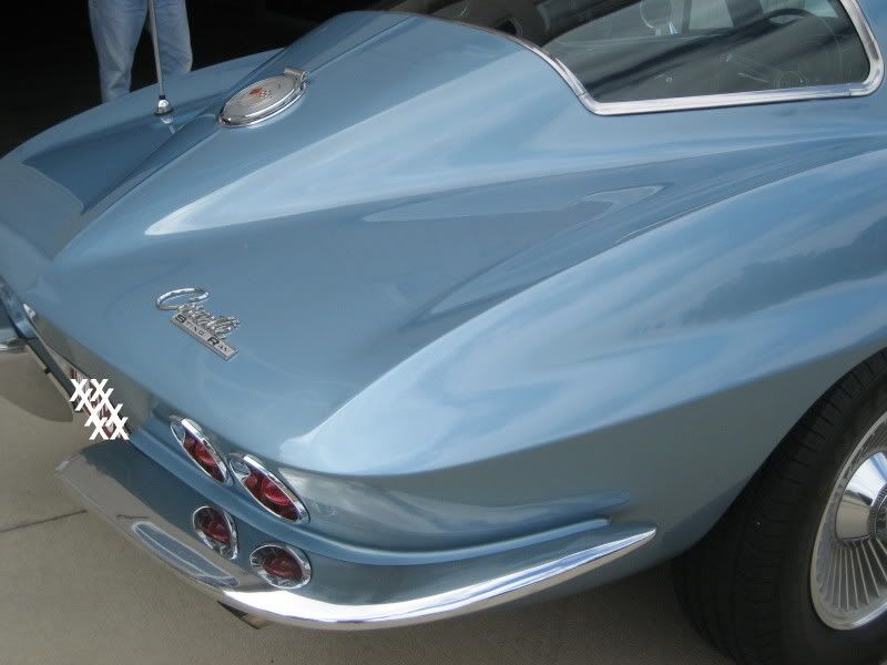

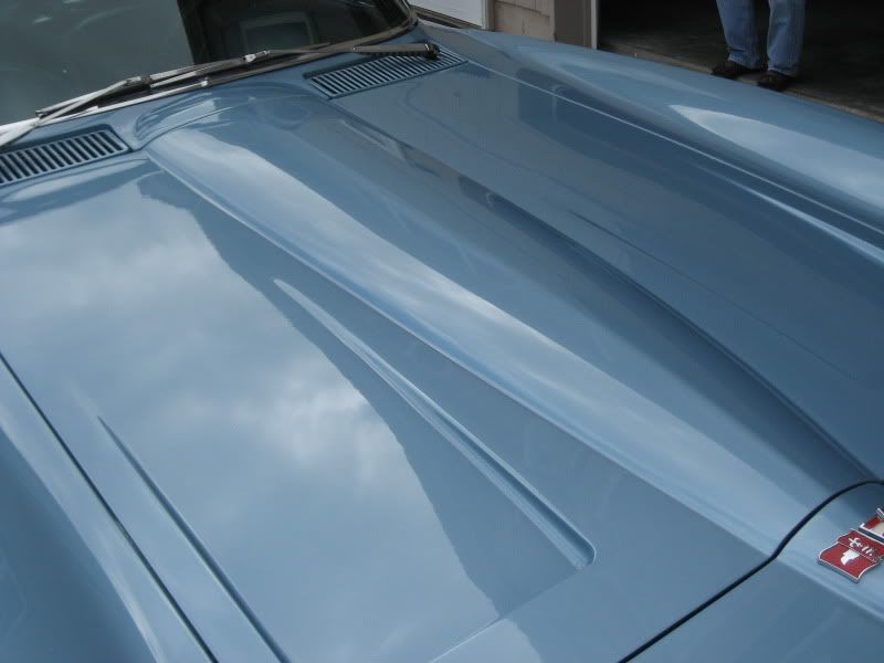

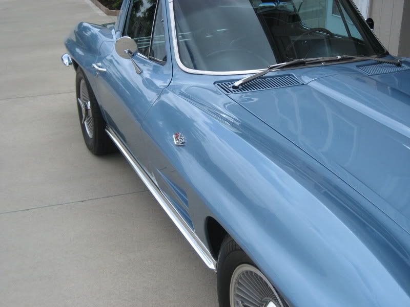

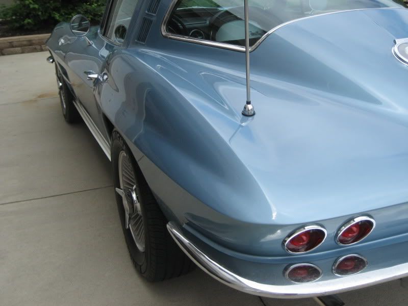

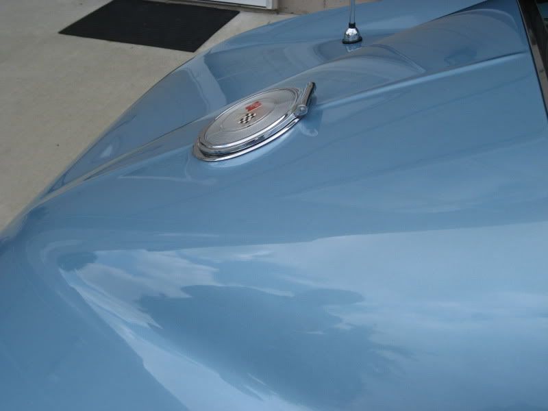

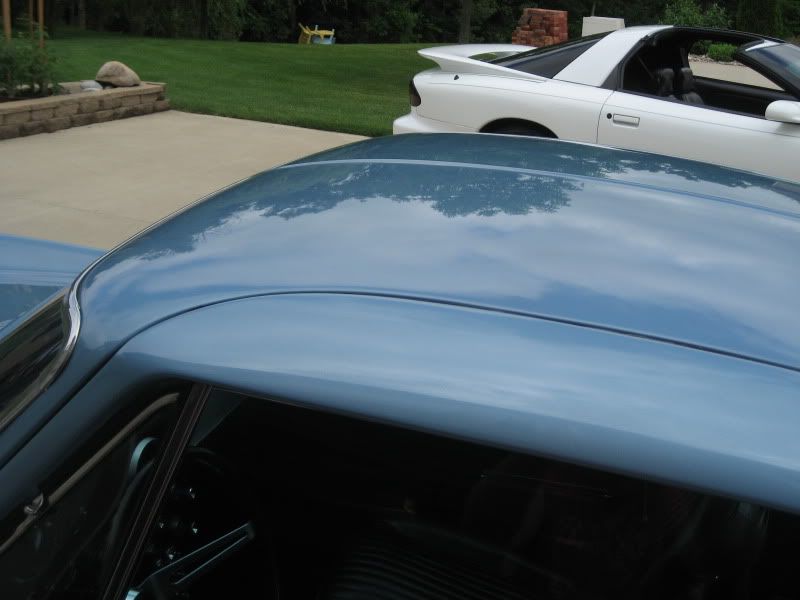

Swirls weren't too bad... a couple before shots, lots of after shots...

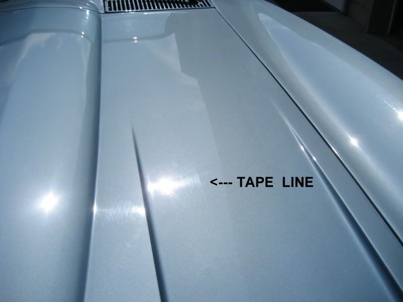

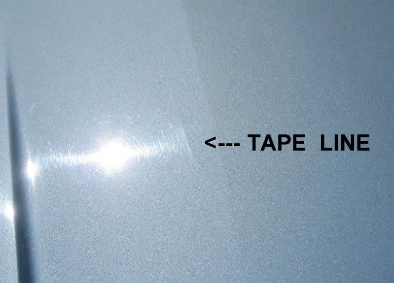

The "tape line" is very hard to see because the car is the same color as the sky!
